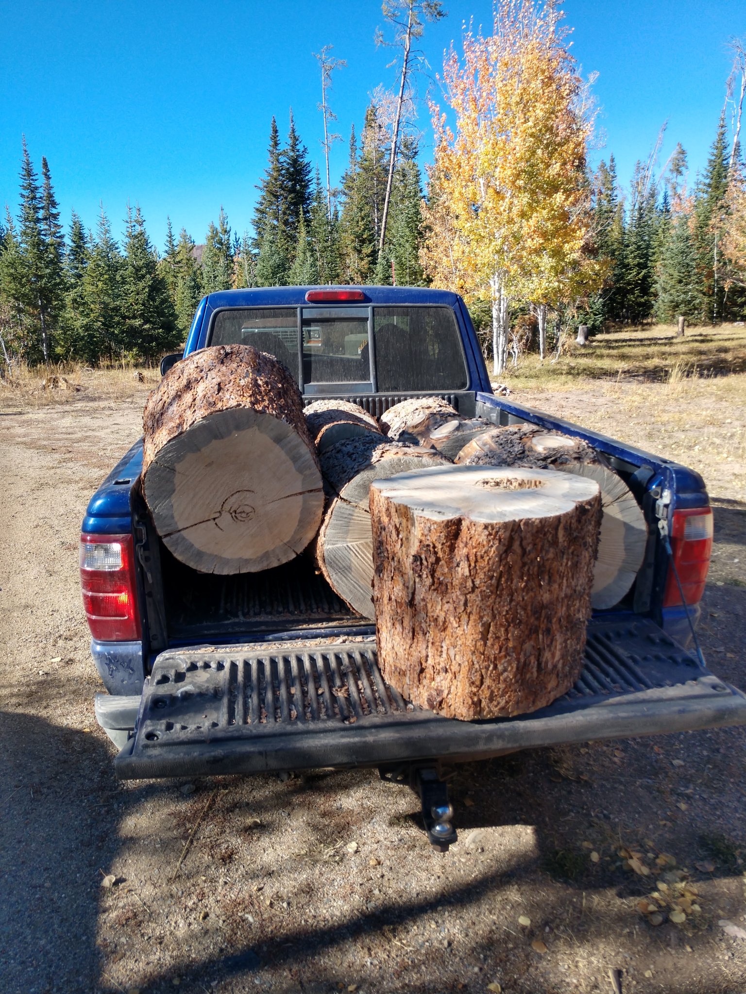

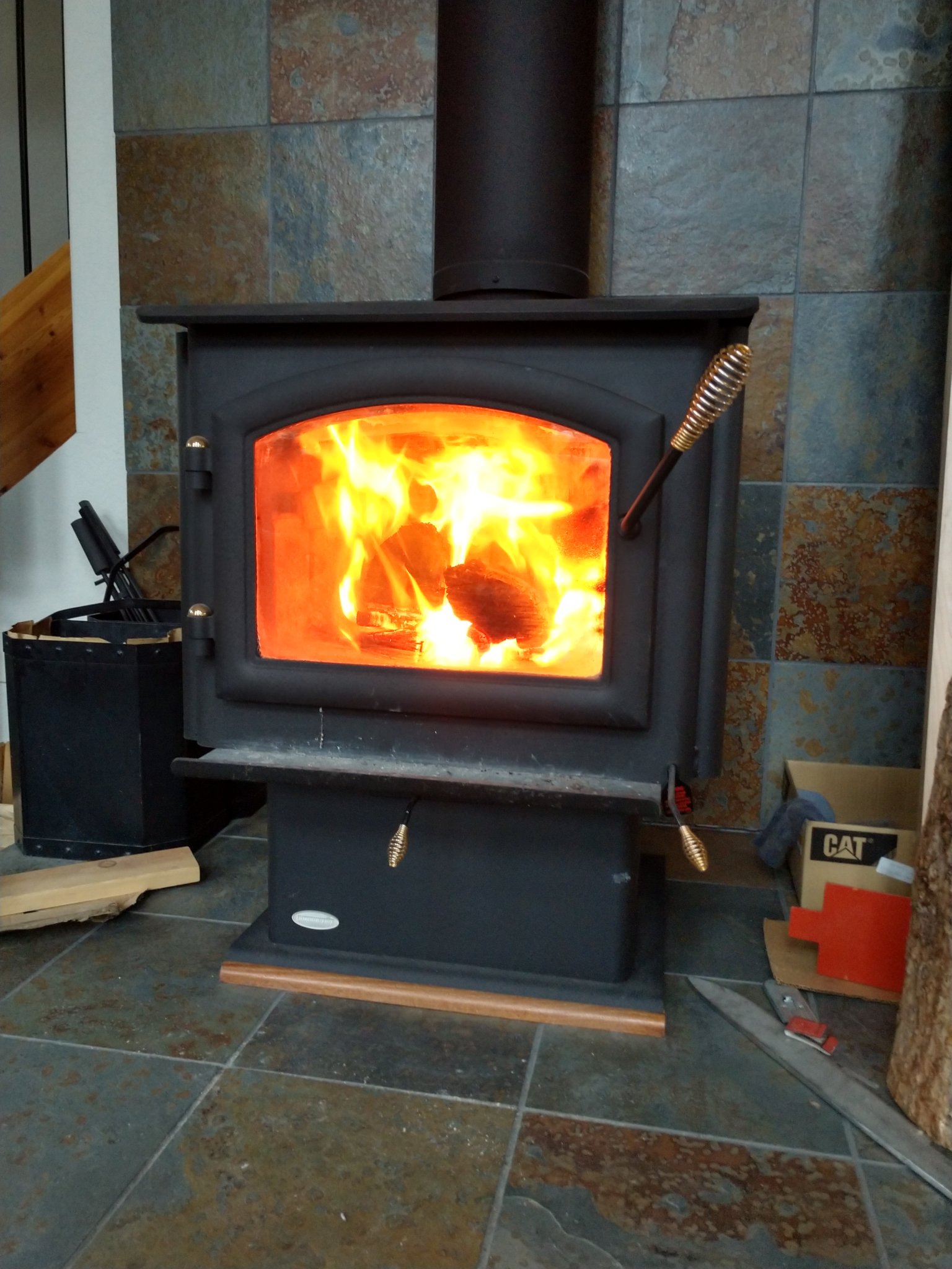

    The solar companies up here ( bunch of fruit bats) put out a call for generators for their clients... guess a month without a sunny day and last week at -25 has put the hurt on the little wokies. Wahhhhh.
    Meanwhile, my little wood stove has the house at 75 on 10 logs a day.

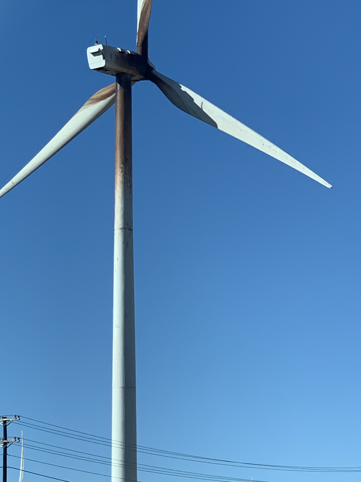

    All the turbines near Abilene Texas are covered with oil and look like this. Does that still qualify as clean energy?
    That's how you tell if there is still oil in it. If it's leaking it's still got oil in it. Don't worry about it till it stops leaking. One of my buddies is in the wind turbine industry. Kinda funny the garbage they plant in the ground. All the money is in getting them up. They don't really give a fuck after that.
