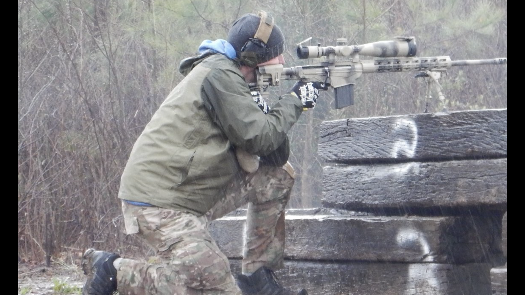

Pic for attention. At the Guardian Long Range Match at Frontline Defense in North Carolina. Day one was a frog drowner.

I also will agree with the 6-9” Harris. In my picture I posted above that’s what I am using. I have never found a situation where 6-9” didn’t suit me. I actually leave it two notches out and don’t change it too much. That probably puts it at about 7”? Get the swivel with the notched legs and a KMW pod-loc. Don’t mess with that knob to tighten them. Even if you’re one notch off between the legs the swivel feature will allow you to level it. I have mine tightened enough to be stable, but loose enough that I can level the reticle.
Is there something going on there with a lower butt pad? Could just be the angle.
The scope I run is a 4.5-27, and I rarely ever go over 16-18 power. You should be fine. That scope should easily take you out to 1,000 yards.
Butt pad isn’t visible in that pic. It’s completely obscured by my arm. I see my left hand (in a black/white mechanix glove), the lower pic rail for attaching a monopod, and down below my arm is a small rear squeeze bag that hangs from the butt stock by 550 cord so it doesn’t get lost upon movement from position to position. Let me know if that answered it or shoot me a PM.
