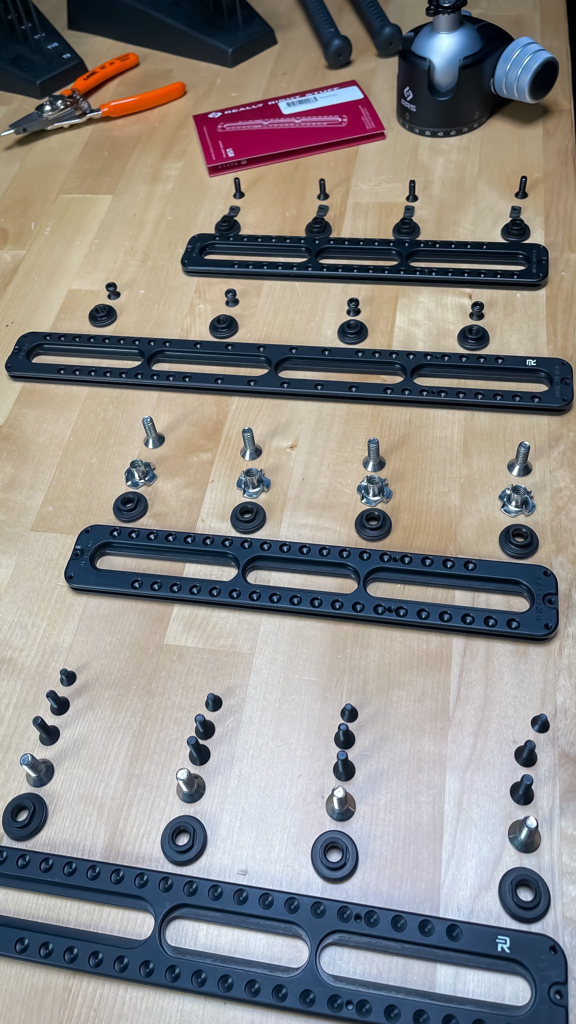

Here are a couple of pictures of the USR's with their respective hardware options. We are currently working on updating the website based off your suggestion. So, thank you.
In the first image from left to right the hardware options are M-Lok, Keyslot, Stock, and Chassis. You're correct that the M-Lok eyelets have an extra lip that helps them positively engage with the M-lok slots. The rest of the eyelets are the same without that. In the second picture, you have from top to bottom M-lok, Keyslot, Stock, and Chassis hardware options.
I hope this helps give a better look and more detail into the USRs and their hardware options. Please let me know if you have any additional questions.

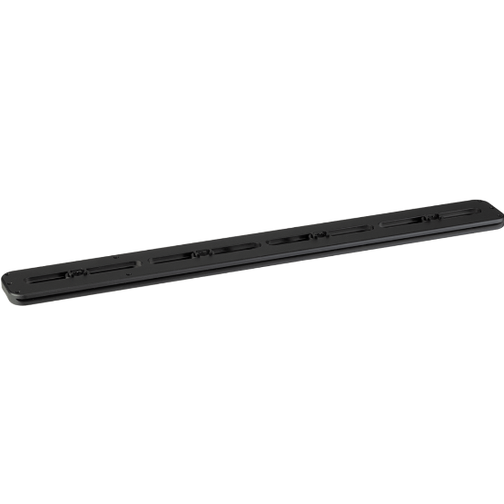

Is it possible to get the dimensions of the holes to get milled into a chassis with bilt in arca. I currently use ingenuity gunworks instead of arca but I'm thinking I'll change to r-lock if I can get it milled into a chassis
I wonder if the clamp would work with the arc Xylo chassis. The pics above shows the lock pattern that is similar to the xylo. The holes in the xylo are for the weights so it wouldn’t work I guess if one had weights installed.
