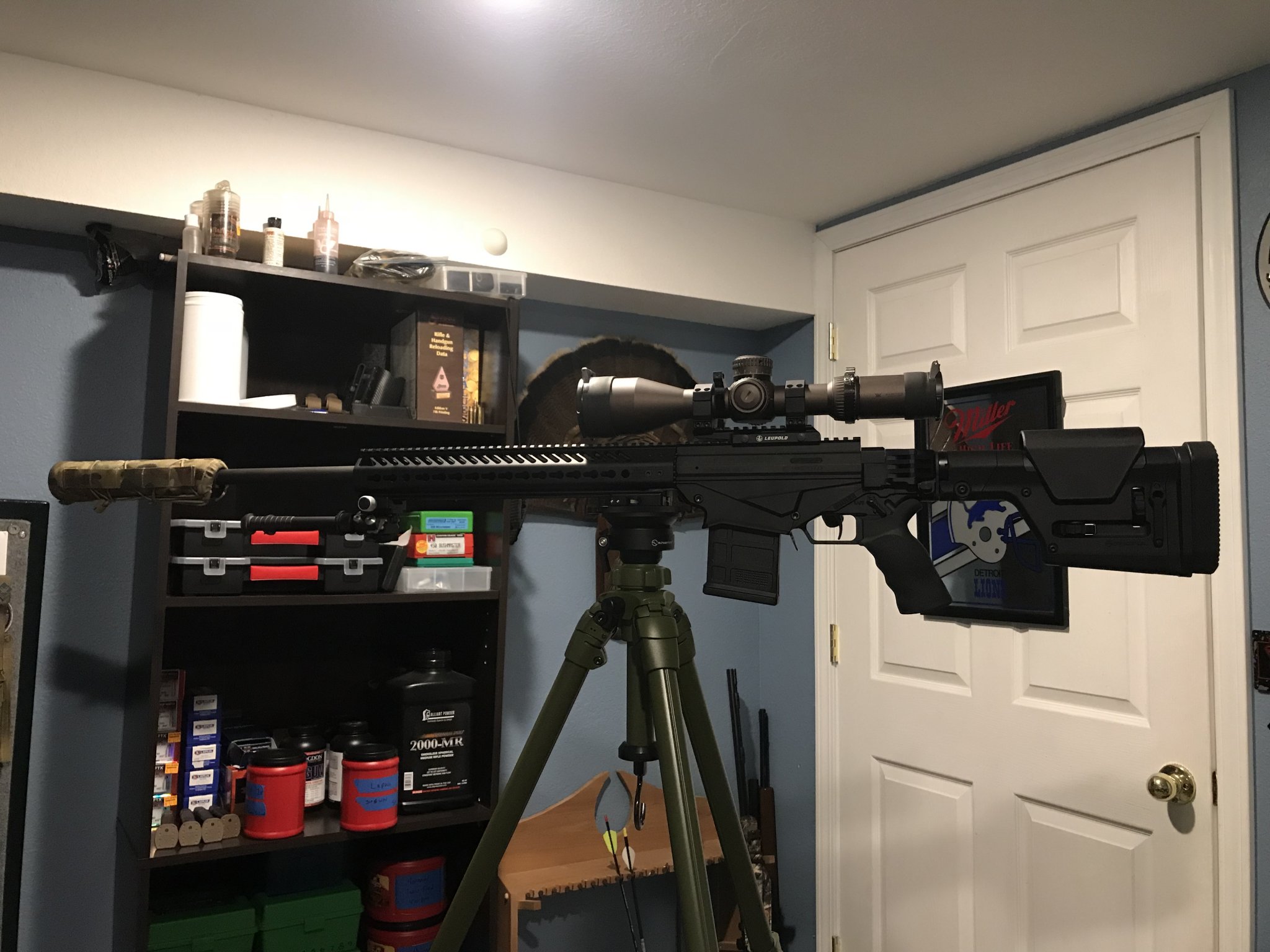

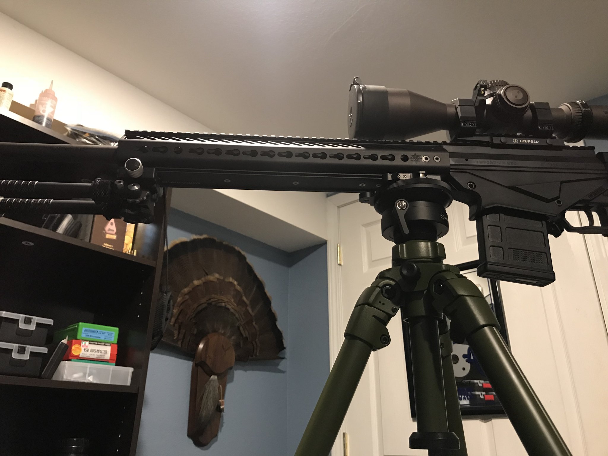

Sawtooth Arca/RRS Rail for Seekins is on point! The new RRS pro atals Mount is pretty legit too.
Thanks, it be appreciated. Am guessing your accuracy didn't get worse? Am familiar with the velocity loss, which is not a concern for this application.
I get ~0.4 from my 110gr prairie dog load, so I think the accuracy is fine. Effectiveness? I shoot along side a 6.5 RPR, and I can hang on a calm day out to say, 1100. Any wind though and 800 is pretty much it.
That said, 308 kicks a 6.5’s ass with subs, and I love subs. Trailboss is money.
I will eventually do the same to my 6.5 RPR.
I would love to see a pic or two of your rifle if you're willing to post some.

Interesting. What's your subsonic load for the RPR? What's it weigh with the shorter barrel? I have a Gen 1 and considered hacking it back to 16", as I never get beyond 800yd these days.
I want to say 9.6gr? of trailboss under a 190 custom comp, LC brass and a BR2.
Not sure on the weight, I want to put an XLR stock on it soon which will drop a few oz, plus when the barrel is toast a 16” Proof in 6.5x47 will probably get screwed on.
Just want to add, I personally hate unsuppressed shorty braked 308s so I’d only recommend doing this if you have a can. Never shot my rifle once unsuppressed, and don’t plan on it.
