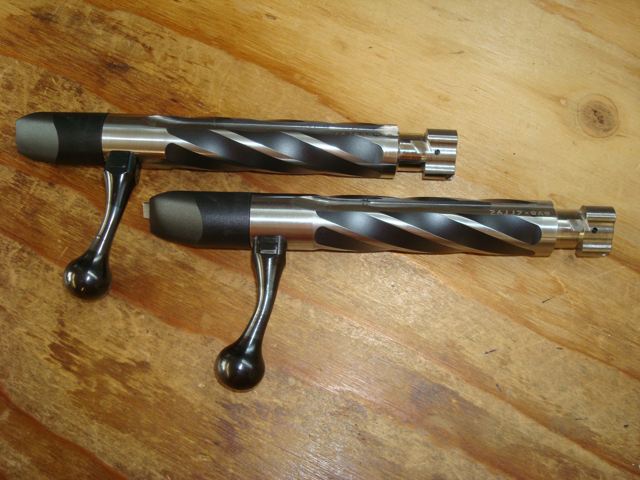

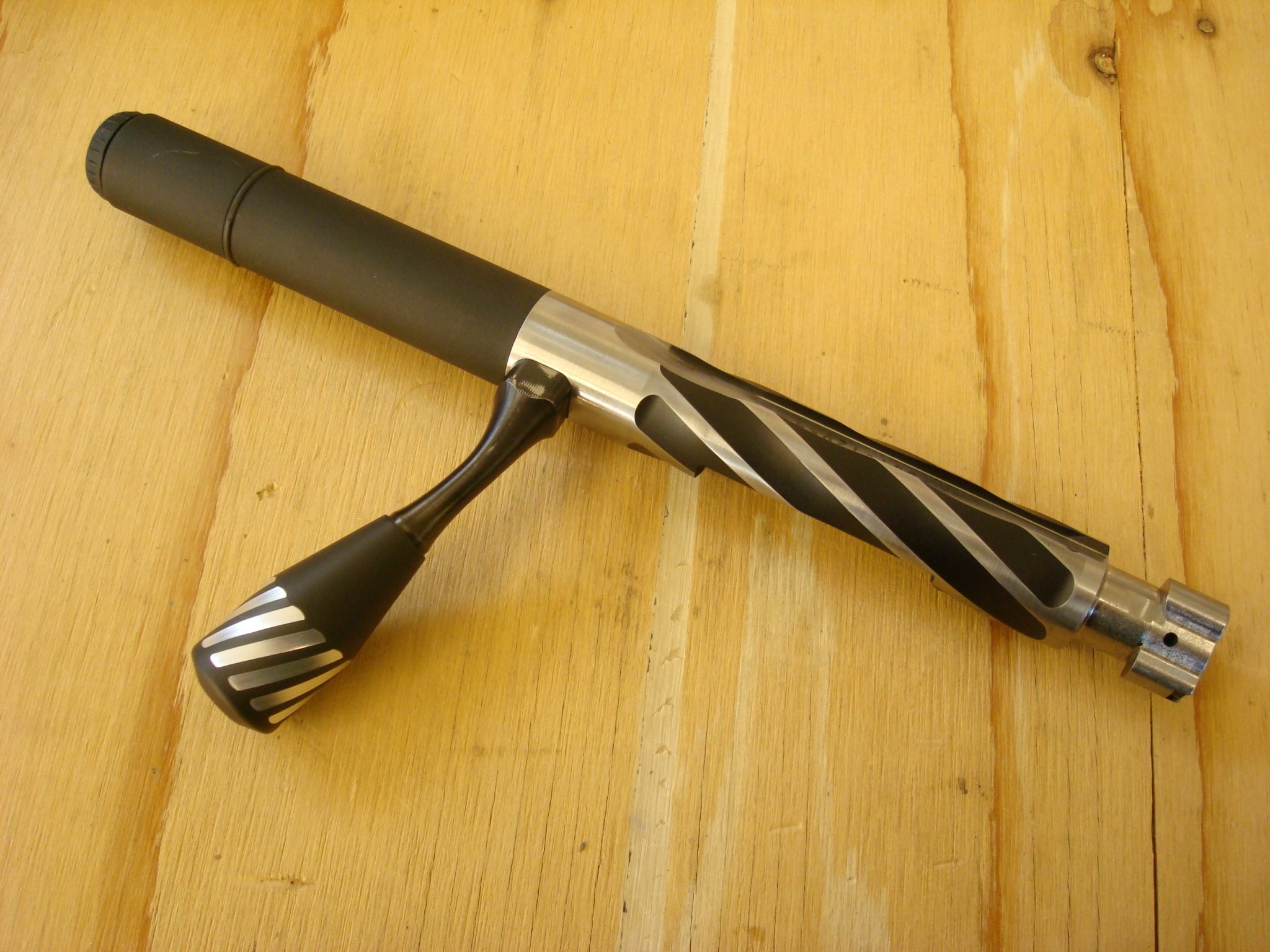

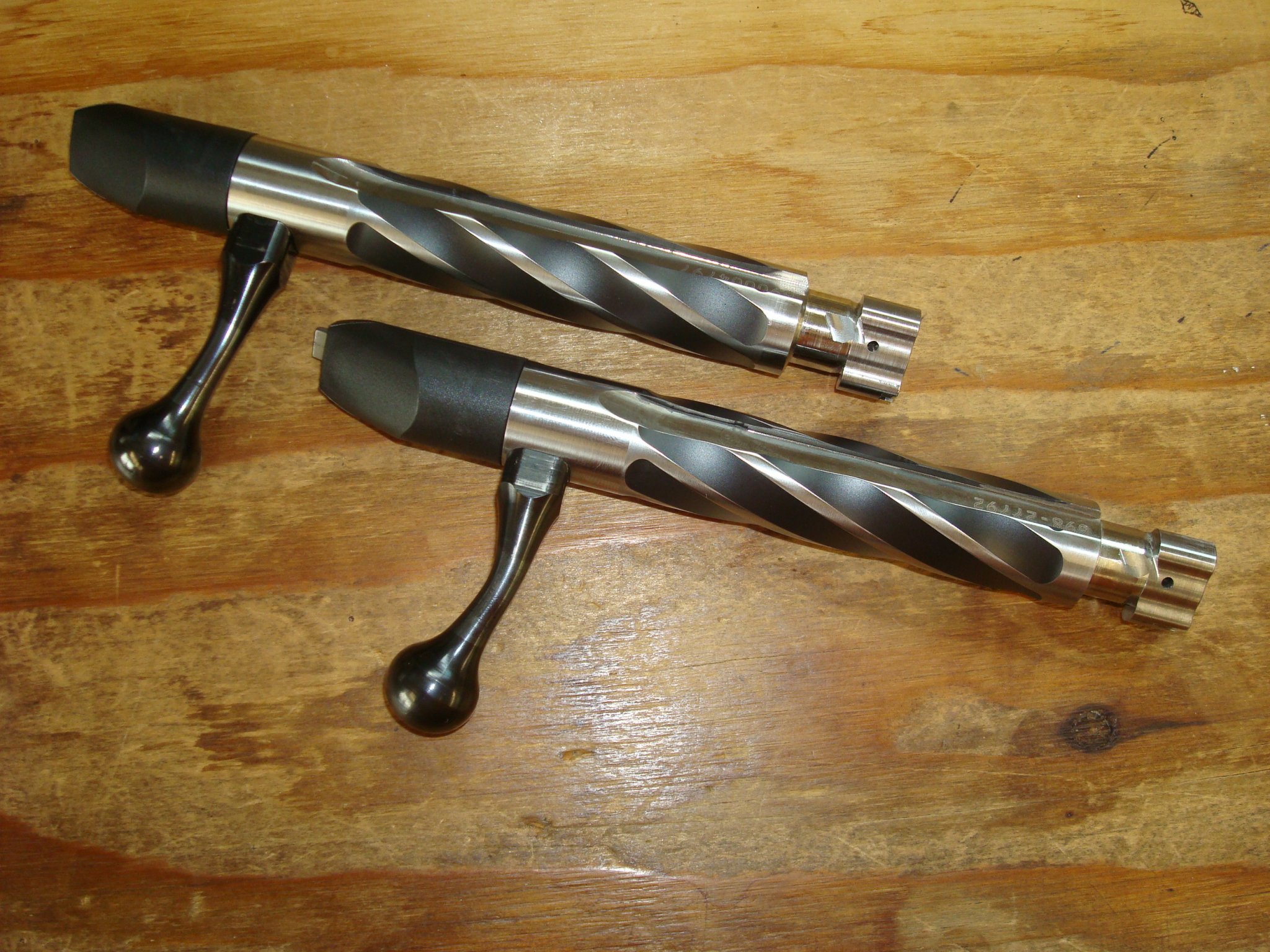

Guys,
Here you go. I have done quite a few of the RPR bolts and Ruger Ranch Rifle bolts.
Thanks for checking them out.:cool::cool:
Paul
www.boltfluting.com
