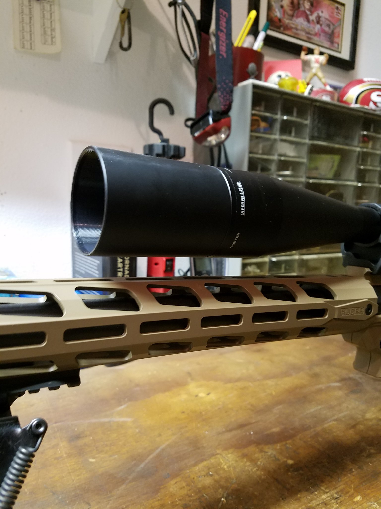

I have a carbon fiber (loose basket weave style). I just couldn't stand the weight of the metal fore ends or the sound they would make whenever rubbed in the brush. I really like this carbon fiber fore end, the link is below.
https://brigandarms.com/
Did it make a noticeable difference on the rpr?
I'm thinking of getting one for my AR but wasn't sure if it will be a totally noticeable difference in weight
It did for feel but I didn't weigh the difference. Beside I've more than put the weight back on with a heavy stainless can from SEG, a Burris Eliminator III LRF scope and bi-pod. May swap the bi-pod for a wheel barrel tire. I shouldn't whine, the lack of recoil because of the rifle weight is a real plus. It shoots like a rimfire. When I first got it and before installation, I was concerned it wouldn't hold up to rough handling. I've had it more than a year and it has held up very well. I'd buy it again.

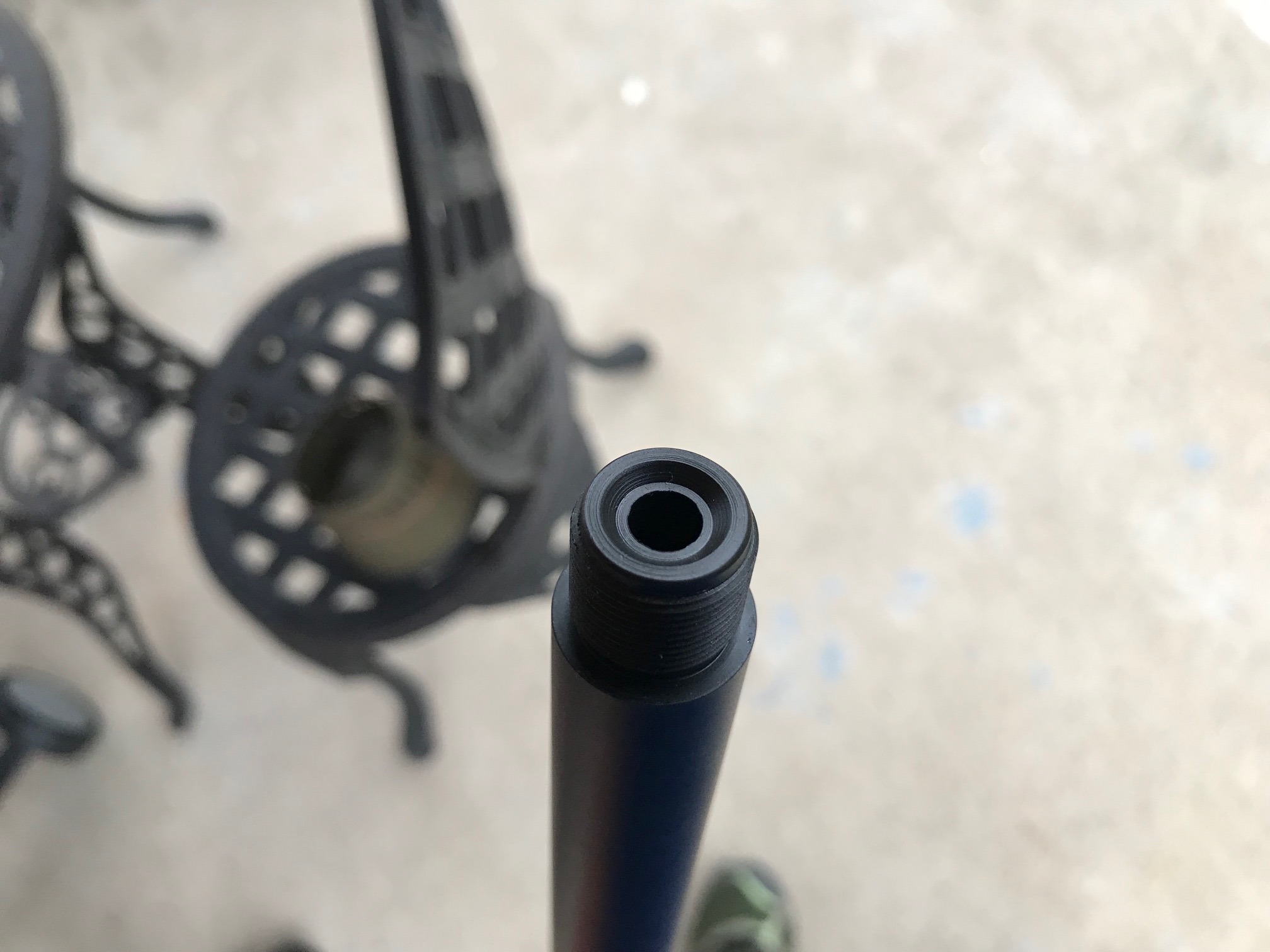

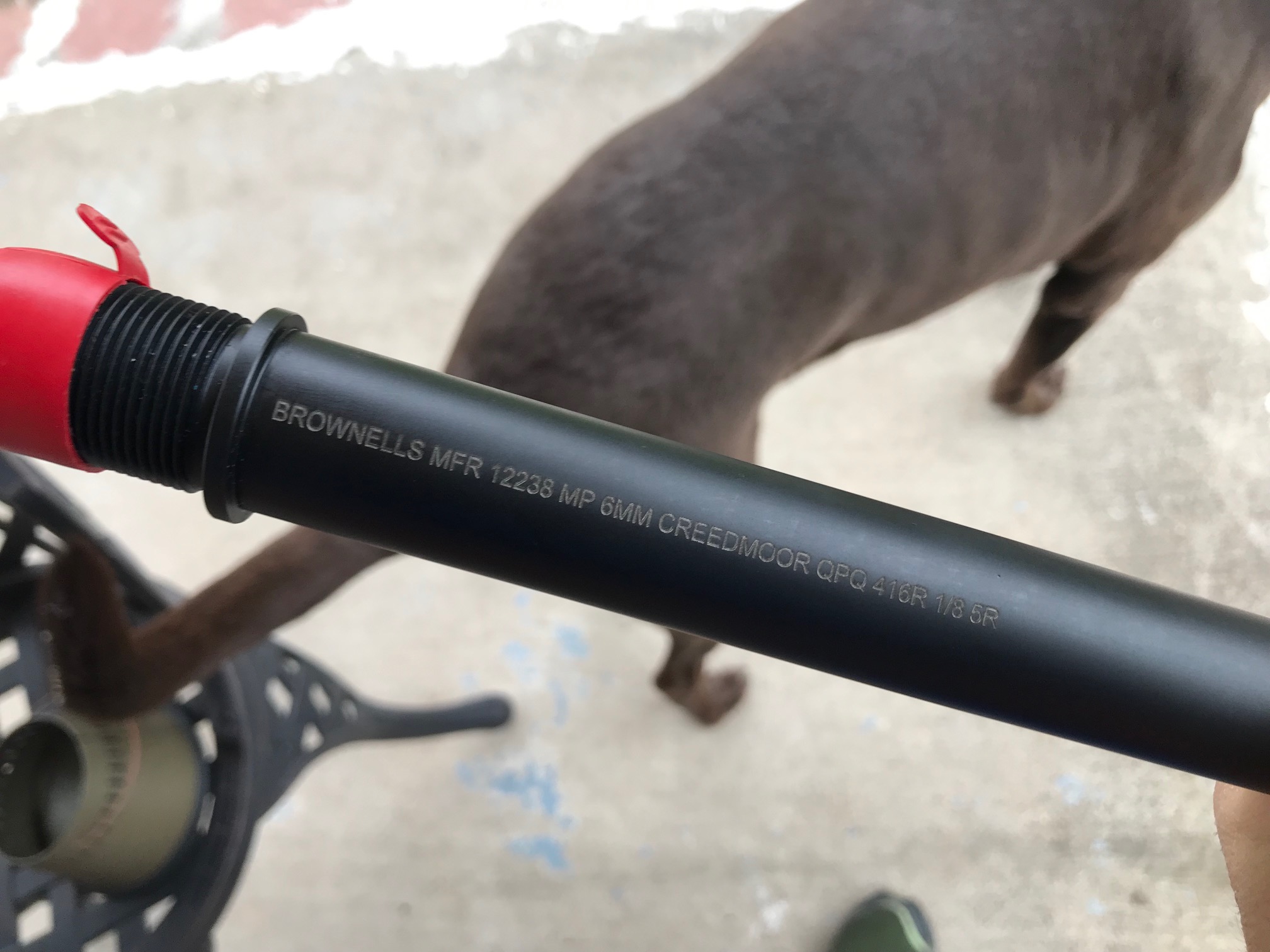

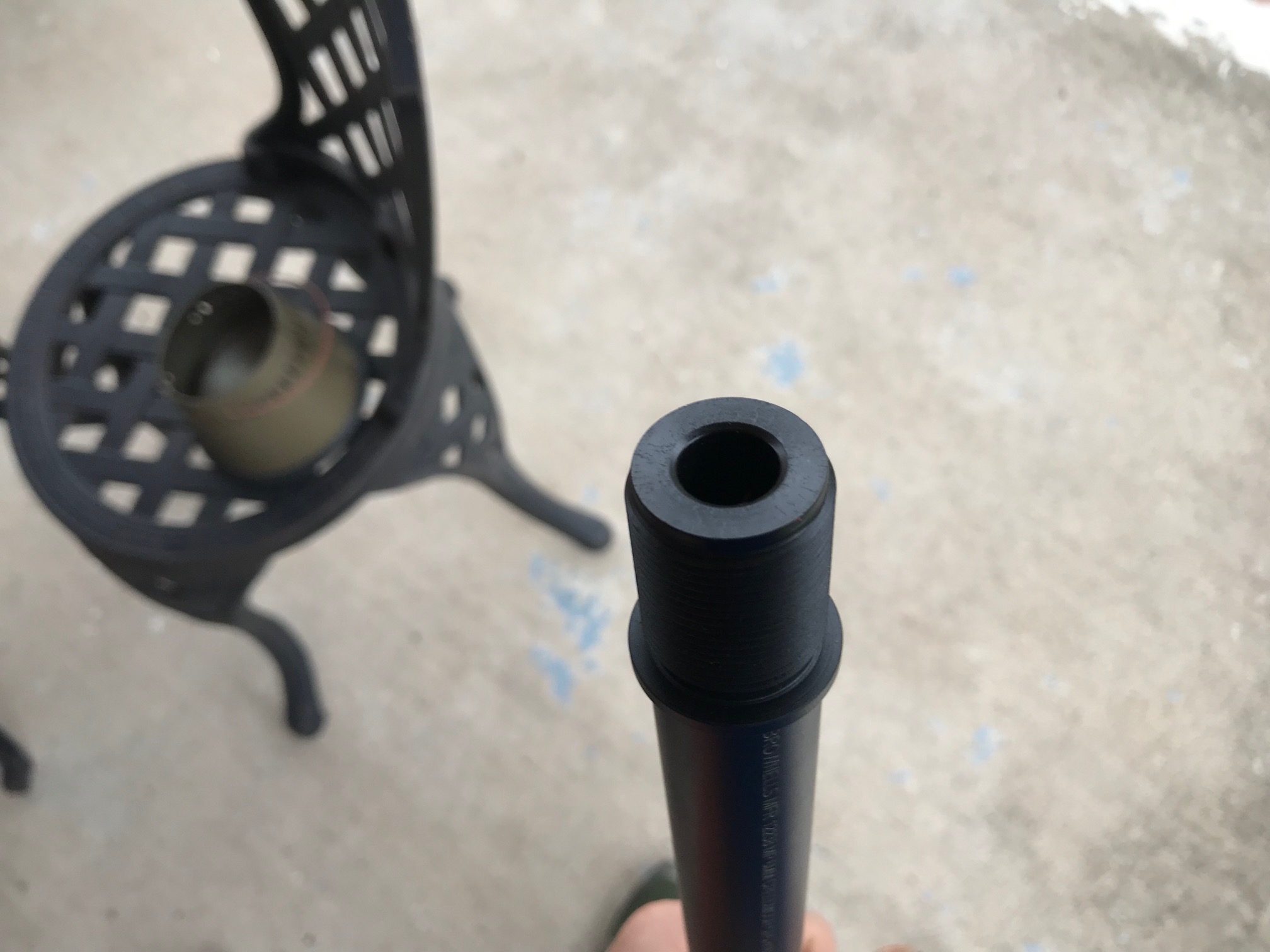

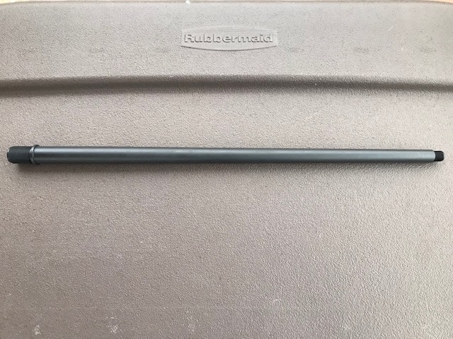

Got a 24" Brownells 6 Creedmoor barrel in. For those curious, the barrel diameter at the muzzle end is about 0.751", middle 0.901", chamber end 1.00".
I need to borrow some go/no-go gauges and I'll be set. Hope I can develop a good load for it. If it blows, back it goes..
Reactions: Mountainbum
