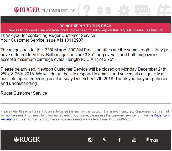

I am thinking about a RPR in .300WM and couldn't seem to find an answer to the factory mag max COAL - so I asked Mother Ruger. Here is the answer - sorry if it's already common knowledge. 3.75" for both magnum RPR's...

What I'm trying to figure out is if I can turn my 338LM in to a 300wm by doing a barrel, bolt, and mag swap? Or if I would need the whole upper?
I know a decent bit about the ballistics of a 338LM but this is my first one I've ever owned so I still have a LOT to learn. Plus specs on these two guns still seems to be pretty limited and I haven't found one in the "wild" yet in 300wm.
Anyone able to help me out with some knowledge bombs?

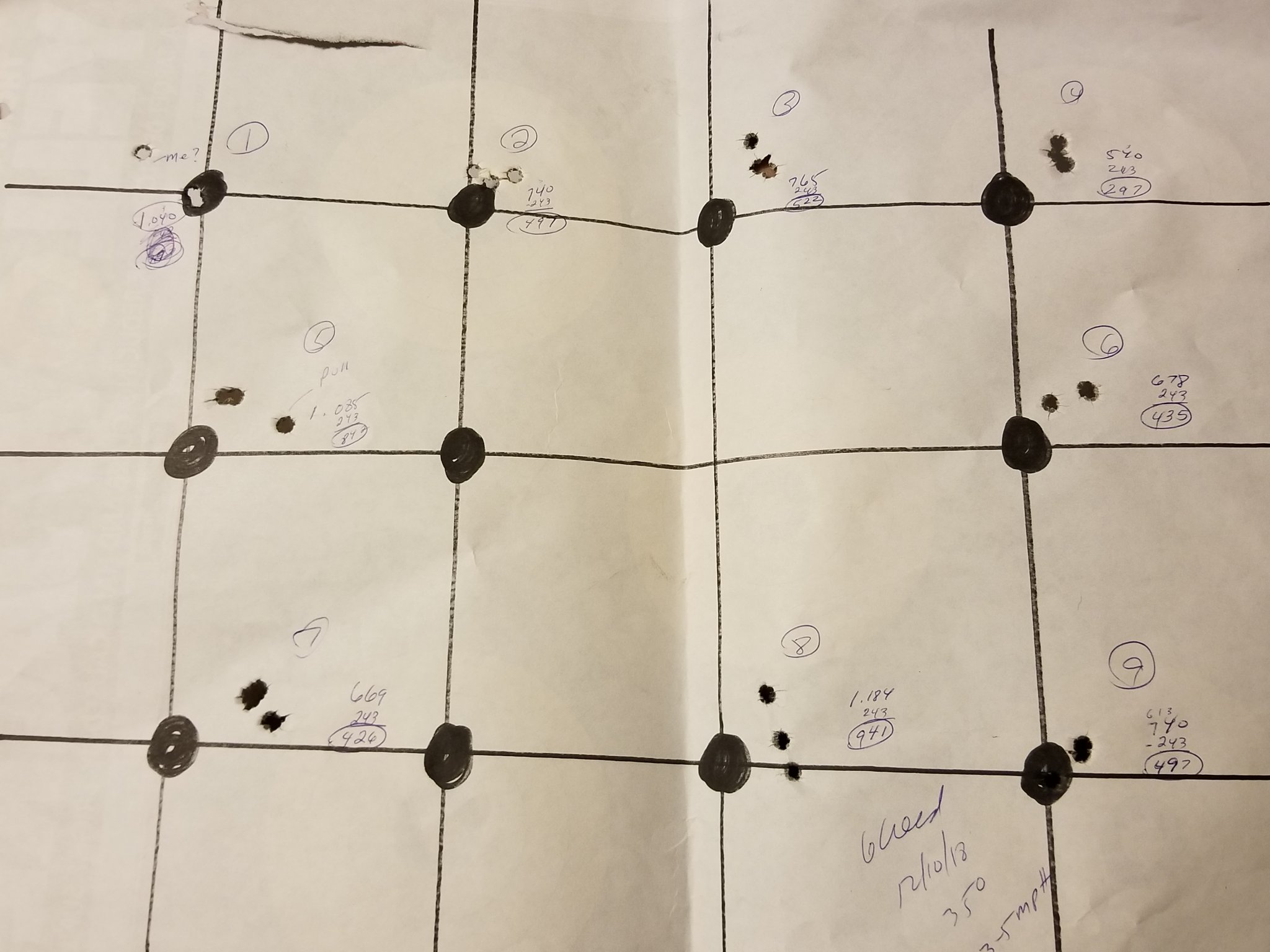

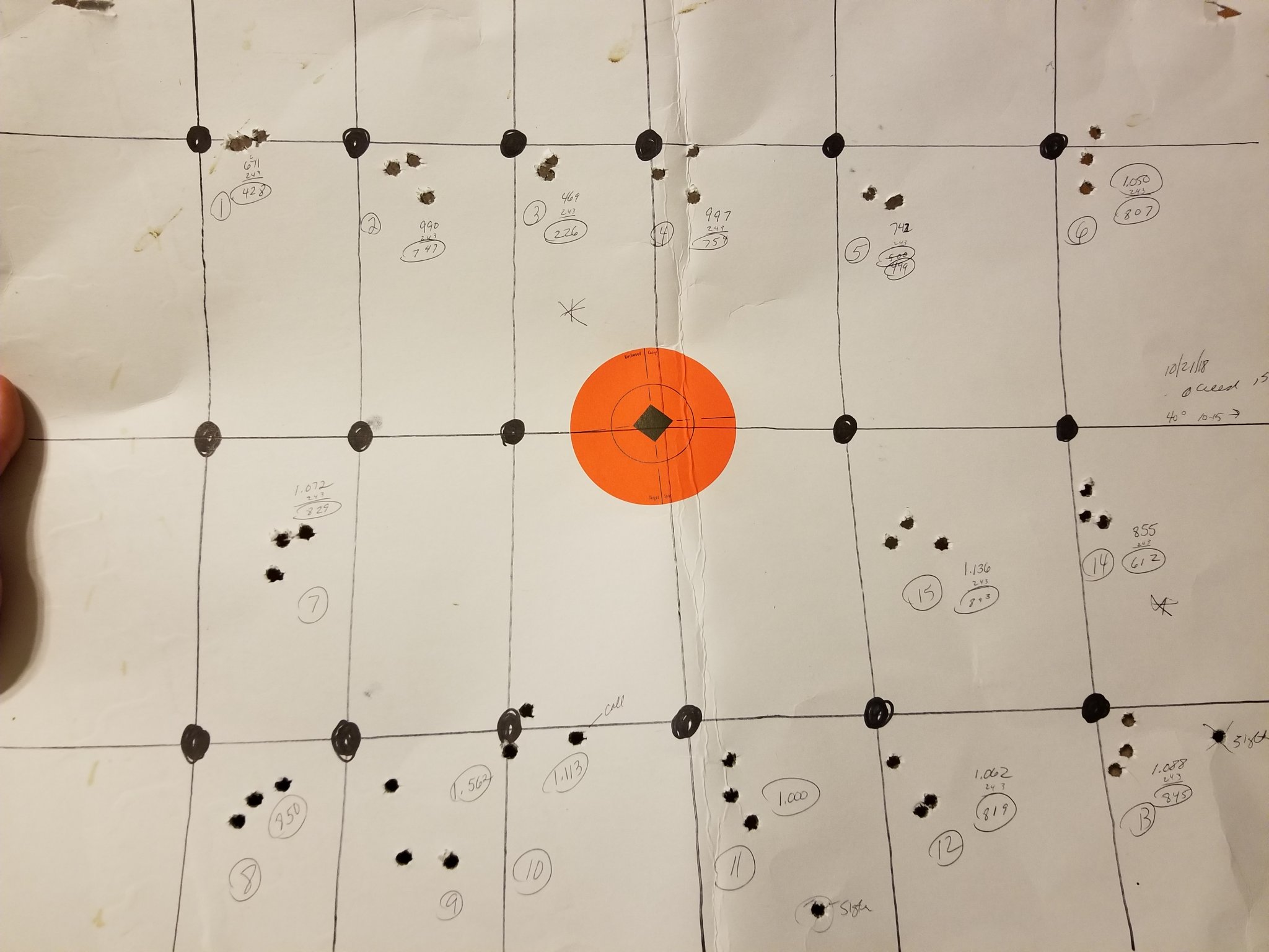

Just picked up my first Ruger RPR in 6mm Creedmoor because i found a great deal on this one. My original intention was to rebarrel to 6.5 cm because I didn't have any loading gear for 6creed yet. Setup is completely factory with a Leupold 8.5-25LRP, AAC SD 7.62. I bought 50 brass and gave it a try. All I can say is that I am impressed...
First target shot for load workup is above. Using Hornady 105 bthp and h4350. Showing a node at load #3 which was h4350 38.5 gr. Not looking for speed just sheer accuracy.
Below is the next set of targets out. Replaced scope with a Leupold 8.5-25 LRP. Again showing the node at 38.5 gr. The pic below that is with Sierra 107s and h4350. Found the magic juju with this combo. The groups are tight, little vertical and the node is wide. Shot this target 30 degrees aff sandbags. No chrony this day. Just too cold.
Can't wait to get it back out. Sticking with the Sierra's now. Bottom target is 39, 39.5, 40, and 40.5 great h4350, win primers, Hornady brass 1x at 2.790 coal.

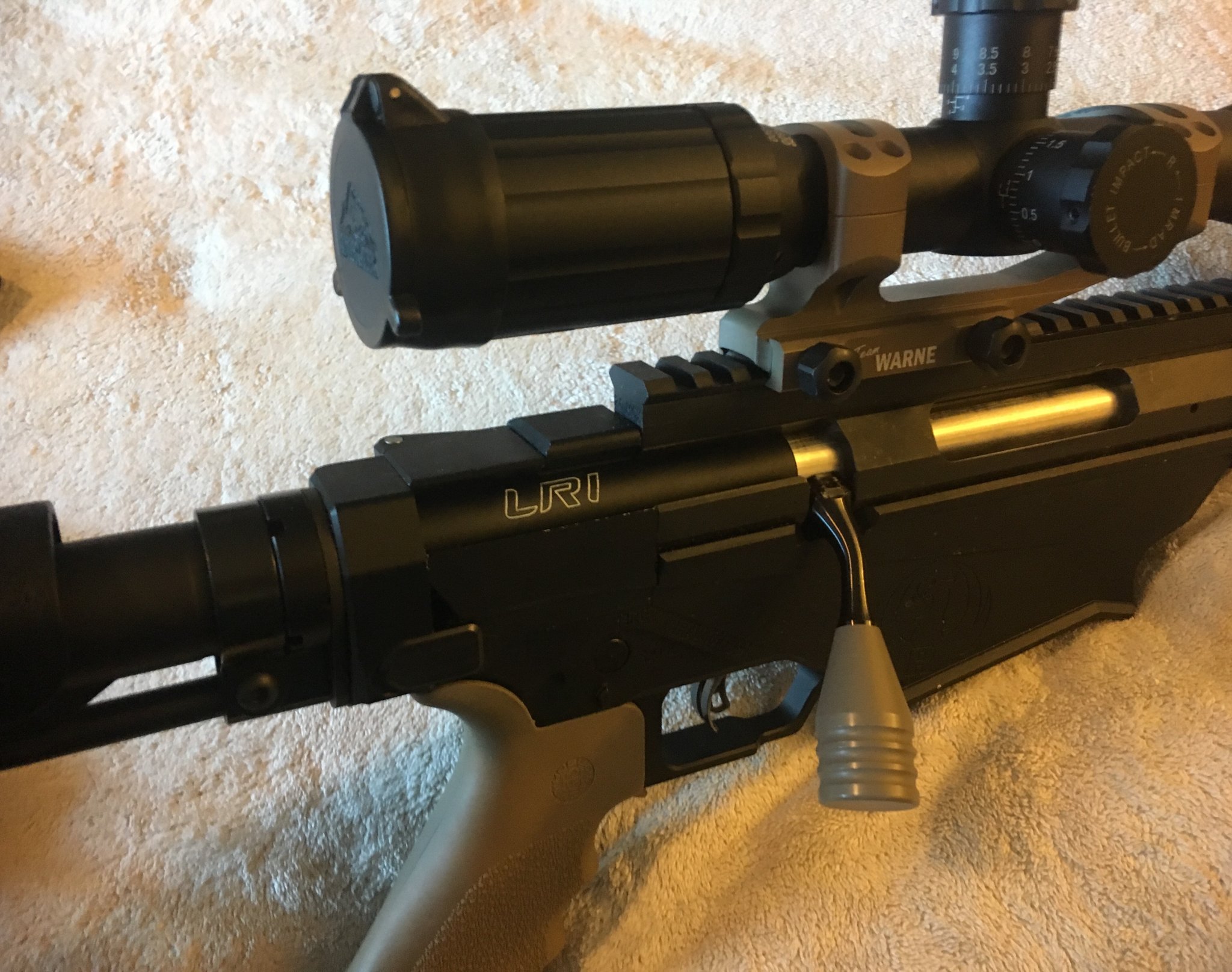

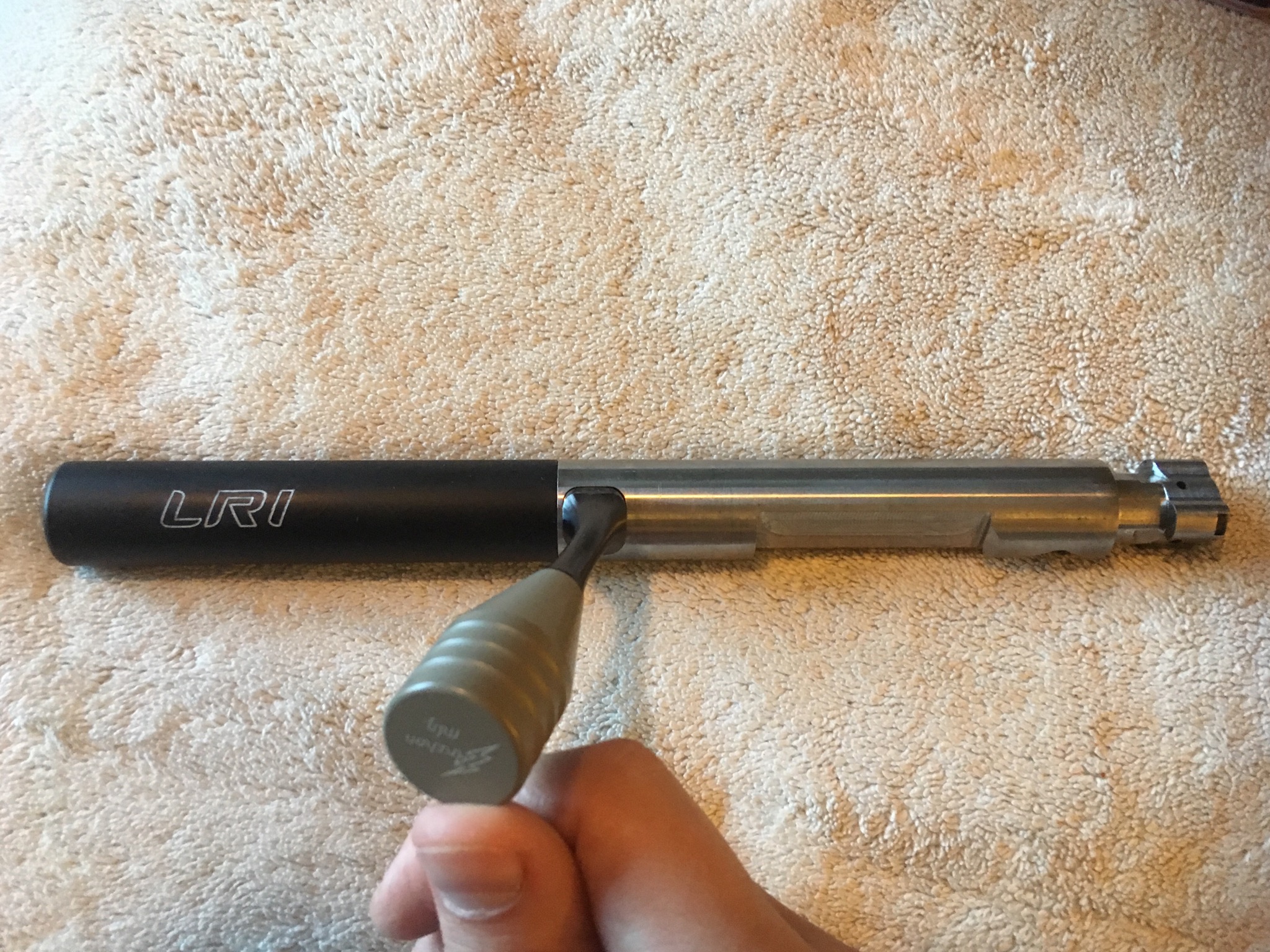

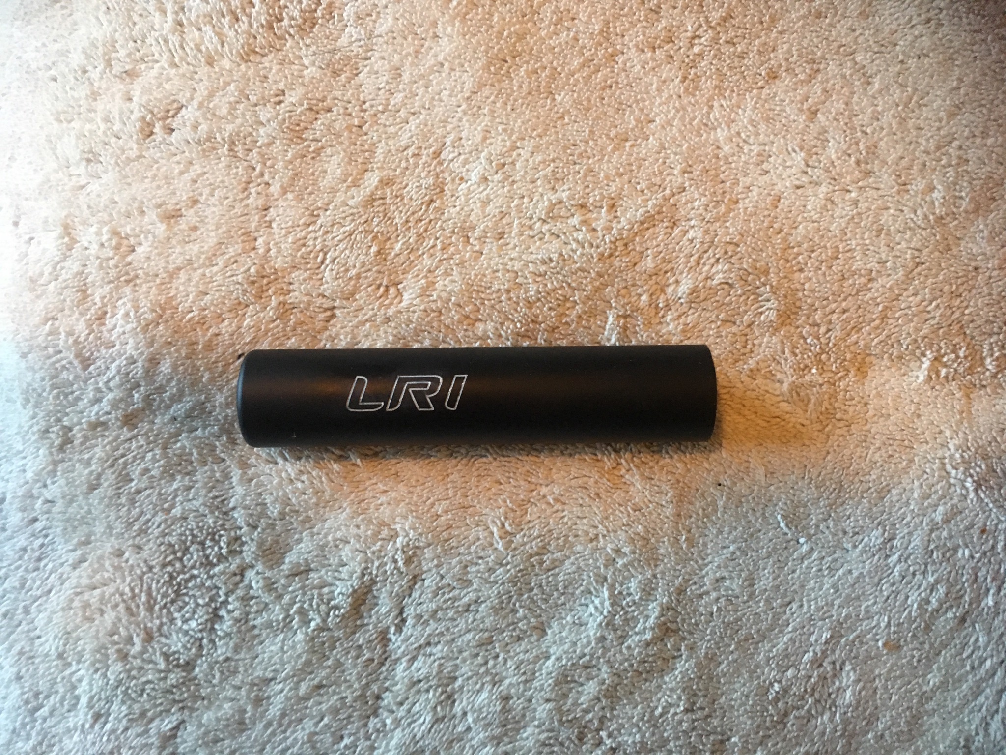

Oh also I’ll add that I know LRI has a similar shroud. But theirs is glossy and I wanted something flat. Also a new LRI shroud from them is $60 plus shipping and the cerakote job on my existing one is $20 plus shipping. So, that was my reasoning

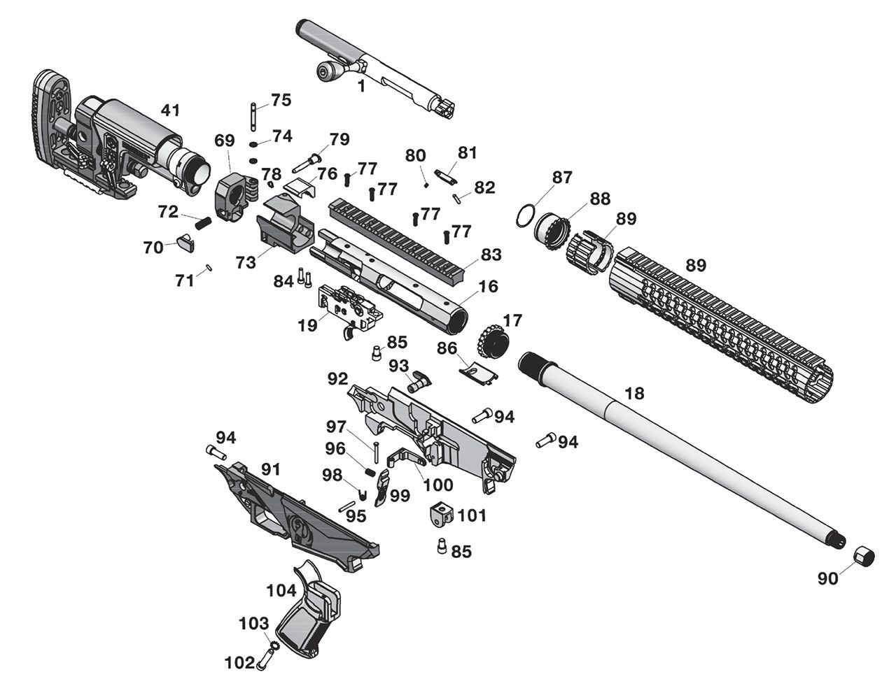

Hey all. The part shown here as number 86, the one that has tabs that hold on the the barrel nut.. For me and my purposes, it doesn’t seem necessary. Can I go without it? If so, I can swap barrels even faster due to the breakdown.
