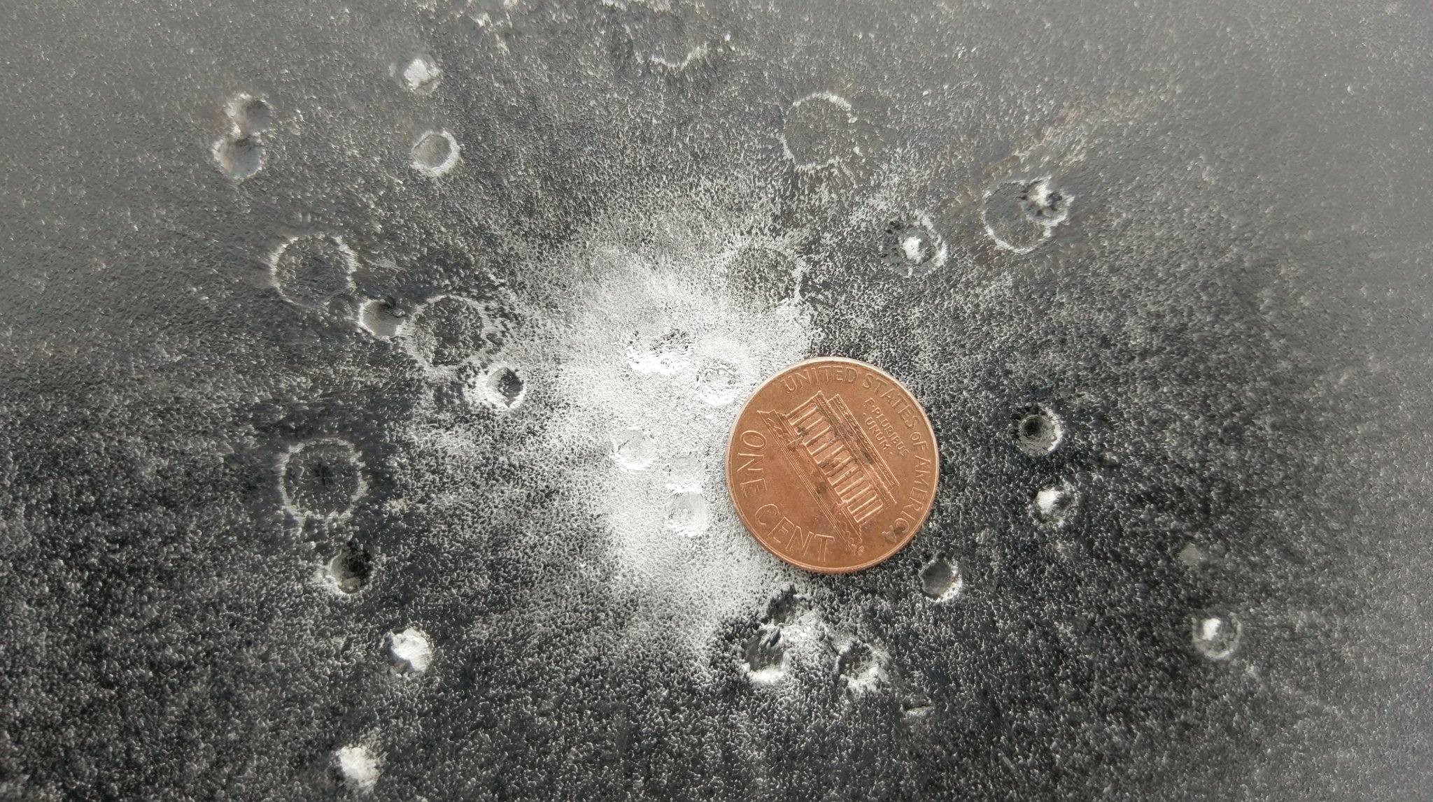

Went out and set-up in the BLM and the weather cooperated for a little while. Got a good first group after zero on a 12" plate with match ammo. Need to remember paper targets and a stand next time. I went ahead and purchased a Nikon Black RangeX 4K so I could do a better 100 yard zero in the open desert.
RPR 6.5 Creedmoor
Hornady 147g ELD-Match Factory Loads
5 Rounds @ 100 Yards
50 Deg F
25% Hum
5200 Ft elevation
~5-15mph variable direction wind
Front: Atlas Bipod / Rear: Weibad Range Cube
Folding Chair & Table, Wobbly
Penny fully covered all 5. I was pretty excited by this group, but I'm very new to precision rifles. Been mostly into pistols and infantry type bolt and semi-auto rifles up until recently.

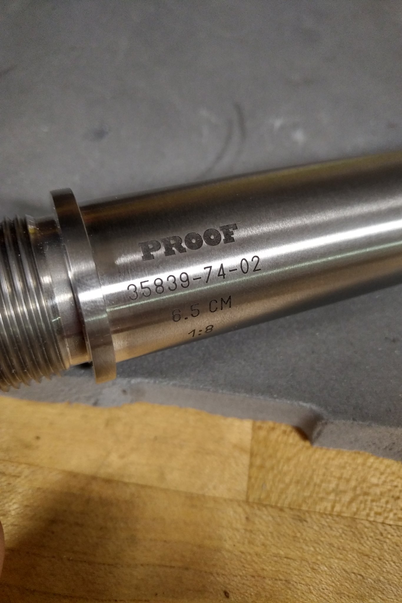

I just picked up a profit Proof M24 profile barrel, 24" from Stocky's on sale for $436 + shipping. Just got done cleaning it and I'll be screwing it on this week. Got a APA Lil' Bastard on the way as well.
https://www.stockysstocks.com/barre...-stainless-ruger-precision-rifle-barrels.html
After a couple emails back and forth about bullet choices and total headspace recommendations with Proof (prompt responses), I'm confident it will definitely outshoot me...

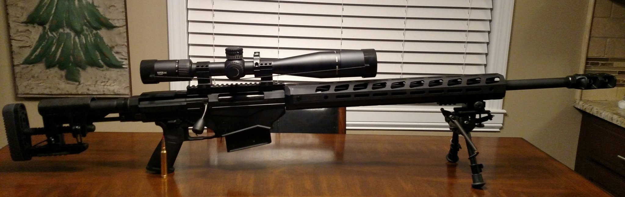

I just picked up a Ruger precision rifle in .300WM. I'm going to load up the following:
225gr ELD Hornady bullets
H1000 (75.9g to 77.1g in .3g increments)
Win Brass. 93g h20 capacity
GM215M Primers
Seated .025" from lands (3.621" COAL)
Vortex viper PST gen2 5-25.
I went through the rifle and torqued / loktited rail and handguard fasteners. Torqued receiver to spec as well.
Seems like a very robustly built rifle. Much more stout than the original RPR gen ii. Trigger feels great too. Must be a tight chamber/ headspace since FL resized brass from my Rem700 wouldn't allow bolt to close. New brass no problems.
The latest American rifleman article had it printing .73 MOA average of 15x5 shot groups with 3 different factory ammo so I'm hoping for a little better than that with handloads. Don't know when I'll be able to break it in but looking forward to it .
https://www.americanrifleman.org/articles/2018/12/19/tested-magnum-length-ruger-precision-rifle/
The new rifle:
