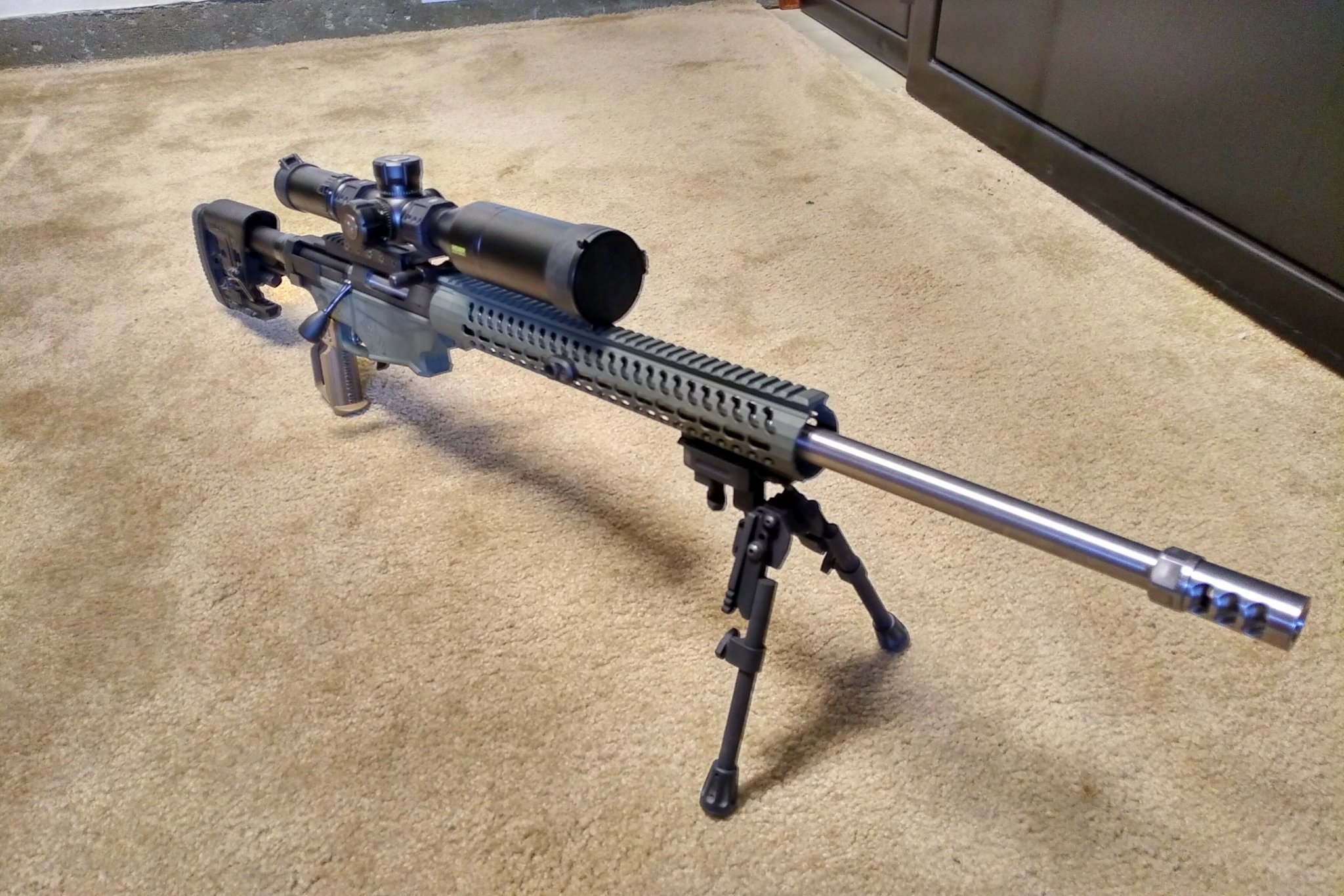

Just fitted a 6.5 with a Proof Research 1:8, 24" M24 Contour pre-fit barrel. On the end is an APA Little Bastard.
The green is rattle can. Grip is Anarchy outdoors. Lefty. What can I say? I'm classy like Coors. It's a RPR, not a fancy shmancy AI or Surgeon ??
Consequently, I have a RPR 6.5 Creedmoor barrel with like 550 rounds through it sitting around. LOL
I bet she'll shoot a keg at click all day.

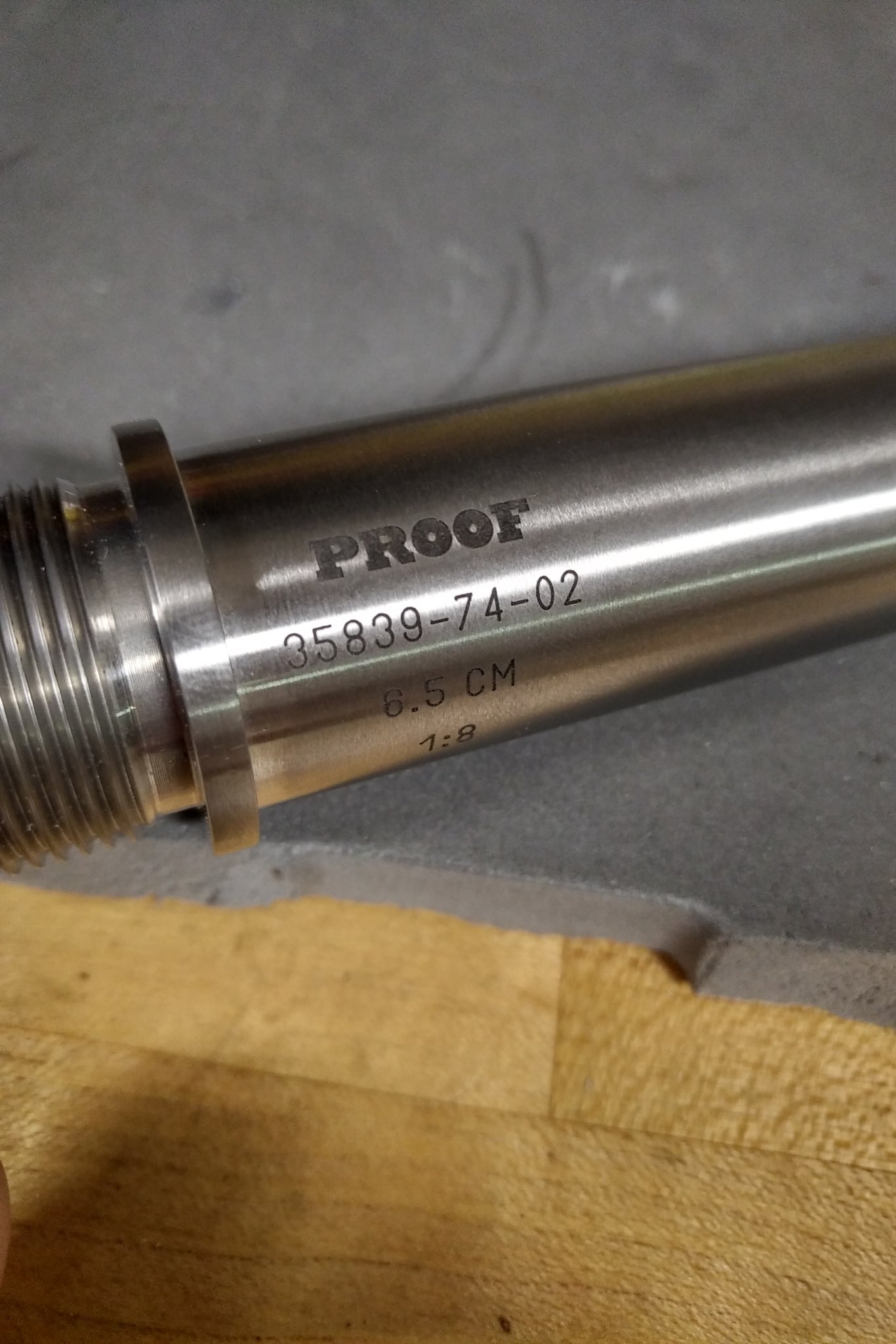

I just picked up a profit Proof M24 profile barrel, 24" from Stocky's on sale for $436 + shipping. Just got done cleaning it and I'll be screwing it on this week. Got a APA Lil' Bastard on the way as well.
https://www.stockysstocks.com/barre...-stainless-ruger-precision-rifle-barrels.html
After a couple emails back and forth about bullet choices and total headspace recommendations with Proof (prompt responses), I'm confident it will definitely outshoot me...

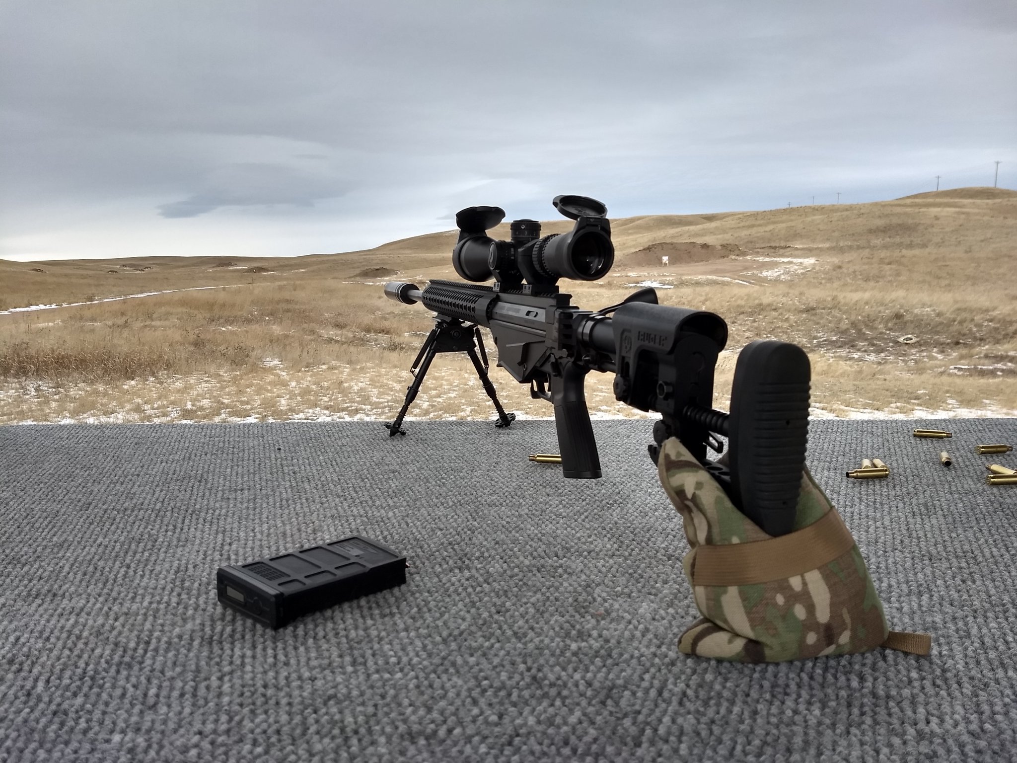

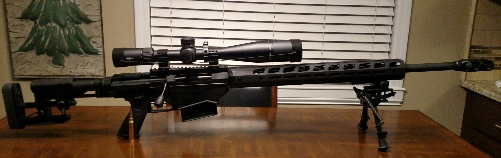

Token picture of my bone stock Gen 1:
Second round hit at 1,020 yds the other day, not bad for a factory rig and shifty wind.

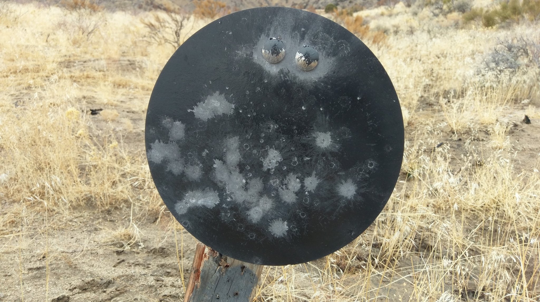

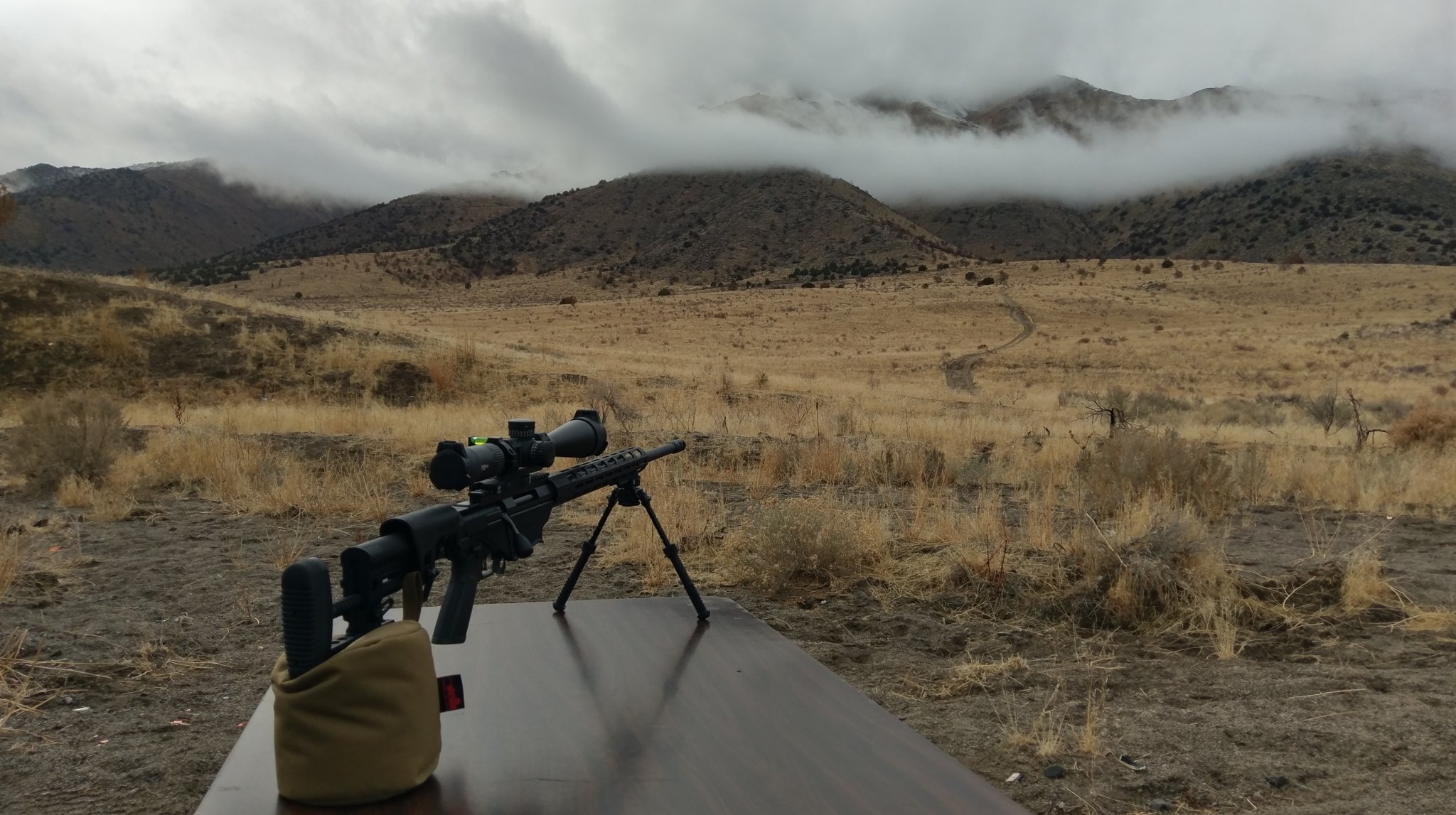

(This post is mostly centered around my RPR, but if it is in the wrong Forum Section, please let me know.)
It took hours of exploring but I finally found the correct area in the BLM public land area near my house that everyone apparently shoots at. I was wanting a long shot capable area, and boom! This hillside ranges out past 1,000 yards, with a dead-end jeep trail along the left side for relatively easy target area access.
RPR 6.5 Creedmoor Gen 3 (Stock)
Hornady 140 Grain ELD-Match Factory Loads
537 Yards
12" Steel Plate
10-15 mph Variable Wind
Missed 1st shot high/right with Hornady 4DOF App calculated dope (not blaming it, I was very much guessing on the wind). I'm a Long Range newbie so I'll chalk it up to luck, but based on the hill strike and using the reticle, I adjusted once, and next 9 shots were on the plate! I almost packed up right then...
Instead, I took a break and shot my new Ruger Mark IV 22/45 Tactical. Fun little pistol! It will be an excellent host for the Dead Air Mask, my first can! :D (In Jail) :mad:
After the interlude I didn't think about it, but the wind had died down to nothing. Went 0/6 while adjusting (fumbling with) the windage. Seventh shot hit, then 23 more straight hits to finish the day!
I am now officially having Long Range fun. Total: 33/40 hits
Pushing out to 750 next time!
(FYI, I partially demolished the 2x4 under the plate with my M1A yesterday. Tried it at 250 yards with iron sights from my "car door rest" :LOL:)

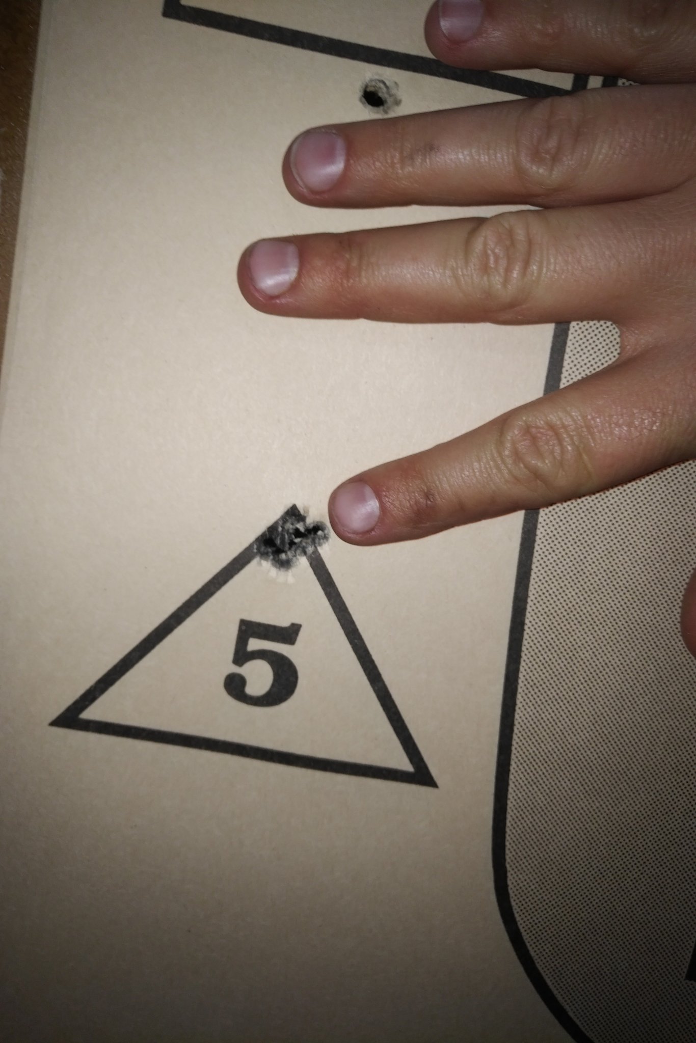

Barrel: Proof Research all-stainless 24", M24 profile, RPR Pre-Fit.
Brake: APA Little Bastard
Installer: Me.
Headspace: set to Minimum +.003" as recommended by Proof.

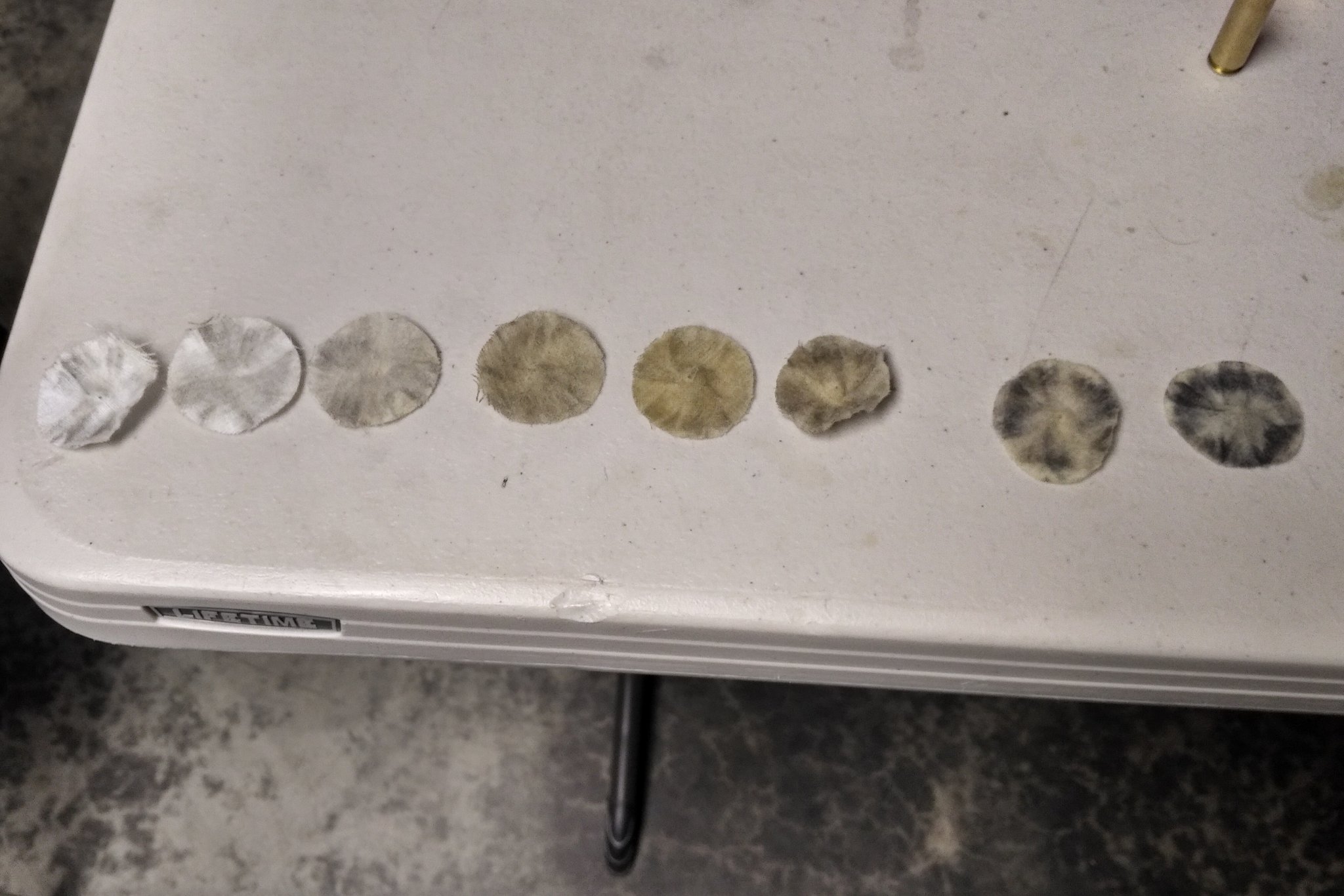

Just did the 3, clean, 3 clean, 5, clean break in as recommended by Proof Research. The cleaning patches after the final 5 rounds came out looking like:
All ammo fired was 6.5CM Prime 130g factory ammo at 50y indoor range, sitting, from a bipod with just my hand supporting the rear of the stock on a cheap folding table that already collapsed once. Final 5 round "break-in group" looked like:
