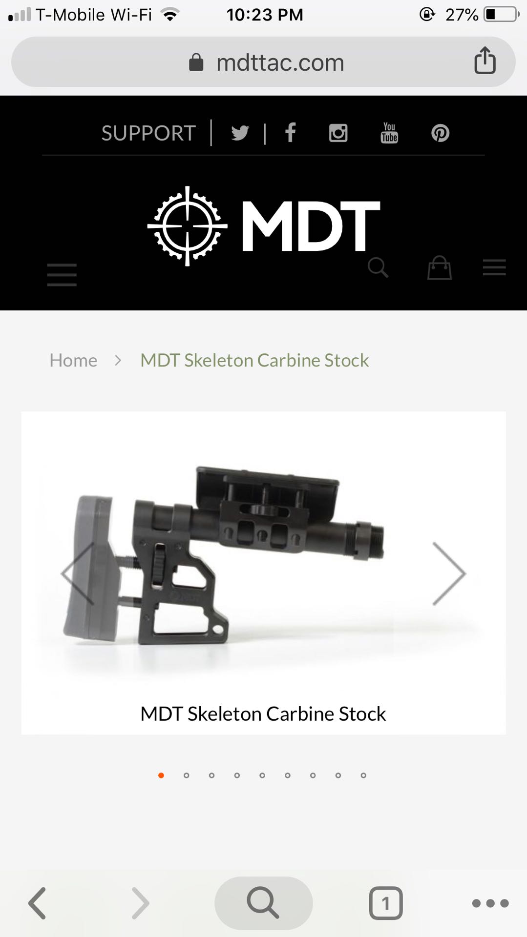

It will be a bit challenging to run the bolt with that stock installed on your RPR.
Has anyone tried out one of those stocks? As far as I know the bolt shroud isn't necessary. You could run the bolt without it or probably use a Ruger American bolt shroud. There would still be some area need behind the folding mechanism but I'm wondering if those stocks may have enough room.

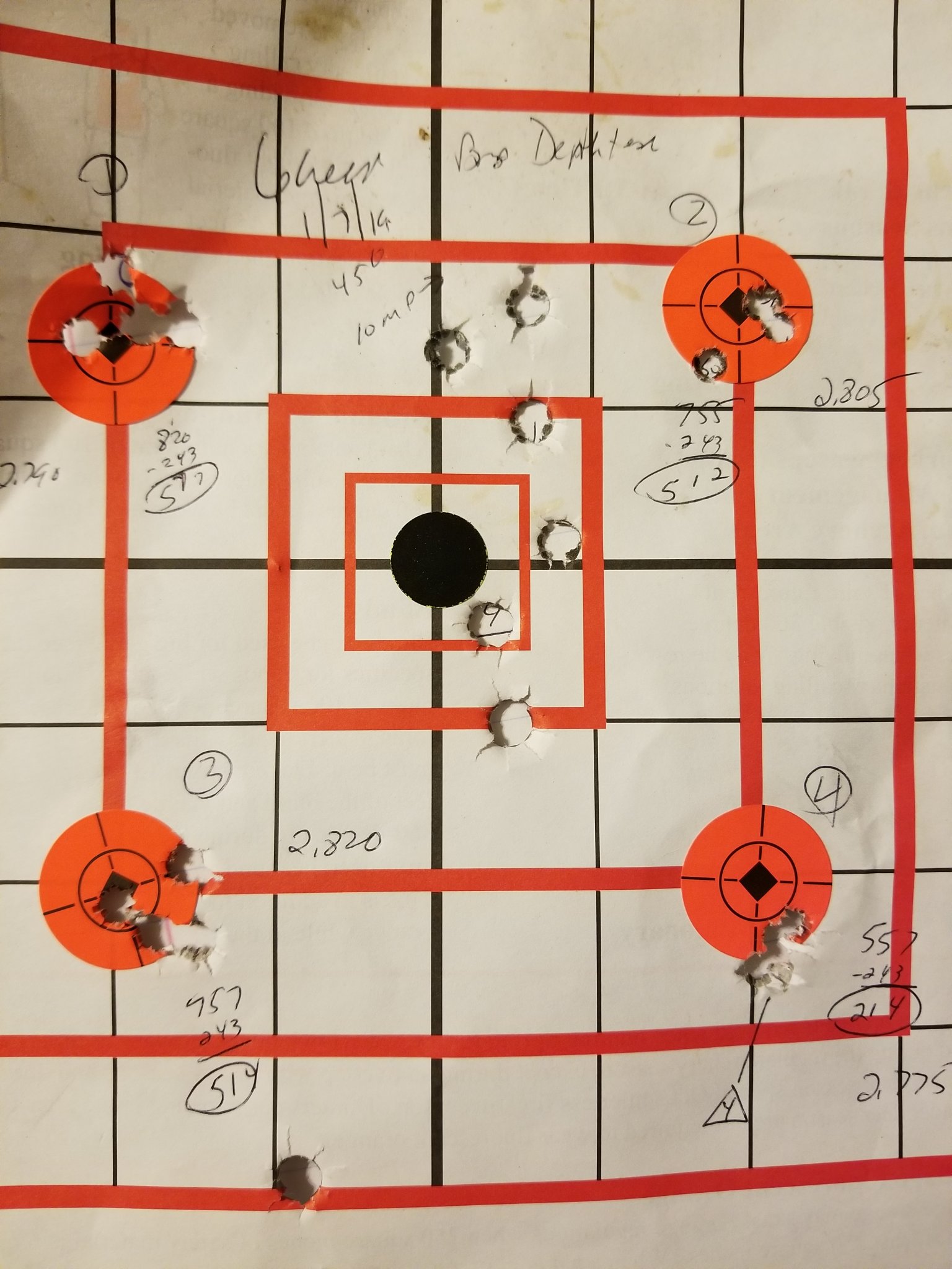

I picked up a RPR in 6mmCM this week. 60 rounds down the pipe. Using Lapua brass, GM205MAR, H4350. Ladder testing at 300 yds. Best load for 107 Sierras seems to be 42.5 gr. (2984fps with SD 6) 0.8" and 1.0" 3 shot groups at 300 yds, also shot a 3.25" 4 shot group at 610 yds. The 115 Bergers are also doing well at 0.5 MOA for 3 shot groups at 300 yds, best load so far 41.0 gr. (2800fps) 0.9" 3 shot group. The trigger was 2 pounds but gritty at first but seems to be smoothing out as more rounds are fired. Thank you Sportsmans Warehouse for taking my $680.

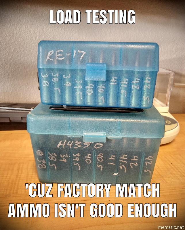

Got my load testing rounds all loaded up for my Proof 24" M24 Prefit barrel. We'll see how they go. Reloder 17 and H4350
Who ever groups the best wins! I'll figure out velocity later LOL. Plus, it's always good to have a couple pet loads for when one powder runs out and unable to resupply. I may do another with IMR 3031 or 4064. Had great luck with those when I was doing 308.
Prime Brass
Norma Golden Target 130g pills
Remington 9 1/2 primers
Loaded to .010" off lands.

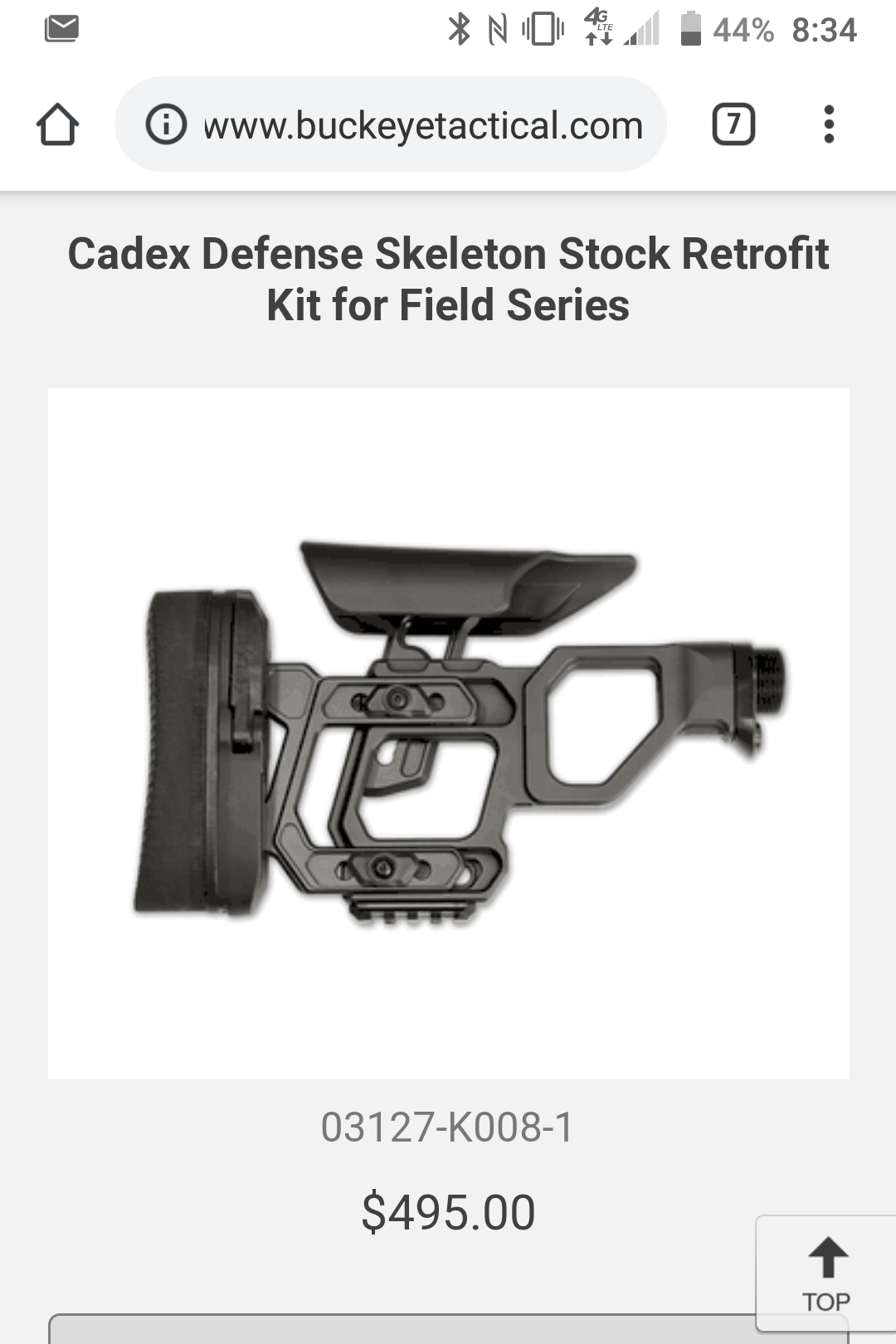

If you're like me and enjoy dropping $$$ on things because 'Murica.... Check this out. Totally gonna get this when funds permit.
Cadex Defense stock retrofit for your AR or RPR. Screws into the female threaded portion that accepts the buffer tube....
http://www.buckeyetactical.com/cade...eld-series-chassis-ruger-precision-rifle.html
Went to their website and couldn't find it now. Bummer or I just entered the wrong info... Your link worked though,
I brought it to their attention about the likely inability to run the bolt back/forth. They advised me they would contact Carex and confirm the compatibility with an RPR.... I guess you found out the answer...
They're a bunch of silly willy's and advertised a product for an application it wasn't designed for.

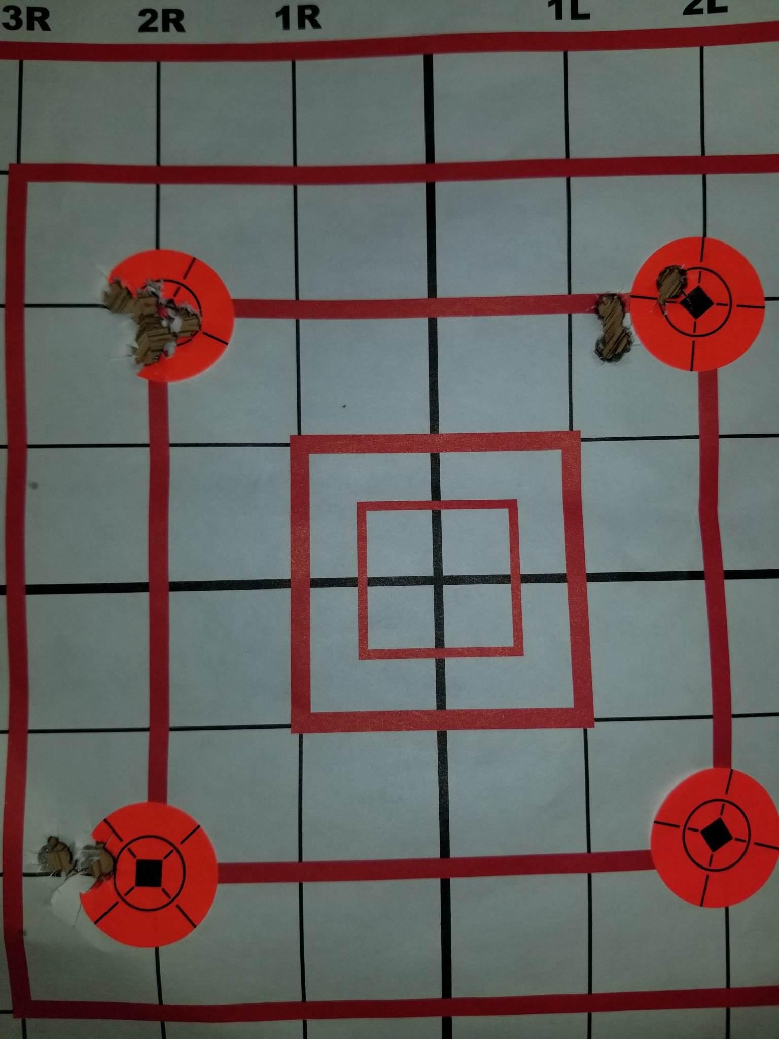

I don't have any DTACs but 115 berger VLD target ,Lapua brass, 41.0 gr H4350, 2.790 COAL, Federal AR match primer, 2890 fps SD 5. In my ladder test shot 3 into 0.95" at 300 yds. Took it to 610 yds with my last 4 rounds (no wind 6200 DA) was able to squeeze 4 into 2.25":love:. Flattened primers no cratering possibly the faintest of swipe marks, no hard bolt lift. I will not go any hotter. Gm205MAR. Love this RPR.
