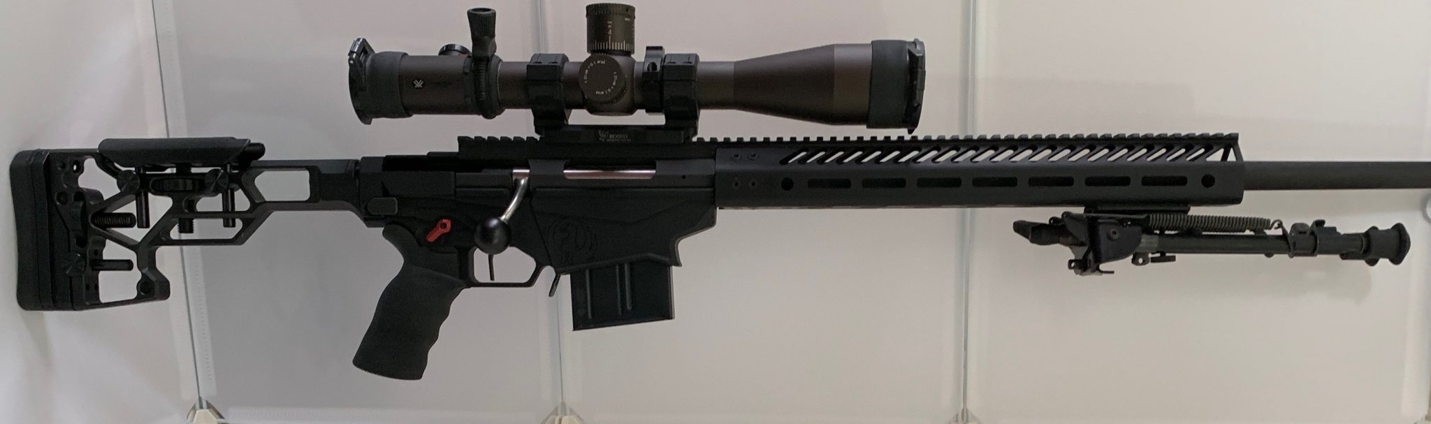

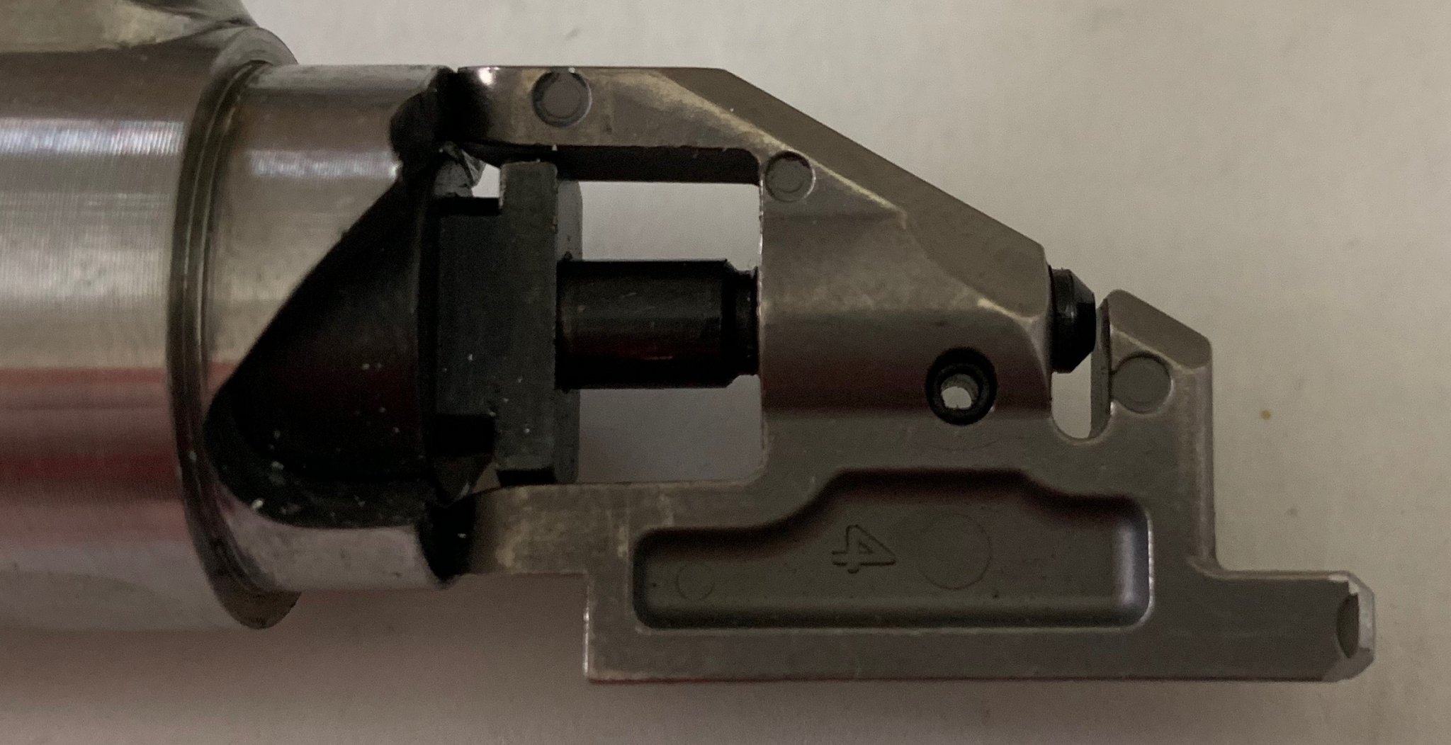

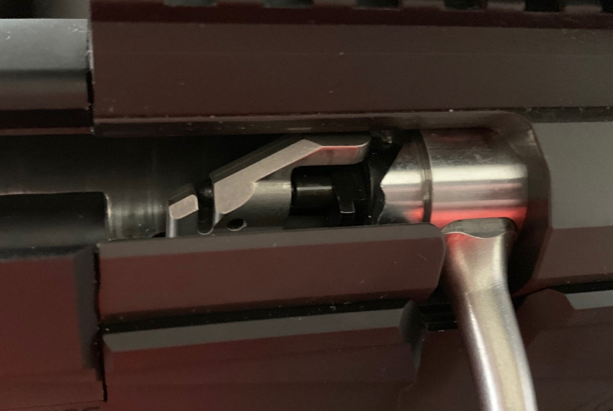

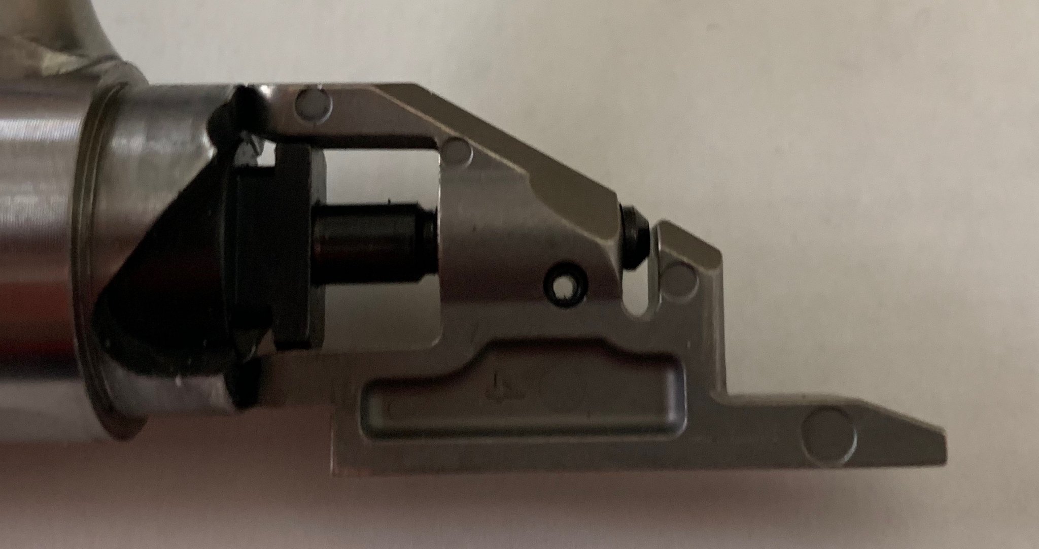

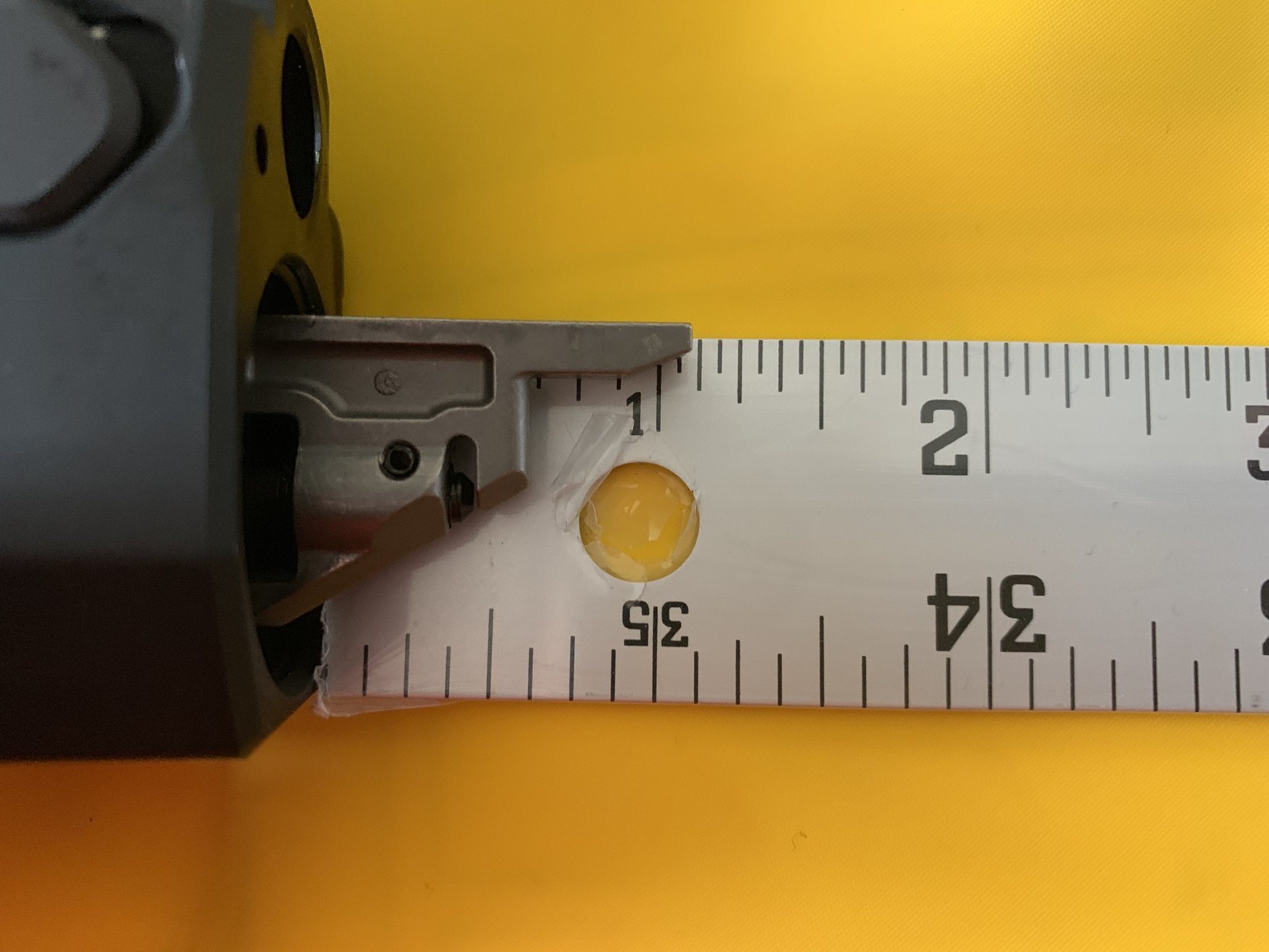

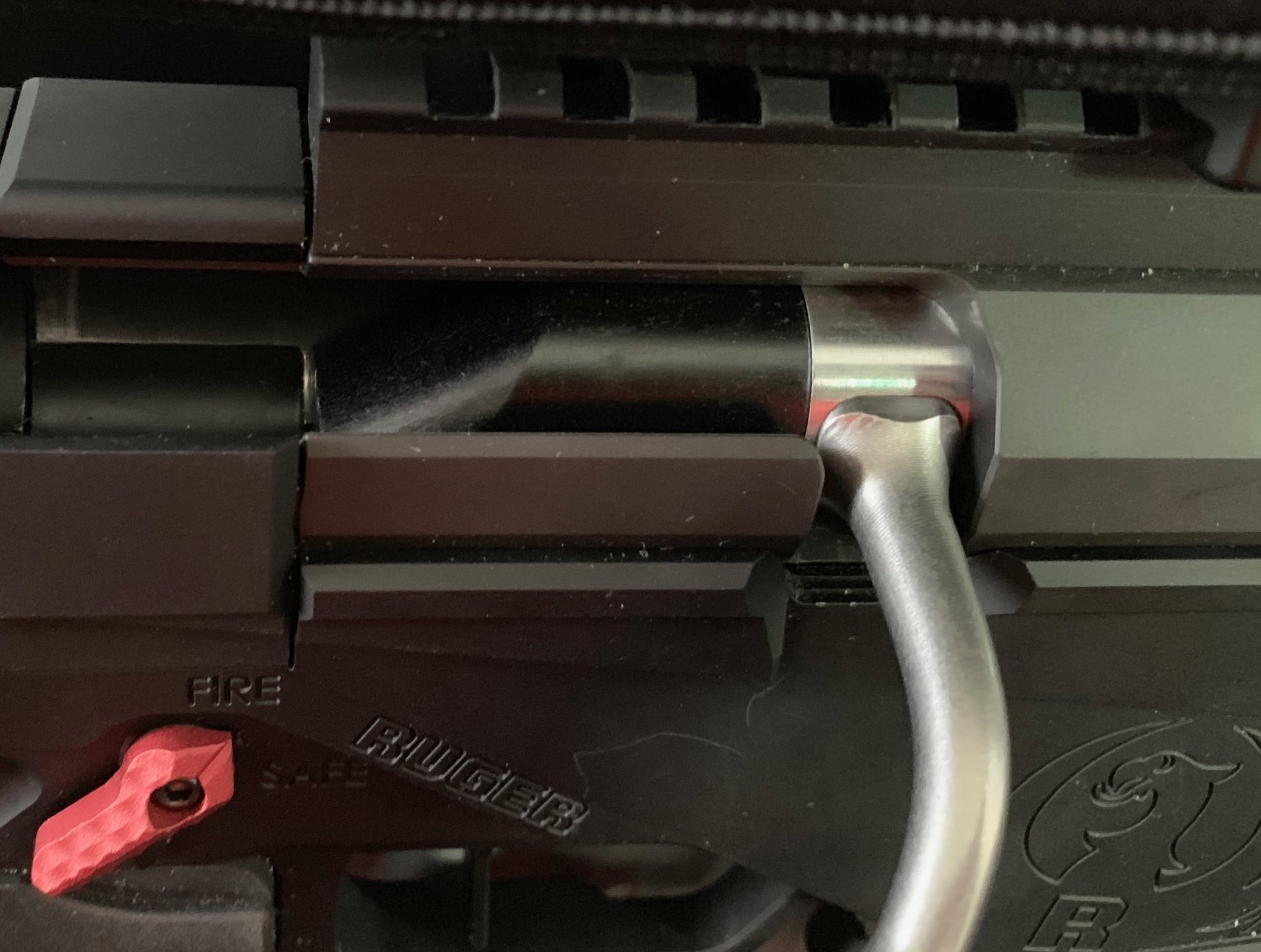

It looks like you can use an MDT Skeleton Rifle Stock v5 on a short action RPR, with a caveat. This did require some simple modification to the bolt.
Duplicate this at your own risk!
We know that the RPR bolt extends into the buffer tube. While the MDT stock does have a mini buffer tube it's not long enough to accept the bolt. The bolt has a tang off the back. As best as I could determine, this tang only serves as a cocking indicator. I chose to trim down the length of this tang.
Once trimmed down the bolt could move far enough back into the mini buffer tube to pick up rounds out of the magazine. I didn't like the idea of the exposed cocking piece, especially with the removal of the elongated bolt shroud meaning it's more exposed than before. Since the bolt is the same as a Ruger American Bolt I purchased a bolt shroud for one of those. The one I bought was from Anarchy Outdoors ( Ruger American Replacement Shroud ). The new shroud fits in the receiver. The bolt can move back far enough with the shroud but my shroud impacts the bolt used to connect the stock to the mini buffer tube. Thus far it's not an issue, if anything I may shave down the area on the shroud where it impacts if I need some extra clearance, though I don't expect to need to do so.
I've tested this so far with an MDT metal magazine. There is some excess room behind the rounds which should help ensure the reliability of the bolt being able to catch the rounds.
So far I've run the rifle this way during a range day and during a local match. I never ran into any problems with the setup.
Reasons for doing this:
  1. Looks good
  2. Much greater adjustability
  3. It's an option other than a Magpul PRS stock
  4. Allows for the addition of metal weight in stock if you're looking for that option
  5. It's a fairly unique modification
Reasons why you may not want to do this:
  1. It requires modification of the bolt (I used a knock off dremel tool with a cutting wheel)
  2. It leaves the bolt track in the receiver open
  3. Its not light weight
  4. It involves removing the stock bolt shroud and the tools contained there in
  5. The black color/shine of the stock and rifle do not match perfectly, though it's not all that noticeable
Overall I'm happy with how it's turned out so far. Let me know if you have any questions.

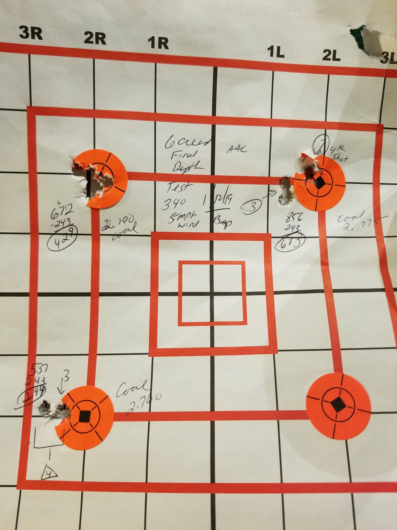

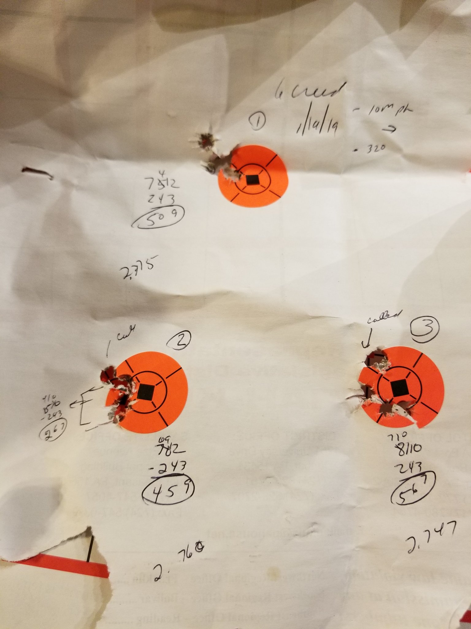

The same load 40.0 H4350, WLR primers and the Berger 105 reduced the 200 yard group down to 1/2” for five shots. I’m tickled with that.
So today I loaded up three rounds same load except I seated the bullet to 2.782 COAL.
I loaded up another three with same load and seated the bullet at 2.809.
I shot the 2.782 COAL into the group on the right. Turned the scope down two clicks and then fired the group on the left. The 2.809 is the group on the left. This target was at 100 yards as I’m dialing my scope in for a match this Sunday.
My rifle likes these Berger 105’s.

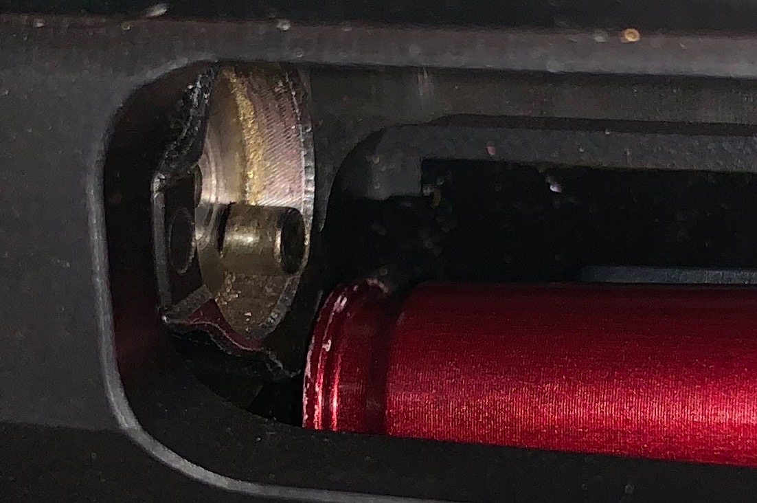

Got a new in box RPR in .300 WM yesterday. Magazines won't fit in the rifle. Called Ruger. Send it back they said. All of it. Apparently no QC. Since I have nothing to compare to not sure if it's the magazines or the magazine well. Why would they send out rifles and magazines that don't work? Person on the phone was nice but sounded like she was reading from the little "handbook of explanations and excuses" they are issued.
Did you have the bolt in when you were trying the mags?
I have same issue with my RPR 223, looks like the front lip of the mag is touching the bottom of the feedramp.
I will post some pics later.
When I got mine out of the box when the Gen 1 first came out, the PMAGS were a little tight going in, but I watched the Ruger sponsored RPR disassembly video, took the "lower" off, put it back on, magazines fit fine after that.
I had the same problem with my 300WM magazines not fitting. They were .002-.004 too wide for the mag well. Ruger wanted me to send the entire rifle back. This beast is shooting 0.5 MOA,I am not sending it back. I gently removed .003-.004 from the side corners of the mag and they fit fine now. I don't know how this made it passed QC. I still love this rifle.
Reactions: el_chingoton13
My magazines won't come close to fitting unless I completely loosen the front receiver screw and allow the two halves to seperate a bit. They said they would pay shipping so I plan to send it back. I don't want to modify magazines because if I want extras, I want them to fit. Thanks for the replies.
Gotcha, so it sounds like possibly out of spec lower receiver issue. I would probably send it back with your magazines so they can see what the issue is, cuz if you modify the mags who's to say you want different mags down the road and you would probably run into the fitment issue again on different mags. Sucks having issues with a brand new rifle but ruger should take good care of ya and get it fixed properly. I've had no complaints from their customer service.

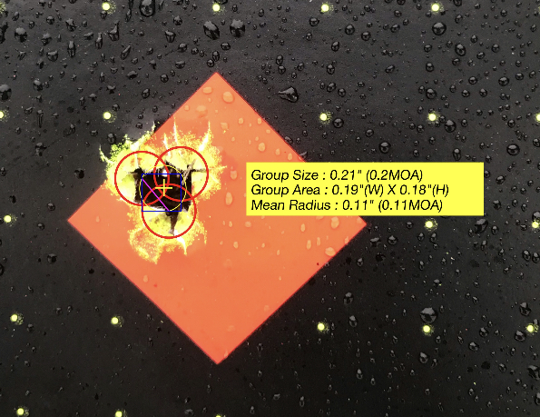

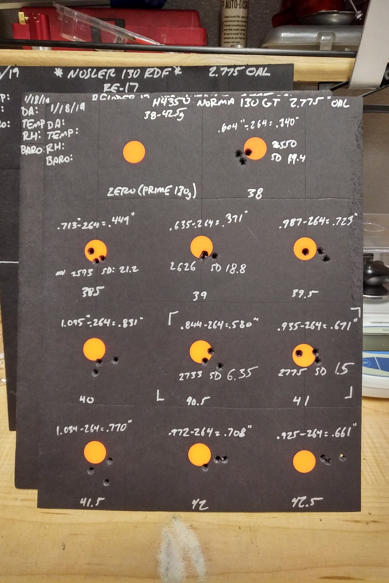

I’m shooting the load of Berger 105 VLD Target, 40.0 grains H4350, WLR primer, Hornady brass. Two days ago I shot a three shot group at 400 yards that was under a inch. Today I shot another three shot group that was just under a inch. Using the BallisticsARC app I guessed the FPS to be 2950. My group was about three inches low of the bullseye.
So I borrowed my buddy’s chronograph. Boy was that disappointing. It showed my average was or what I thought was the average of 2833 but I could see some rounds were 29xx down to 2790 but before I could see the SD numbers I shot the Chrony center mass and sent parts all over my backyard. So I’m not sure if 2833 was the average.
So I plugged in the 2833 in BallisticsARC. I shot the 400 yd target and it was centered up.
I have tried higher powder charges and my groups opened up. I’m suspecting the WLR primers might be part of the problem too.
It’s confusing to why this rifle is shooting so good with the SD all wonky. The Chrony is old so it might have been out before I snuffed it out.
