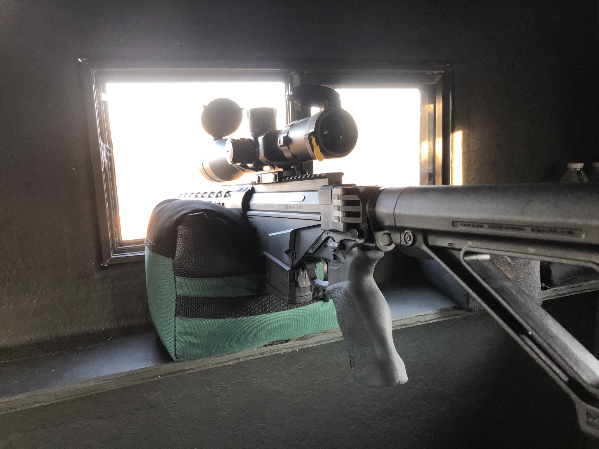

I’m 6’2” and have found I like exactly 15” lop. Long arms. I still have the factory stock as well. It’s served me well enough that I haven’t really looked elsewhere yet
It’s all good for me on a bench.
But sucks if I have to do this.

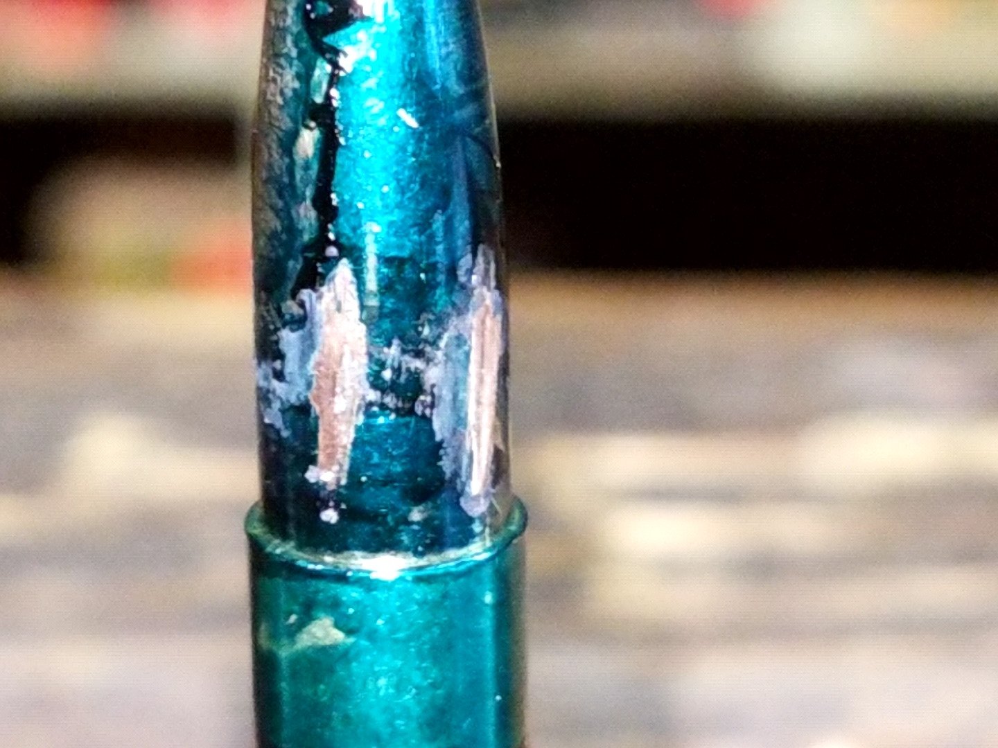

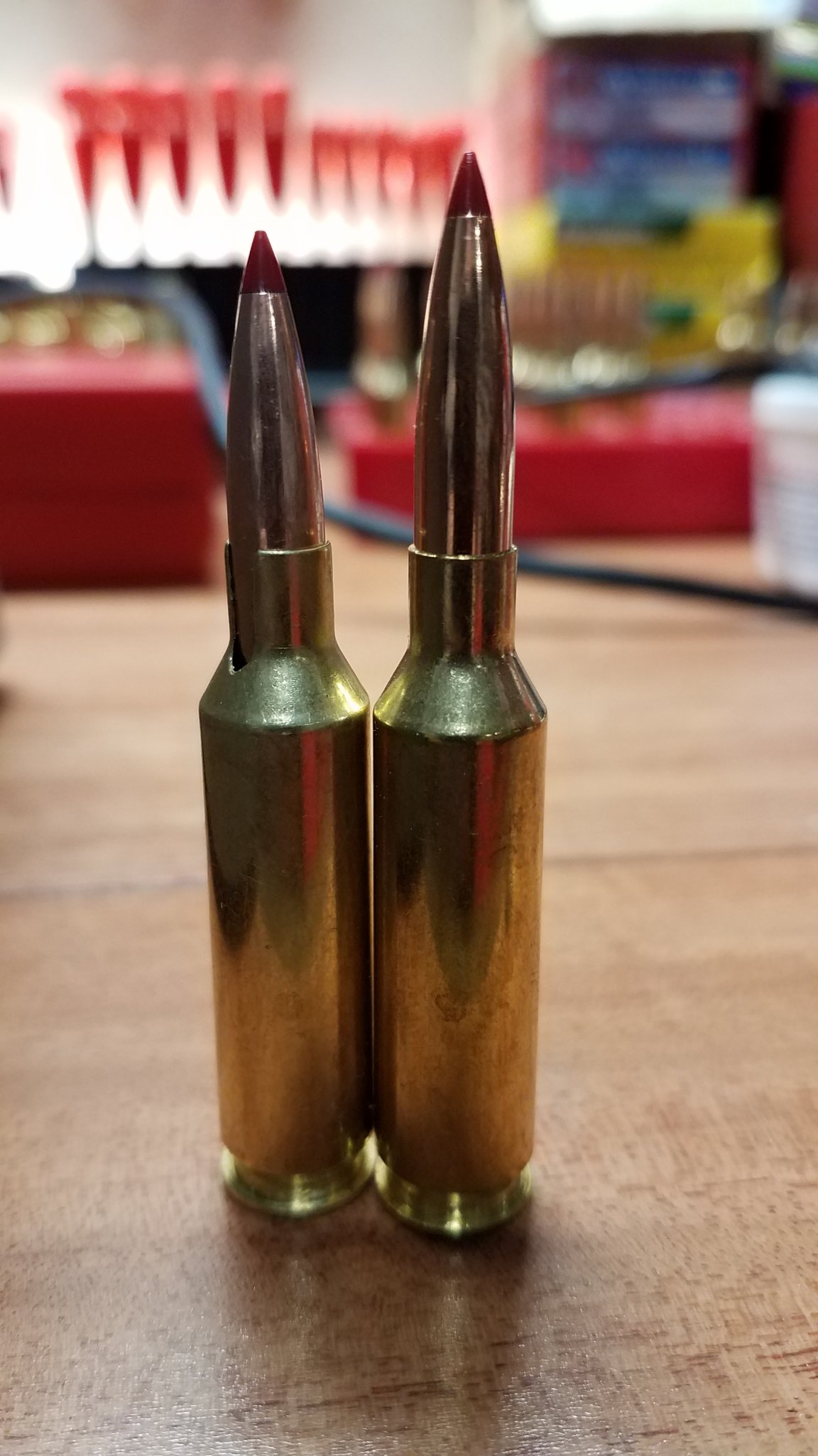

Evening all. I'm new here so please bear with my ignorance. Bought a ReaPeR in 6 Creed late last fall. Shortly thereafter I dove into reloading like I had two months to live. Long.and shott of it, the more I read about reloading the more I started to think I had an issue with my RPR. It was sent back to Ruger last Saturday and I'm fairly certain I have a serious throat issue. Factory Hornady 108ELD's jammed into lands. I could go into more detail but have already spent a lot of time posting this situation up on another forum so I'll be more specific when this all shakes out. Some pics to burn up server space.
Evening all. I'm new here so please bear with my ignorance. Bought a ReaPeR in 6 Creed late last fall. Shortly thereafter I drove into reloading like I has two months to live. Long.and shirt of it, the more I read about reloading the more I started to think I had an issue with my RPR. It was sent back to Ruger last Saturday and I'm fairly certain I have a serious throat issue. Factory Hornady 108ELD's jammed into lands. I could go into more detail but have already spent a lot of time posting this situation up on another forum so I'll be more specific when this all shakes out. Some pics to burn up server space.

Soooooo, factory ammo jams into the lands?
Yup. Pic of two cartridges is a home made modded case with bullet seated touching lands on the left. Right one is factory ammo. I noticed I really had to force the bolt closed from day one but I thought it just needed break in.
That’s not a throat issue. When you said throat, I thought you were going to say fried. This sounds Like a chamber issue.
For a newbie, how can you tell if an RPR has an issue with this? I was looking to buy a 6 creed RPR myself here soon.
Very simple......put bullet in gun...close gun...open gun....if it looks like assholes, like the one above, you have a problem.
Seriously man, rare dealio, If fubar Ruger will fix.

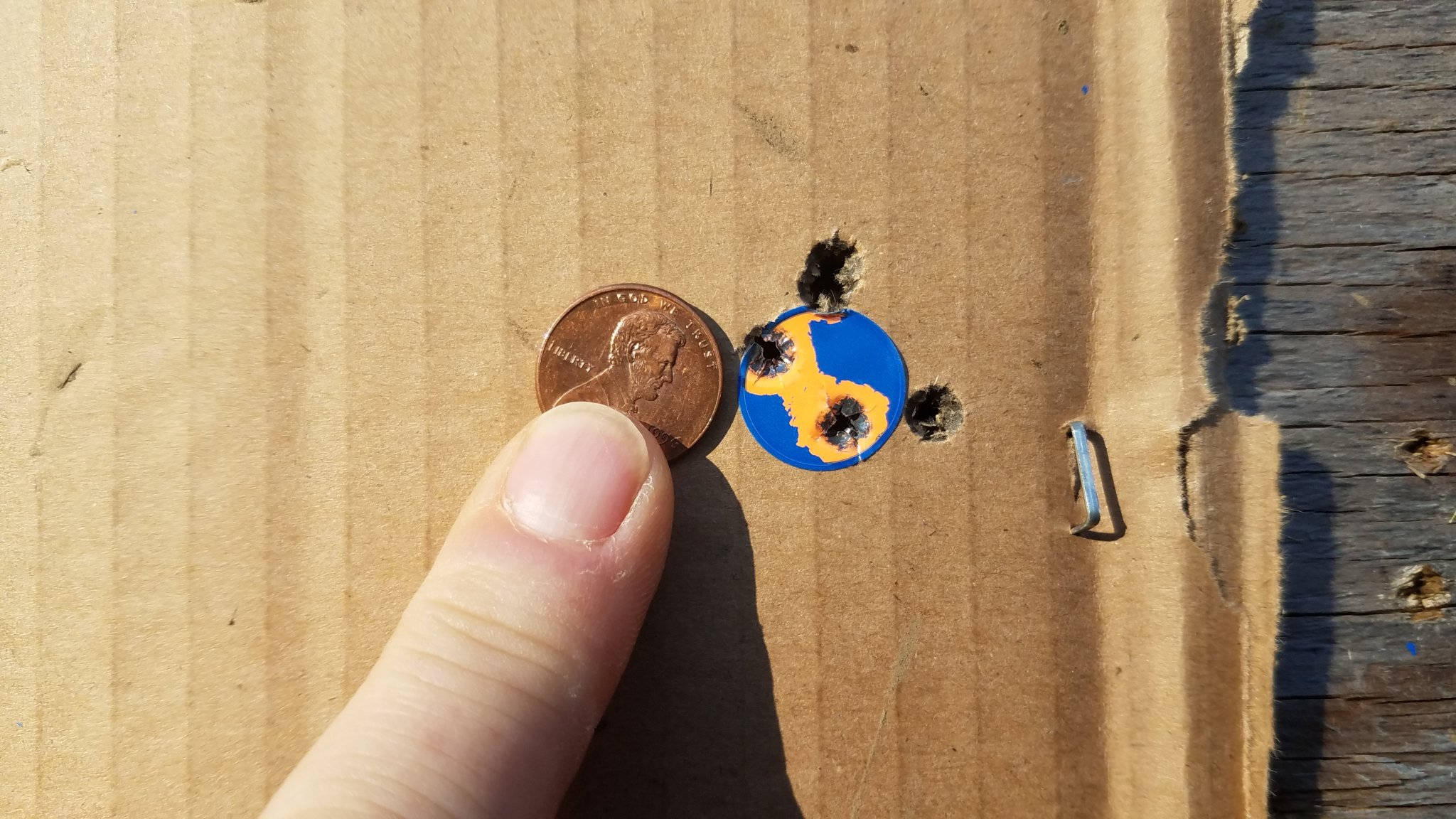

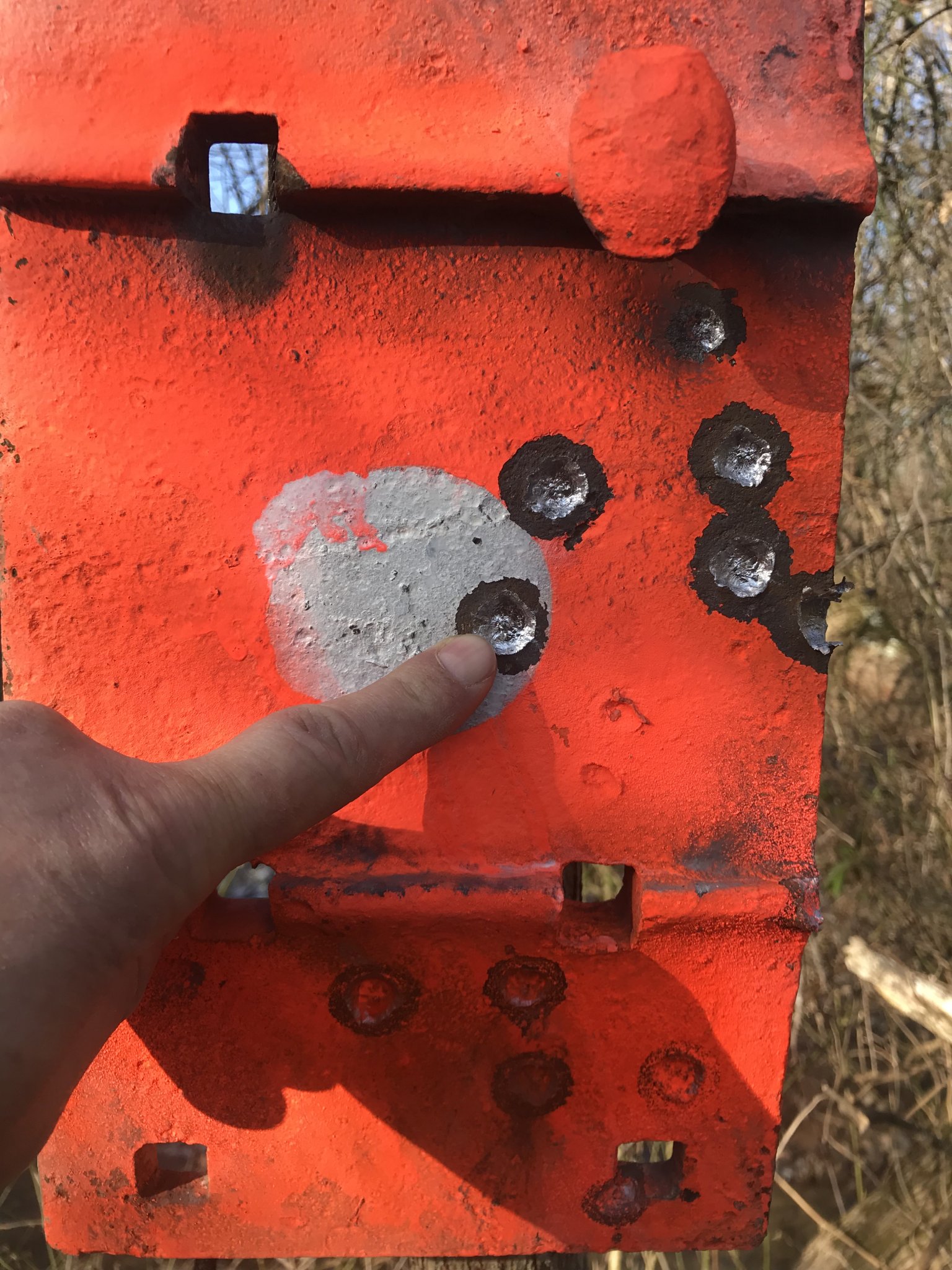

Today I shot five rounds at 400 yards. Load is 40 grain H4350, Berger 105 VLD Target with WLR primers. FPS 2833
Shot off one of my precision match obstacles. Not rock steady. BallisticsARC called for .1 click for windage which I did not dial in. Scope at 1.7
The bullet impact I’m pointing at was one of three extra rounds I had loaded up with 42 grains of H4350. First two were off target so I turned scope from 1.7 to 1.3 and bullseye.
I’m going to try some different primers & loads to get my FPS up.
