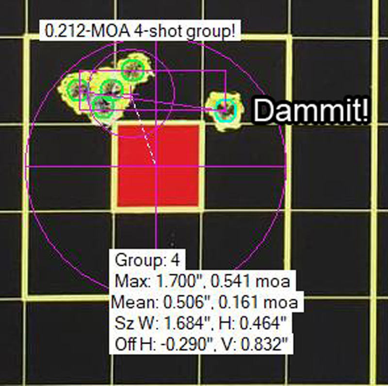

Shot this group today at 300 yards with 3700 rounds on my original RPR 6.5 barrel. Harris bipod and rear squeeze bag. Factory Hornady ELD-M 140-gr ammo.

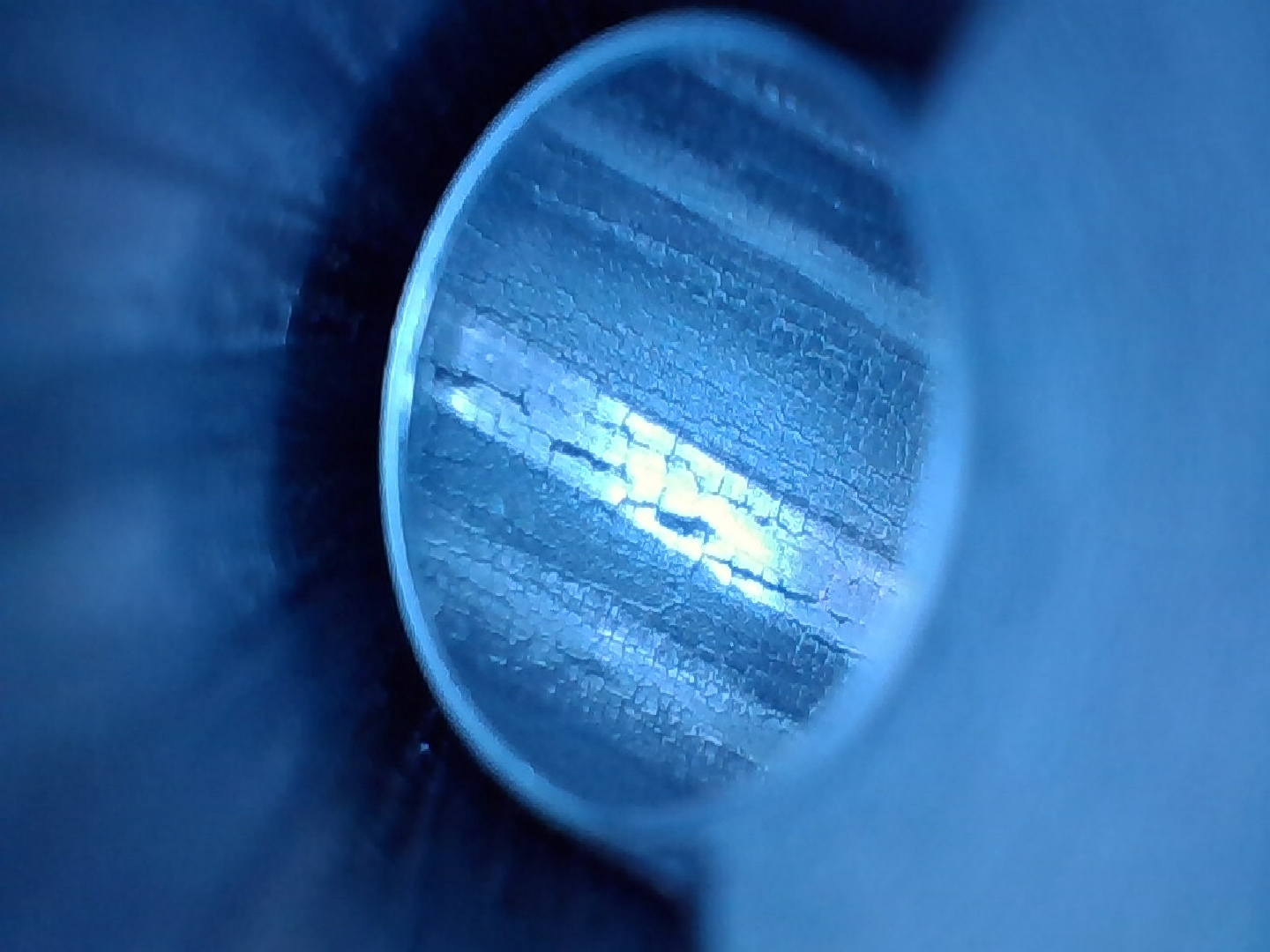

Although I did not shoot the proof barrel I did bore scope it and internally it looks as good as anything I have seen. I am talking about the all stainless barrel not the carbon fiber wrapped one. I dont think you can go wrong with a proof barrel. Check Stockys.

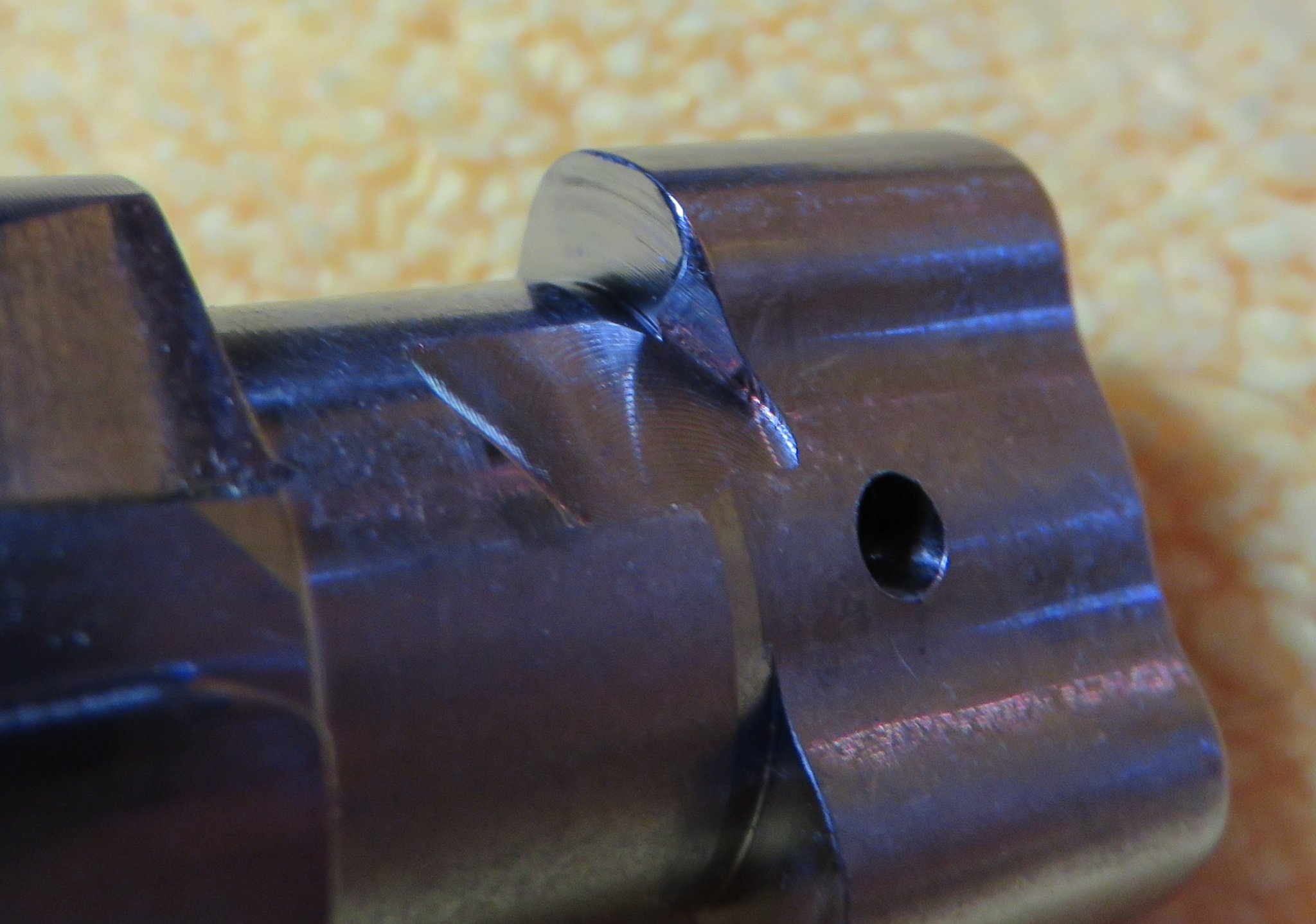

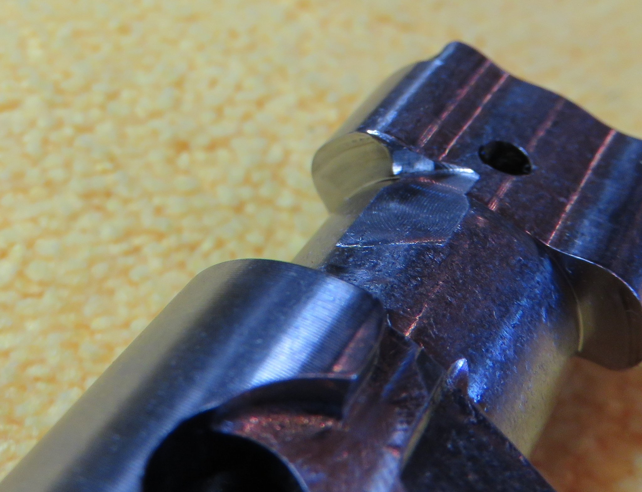

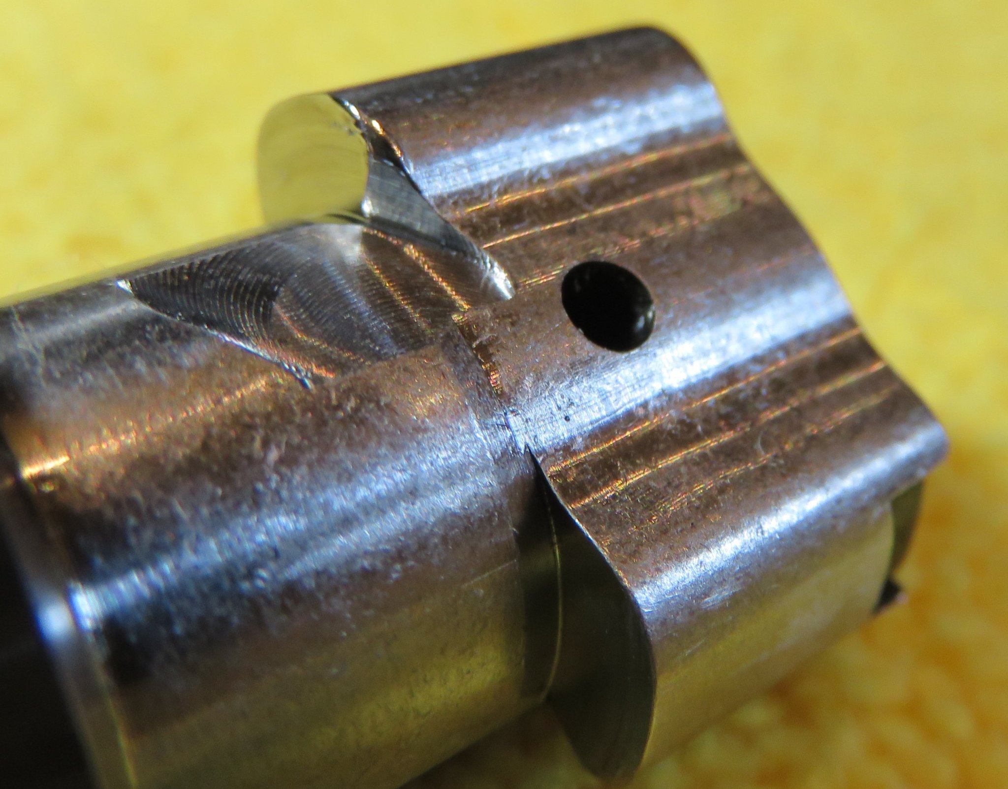

Well, I've got 6500 .308 rounds on my PRP bolt . . . take a look at picks of each lug and judge for yourself :
Reactions: Hardpan
