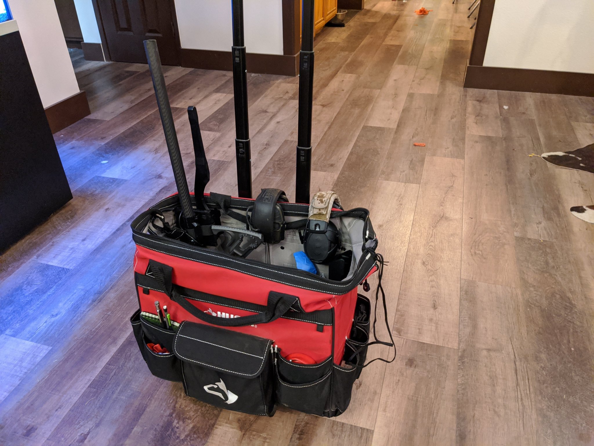

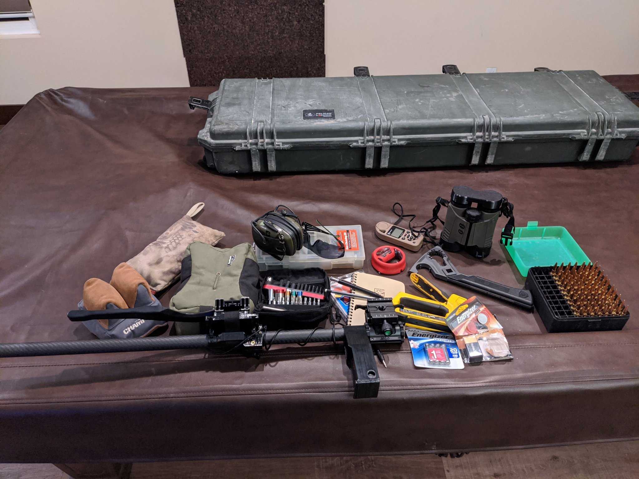

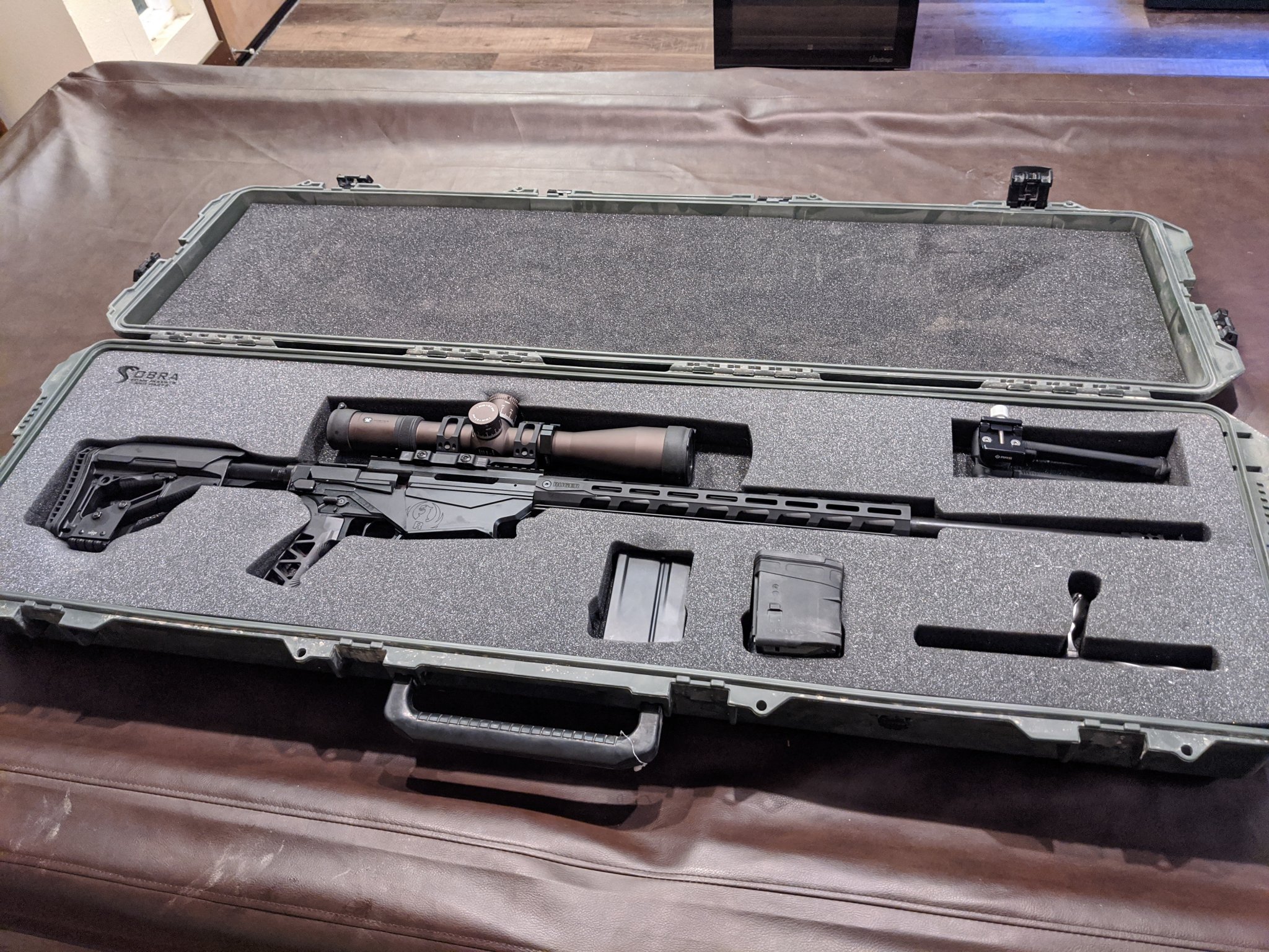

What is your RPR System? Short of calling it a Sniper Weapon System (SWS) like the M24 SWS; what does your RPR dedicated system look like? I was evaluating my own last night and realized, that too much of the ground support for my rifle is shared across multiple rifle systems... I want to change that, even if I have to duplicate every tool, rag, or cleaning rod, just to stay dedicated. What triggered me was the latest video dropped by the Sniper's Hide, highlighting tool kits for your rifles.
Would any of you mind showcasing your system? If you have previously done so, would you mind posting again? Pics and lists would be greatly appreciated!
My next two purchases will be a dedicated compartmentalized rifle case, and one of the tool kits highlighted in the linked video. Or I may just add another Fatboy torque set to my kit. Thoughts?
I have a dedicated case for each rifle that houses the rifle specific items (mags, sling, bipod etc) and then a rolling bag that goes to the range no matter what gun I am shooting. That houses the universal items like ear and eye pro,fix it sticks tool kit, cleaning tools, note pad, Kestrel, LRF, Magnetospeed, batteries, rear bags etc.

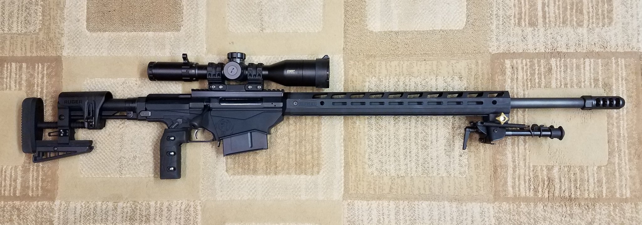

I will be rebarreling my Ruger RPR 338 Lapua soon. I'm NOT interested in changing cartridge to an Improved or XC. I predominantly shoot 300 grain Berger Hybrid and 285 Grain ELD-M bullets and have hits just past 2k yards . I want to shoot a few ELR matches and would like to hear some thoughts on manufacture, rifling type, twist, and length. Thanks!
