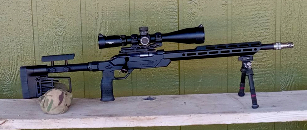

I was fortunate to get one of these excellent Sharp Bros. chassis as soon as it became available. I blew the dust off of my RPR and went about mating the chassis and RPR's barreled action. Flawless! A perfect fit.. Added a stock, grip and scope then off to the range. Magazine fed flawlessly and I could actually shoot the RPR now with a real cheek weld! No more "stock flex flyers". Now there is no excuse. The rifle's full potential can now be exploited.
looks like a good chassis. The RPR I have has the smallest length of pull of any gun I ever owned. It's like the gun is made for a small child...
