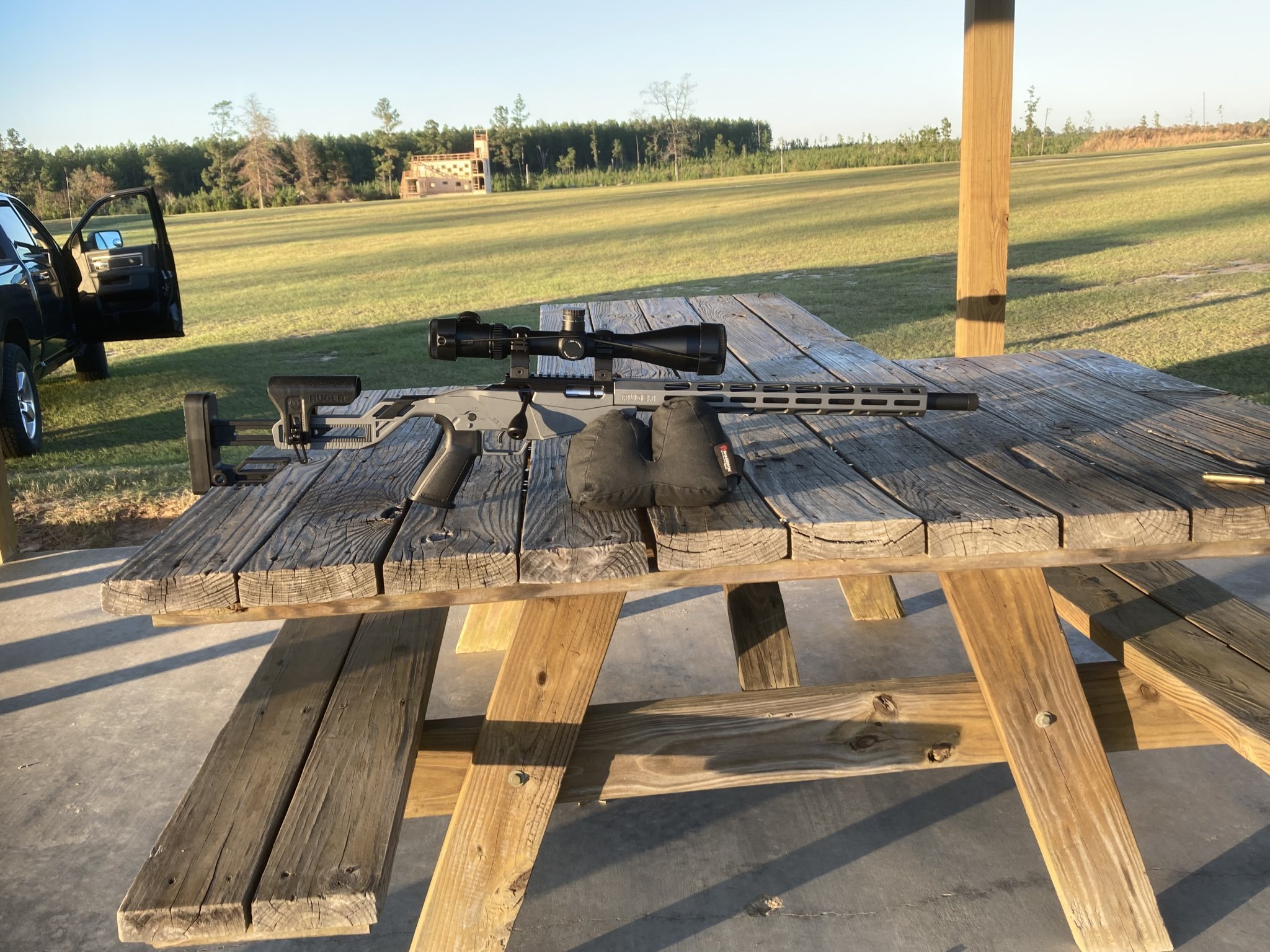

We have Brenda's RPRR running last week, got her sighted in, with some issues, not due to the rifle but due to the sigher-in-er. Dyslexia is hell when trying to turn knobs. (is right, right or do I need to turn left, this literally is the way my mind works)
Got it on target at 25 yards, fed in my dope for SK Standard Plus/SK Long Rifle Match that my Vudoo uses, first shot, hit a mini silhouette at 50 yards.
Took it to over to unknown distance range and she was hitting targets out to 195 yards. I can't promise perfect one hole groups, that some complain about, but it does what it's supposed to do. And for that, we are happy

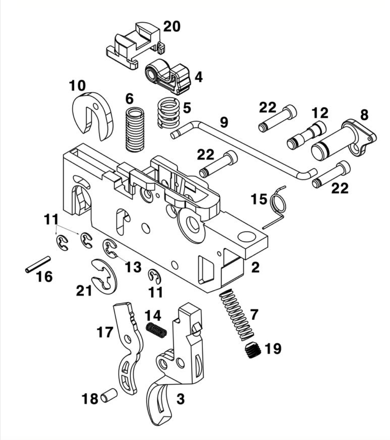

think the bladed trigger "safety" spring may be not installed correctly? Anyone else let me know if this is "normal". Rifle functions as it should otherwise.
Not seen it myself, but another older thread here said they had to increase the trigger pull weight adjustment to prevent it from sticking.
