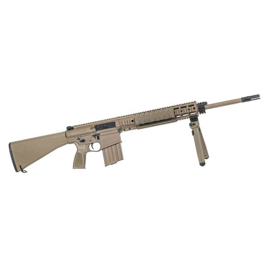

Their new sabre 308 lineup looks cool I'll give them that:
