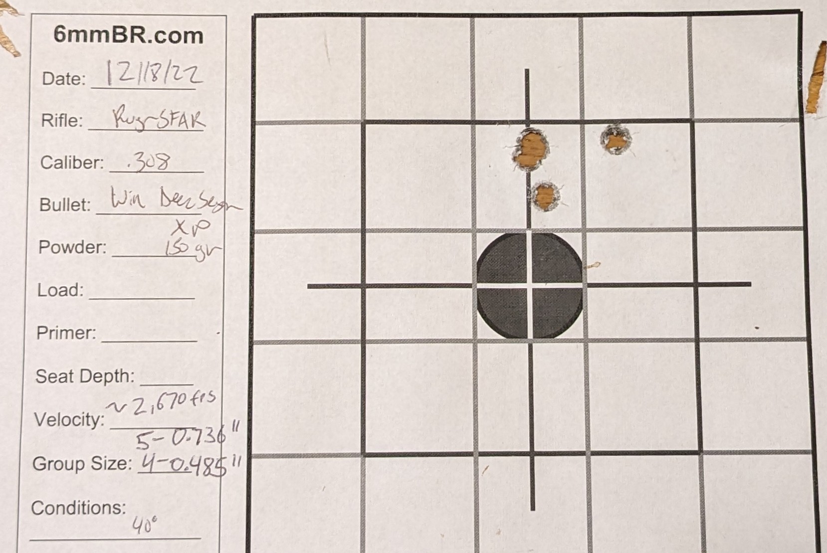

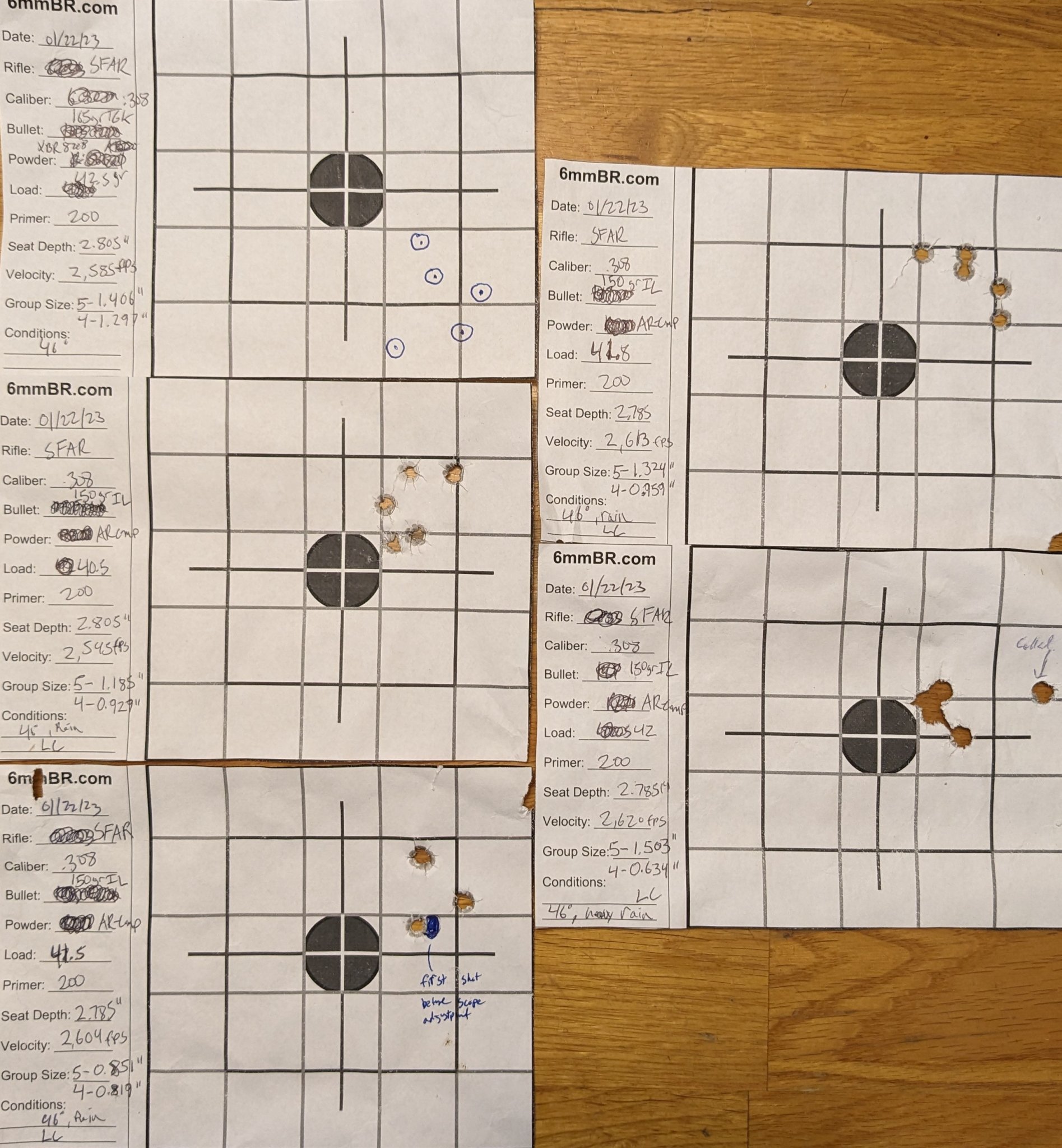

I tried 3 ten shot groups today with 42.4,42.6(used last time) and 42.8 of Varget. Plus I switched to 6.7oz buffer.
The SD and ES tripled for 42.6 🤷‍♂️ I know ten shots is going to show a more accurate range but it was surprising. Groups opened up too. Maybe due to the heavier recoil impulse with the heavier buffer.
I think I’m going to concede that this barrel doesn’t like 168 gn MatchKings. Time to move on maybe. My plan was to see what the rifle could do with what should have been a tack driver bullet before developing a critter round. 42.6gn with low SD/ES numbers was looking promising with an acceptable 100 yard group, but not so much after today.
No big deal, kind of disappointing but it’s all fun, right! I’ll do some research on a good fox/coyote bullet and start over.

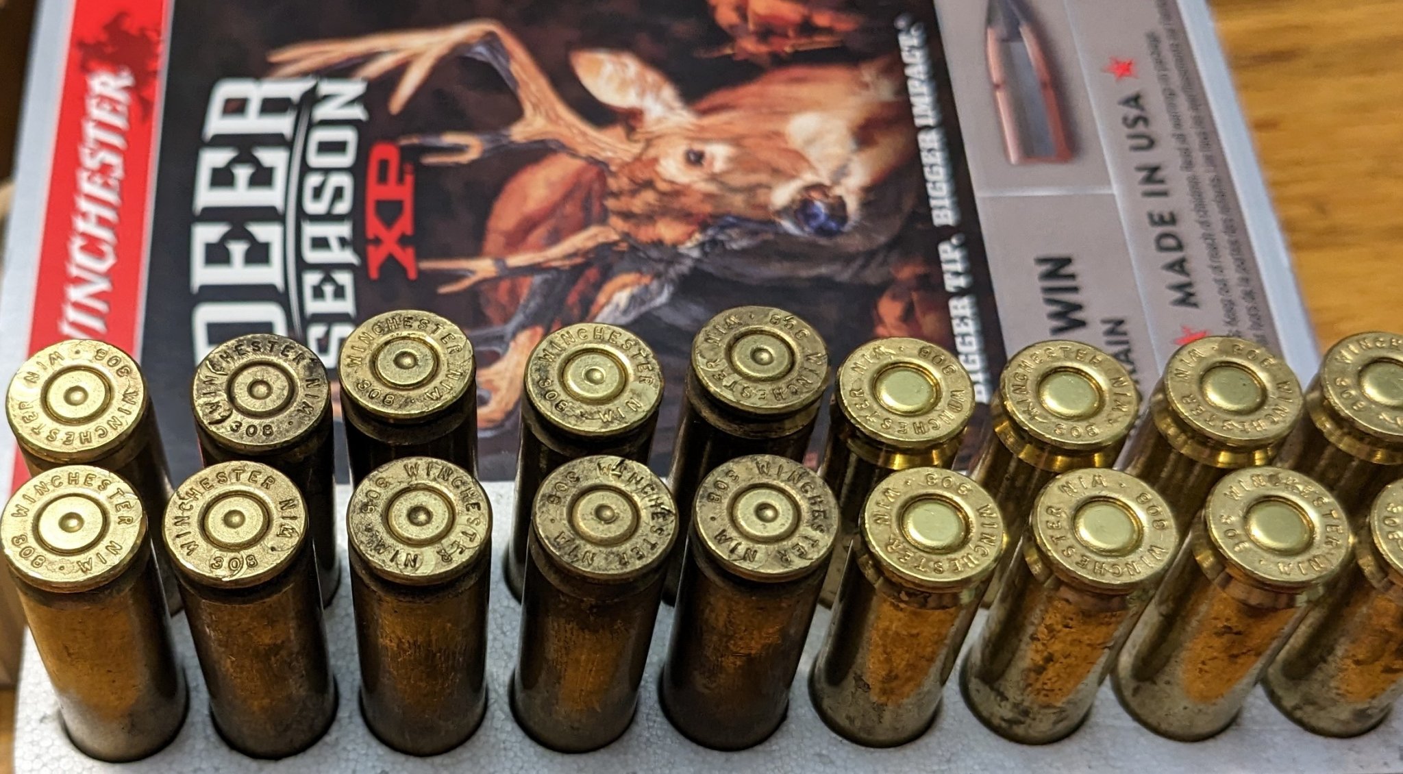

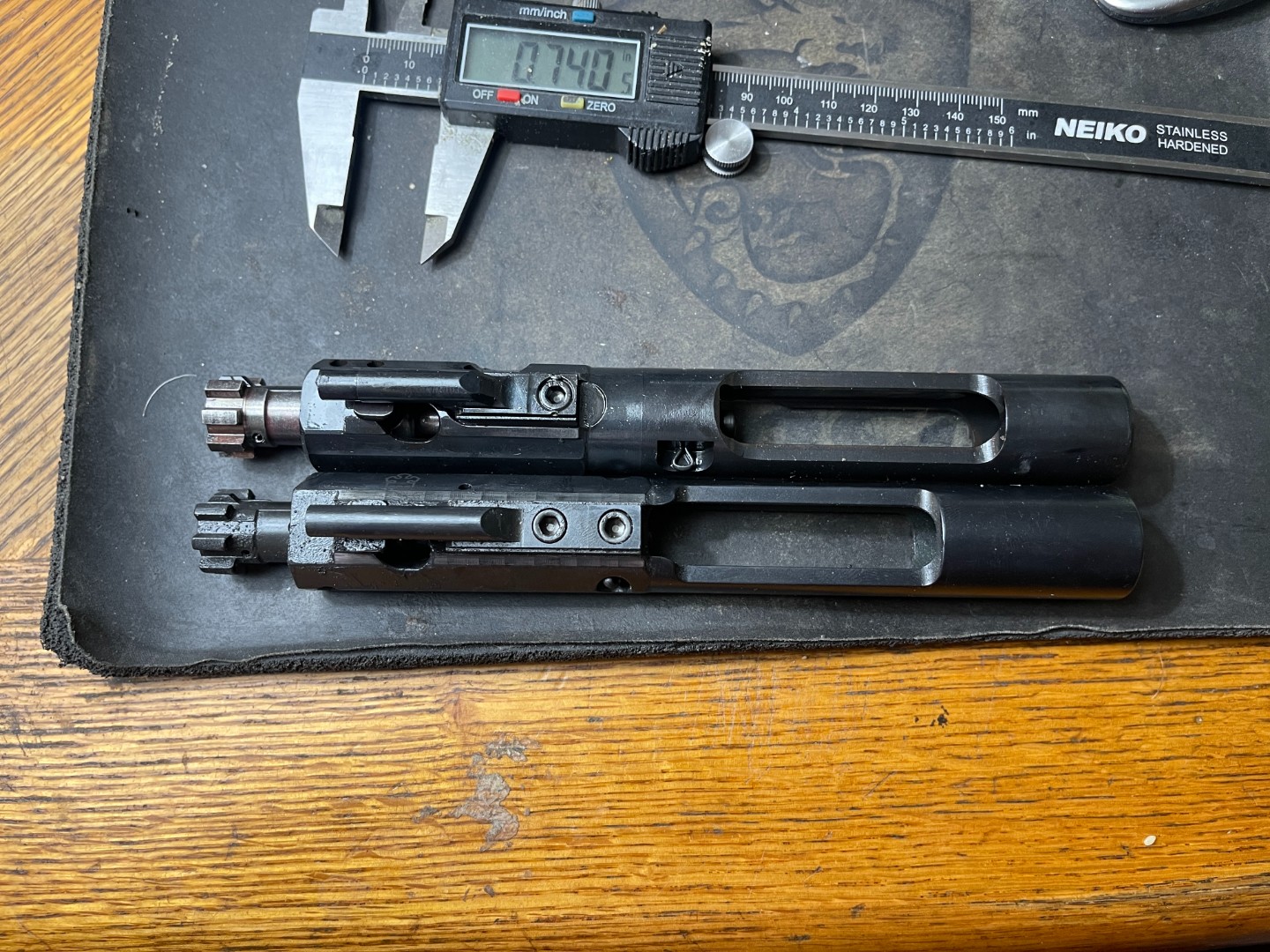

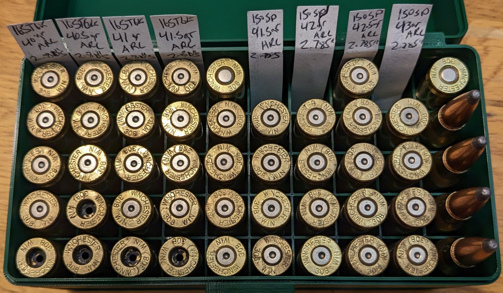

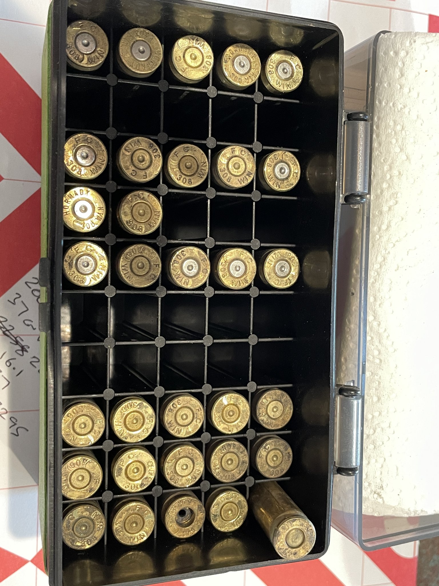

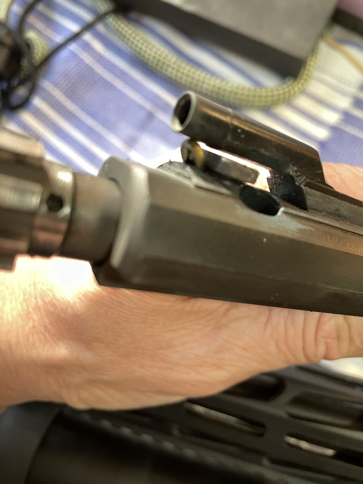

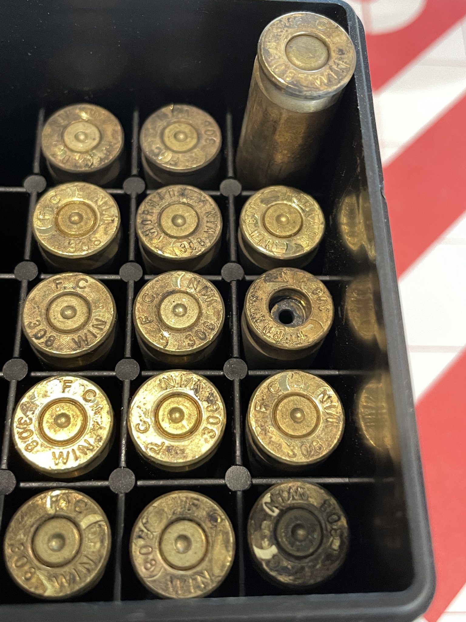

Even with the heavier buffer it’s still tearing up case heads. Am I pushing it too hard?
I was shooting my ‘farm critter’ 300AAC yesterday working up some 110 v-max loads, makes me realise how nice the trigger is on my SFAR 😂
Changing the buffer is what jacked up your es and sd. You'd have to start load development all over again with the 168.
I went through all that with a 16" pws 308. I believe its a mid gas setup. Pws has since realized the error on their ways and the new rifles run a longer gas system.
I sat down with 168 fgmm and tried three different buffers, three springs and an a5 length extension. Groups shifted in poi and overall size with every change in the buffer setup and es and SD varied wildly. I racked my brain over it for quite a while to the point I was really just losing interest in the platform.
In the end I ended up with a home made heavy buffer, Tubbs flatwire and the a5 extension.

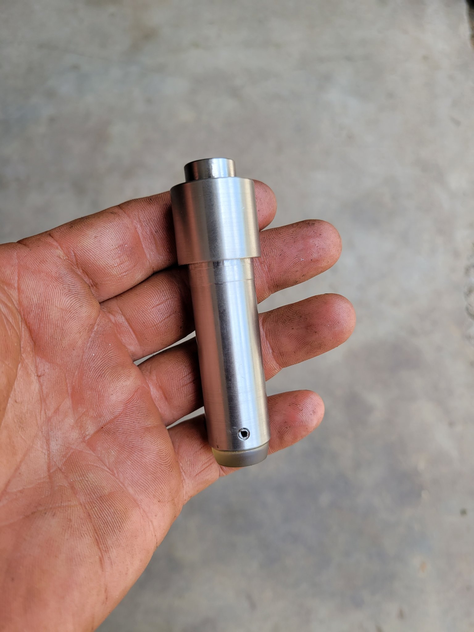

I left all the meat on this sucker I could. The back end measures the same length as an ar10 carbine length buffer but overall it's the same as a regular buffer. Ended up just over 11 ounces!
Prior to this I used the heavybuffers.com car-10xh which was a 6.5 ounce buffer and their heavy spring. Sucker kicked like a mule but shot decent. Honestly I didn't think a 308 was capable of that kind of recoil. Still wrecked brass though and it put a lot of gas in your face. Which isn't supposed to happen with a piston gun.
I switched to an a5 reciever extension with a Tubbs flatwire and my buffer and it finally calmed down to a 2-3 O'clock ejection pattern depending on what I'm shooting. I believe there's three tungsten weights in it and the whole front end of it is solid. Recoil isn't bad at all now believe it or not.

Mixing by up the loads today. 168mk group was ok but numbers are higher than previously with 6.3oz buffer that I ran today. It was a good 20° warmer today, probably closer to 30° , at round 70! maybe that had something to do with the number disparity??
165gn interlock were a bit disappointing with very high SD numbers although groups weren’t terrible 🤷‍♂️
200 ELD-X grouped well and had great numbers but on the last set ( not an outrageous load by any means) I blew a primer ( that I didn’t notice) which lead to a major jam ( think brass punch and lots of hammer work!)
I’ve never had a gun pop primers like this one. I should have been looking closer at pressure signs but not even being up at max loads I didn’t pay enough attention, my bad!! It’s even blown primers on factory 150gn so go figure 🤷‍♂️
I’ll load up some 110 v-max, 150 btsp and more 200 ELD-X with IMR4895 next and see how they look. I won’t bother going anywhere near the higher end loads though. There’s definitely something about this gun and showing pressure signs at moderate charges ( and it seems to happen suddenly. ) Do AR10s in general have this problem? I’ve never owned one before.
Anyway, here’s a few photos to bore you. Any input always appreciated and Happy New Year! We all made it through another year without blowing our faces off 😂

My load runs with FC brass were pretty bad in terms of ejector/extractor marks, and lost some primers too, all well below book max loads. Win brass and lower loads held up better, but you can see even factory Winchester XP is getting a bit mangled up, with brass carved up by the ejector holes. I don't claim that the Win XP group is repeatable, but the rifle did seem to like that ammo.
(btw, the primers are missing below because I popped them out to check for pocket growth, only the highest 165gr load showed a little)
Once my LC LR brass comes in, I guess I probably need to drop a half grain or so and work up again. I had a few of the 150gr loads jam up during feeding, I think they didn't have quite enough power to cycle with the H2 buffer in, so I may reshoot those with an H or even carbine buffer in to see what happens.
View attachment 8037200View attachment 8037201View attachment 8037202
I did d some brass prep last night, over 100 pieces. Just about every one had to be run over a file just so I could get it in the shell holder thanks to the ejector and extractor damage. I think much lower loads will need to be tested otherwise we’re going to be buying new brass far too often.

Blown as in popped all the way out and rattling around in the magazine etc? I would send it back to Ruger. Something is wrong.
Ejector swipe and little burrs here and there are pretty normal but popped primers aren't.
Yeah, popped out. One jammed between gas key and bolt pivot pin and locked the BCG up ( see earlier post with photo)
I think the primer issue comes down to the bolt unlocking way too early. Once run in, and running on a lower gas setting it’s better ( with heavier buffer) but still shows ‘pressure signs’ way earlier than you’d expect.

Worked on loads a bit more for the SFAR yesterday. It was raining so I tried to label the targets with load info before hanging them up, and then wound up losing track of which row was which, so they are kind of a mess.
The rifle does seem to favor lighter bullets, including the bunch of 150gr SP I had left over from a Hornady promo. I'll probably try something along the lines of 155gr ELDs at some point, now I think I'll swap the 12x SS for my 3x prism and run with these loads for a while since I have the bullets laying around.
The 150gr loads were pretty light and choked occasionally with the H2 in, so I went back to an H. I did see about 120fps higher velocities with LC LR brass than Winchester with the 150gr loads, which was more than I was expecting.

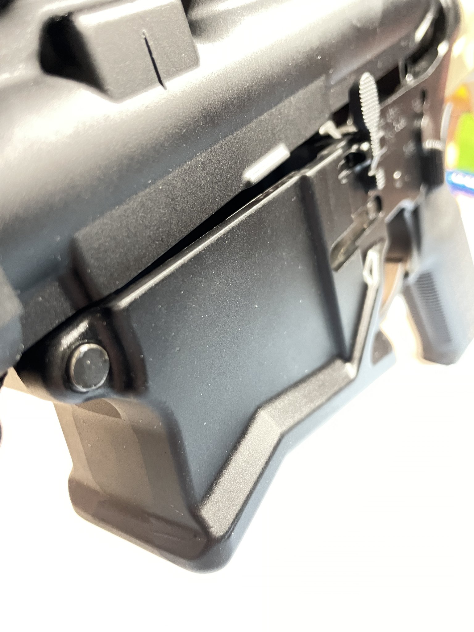

Guys, I have a crazy question…
Origin story - I had hoped the LWRC Six8 would allow me to build an AR in .223 Wylde with an insanely long max COAL, but the small gain of only 40 thou just wasn’t enough to justify the work I’d have to do on it.
Ready for crazy? Here I am.
Can a standard 5.56 AR upper be installed on an SFAR lower? If so, I’d like to develop a magazine for it. I think I could gut an SR25 PMAG, modifying it as necessary, and bond in a 5.56 mag that’s been windowed at the front for super long loads.
I may have to use an AR9 bolt catch or something like that, but I can figure that out down the road.

The short answer is yes.. a AR-15 upper will pin onto the SFAR lower..the longer answer is that the firing control unit is moved backwards to accommodate the larger magwell...so it may likely depend on if you can fit a standard bolt in the Ruger carrier and use the longer SFAR firing pin....

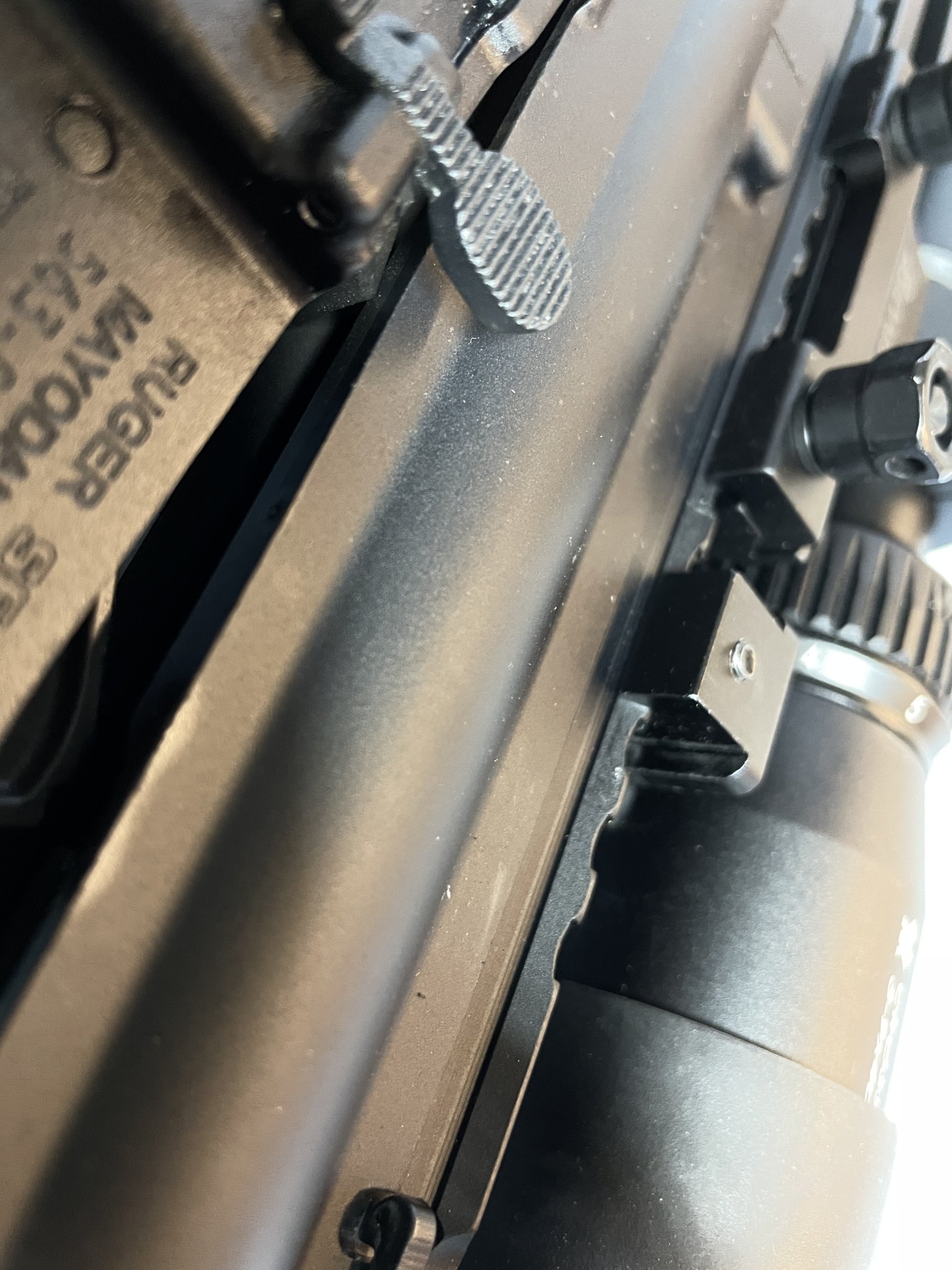

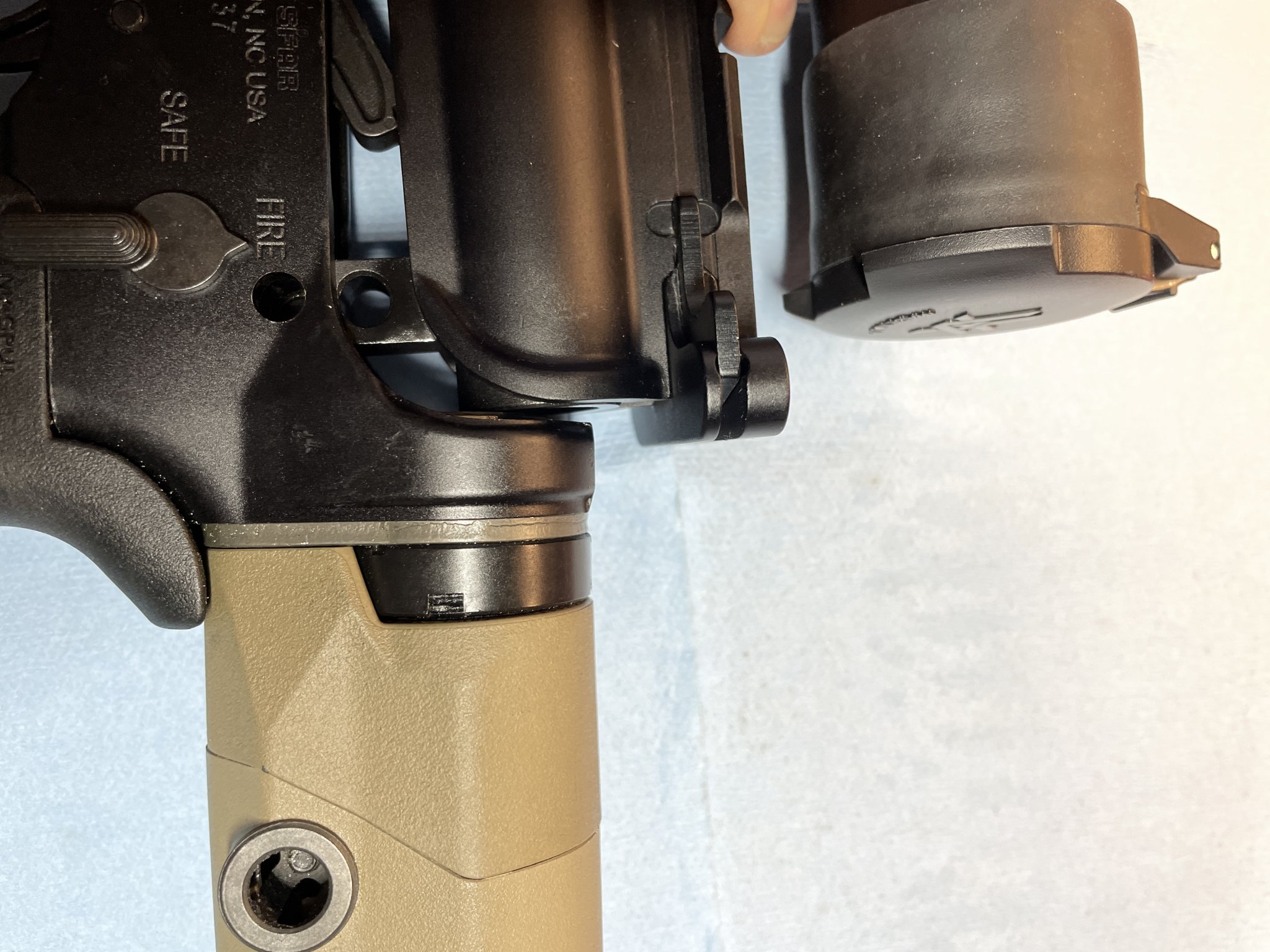

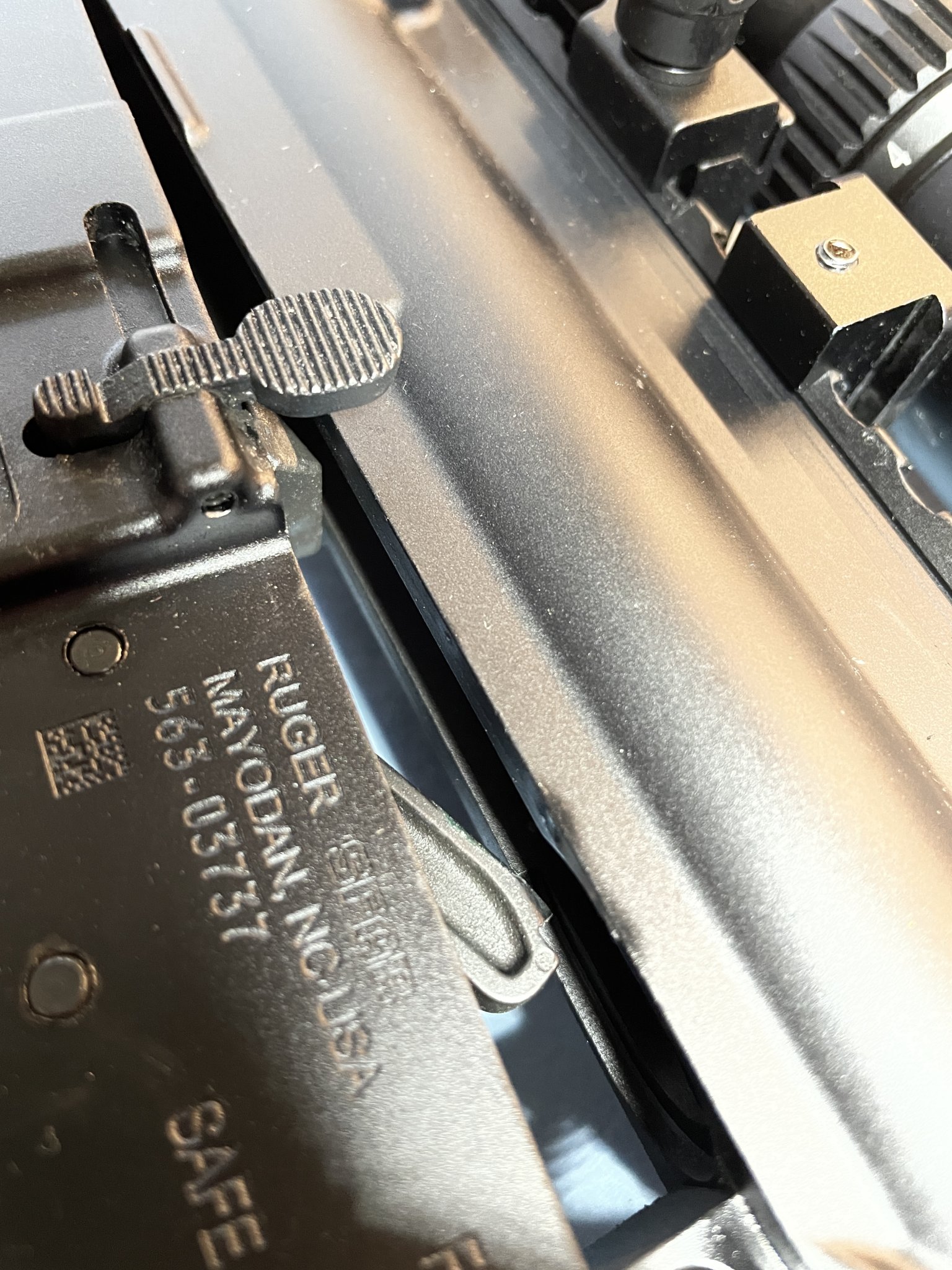

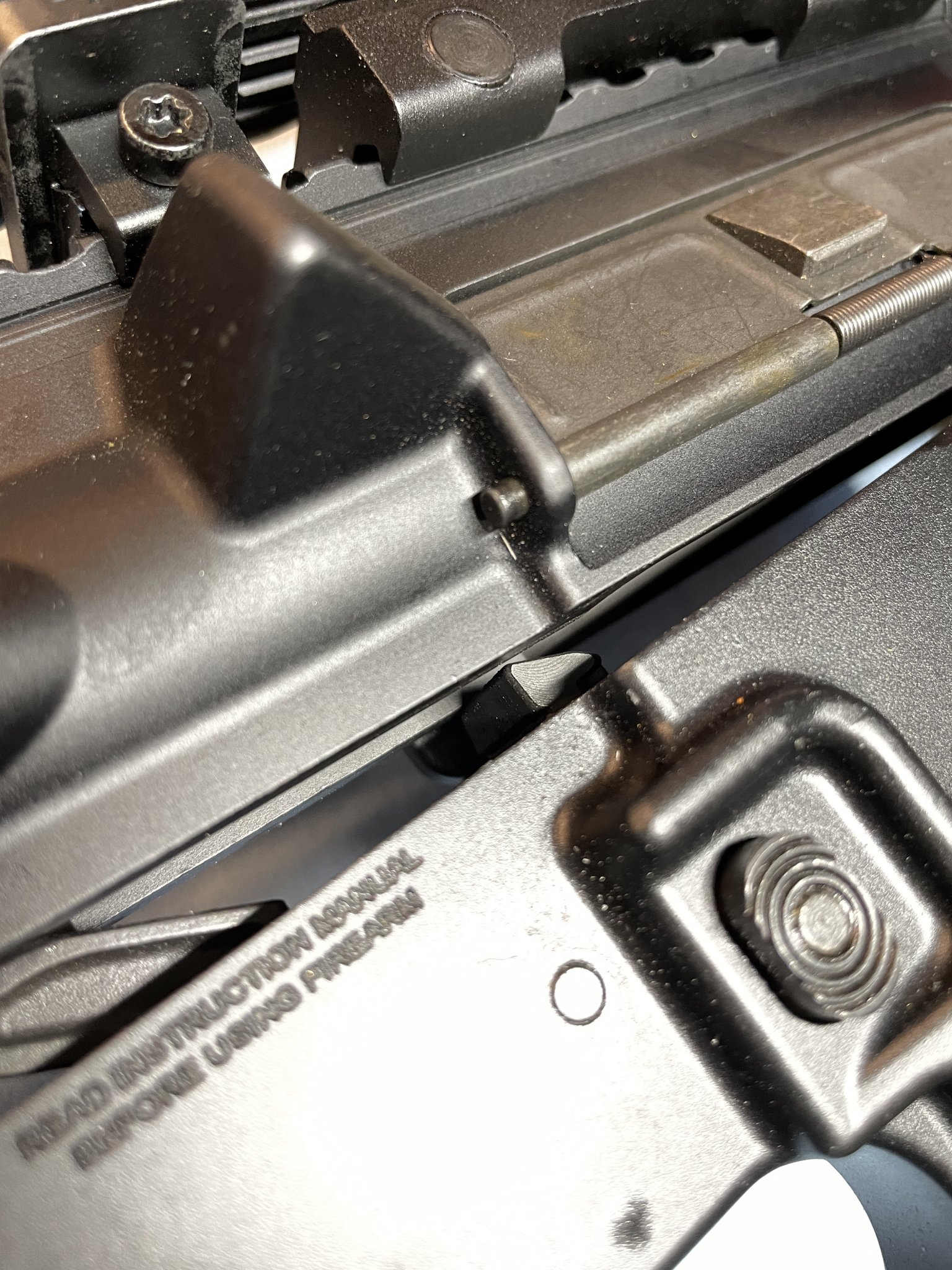

Although upper and lower pin holes 'would' align, they can't because the bolt release is in the way. Even if you removed half the width of the bolt release, I don't think it'll work on the AR bolt. FCG is in the wrong place plus the SFAR lower is slightly wider than an AR so the upper doesn't sit on the lower properly. I can't close the upper/lower due to the bolt release being in the way but it looks like you'd have a small gap at the rear too.
As far as I can tell , the SFAR and AR bolt locking lugs are different so it's not like you can try swapping them around.
