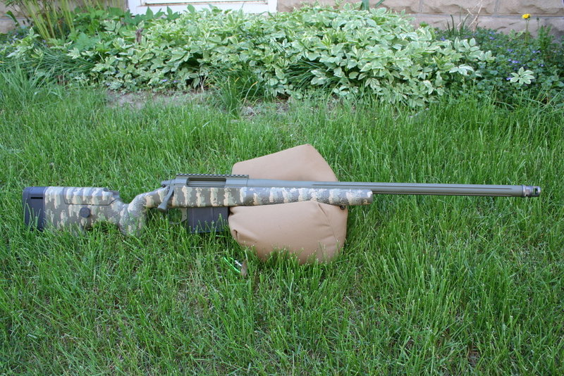

RWS Base Custom Rifle
AICS 1.5 Chassis
Remington 700
Brux 26" - 1-8 Twist - M24 Contour
Thunderbeast 30BA Suppressor
Timney Trigger
Schmidt and Bender PMII 5-25x56mm - P4F
Sphur SP-4001
Load Info
Lapua - Virgin Brass - Neck Sized with .249 Bushing
Powder - Varget 24.3 grains
Bullet - 69 gr SMK - .010 off the lands
Primer - CCI 400
Velocity - 2950 ES - 8

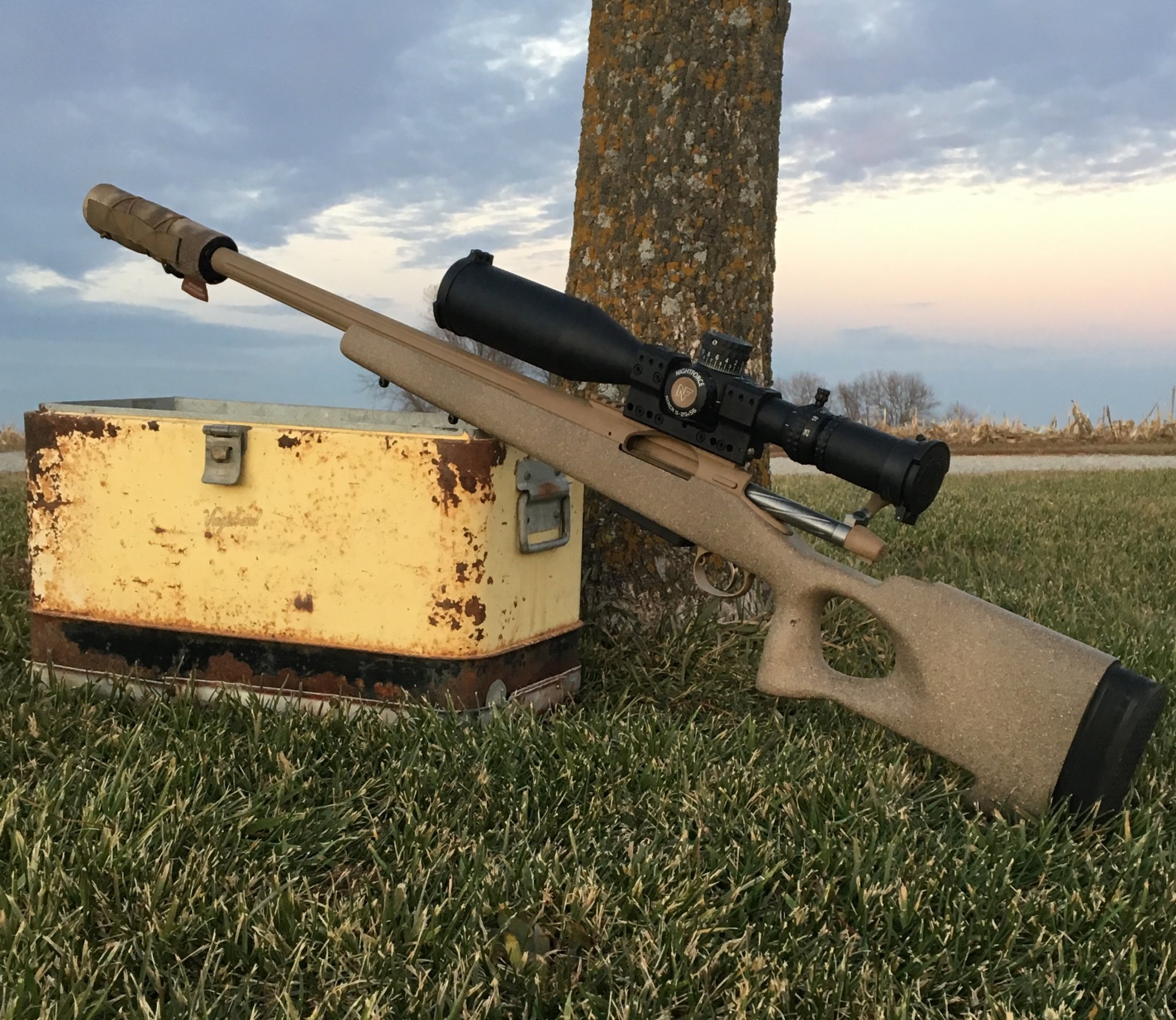

Just got this from a happy customer.
Hey Robert, just wanted to send ya pics and let you know that the rifle I had you do for my dad turned out amazing. He absolutely loves it and it’s a hammer like the rest of your builds!! Day after opener of rifle season he got a big 10 point Michigan white tail! My dad wanted make sure to tell you thank you. He adores the rifle

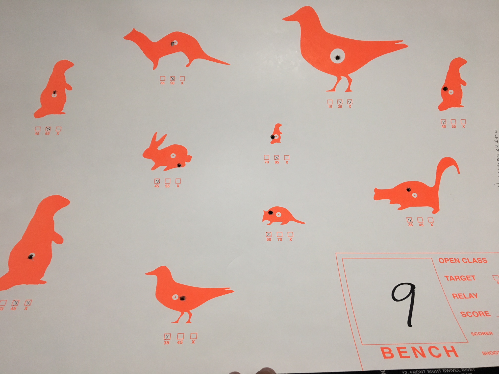

Just got this email from another happy customer.
"Robert, got my rifle end of last week and it looked great. Had the chance to go shoot it for the first time today. The first two groups are attached. Both shot with Hornady 143 ELDX. No load development needed here.
Just wanted to say thanks for a beautiful job- workmanship was outstanding, and accuracy can't be beat."
And it's not even broke in yet.

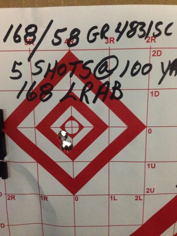

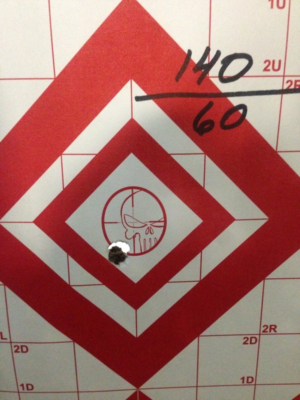

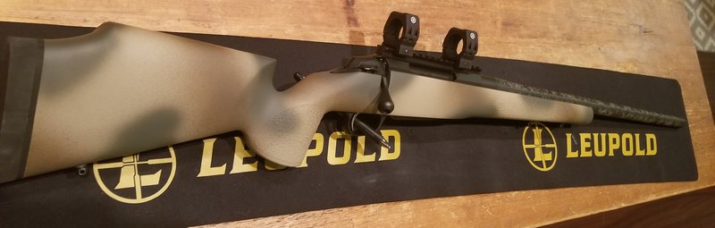

Wanted to say thanks again, dropped the 280 AI barreled action into a Mcmillan Edge stock and delivered it to my dad for his birthday. It brought tears to his eye's. He sent me this target pic today, it seems to like 140 Accubonds and 168 LR Accubonds!
