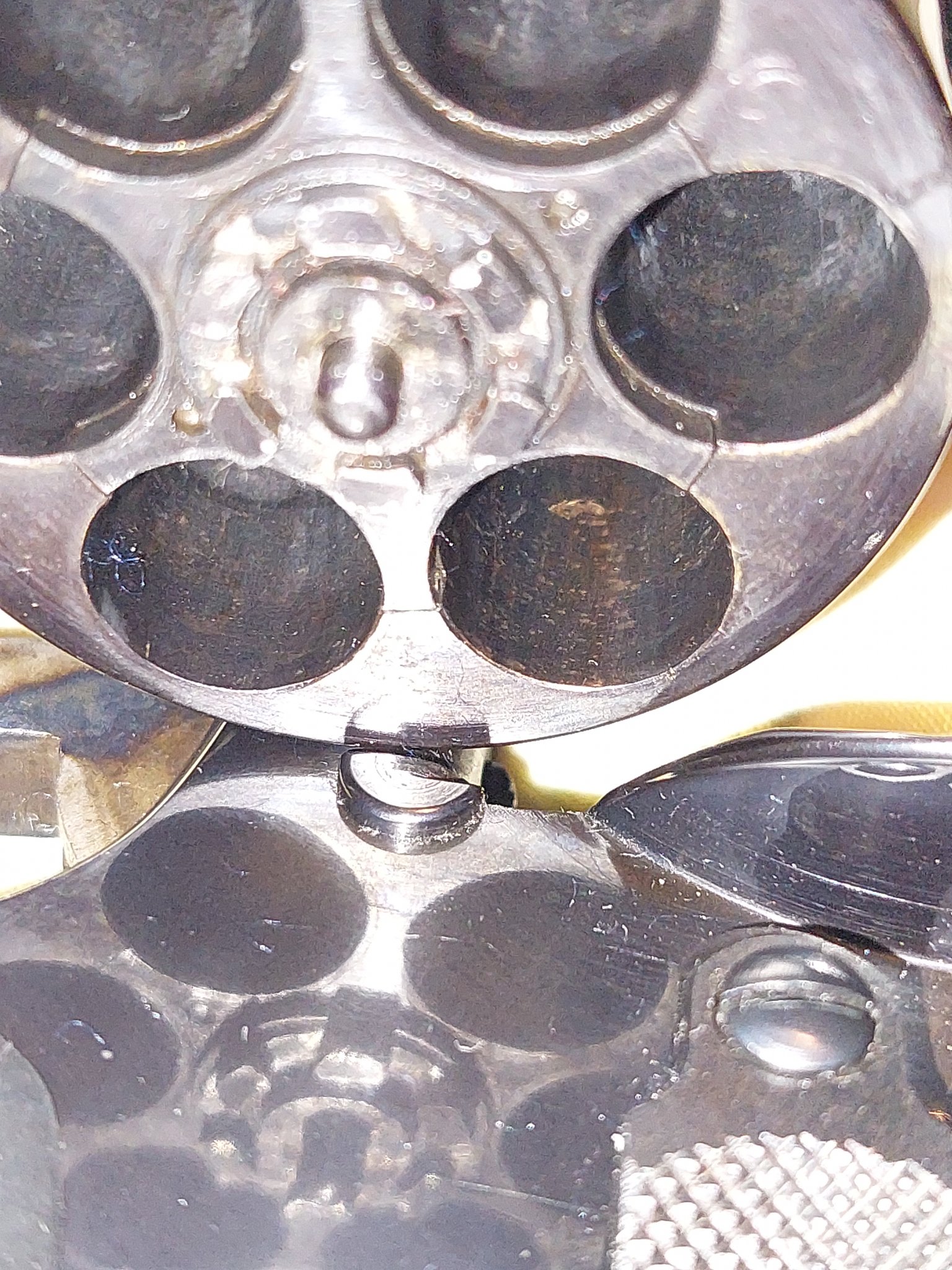

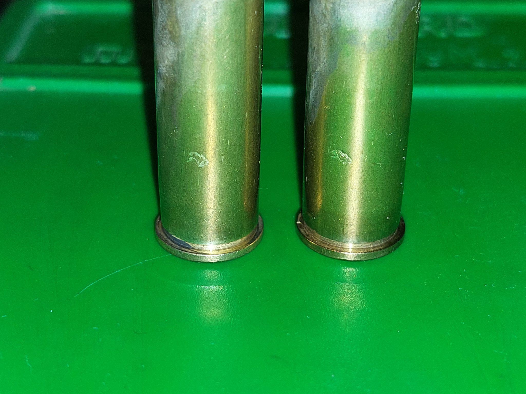

Bought a used classic S&W 29 last year and took it to the range today to test fire. One of the chambers had a very sticky case causing inability to eject. Brass had some ugly mark on it. After inspecting all the chambers one had some leftover brass stuck in it. Corresponding to the marks on the fired brass. Shot two sets of six, so two pieces of brass with the same look. I'll discard these.
I was wondering if I could just polish out that one spot in that chamber and call it a day.
Not sure if S&W would fix this for me, maybe even replace the cylinder under their (lifetime) warranty. This is a non locking older model. I'd hate to have a new cylinder installed if the polishing would cure it.
Thoughts?

I have seen that before. Mainly on bolt rifles. The corrosion is on the down gravity side. It was probably condensation. No matter what caused it. I digress. Polishing is the way to go. A little at a time. It may be more brass than corrosion. A little at a time.

More then likely likely it has not been cleaned in a long time. Get some hopes 9 and a brush or big45. The big45 won’t remove bluing.
I do have a dremel, could hit the spot with that first, then move on to the steel wool to clean up the chamber overall. Obviously I do not want to modify dimensions much.
Hell no!
That is NOT the same thing.
Goodness, do not do this. You will ruin your cylinder without a doubt.
0000 Steel wool and a bore brush is what you need and will work. The steel wool and oil will not touch the gun steel or the bluing but will card the rust off and take care of your issue based on what I am seeing in your pics.
Please listen to my advice and go spend 5 dollars on the correct supplies to do it.
If you don't have a drill, borrow one.
Hell no!

Just chatted with MK20, thanks for the advice.
Just to be clear about the dremel, I was thinking about a tear shaped felt pad with polishing compound on it. Not any sort of stone. :)
I'll give the steel wool a whirl, see what it does to that pit. If ejection is restored and brass isn't as badly marked, or leftover in that chamber I'll call it a success :)
If not I'll probably seek out a pistol smith to properly hone it for me.
I am sending you a PM with my contact info as I can help you fix this easily.
