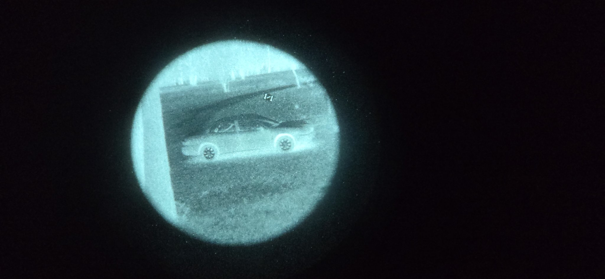

Okay, so I have spent about 20 minutes with my PAS29B. I have not tested ALL the things, as the menu and options is far more complex than the TAD. However, a few things:
-EVERYTHING WORKS! It powers on. It doesn't get stuck. The ABC works very well.
-Again...EVERYTHING works! The menu has no dead-ends like the TAD (See: Anti-lag), in the PAS29B, anti-lag works, and works well. Moving my head as fast as is sensible, my dog about 20m away blurred a hair, but "stayed in place pretty well". With the TAD, or PAS29B with AL-off, the dog would "move" his length back and forth whipping your head side to side.
-The buttons and overall "feel" of the unit is SOLID. It just feels like an MB or Audi compared to a Honda. I'm sure the buttons function the same, but they just feel better on the PAS29B. It just feels better made.
-Image quality is about the same as far as I can tell. The higher res, etc. of the TAD isn't making a difference at 1x through a tube. Even a really good tube.
-You CAN take thermal snap-shots and you CAN review them/look at them like a slide show through your NVD. You can also delete them so you won't risk filling up your 10,000 shot hard drive with nonsense.
Overall, I really wished I had just foregone the entire TAD experience. This is superior.
