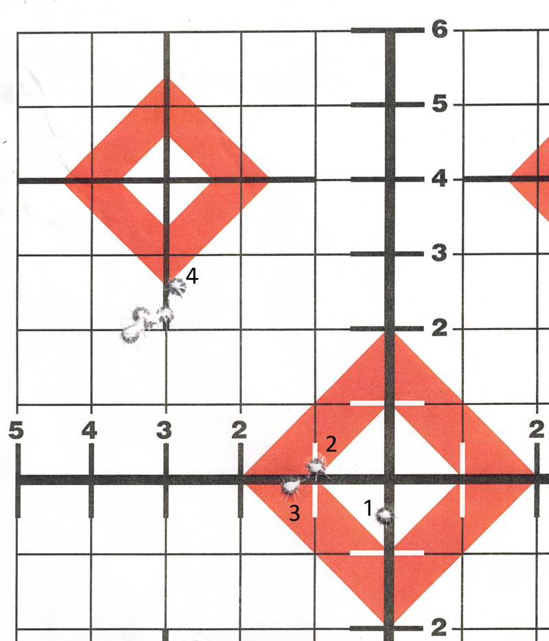

I ordered and received an S20 Hunter in 6.5 PRC this past Friday. The first thing I did was weigh it and it's 8lb 4oz which really surprised me. It's 3/4 lb lighter than my custom Kimber 8400 Proof also chambered for 6.5 PRC but not the 7.4 lb listed on Eurooptic's website. Overall I'm very impressed with the S20. Fit and finish are superb, the action is very smooth, feeding and ejection are excellent, and the trigger is outstanding. It's the closest thing I can find to a "hunting weight" AI.
After zeroing the scope I shot two 5-shot groups using Hornady 147gr ELD Match. Here's the second group.
Here are the first eight shots through the rifle. Shots from bore sighting are #1, #2, and #3. I made a scope adjustment after #3 and then aimed at the bottom of the diamond at top left. Shots #5 through #8 went into 1/2 moa.
Nice result. In regard to weight, if you read a bicycle catalogue they show the weight for the smallest frame size in that model; if you read a rifle catalogue they show the weight for the version with the biggest hole down the barrel and complementary lightened stock, i.e. the wooden stock with a great big hollow in the buttstock or synthetic version without any balance weights hidden under the butt plate (or in the pistol grip).

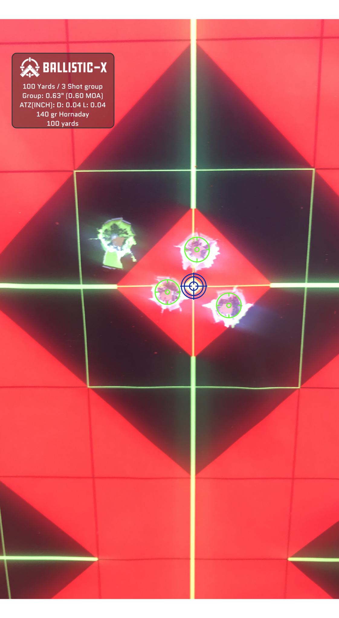

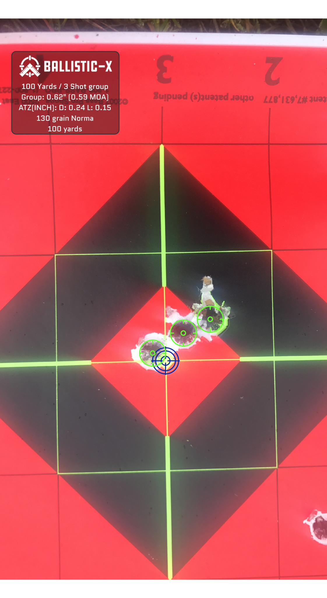

on another note, . . . happily
after two trips to the range, and maybe 120 rounds down the pipe
it seems to be a .6moa gun FOR ME, from the bench, on a bag in front, and squeeze bag behind.
this is with :
hornaday match 120's,
federal GMM 130's
Norma Match 130's
and hornaday match 140's
the "flyer" on top target (to top left), is from a different string,
I was running out of targets, and had to do some double duty with groups, on some targets
Ballistic-X-Export-2021-02-12 14:08:57.829465.PNG
Ballistic-X-Export-2021-02-12 14:55:58.380717.PNG

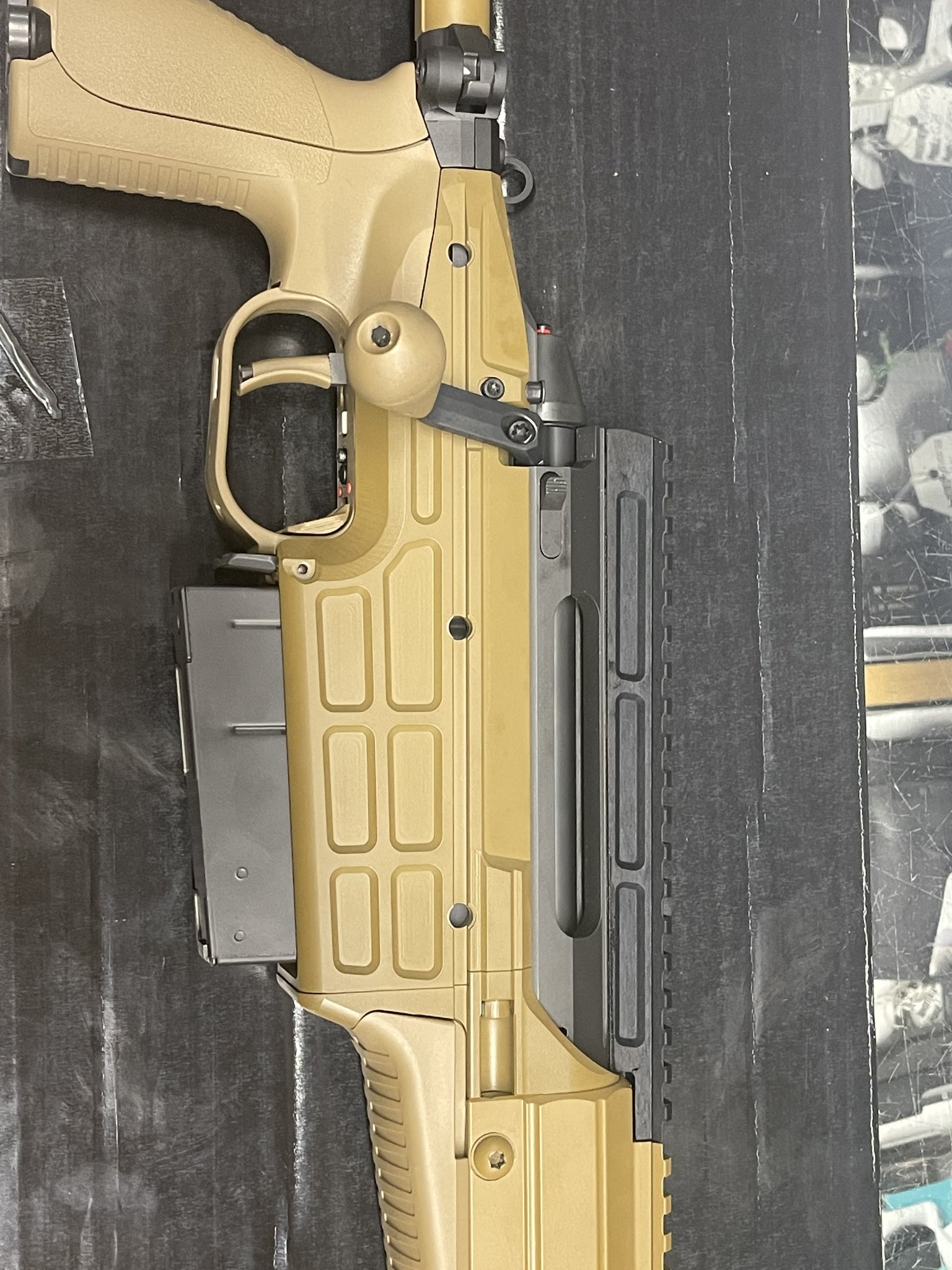

It's called a TRG M10/A1 if you want it. Or a TRG-22 with a KRG/Vision/Cadex/Pau-Tac if you prefer to go that route. Then you would not have to deal with the split pic rail.
IMO Beretta dropped the ball on this one. It is a very good rifle. But as with all compromises...
Only a sample size of 1, and the user might have ham fisted it, but another forum a poster had the stock crack where one of the bolts connects to the chassis. Not much detail if it was an action screw or one of the screws that hold the plastic forearm/rear stock to the chassis. If it was just the screws holding the plastic stock/forearm "slabs" on I could see that happening if you cranked on them, especially if they are not metal interfaced like say the AI forearm slabs are.
I had this happen to two thumb rests for the precision butt stock, but that could very well be from me over tightening the screw. I have not been able to find some solid torque values for that particular screw (although admittedly I have not done too in depth a search and might have missed it in the manual). I mainly use the hunter butt stock now and it has been great.
The only other real issue I have had is from adjusting the trigger pull weight down too much. If you go too low the safety does not work and sometimes the trigger does not reset so a heads up on that. I had it down to like 1 pound 8 oz and it worked most of the time, but I didn't feel quite right due to the safety and trigger reset issue.
Overall, I love the rifle though. It shoots a little more accurately than my tac A1 and loves most of the ammo I have fed it (FGMM, Federal Berger hybrids, ADI, and Norma especially). I have only been able to take it out to 700 yards so far and it can consistently hit 4x4 diamond plates even though I am new to shooting past 300 yards. The only thing I am unsure about is barrel changes, but in a 308 there will be time to figure that out.
You mean this one on my bench? Lol.
So you had a 42A1 and bought a S20 then asked for what you already have? Bummer... 😉
Me thinks "The King" is in need of better advisors... 😁
The 42A1 is an S20 ($1600) and a $1500 stock all for the low low price of $7999.

wonder if some graphite kinda liberally applied down in there, would do the trick
I need it extended to the nest-to highest position to get good visual alignment
Mine is really hard to adjust too. I had to press that lever really hard until I hear a click before I can move it.
