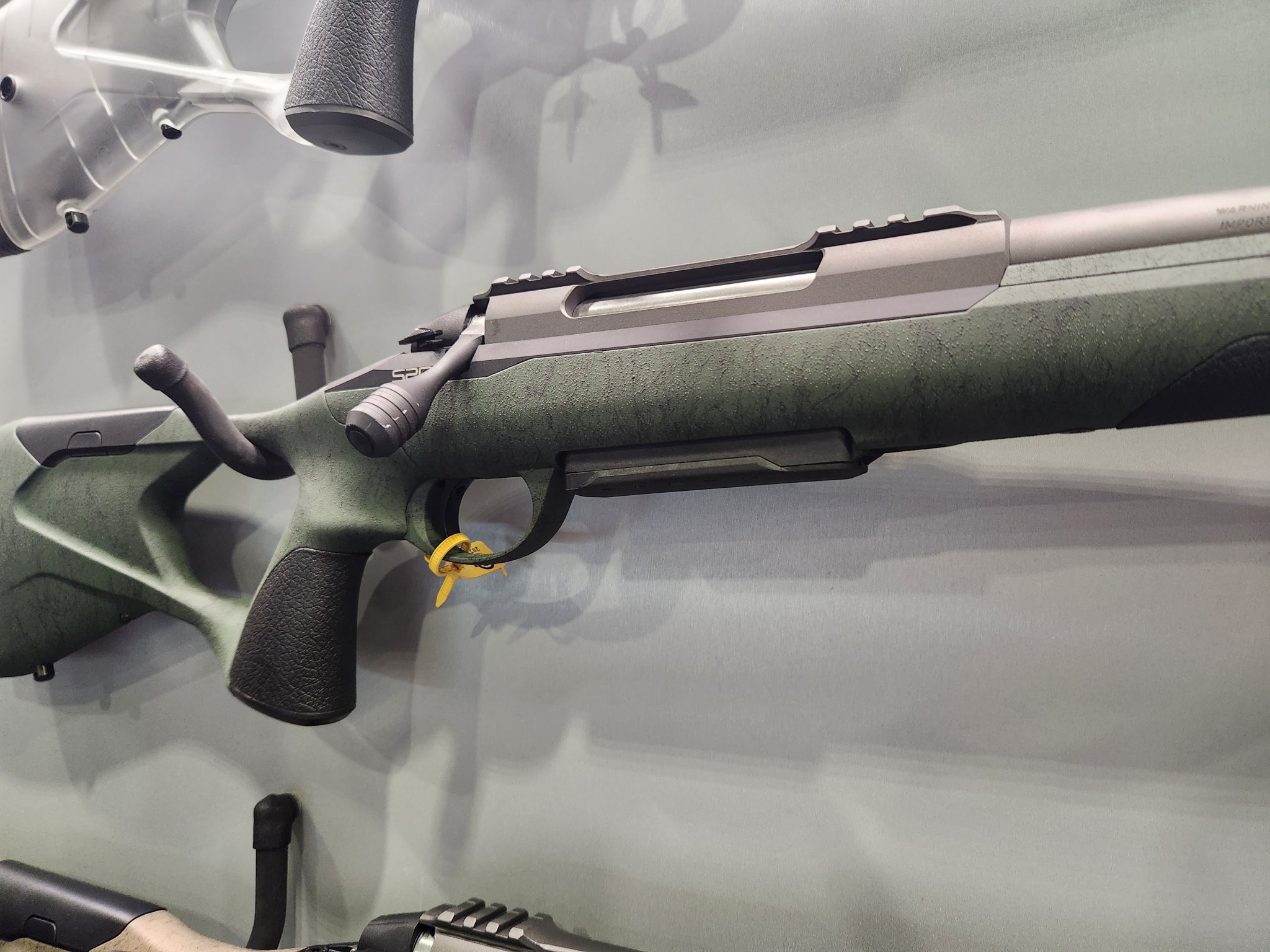

Per Beretta/Tikka at SHOT only the S20 hunter model will remain and they added the Roughtech stock which is noticeably nicer than the original.
Well that's good, sako should be ashamed of the old creaky cheap feeling plastic version. Wonder if we'll be getting the 2 stage triggers and heavier barrel options. Hopefully they also fixed the mag feeding issues many have been reporting.
