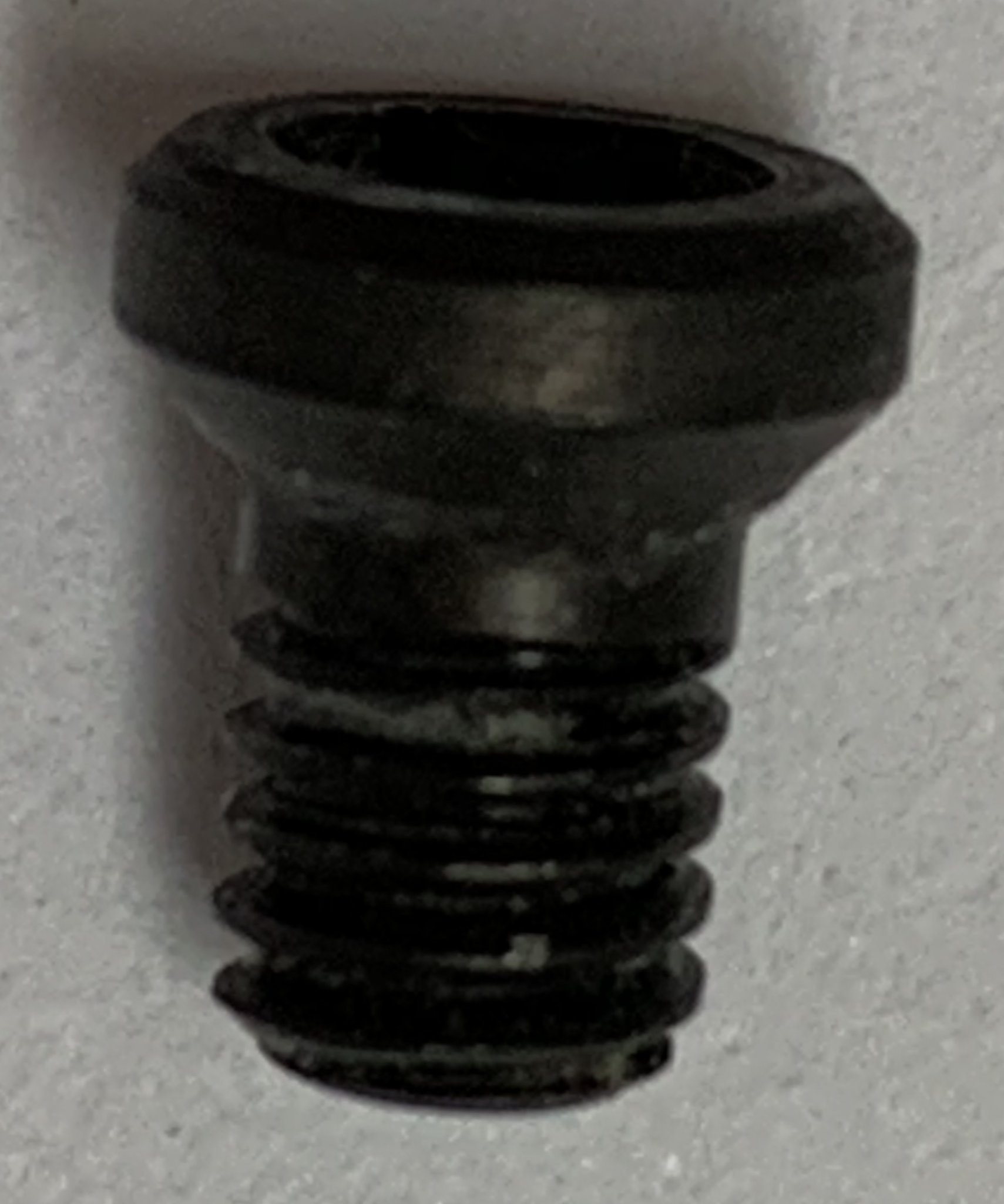

One of my original rail screws has a major thread diameter that measures 3.335mm, an OAL of 6.239mm, approximately 4mm from the end of the taper under the screw head to the end of the screw of which approximately 3mm is threads, the head has a diameter of 5.256mm and takes a T15 Torx Bit. I don’t have a thread pitch gauge handy.

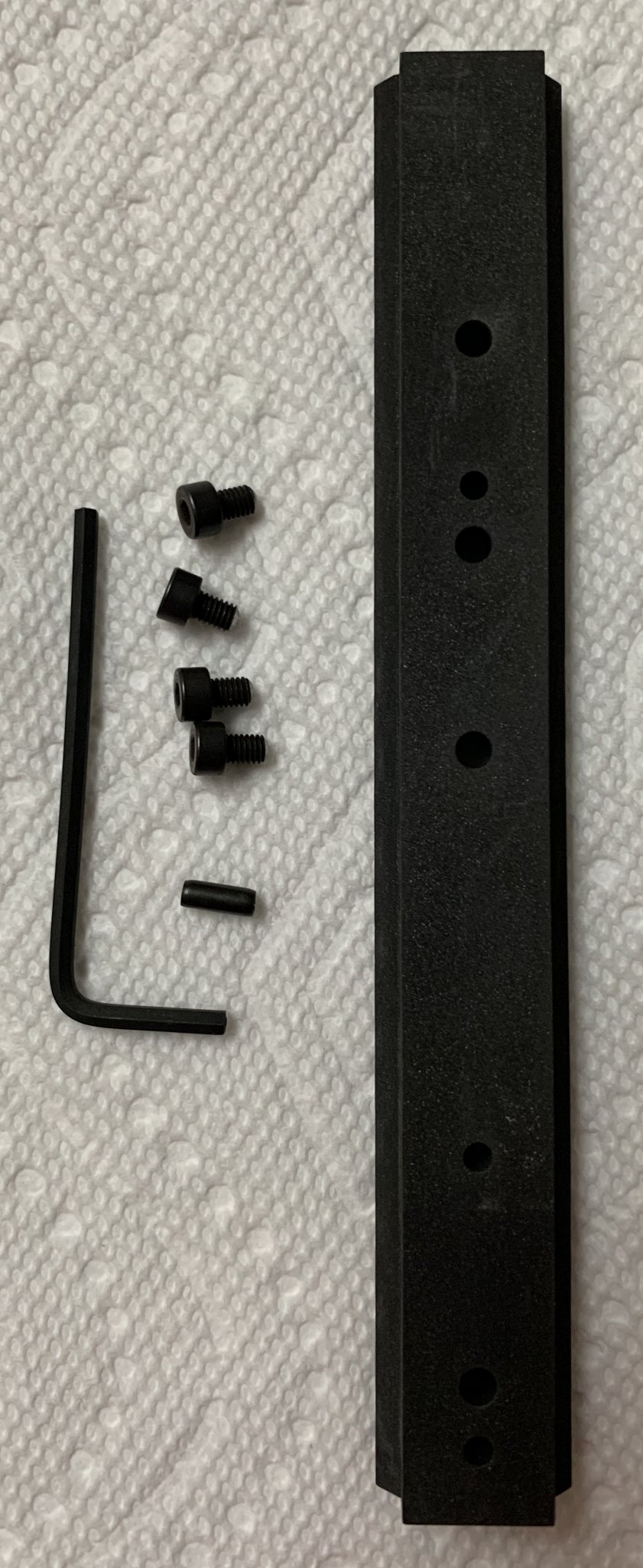

Measuring the screws I have yielded these figures:
5.25mm diameter at the head
3.3mm major thread diameter
6mm overall length
I don't have a solution yet but at least I know what I'm looking for!

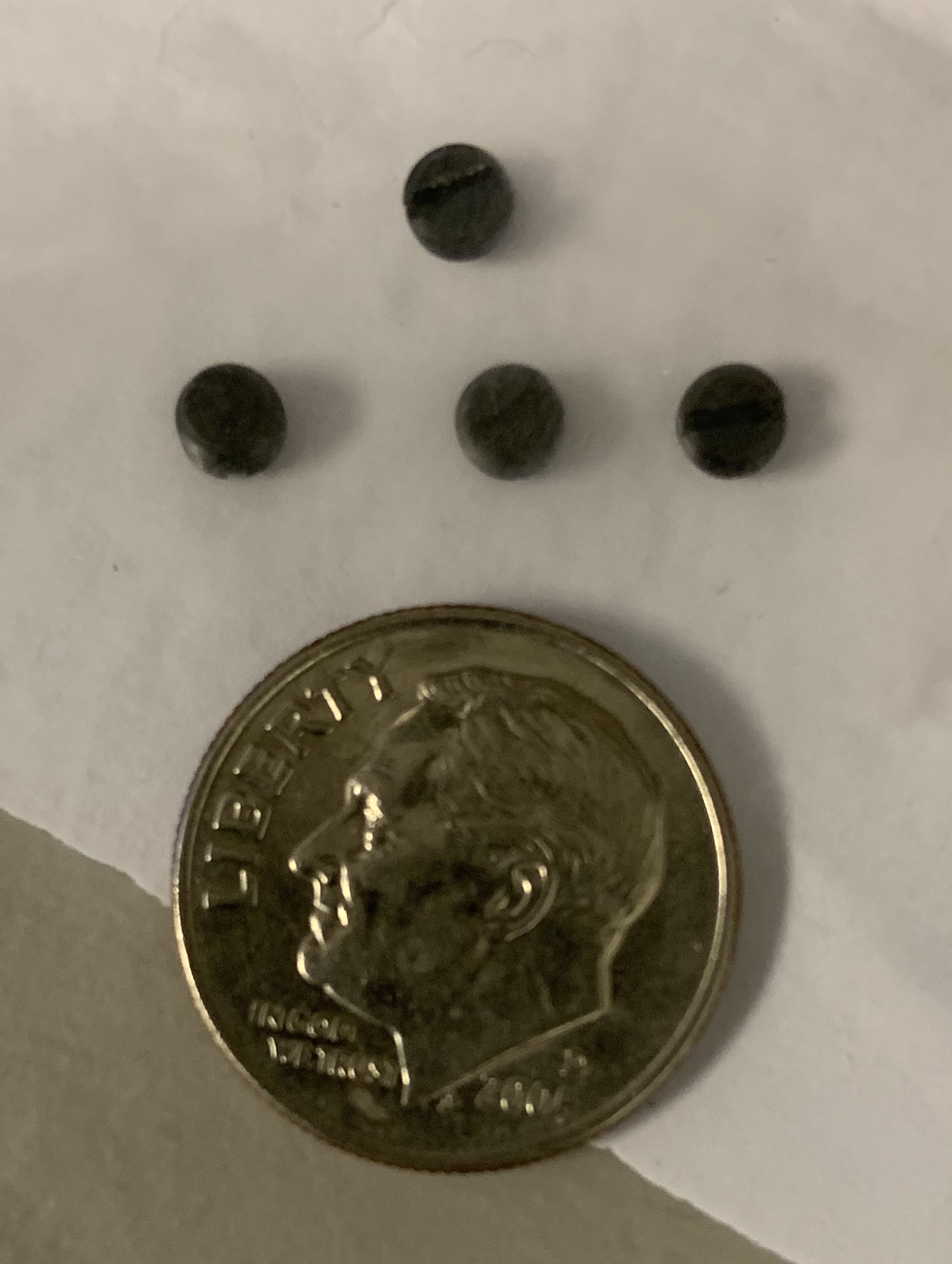

Since this thread is about Sako TRG rail screws, here’s a pic of the screws that fill the holes left by removing the factory rail when you put a Spuhr mount on, they‘re 3.5mm like the rail screws and measure 2.54mm in length. I tried making these but ended up buying the Sako screws... for $33.99. (Is anything Sako cheap?)
Wow those are tiny! I didn't even think of needing to do that...
The $35 is worth satisfying one's OCD though.
Also - wanted to mention - Shars is a dead end for now. I'd have to buy the screws I think might work and then return them. Because everyone is working from home they aren't there to measure, unfortunately. Since I have the EGW rail and the screws for the regular rail coming (still need to decide what I'm going to do now as far as that goes) I think i'm done hunting this down...but maybe the next guy will benefit from all this research.
That’s why I posted the plugs, I had pulled the Spuhr off and found that some solvent had crept through the open rail mounting holes while cleaning the bolt rails and chamber and had started to etch the receiver and Spuhr.
Ouch! I'll have to watch out for that depending on what holes end up plugged/not plugged.
