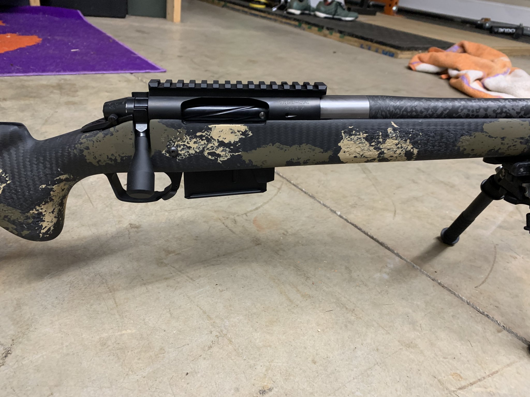

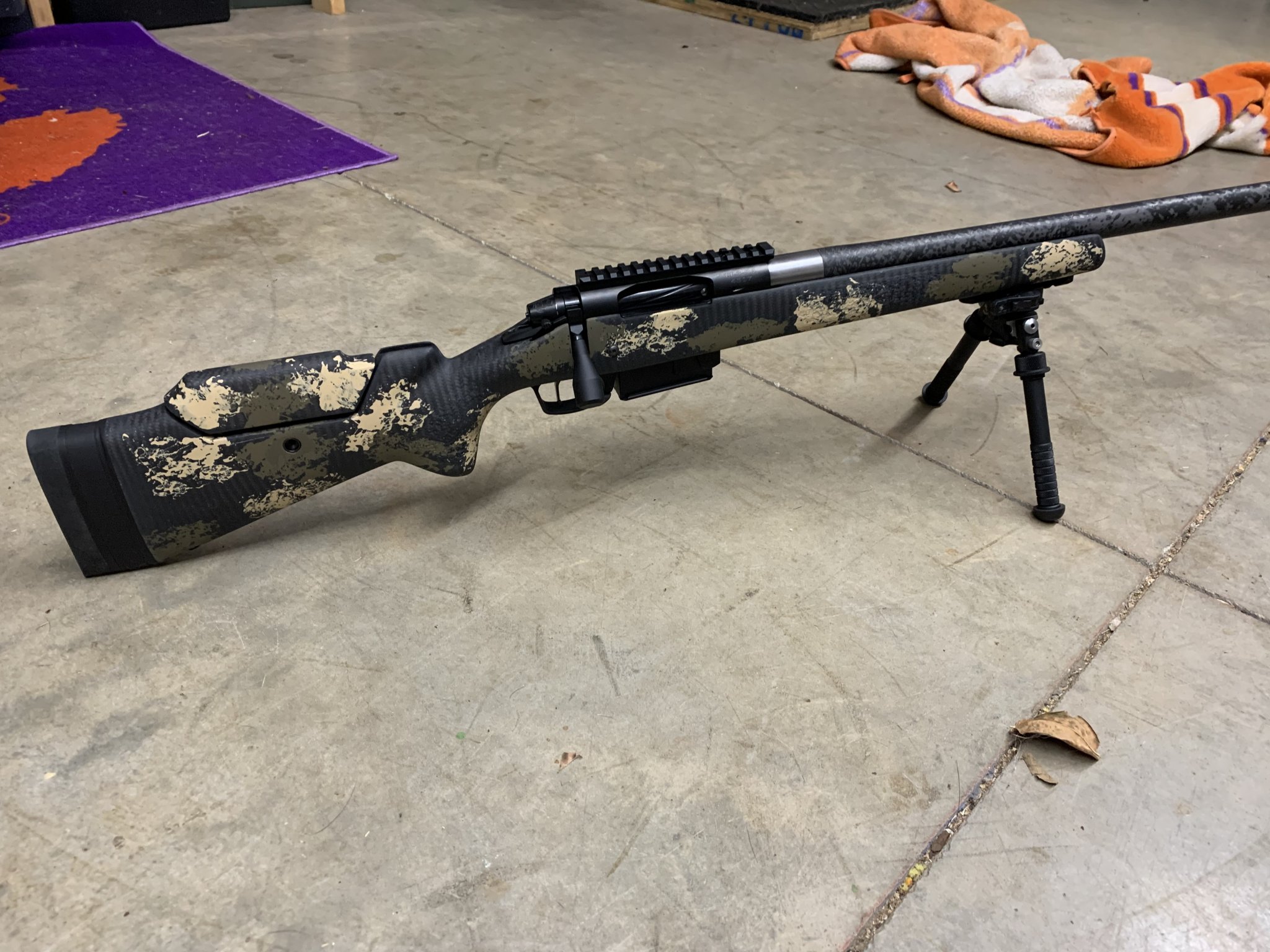

Here's what I put together, it's pretty close to what you're proposing.
Manners MCS-TA
Zermatt TL3 SA
Proof 20" CF in 6.5CM
Triggertech 2-stage, flat shoe
Scope will be a S&B 3-20x50US.
Rifle as pictured is right at 7lbs.
I own a 18.5" barreled 308, and would recommend sticking with the 6.5CM as you mentioned. You mentioned the XM-3 style, and keep in mind that's a #7 taper barrel, which is a boat anchor. If you're thinking about the XM-3 in terms of trimming weight, I can assure you this is NOT the case (I can post pics of this taper if you'd like). If you mean something else by "XM-3-ish", please clarify.
Also, if you don't have the gear to assemble the rifle, keep in mind the boys at Altus will do an assembly and function check for a small fee. You'll pay more in shipping than a shop fee, but it might be worth it to you. In all, it sounds like you've put together a solid build.

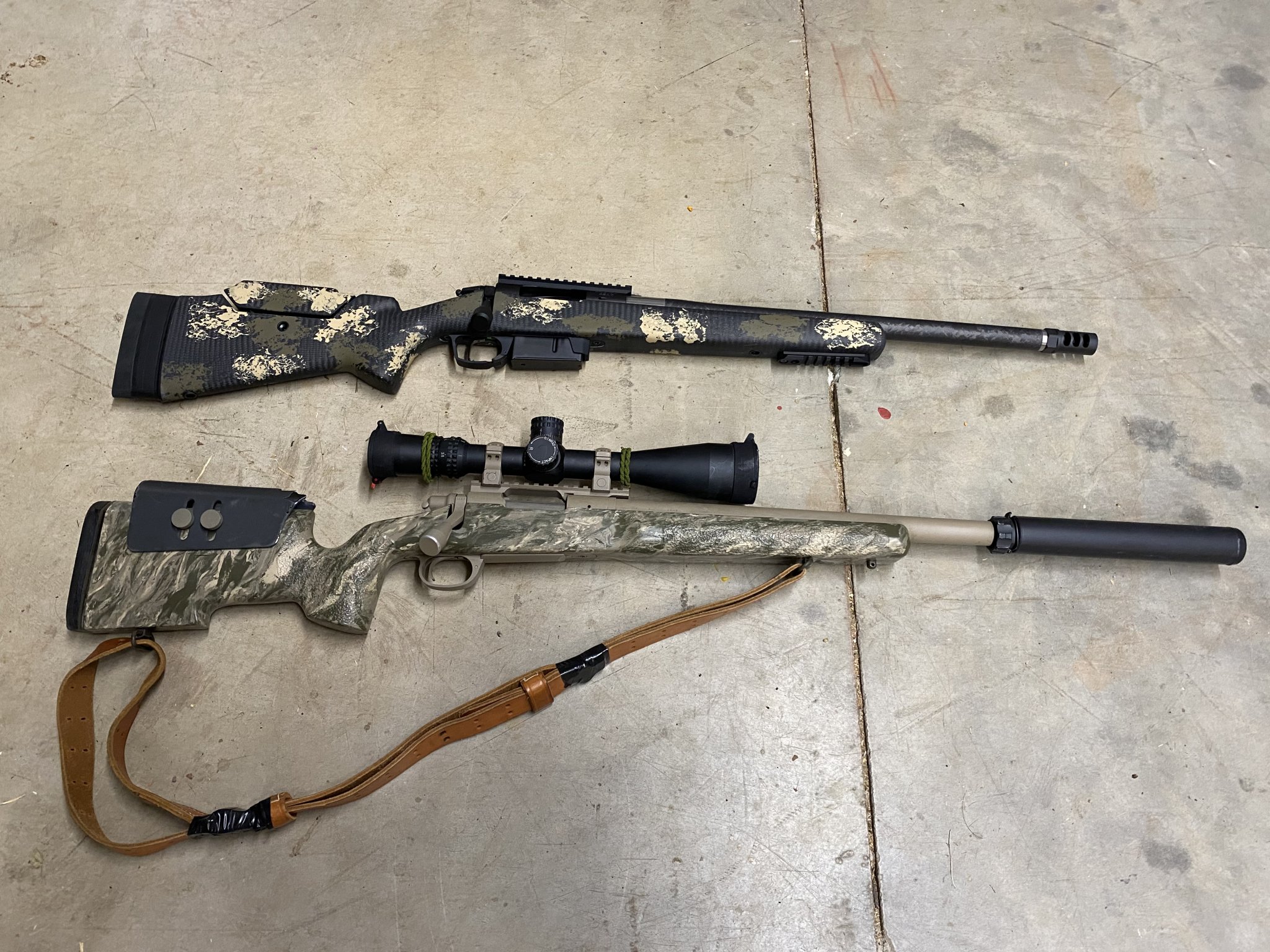

For reference, here's the rifle next to an XM-3. Only difference from the .mil version is the McMillan A5 stock (pictured) vs. the A1-3. Difference in overall length is 2.5". The picture makes the XM-3 appear much longer.
The XM-3 is a heavy bitch. Incidentally, its weight while being used hunting that drove me to the newer rifle. Advances in CF stock and barrel now give you the feel of a larger rifle at about 10lbs less.
