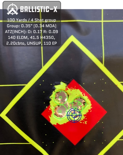

It’s an accurate gun, especially now that I’ve tuned a load to it.
The long road to get there is what turned me off of Savage.
