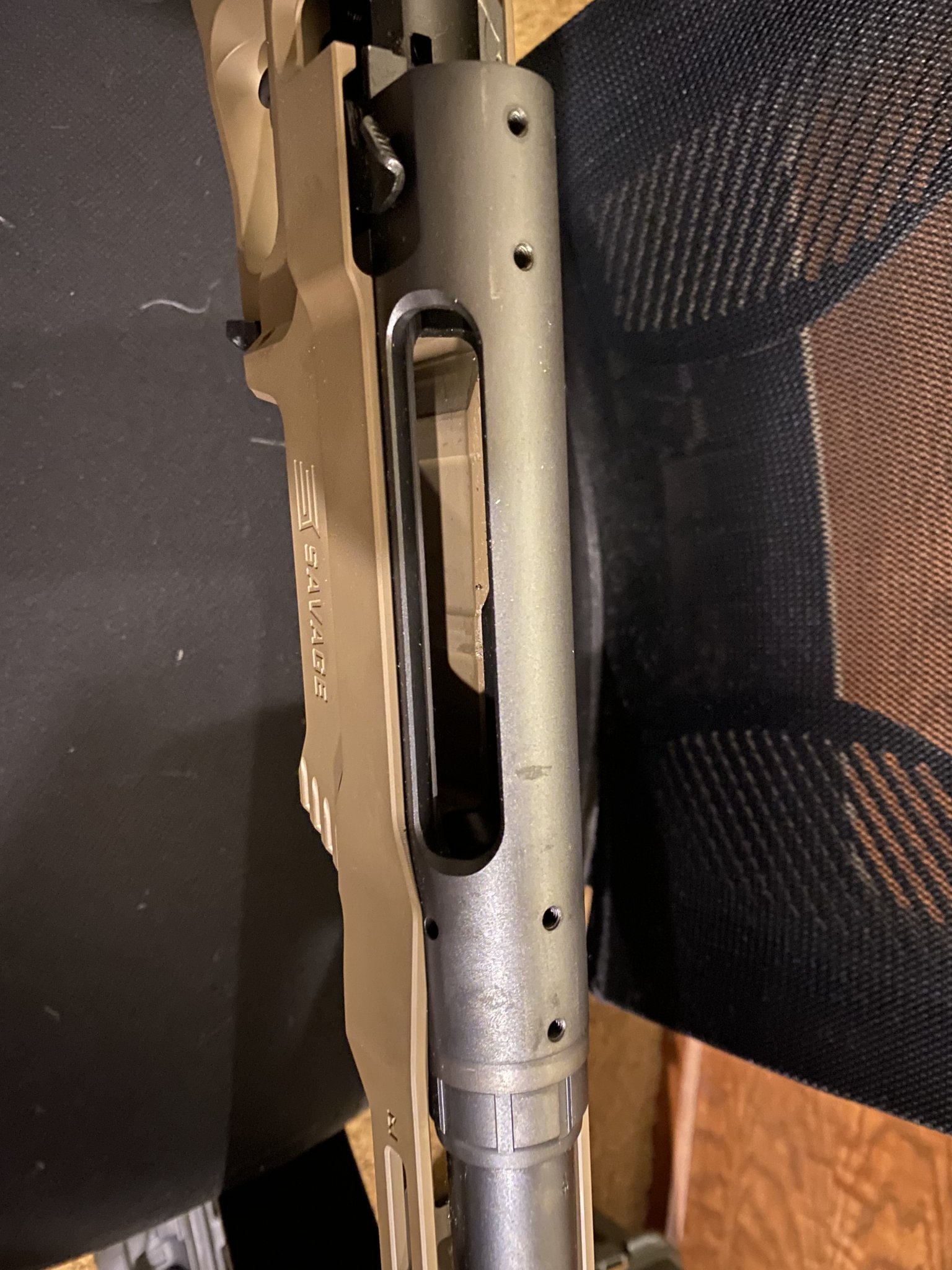

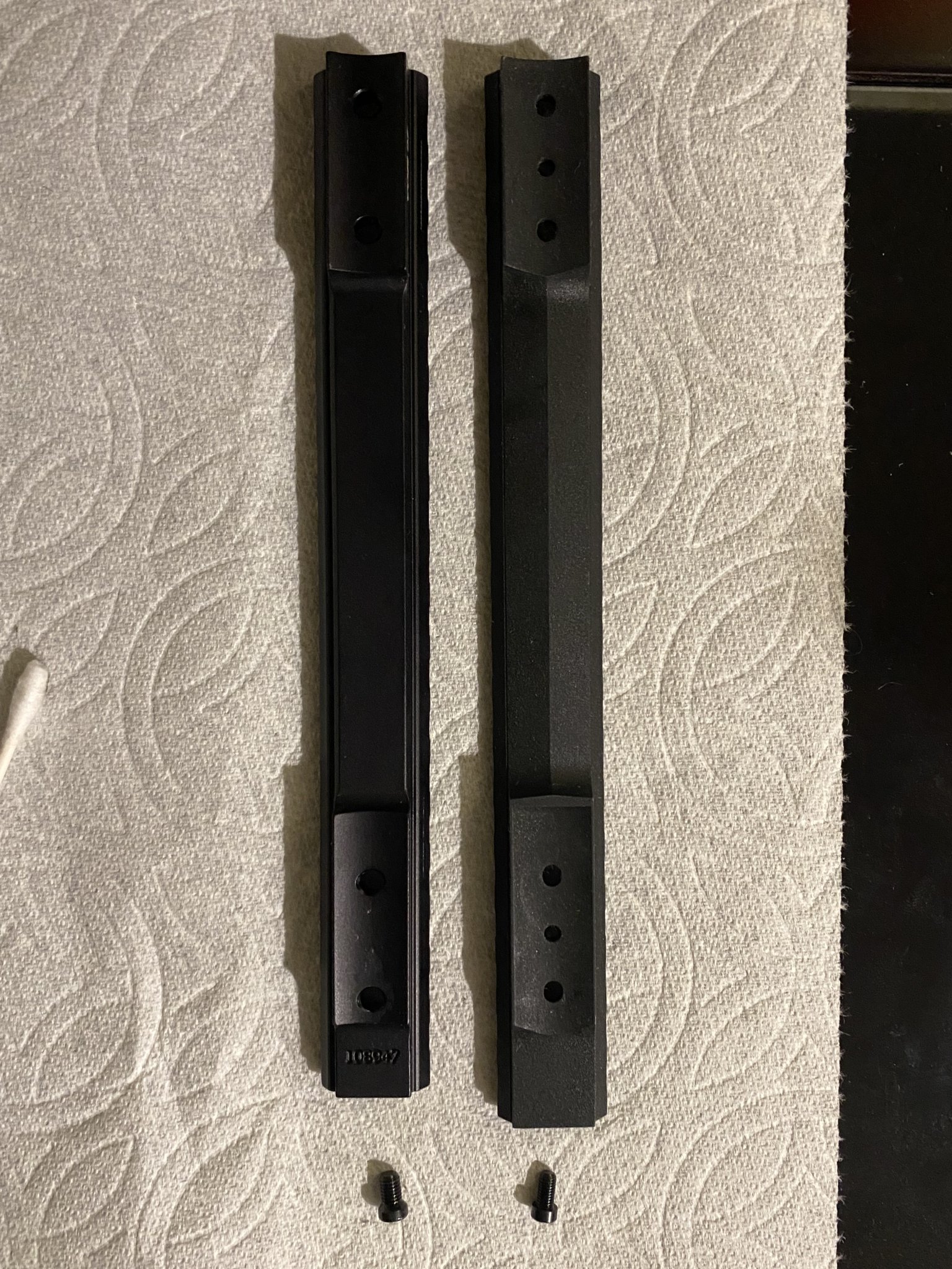

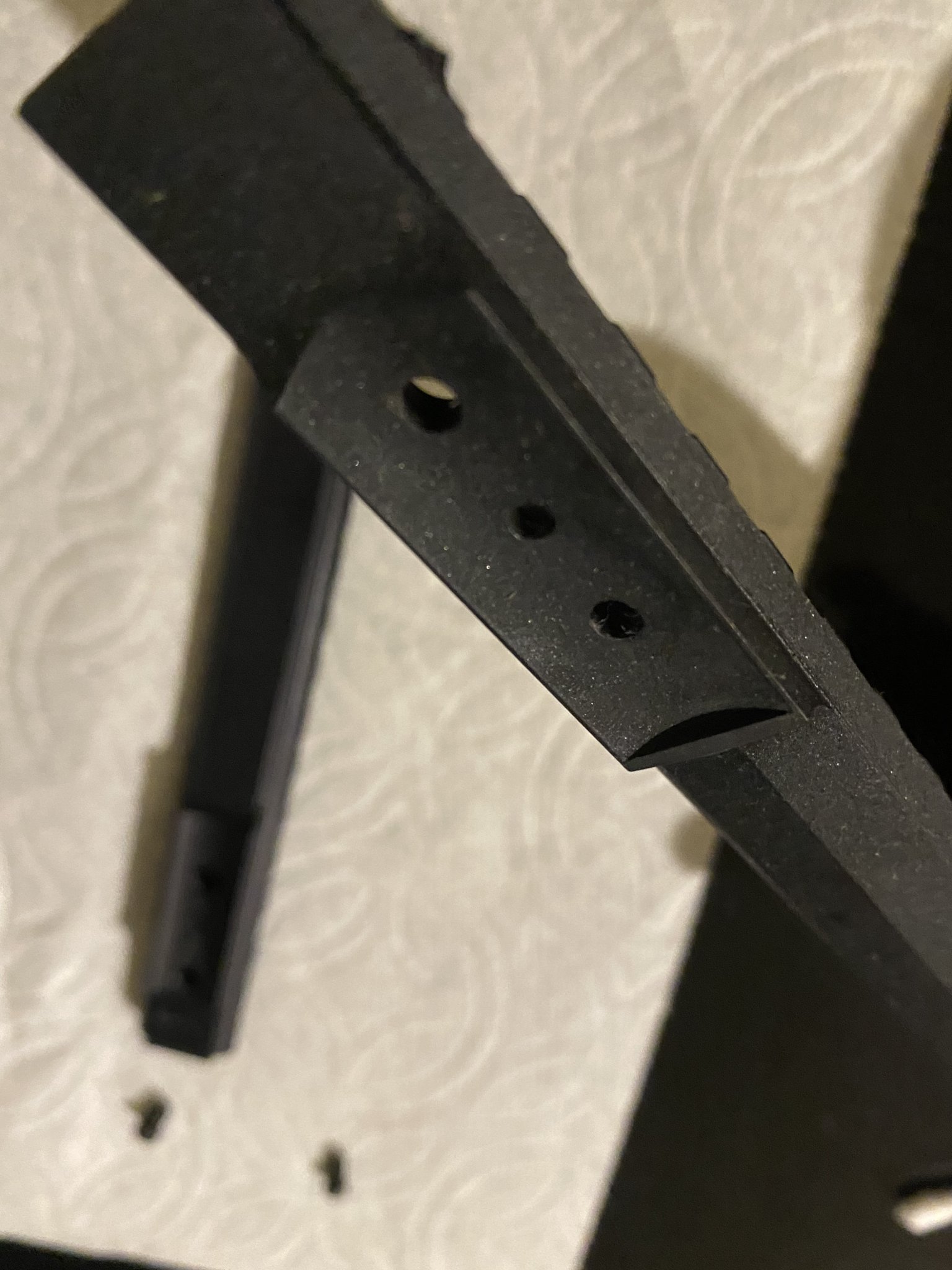

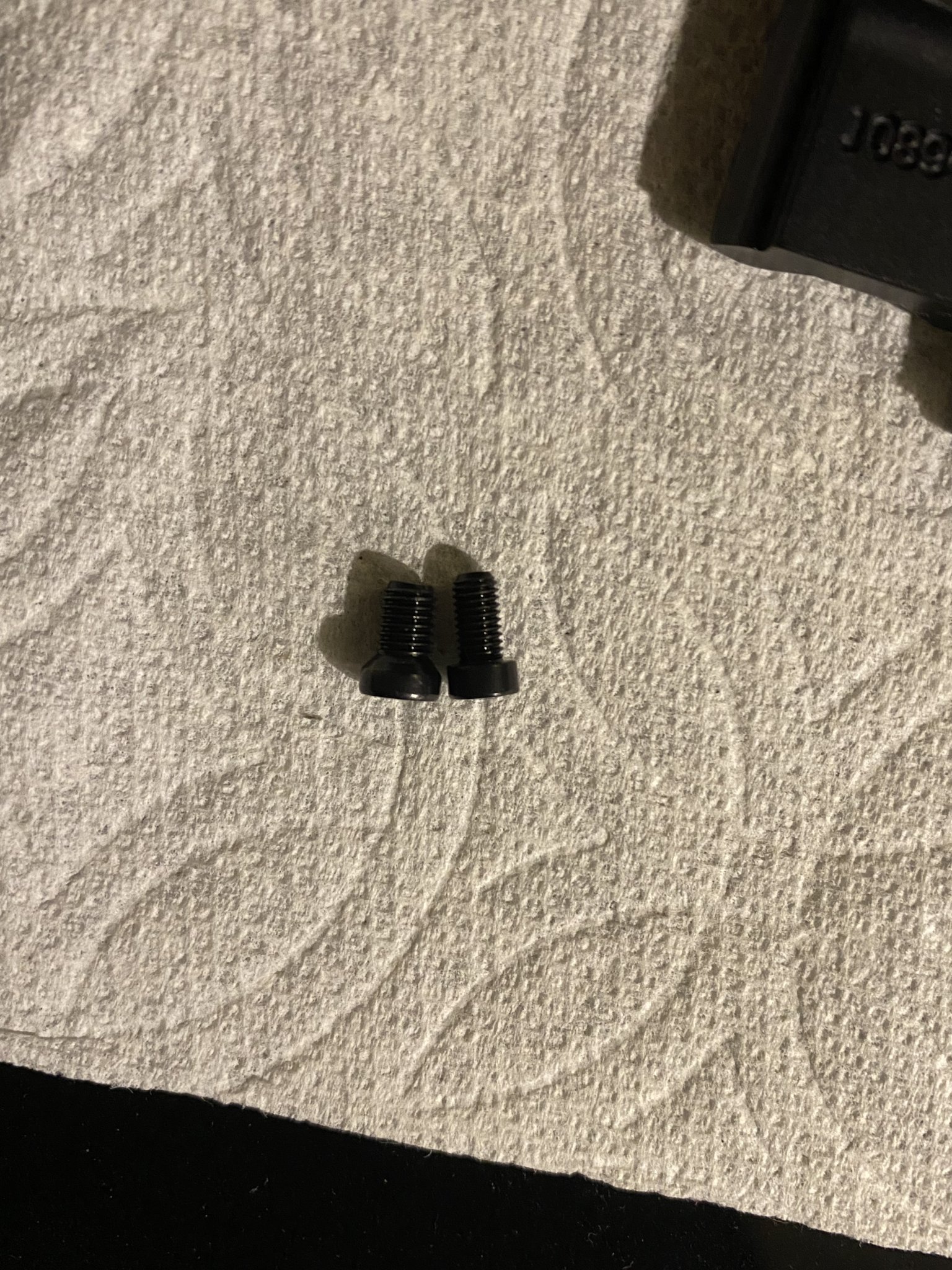

The above is my receiver, and the other images are of the EGW rail that came with it, and the badger ordinance rail that is supposed to fit. As you can see, the badger rail has a recoil lug, but the design of the action doesn’t have a gap above the ejection port. So the recoil lug won’t allow the rail to fit flush. And, the screws that came with the rail are too small for the holes on the receiver. I’m thinking I just drill out the holes on the new rail to accept the larger screws.

I bought the one for the Savage 110, Long action, Accutrigger model. The only other one that may fit would be the "Lapua only" or the 110 BA stealth maybe. Curios if anyone else has switched out the EGW Rail or just stuck with it.
