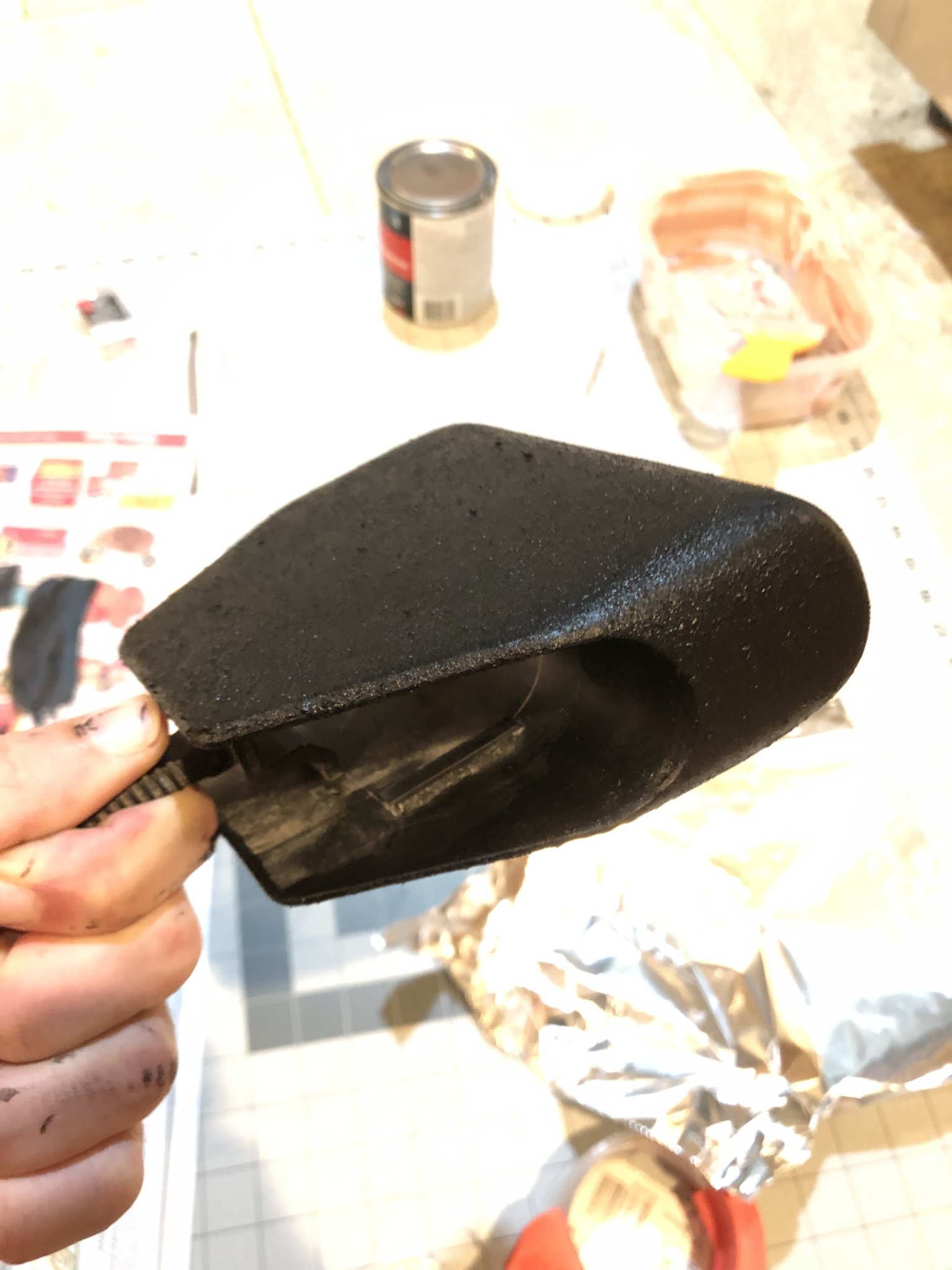

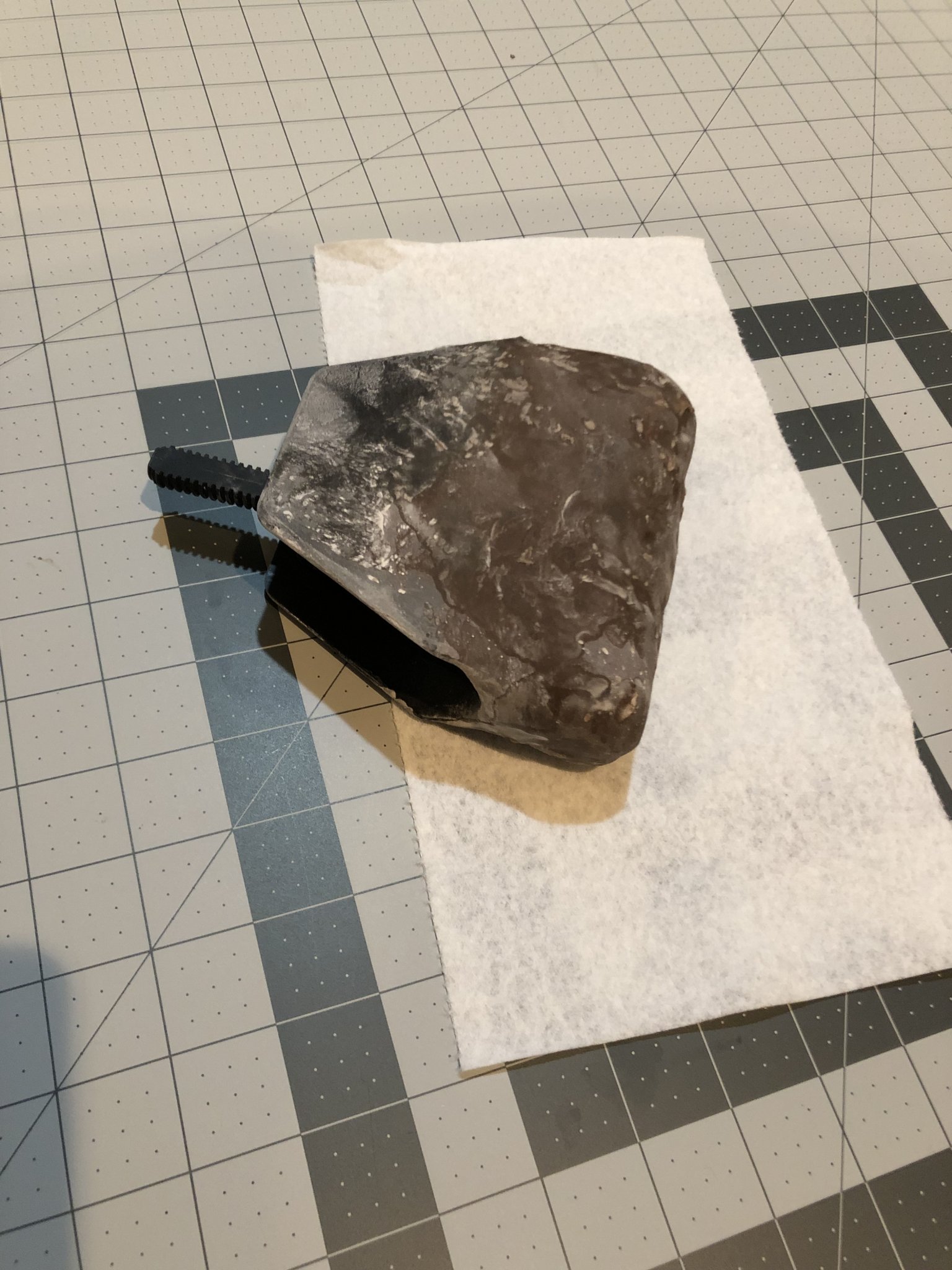

Yeah the 20MOA on top of giant rings to clear even a modest scope and the scope’s axis is almost 3” over the base of an AR stock. I just cannot believe every single person who purchased one of these is not posting this is an issue. Swapping the stock or casting a mold for a new riser is not a huge issue for me. I just wanted to make sure there was not some mystery piece missing from the box. That and I was starting to get self conscious about my head.
Reactions: Boss334OP
Trust me, it didn’t start that way lol. I’ll get some photos of it on the rifle later.
