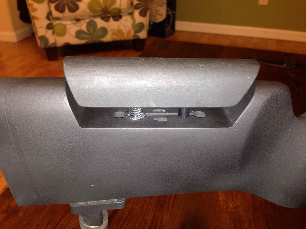

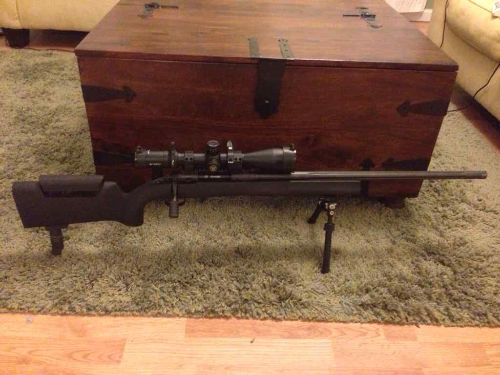

The 10fcp is a fine rifle. I have owned 2 (first was. 10fp) and they both have shot .25 MOA out of the box with 168gr FGMM. My current 10fcp HS has the flutted and threaded 5r barrel. I will say that the palm swell on the HS stock takes a little getting used to but it's not too bad. You will however definitely want to add a cheek rest of some sort to the stock. I decided to add the KMW Loggerhead instead of the kydex style. It took about a week to install ( little here and there), but it came out super clean. Here are a few pictures ( I have since changes scopes, rings and added a brake): ATTACH]24209[/ATTACH] ImageUploadedByTapatalk1387430011.106411.jpg

djdilliodon is that all I have to do is switch barrel to make it .223? jlitalien that is a nice job on cheek rest looks clean I'll either do that or the ky Dex. Is the trigger on the savage good enough or does it need replaced or have it tuned
