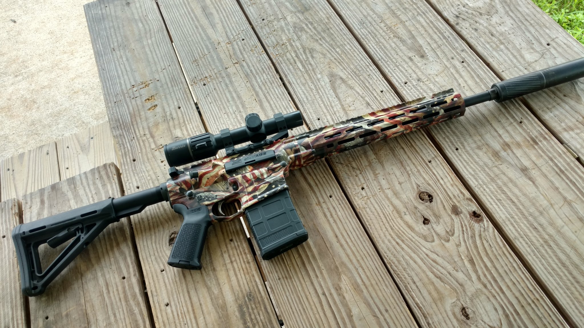

Thanks for sharing your observations. I'll be taking mine out again this week and hopefully have some FGMM to try. I haven't taken anything apart on mine and likley won't. Mine is the Hunter so my expectations aren't the same. It just needs to kill pigs so if it gets less than 1.5 MOA with whatever ammo I choose, I'll be happy. I do love the weight and balance of the rifle so far.
Don't laugh at the finish, this one was about $200 cheaper than the plain black model so I jumped on it. There's always Krylon.

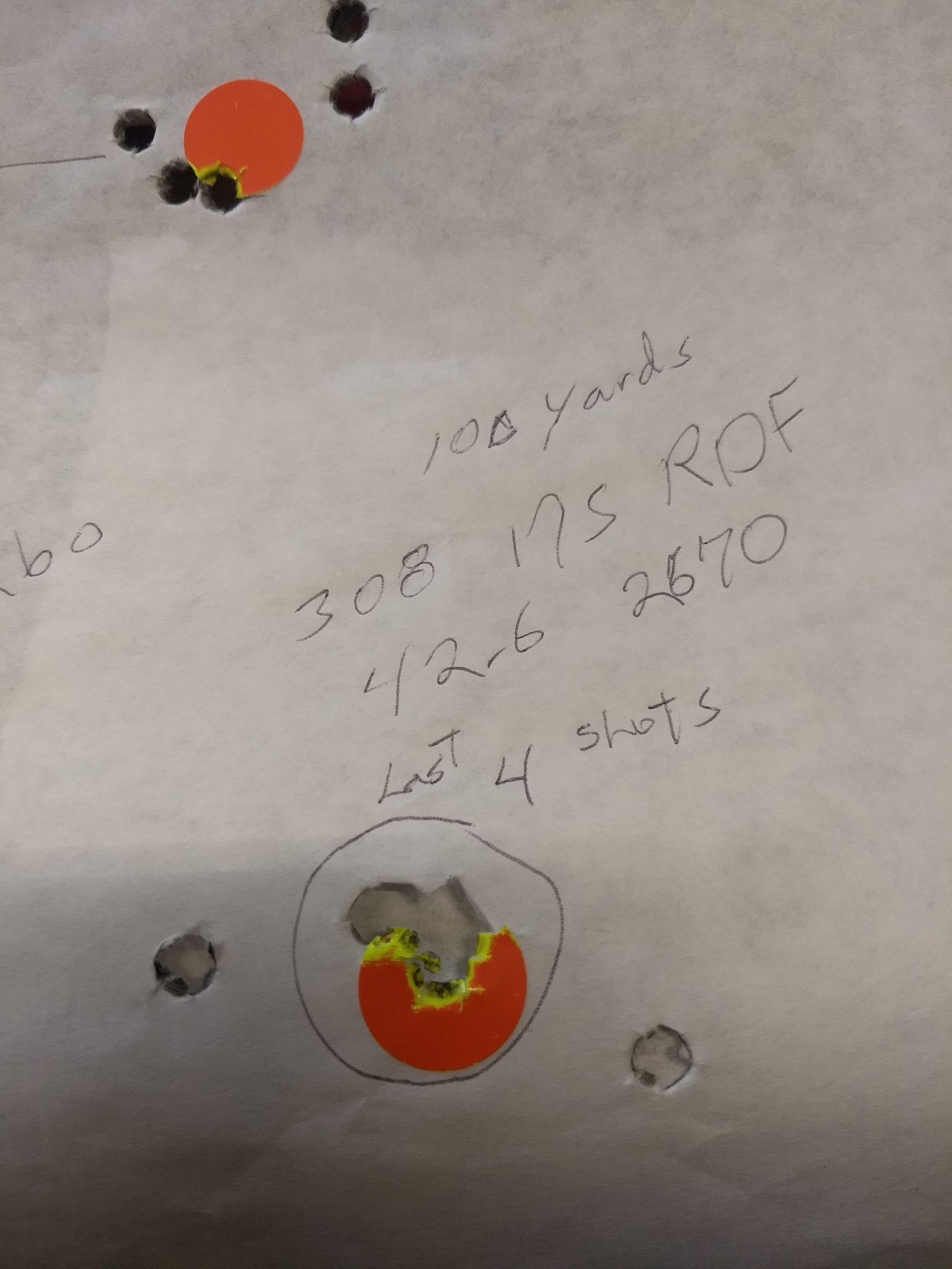

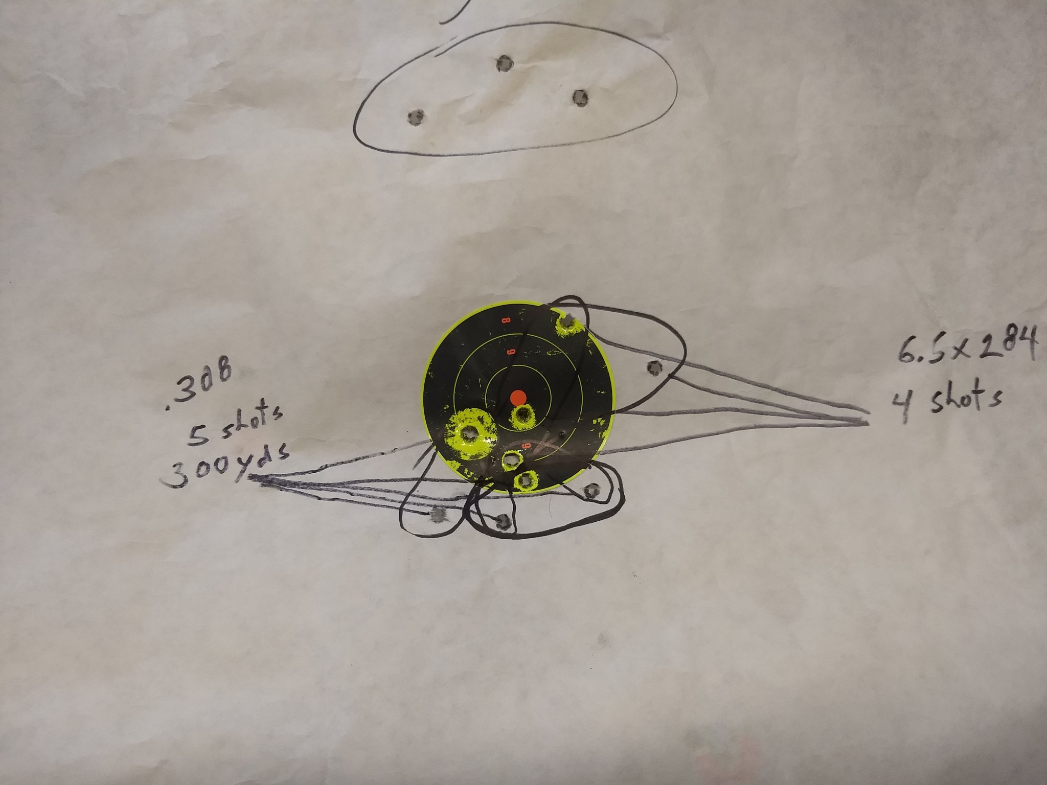

Ok, so I finally got out to get in some range time.
Heading on a Elk hunt in one week a needed to get some rifles sighted in.
Took 4 to decide what I will take on the hunt.
1. 6.5-284 : barrel just about shot out
but still #1 choice. Wt 11 pounds.
2. 260 rem: excellent shooter but Wt
is 14 pounds.
3. Straight 284 that wt. 6 pounds but not
set up to shoot a long ways out.
4. Not in the running but had to shoot
it : Savage MSR10 LR.
I've done some work to it but wasn't able to get the accuracy out of it.
Took two loads for it. 41.6 g 8208, 175g RDF. The other load was 42.6 g. 8208, 175g RDF.
These loads I have shot before and was giving them one more chance. LOL!
Well I think I cracked the code after a lot of work and fluststration. The last thing I done was glue the barrel to the action. That was a least 2 months ago and I've been to busy to shoot it.
To make this story shorter, things didn't seem to improve at first.
But tried a little something different.
I may be wrong but I griped the rifle just like I grip my 45 (VERY TIGHT)!
IT SHOT EXCELLENT! 4 shots just over .33" then I shot it out to 300 yds. Holding one mil high and I was very happy.
These images are confusing but first one was 100 y. I shot a lot of rounds with different rifles and this was the last spot on the series. The two that bracket the dot were the first two.
Then I held the rifle different than before and shot the 4 touching.
I also had a target in the next image at 300 y.
I was using it for two rifles.
Anyway the impacts for the .308 were great for me and this rifle.
Right now? NO MORE BAD MOUTHING SAVAGE?! Maybe it is the Indian and not the arrow?
