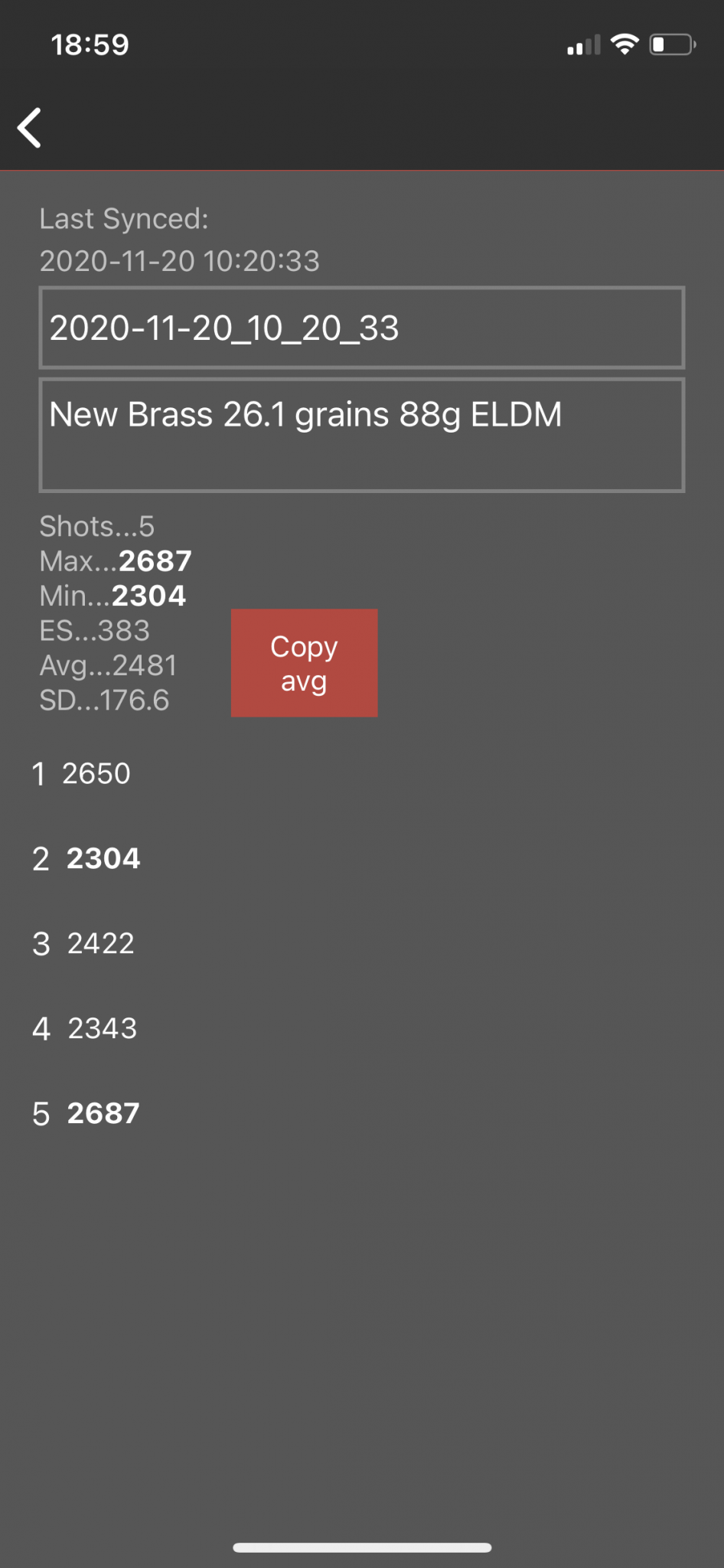

Totally agree that it is a waste for the most part. I would be happy with SD’s above that but I have not been able to get even close. Here is the results of one of six tests done today.
How's the battery in your magnetospeed? Sometimes I'd get wonky readings when it got low.
There are several things it could be - ie. How are you setting neck tension? Also, if you are doing velocity ladders with a single round at each charge weight it is quite possible to get a few data points below the trendline.
I will get a new battery for the next range trip and see it that helps. It was a new battery when I had issues before but hey it is worth a try so will do that.
Agree with MCHOG. Probably something you are doing with the charge weights...inadvertently. But, is it new or fireformed brass? Which primers? How are you sizing (neck tension, specifically)? How is your seating depth consistency? Are you letting a round sit in a hot chamber before firing...specifically on one that goes unusually fast? I would start by weighing out some charges that don’t go into the case...just weigh one out and set it aside. Check that the scale goes back to zero and then weigh out another....check zero and then re-weigh the first charge....does it still weigh the same thing? Do this enough to be absolutely convinced that each charge that goes into a case weighs what you think it does.
Batteries in the magneetospeed?
Just some ideas.

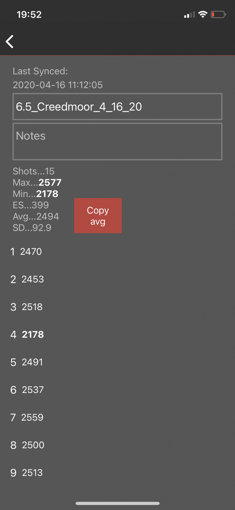

I use a Sinclair mandrel for sizing neck tension and use a Redding completions micrometer seater with very consistent seating depth results. With form fired brass. I will do the measuring like you suggested and see what happens. I have no issue buying a new scale. Will start looking in that direction.
Hmmm...that’s a huge variation. Have you tried the magnetospeed with a different rifle/cartridge...some kind of “known”?
Agreed. It is a huge spread and bigger than a small variation of powder charges. However don’t disagree that testing my measuring system would be a good place to start. I forgot to say I am using cci bench rest small rifle primers all of the same lot. As for testing with a known cartridge. No I have not. I will have to see if anyone I know has a known load they could shoot with my magnetospeed. I do t personally have a known load. Load development is new to me.
All the questions were in part to rule out any big problem in your process. It sounds reasonable. How are your trim lengths? You don’t have some brass pieces that are over length, do you? I’m not sure that would do what your seeing...speed changes...but it’s worth checking. I don’t know shit about .224V but I’ve loaded a lot of 6.5CM. What are your numbers for those? Low SDs aren’t necessarily a result of perfect load weights...all the other stuff matters too. Finally, how organized are you? Is there a chance you are mixing up loaded cases and getting out of sequence?
My trim lengths are very good. Very consistent using a Giraud trimmer and checked following trimming to make sure they are consistent which they are. I am very particular when I load and use a system that keeps me in order. I thought the first time I saw an odd speed that I had maybe switched a round or got the measurement wrong. But after seeing similar results again and again being even more diligent I have decided it has to be something else. Here is one of my 6.5 tests.
That is a pretty significant spread. I’d check the magnetospeed with some known velocity ammo. Even buy some factory rounds and run them through, they should be a lot more consistent than what you’re getting.
Think about if you wanted to get a spread like that on purpose. You'd have to have such big variance on charge weights and that would be difficult on a beam scale. Id say its the chrono. Shoot some good factory ammo over the chrono and see if it gives the same results.
Yeah...I’m starting to think maybe it’s a chrono issue...that spread look really reasonable except for shot 4. And that seems too much to be attributable to anything other than some kind of gross loading error. You could try shooting a string at...300 yards or more. If there’s really a velocity difference of several hundred FPS, it will hit low. Of course this depends on you being a good enough shooter to see the difference as a low shot not a poorly executed shot. Or, shoot some factory ammo and see what’s up. Or, put the chrono away and just short for OCW as it prints, without regard to the speed. Keep us posted.
Looking back at some of my 6.5 data
I tried some factory Hornady 140 g ELDM back at the beginning of using the magnetospeed. Shot nine rounds which one round did not register any data. That produced an extreme spread of 78fps and an SD of 23.9. So better that the recent data. I also was able to get the SD of my reloads using IMR 4350 down to 21.3 and 22.6 for two different tests. I kept that as my charge weight and started seating depth adjustments. Half MOA at 100 was best group so far with that so very happy. Then got distracted with new 224 build and testing which has brought on the real issues. I think I will try a new battery I am thinking that might be an issue given early on data vs today’s. Also I am confident in my ability to shoot well enough to see the difference at distance. Think I will try that if a new battery does not produce better results.

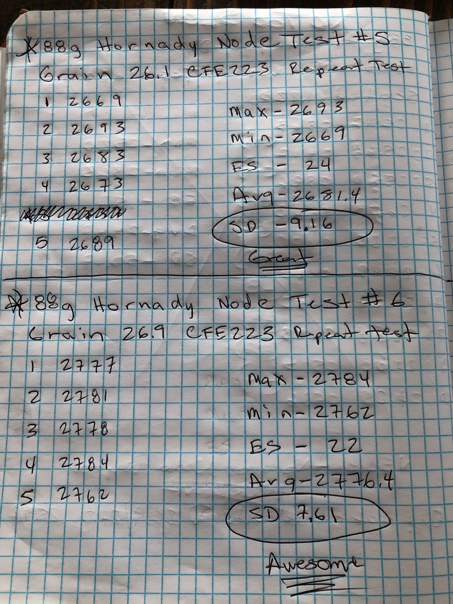

Did some testing today. New battery in the chrono seemed to help some but did not solve all the inconsistencies. Retested the last set of loads which did produce better results but still have random strange numbers that don’t make sense. Was very careful as always to get my loads as correct and consistent as possible. Think the next step is to work through a OCW loading and shoot out to distance and see how things go. Or maybe if I can find someone with a labradar to try. Or run my magnetospeed on their known loads to see if it reads consistent with their known loads.
Reactions: OREGUN and MCHOG
Ok guess I should have actually done the math before I spoke. I actually did find some good data today with the new battery installed. Yes there was a couple odd numbers with some new powders and loads but I retested some loads I was pretty sure would be good and they are. Here are the results. Sorry for the hand written results that are a little harder to read. Forgot my iPhone to magnetospeed speed dongle at home so had to just do all my testing which was more rounds than these then pull the data for these sets out. Bottom line it looks like the new scale and new battery made a huge difference. Think it will be hard to get better than a SD of 7.61. Thanks for all the advice.
