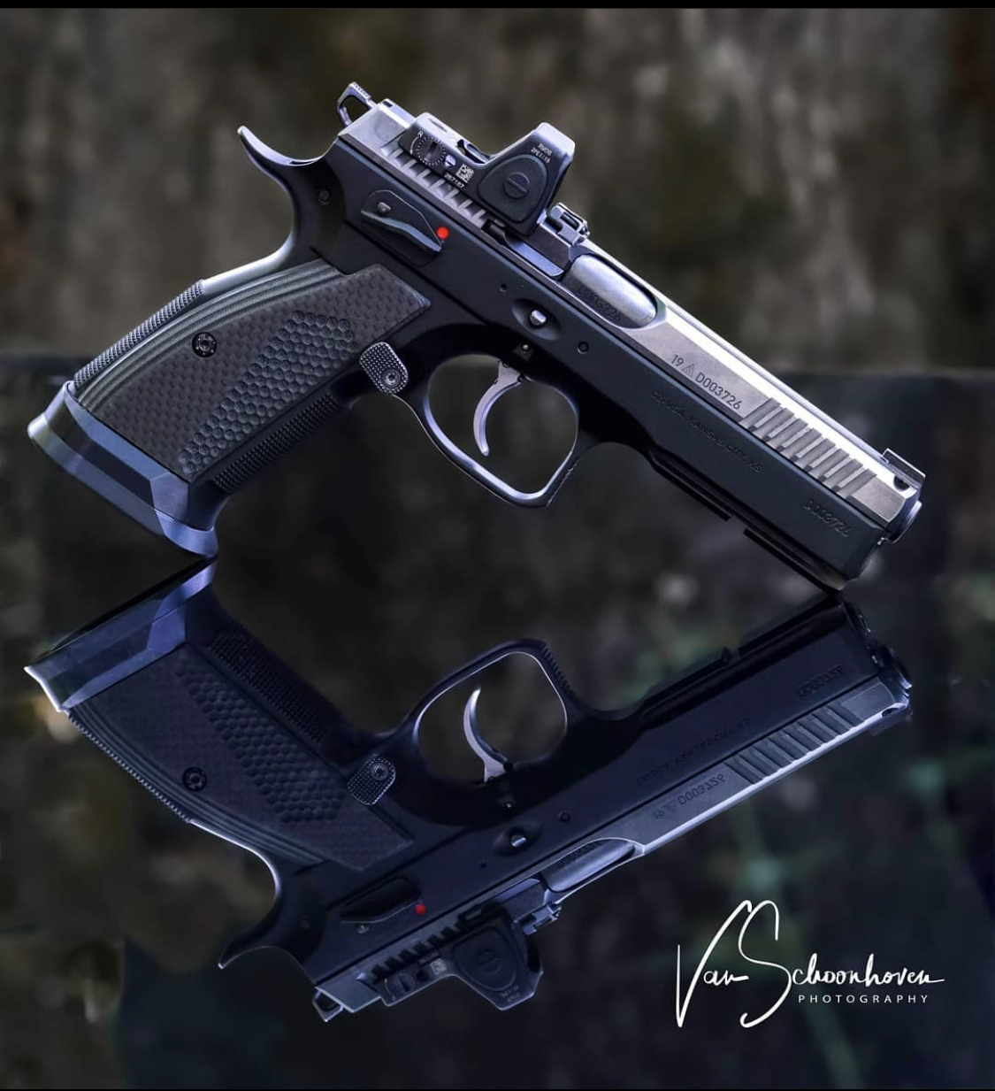

Having the dot that low also helps keep your draw stroke much closer to that of your irons only guns.
I shoot open and limited often in the same match and switch guns back and forth and it doesn’t bother me at all.
If you have a super high red dot like most of the open guns then it throws you off going back and forth.
As you can see my open gun is still a super practical pistol. I run factory ammo through it and out of over 50 thousand rds so far I’ve had one malfunction of any kind and it was fixed by a quick rack of the slide..
Its actually had less malfunctions then the glocks running in the same conditions.

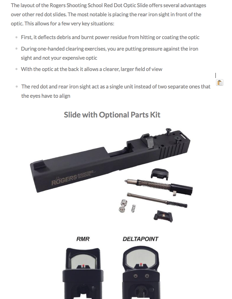

My comments regarding sight location are based on tens of housands of rounds of experience with Bill Rogers at his elite shooting school; post #9 shows the Glock Setup he recommends that I first starting using.
He outlines the advantages of his design here.
How low the optic can be installed is obviously firearm specific related to interference with any safety block mechanisms / extractor channels etc.
With a really low forward rear sight, the typical advantages won't be appreciated.

The last point is complete fucking bullshit and shows a complete lack of understanding of how reflex sights are used and why the iron sights are there in the first place. It's two independent sighting systems. Forcing the dot to be on top of the front sight is dumb and a needless obstruction.
Yeah, I don't care if God himself said it. It's still bullshit.
BTW, #1 is also bullshit. I have just over 7K rounds through an RMR and not once have I had to clean even the slightest bit of powder residue from it. Dust, yes. Fingerprints, yes, water spots, yes. Powder fouling, no. And if spent cases come back and hit the glass, (hello Gen 4 Glocks) unfuck your pistol.
#2 is dubious at best. The fucking optic sits higher than the rear sight. Guess which one has a higher likelyhood of being the charging handle for the pistol.
#3 is true but not why they think so. Field of view is a concept that does not exist with reflex sights unless you're one of the tards who insists on seeing the entire world through that tiny glass instead of letting one's peripheral vision superimpose the dot on the target while your eyes see the dot as just another object at infinity. Now, the sight in front does not obscure the dot in some awkward positions, if that's what they meant.

Tell your friend he could have a side business milling stuff that nicely. I’d send my S2 to him.
He has a full time business making firearms parts and is over booked already so there isn’t enough profit in milling slides. As far as sights in front or behind here is a quick video of my setup
I also agree I have never got powder fouling on my rmr.
Maybe if your running a comp you would but I don’t see the iron sights blocking much of that anyway.
Also the charging thing is a bit of a miss in my book. I’ve never seen someone actually hit the rear sight vs the optic for charging. I’m sure if you were super careful you could do it but I think this is more an emergency thing and your probably going to be in a f-ing hurry.
Those are not advantages in my books. If your going to take the time to line up your sights your missing the whole point of the red dot. In my opinion anyway.
Reactions: 308pirate

Nice video showing the front placement . First thing that jumps out to me is there appears to be less “distractions” while looking through the window at ALL points in the window. Yes I know I am not supposed to look at the dot but focus on the target, I still need to train more with this.
For now though, I’m going to stay with it behind the optic.

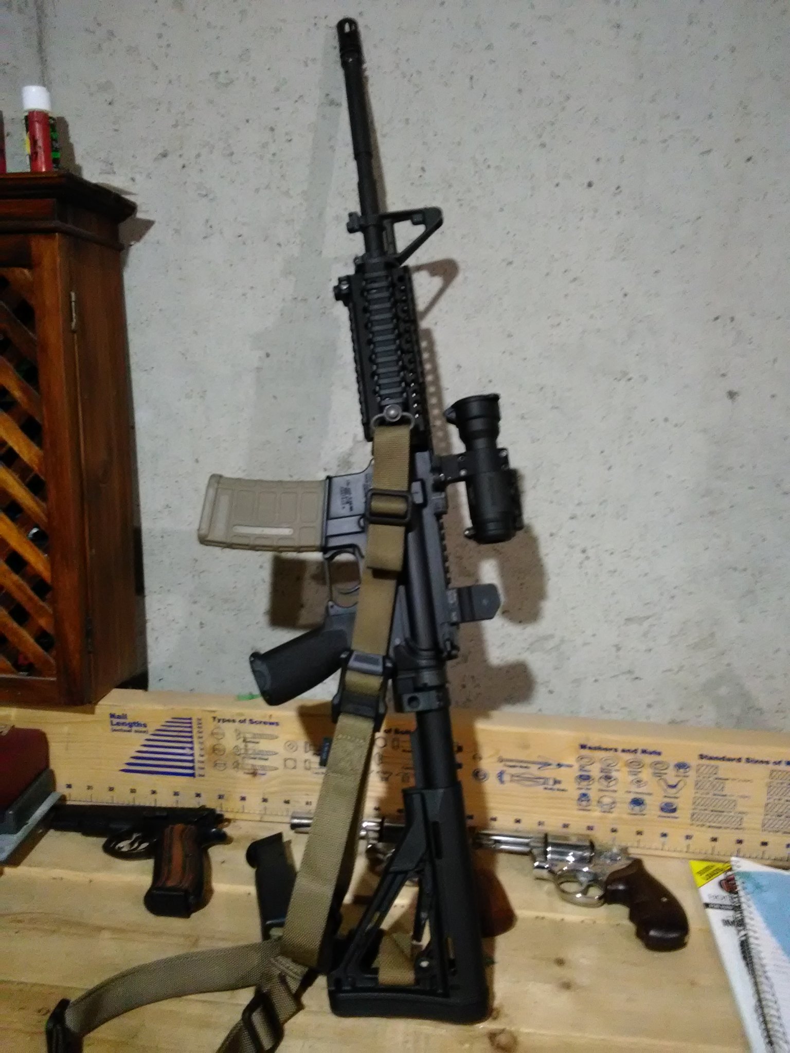

Yeah you are. You're making ssumptions about how all this works and you don't have a clue. Let me list them for you:
  • having both the dot and the irons was honestly alot of shit to line up.
  • having all this shit on the slide kind of defeats the purpose of having a red dot.
The majority of us dont pile up irons on our rifles and throw a red dot in the middle
But hey, you do you
Yes Im making assumptions AND ASKING QUESTIONS. Thats why Im here. Why are you even in this thread? Can we get this thread back on track for us that are really trying to learn about this?
