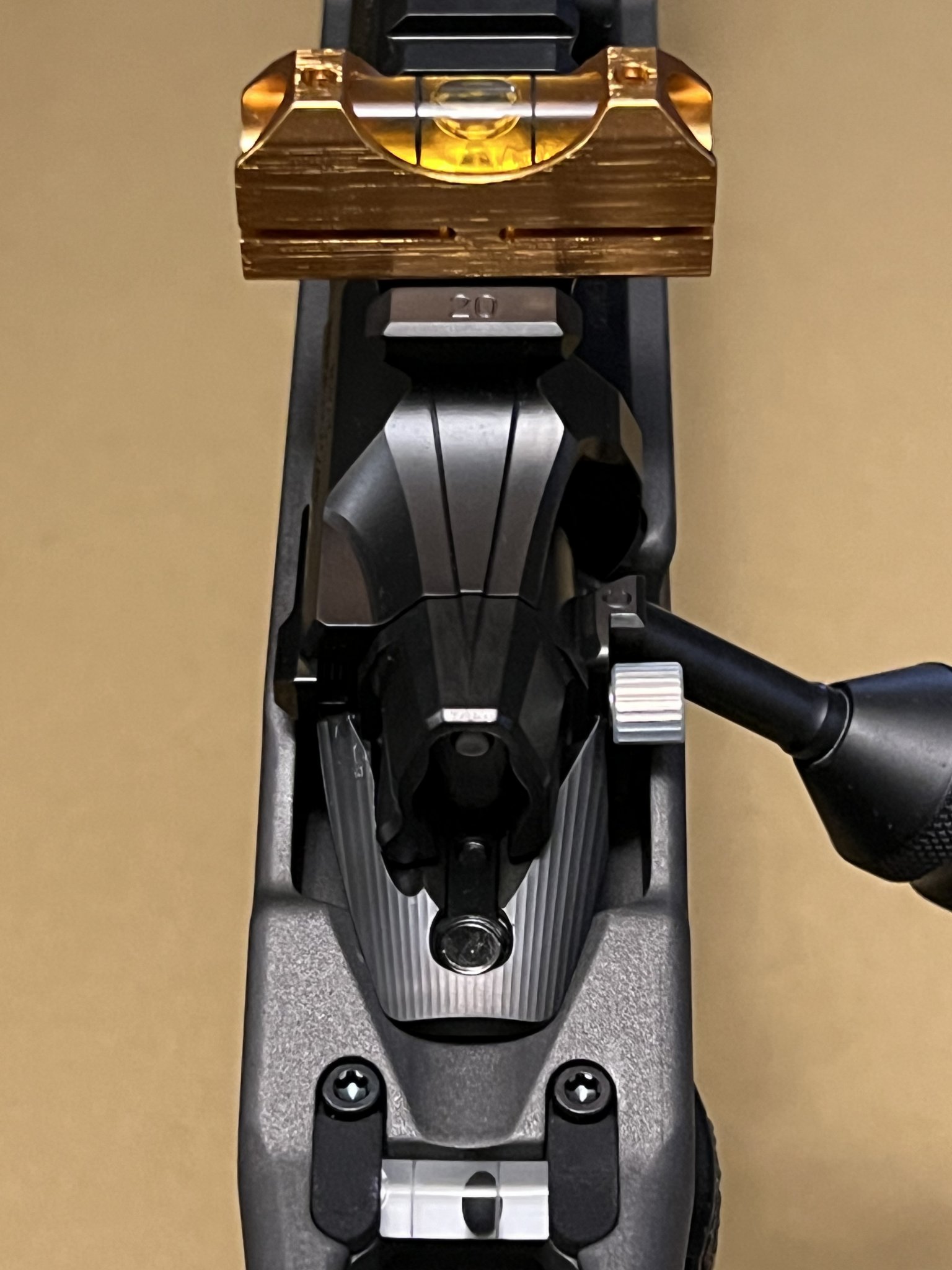

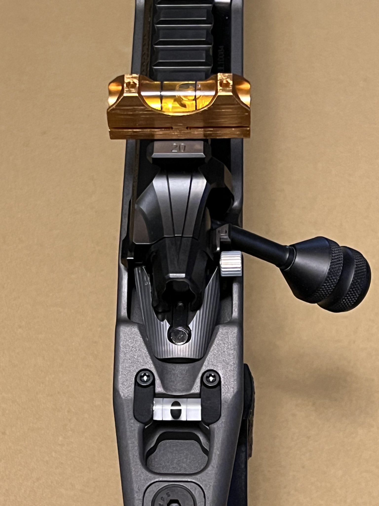

Got my MPA PMR Pro II with the new CDG action. I’m getting ready to install a scope but as I started checking level, I noticed that built in picatinny rail is out of level with the built in level.
How should I proceed here? I think it would make sense to adjust the rifle to level with the receiver rail but then the chassis level will be out of level. Opionions?

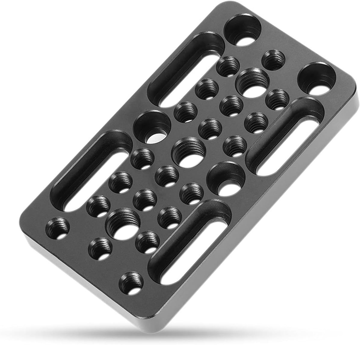

I have a smallrig plate used for videography that has a bunch of holes in it. It mounts to a tripod, and...
To this plate I mounted a pic rail. This very basic setup is what I use for all my scope leveling.

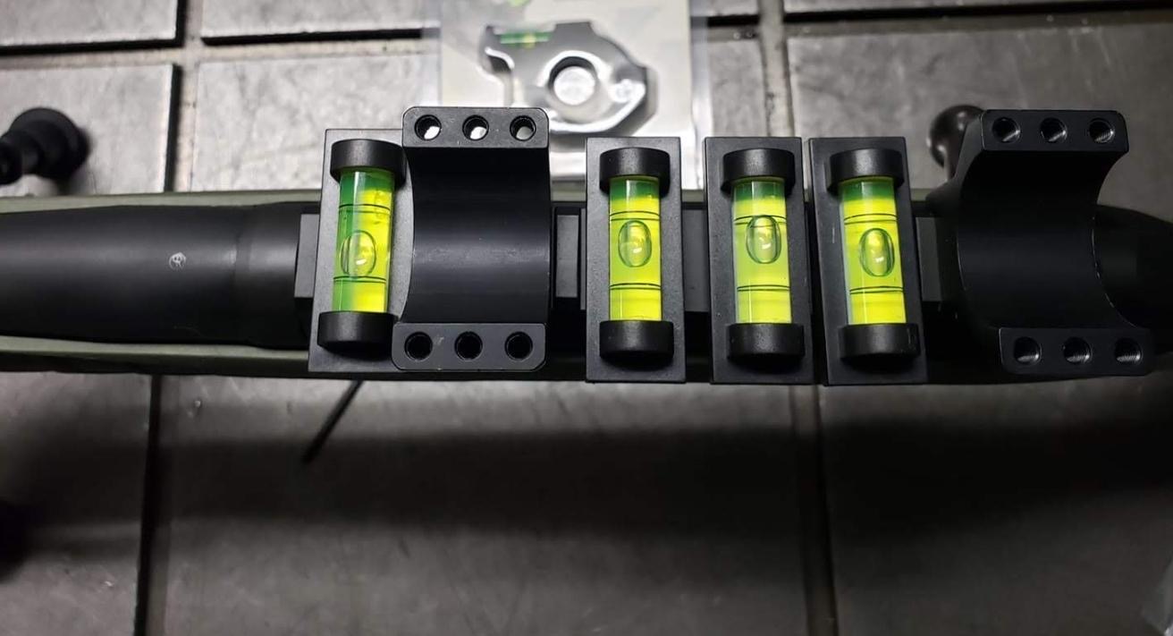

What you need is more bubbles. Get enough of them on there and 1 should show level. Just pick the one that is and call it good.
