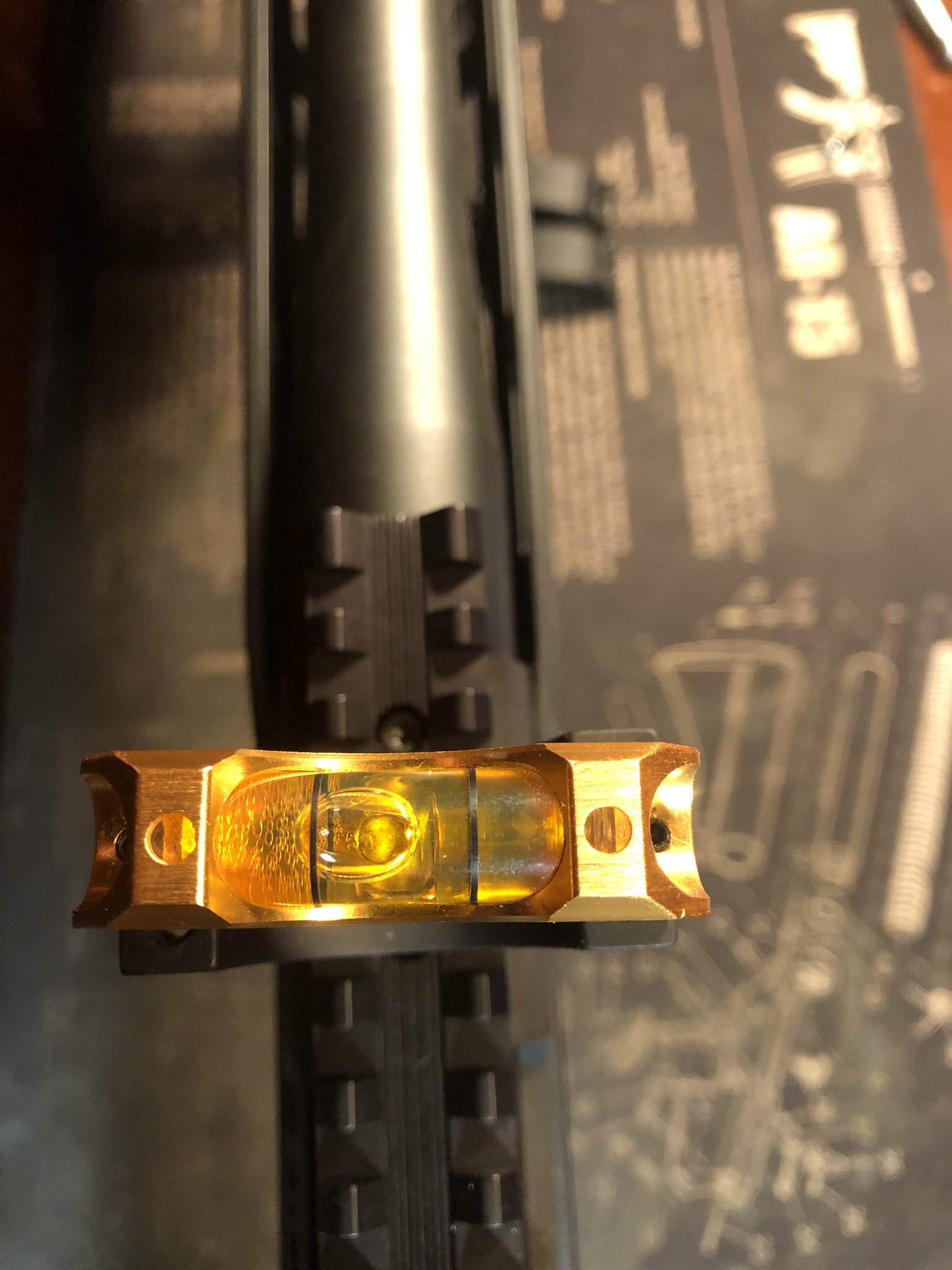

I did a search and didn’t really find an answer. I’m putting together a .22 for MARS this year, it’s a B14r barreled action in a MDT chassis with a EGW 20 MOA base and vortex rings. It’s going to be fitted with a Vortex AMG. The problem I’m having is trying to level the rifle, I put the level on the base and it shows dead on, then I put the level on the rings and there off. Both of the rings and the base all show different readings. I’m assuming I should go with the base level, is this correct?

If you guys look at his pic, the level on the ring has a half a screw hole showing and none showing on the other side.
If rifle is not level front to back, his bubble will be off because he’s not squared up on that ring. His bubble is showing off. If it’s level in every way, front to back, side to side it won’t matter, if not it will matter.
