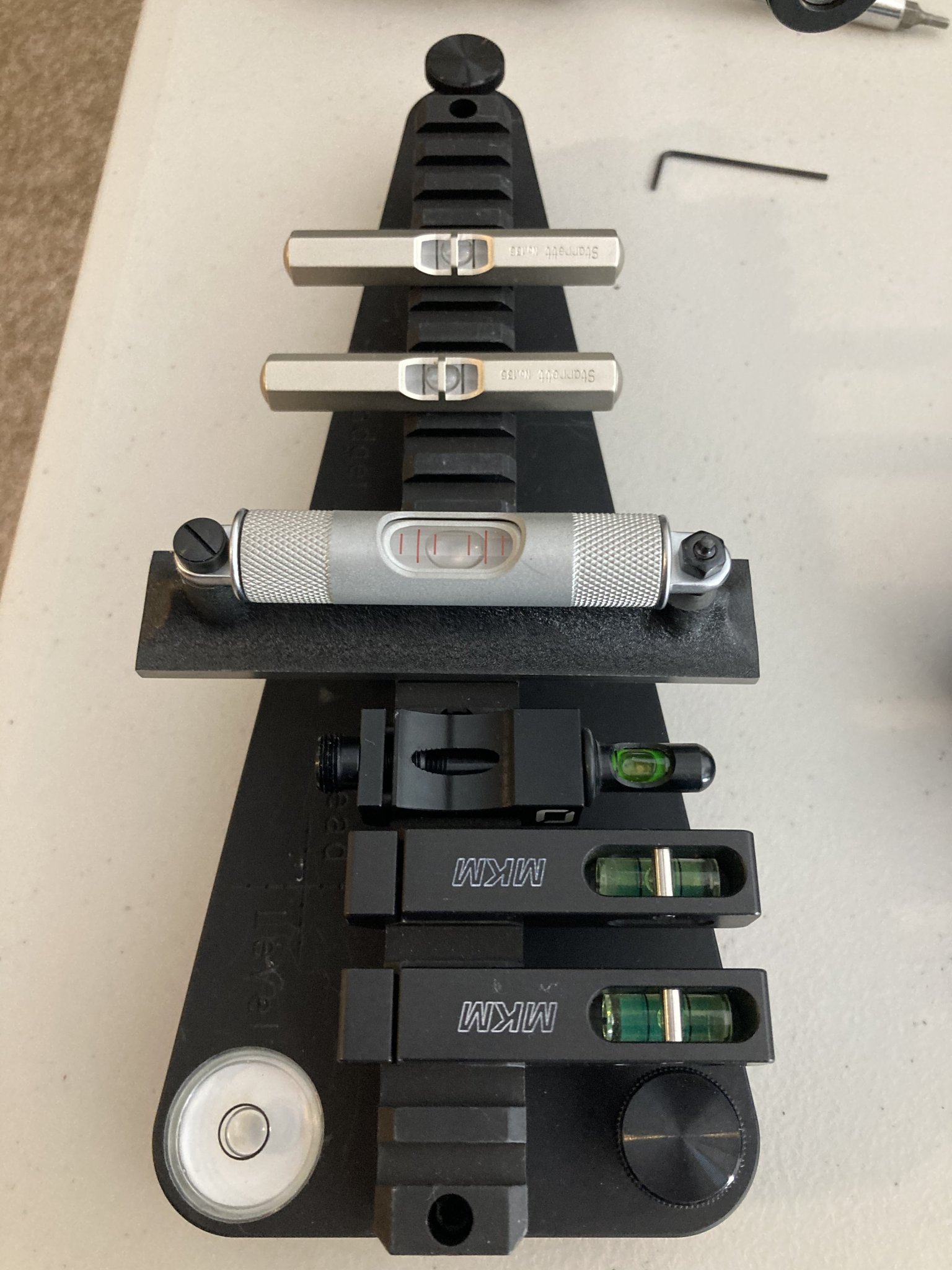

They are all close enough no shooter will notice a difference but I would never use a clamp on to rail level for mounting or after for range use.
I use the clamp on style for my ftr and f open rifles. They work great for that application. (at least for me) agree as to the no difference, that was my point, I do think it’s important and nice to have a plumb level reticle but to what degree…(cant) matters to a certain point but repeatability is king
Yours work. Seen many that were way off. Machining and rail fitment are variables. I like to use scope mounted levels so I can make sure that level is level.
And have been using my same old cheap level to mount scopes for years and it works fine too.
