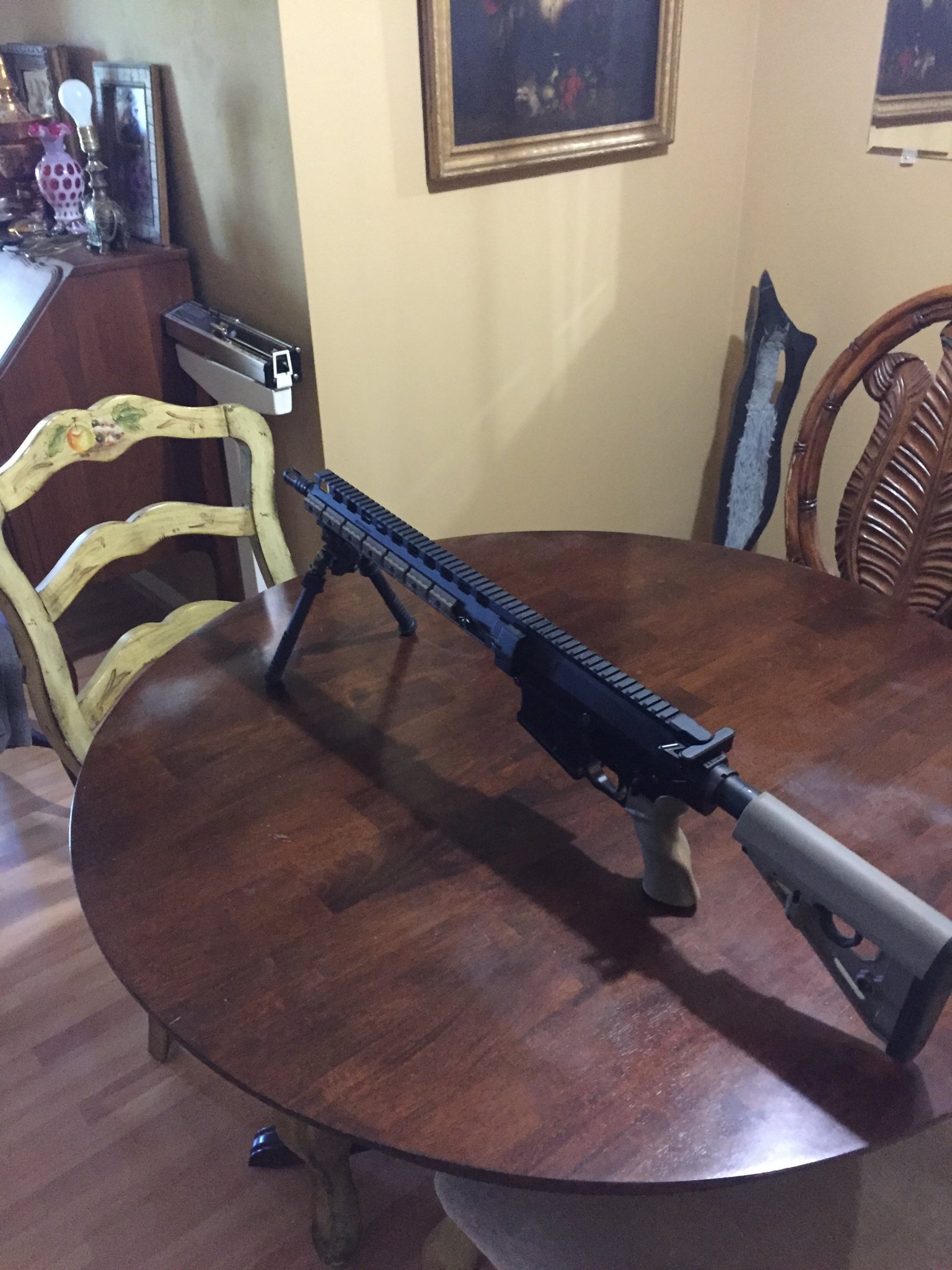

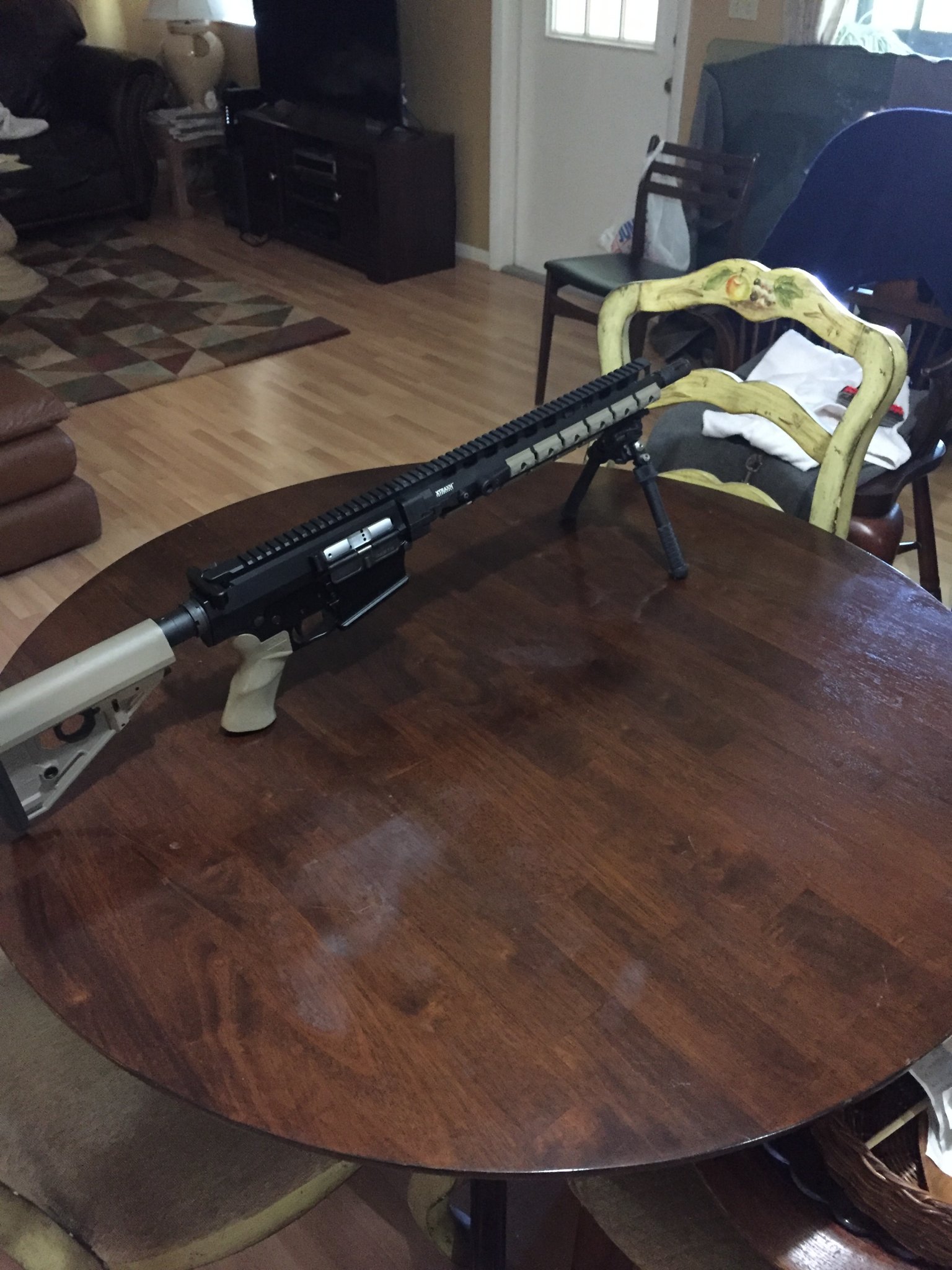

Hey, I was just looking to see what scope mounts other people are using for a Tangent Theta 315M and any other opinions/options for a good scope mount. It will be going on an AR-10 type rifle. Qd mount is preferred, but not absolutely necessary. Thanks

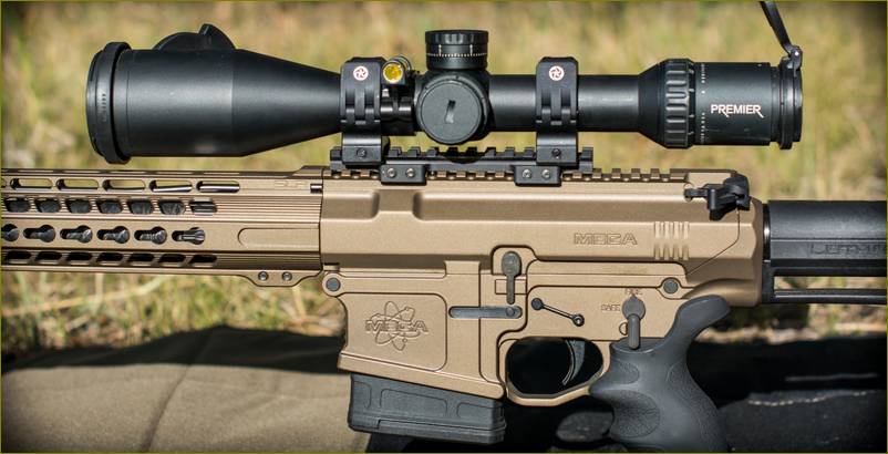

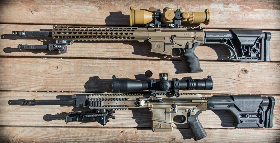

You don't need a cantilever mount for a large frame upper, straight mounts are able to provide enough eye relief without a cantilever because of the extended rail on top due to the "larger" frame of the upper receiver. The below rifles (both large frame AR's) have standard (non-cantilevered) mounts. I'm not saying not to buy a cantilever mount, I'm just saying it is not necessary for a large frame AR. If this mount might ever go on an AR-15 upper, then I can see why you might opt for the cantilever style.
Reactions: Josh0419
Going to depend on stock also. My RRA X-1 5.56 and my Armalite 3gun AR10 are the same distance to the front of receiver if the RRA is fully extended and the Armalite is as short as the Luth can go.
