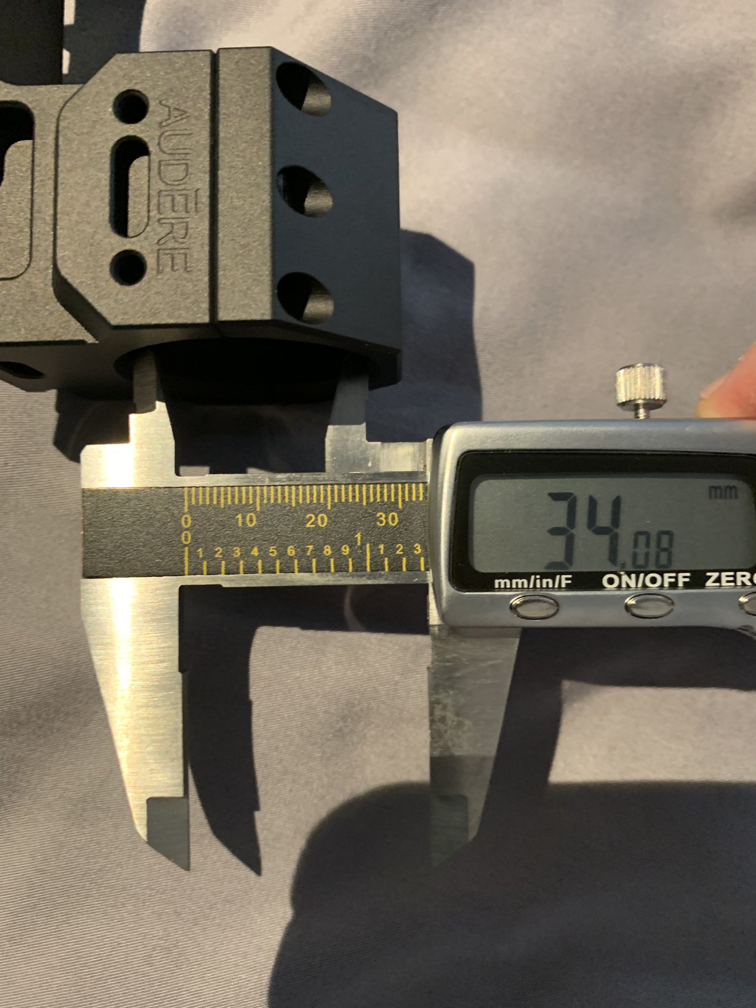

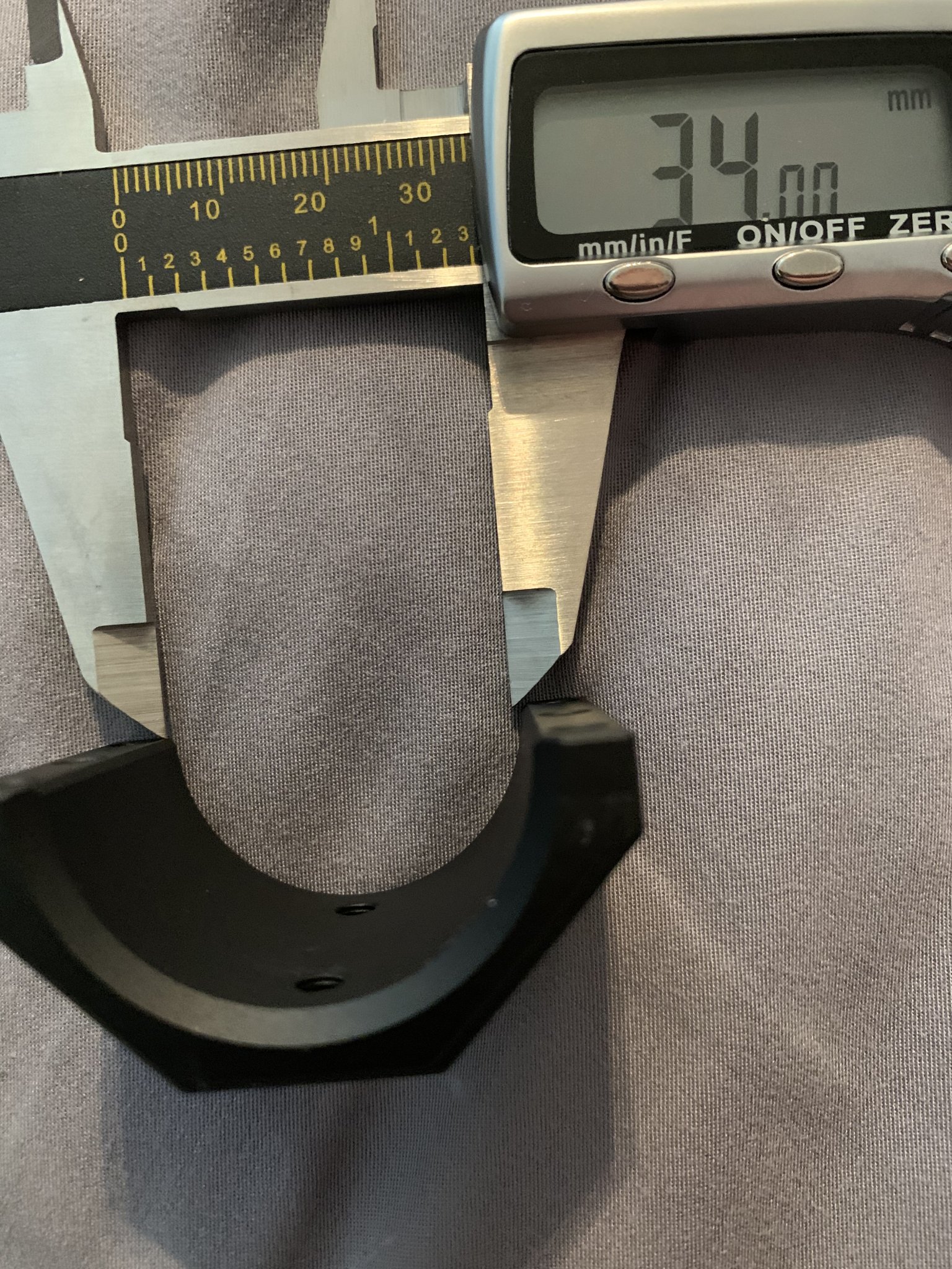

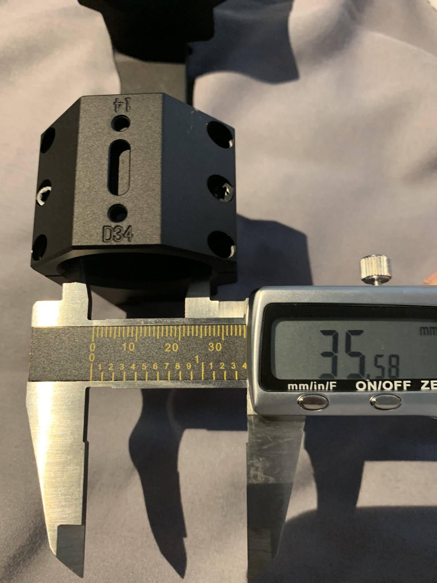

I stopped messing with it after retorquing them and took everything off. I did extensive research in what size mount rings I needed. I think the mount is just defective. I can measure with calipers though but I would hope SB has better QC and wouldn’t let a scope leave with incorrect tube diameters.
Reactions: Baron23
Measured rings and scope. Rings look to me a little bit bigger than 34mm. He’s to see but there is a small gap on the right side of the calipers.

Assemble the rings without the scope and use the other side of your calipers (the id side).
Definitely a 35-36mm ring that got mis-marked.

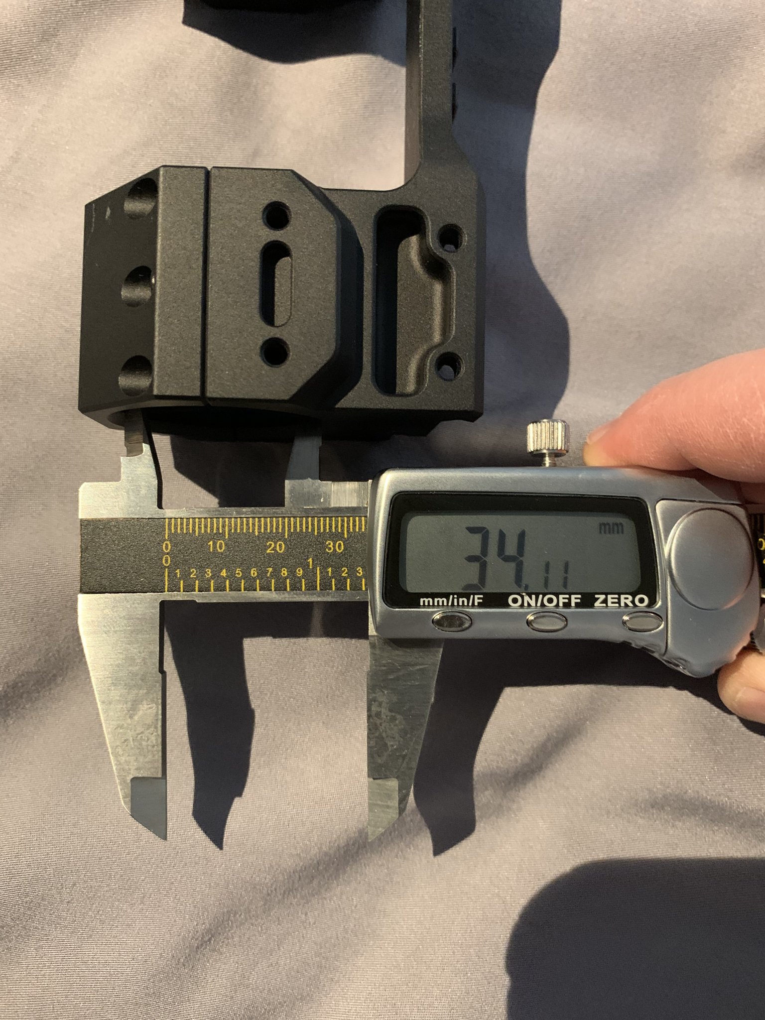

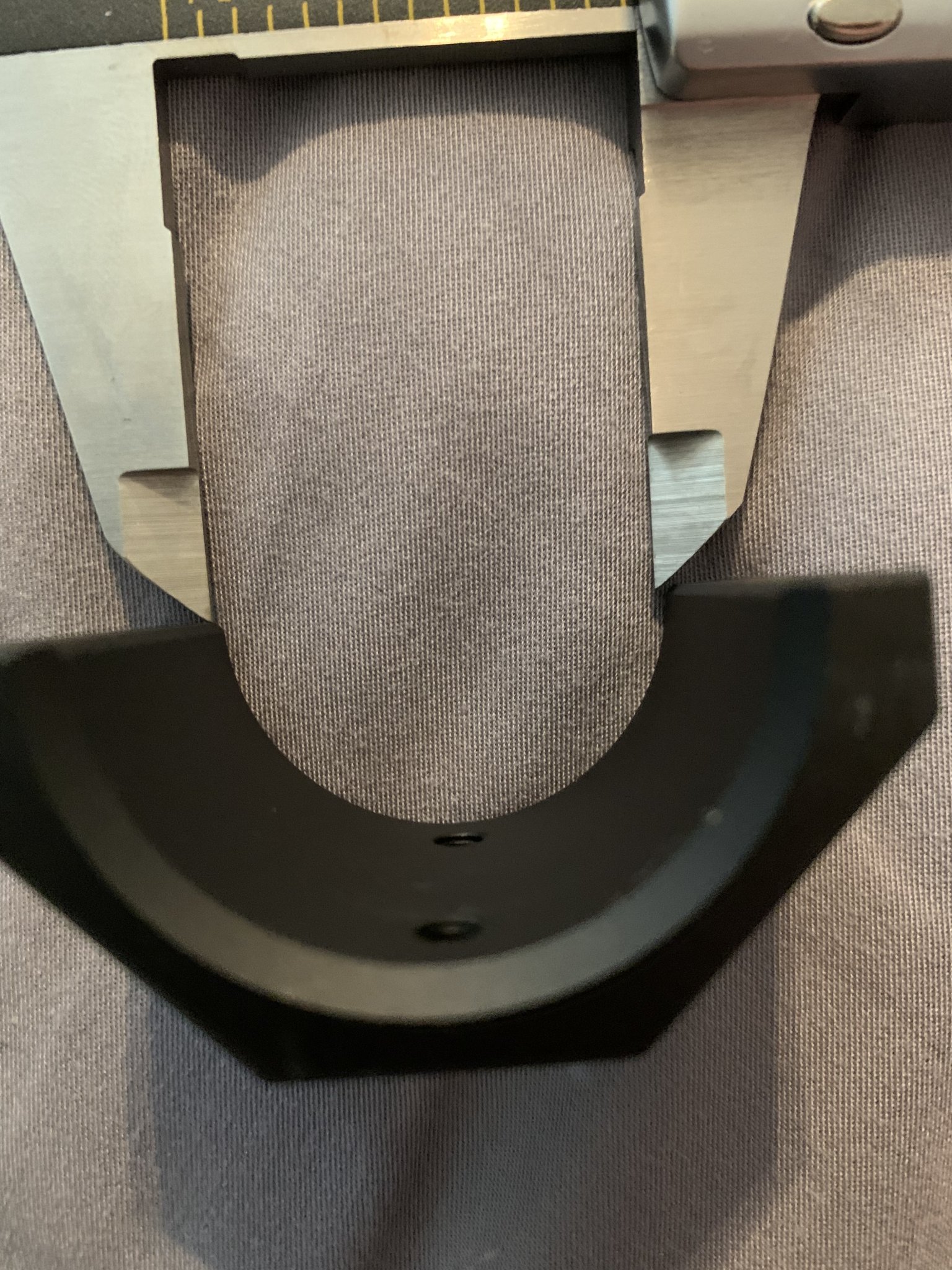

Hope this is better. Tried getting horizontal and vertical. I feel like the 35 reading is off because it was sort of in the grooves but idk. Hard to get a good measurement on a circular thing with flat faced tool.

Yes please email me ([email protected]) and I'll include the owner of Audere. We need to figure out how either 34mm engraving got put on 35mm mounts or vice versa. Hopefully this isn't a batch problem, but Audere will 100% stand behind things. Apologize for the issue!
Appreciate it. I’ve been in touch with Tony today. Still waiting for his response. Should I box it up and get it ready to send back?

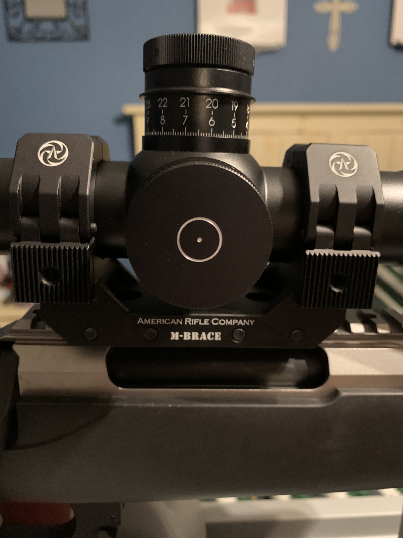

Fixed. No rotating issue now. The audere was a nice mount too. I hope the one coming with my zeiss lrp works out.
