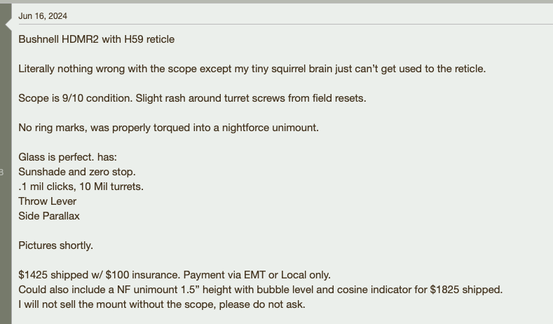

Its $1,425 Canadian, which translates into $1000USD. But I noticed it is not even illuminated, so that is a no no.
Illum isn't as big of a deal as you might think. Illum comes in handy hunting at weird hours or odd lighting conditions, but I very rarely use it in a match. This entire season I've been using a non-illuminated MK5, and it's been fine. I would, however, absolutely agree with not spending four figures on a Bushnell.

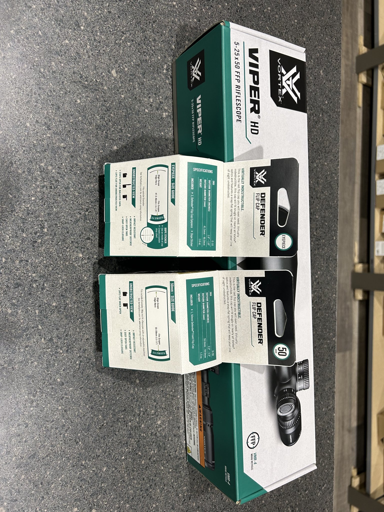

Vortex… Better warranty, too. And unlike Athlon, the new Viper HD is built in the Philippines, with Japanese glass. People have been saying the glass in the Viper HD is on par with the older Razor Gen2 scopes. I have the same scope I linked you to, but have not looked through it outside yet. I also have a new Razor Gen3 6-36, that I can compare it directly to. If you want, I can try to setup and take some pics through them both, and see if it does the glass any justice?
I would love to see that and I am sure other will do as well. Thanks!
I would like to see this comparison as well.
You got it!

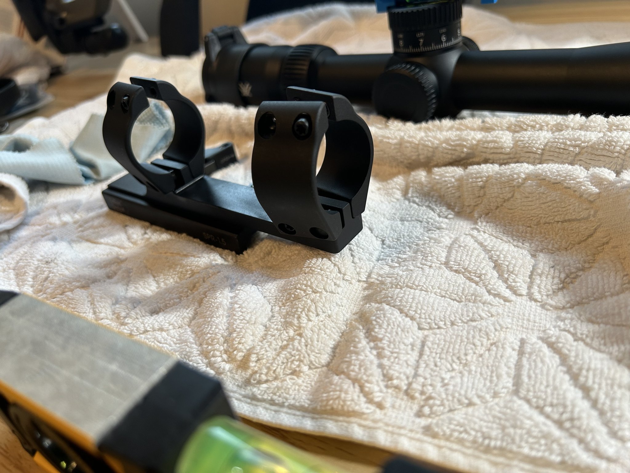

Follow the specs in the manual, each set of rings is slightly different, but all are the same in regards to - the bottom to the rifle are always more than the top to the scope.
I'm almost positive my American rifle company rings and mount are the same spec of 55 in/lbs on top and bottom.
follow the directions of the mount if it's a good mount.
That is correct ARC M-Brace rings are recommended by ARC @ 55 inch-pounds for both the ring and base clamp. Easy to keep up with. And if you use something repeatable like a Fix-It-Stix 55 in-lbs. torque limiter, then it will be very repeatable zero incase you have to remove the scope for some reason. I'd still check zero, of course, but it will either be dead-nuts, or very close, provided you use the same torque specs. 👍🏼
