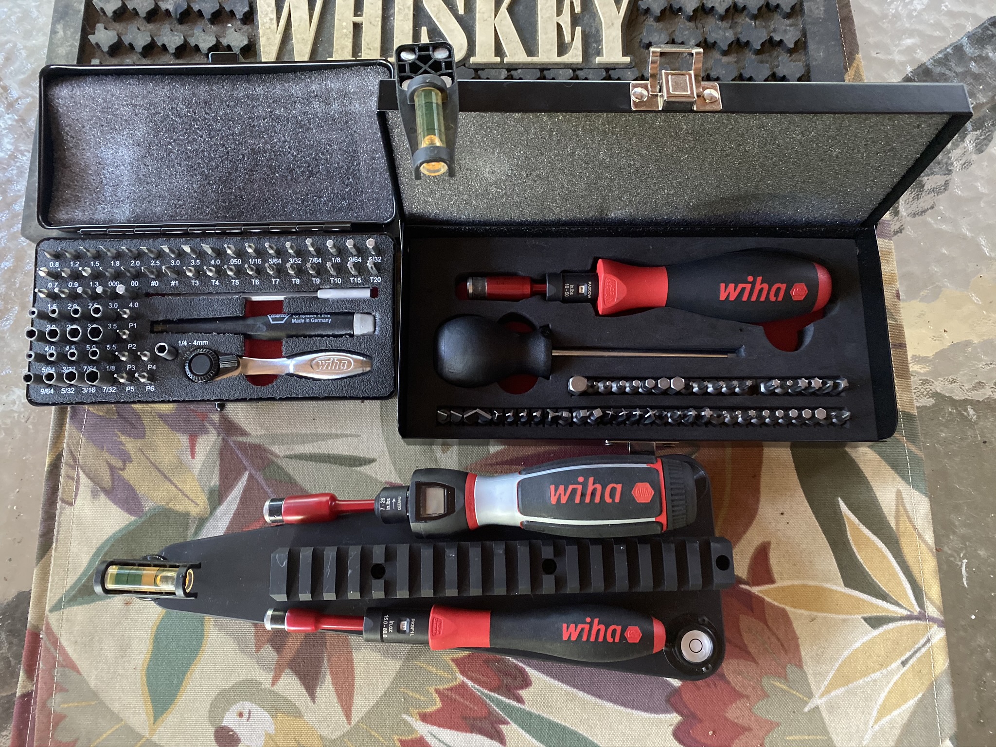

I have spent a metric fuckton on tools and related items for all manner of projects over the years. That said tha Badger Dead Level is the last money I spent on a tool to assist with scope mounting and as mentioned above I always confirm with a plumb line. IMO the Badger is good kit.

The absolute best scope mounting tool. With the plumb bob it’s damn near as close to perfect as you can get.
