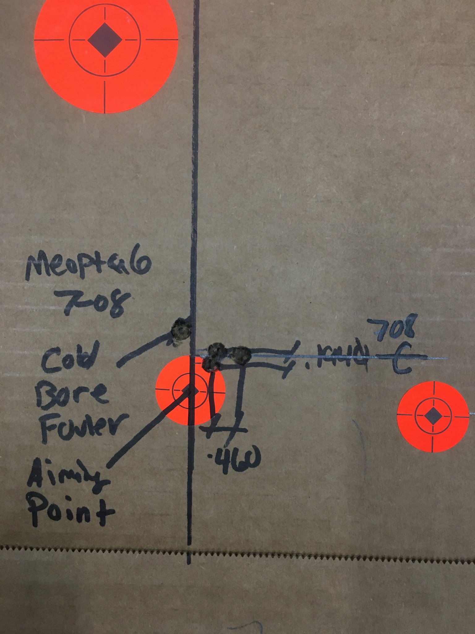

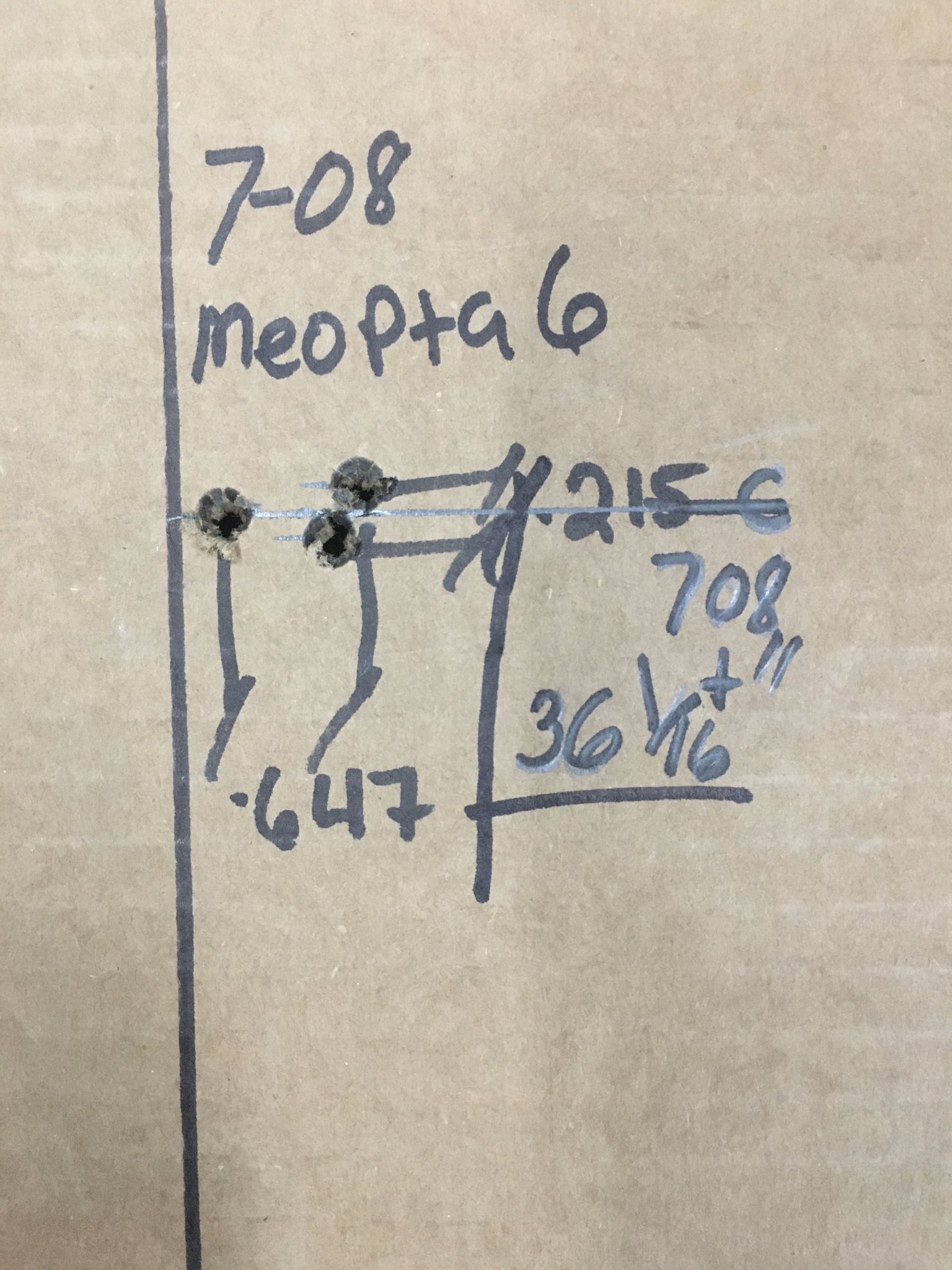

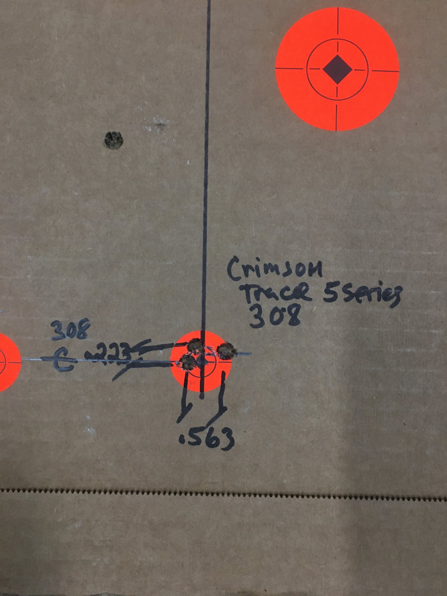

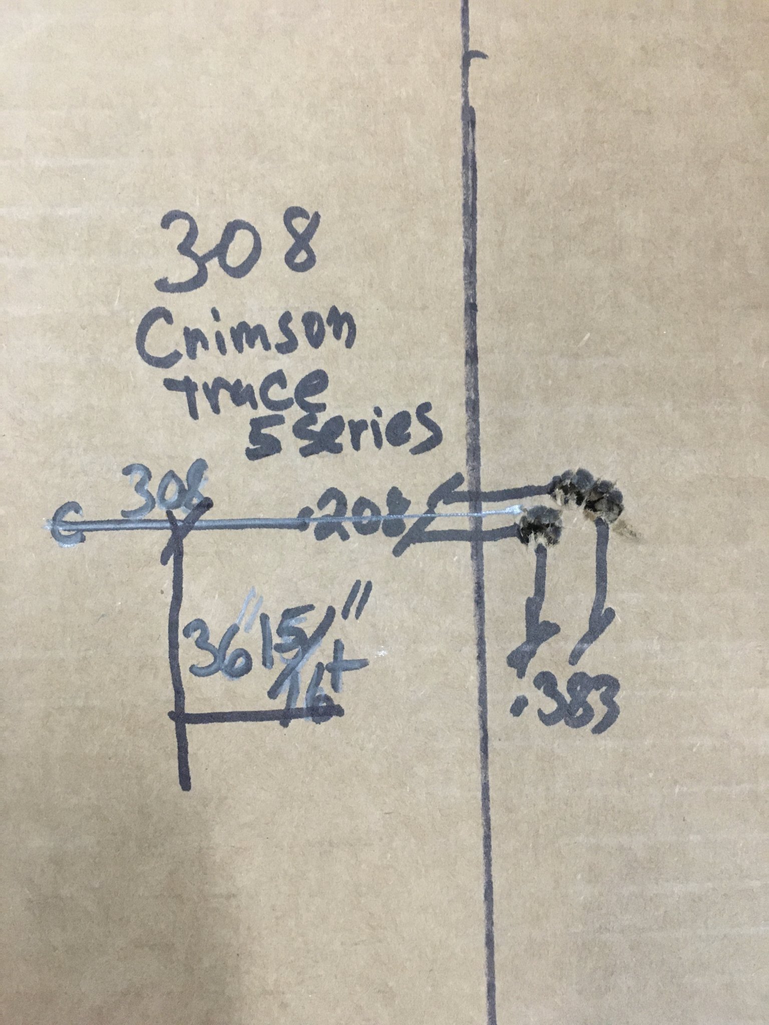

So first time doing a legit tall target test with 2 rifles 2 different scopes. So pretty simple it’s all in the pics. 7-08 with a meopta optika 6 in Mils Measured

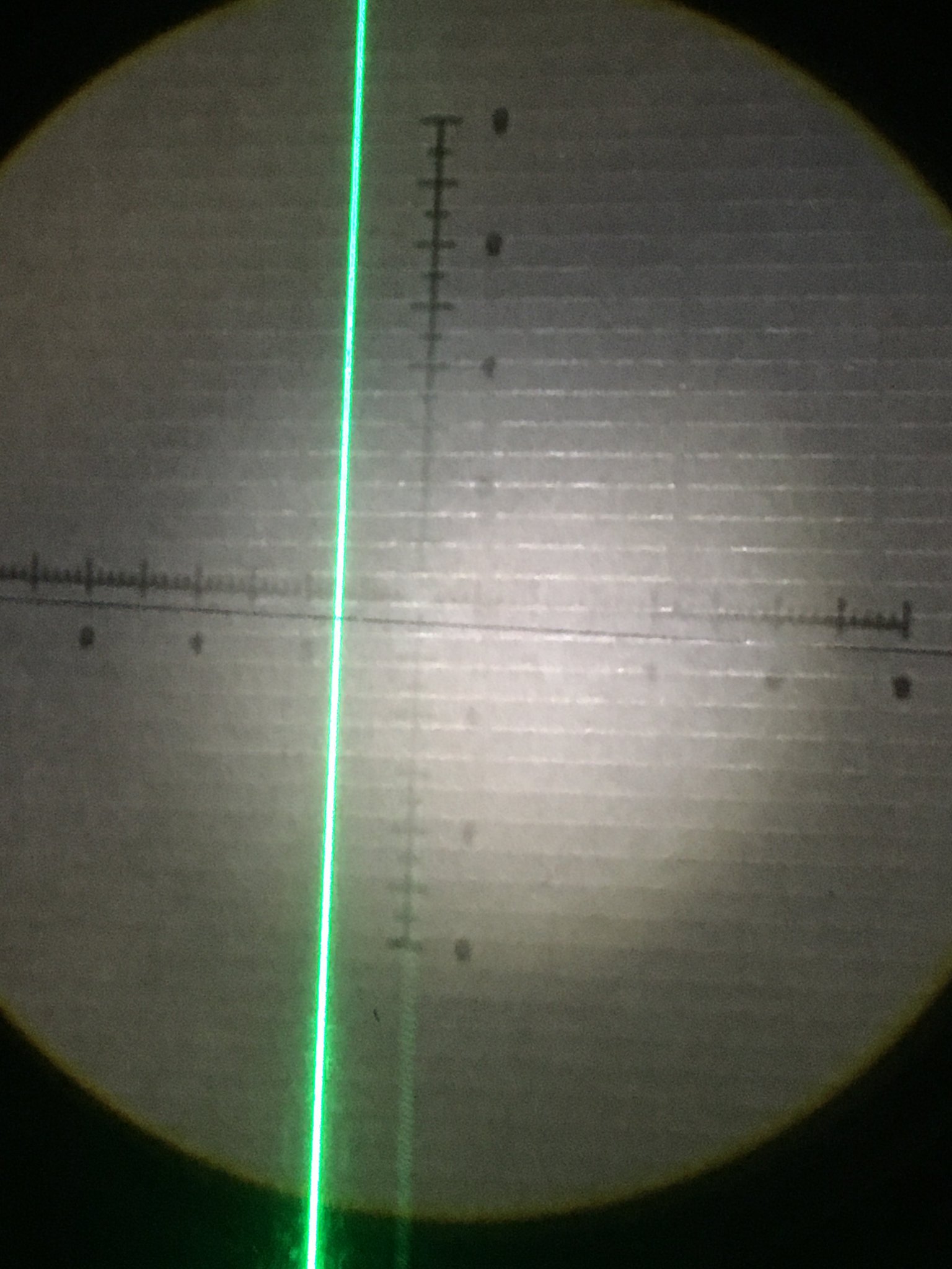

36-1/16 center of group to group 10 mils up So the division expected travel 36” divided by measured travel 36.0625 equals 0.998266897746967. So is that the number to put in the correction on the kestrel app? So the other rifle a 308 with a crimson trace series 5 measured 36-15/16 so almost an inch higher than what it should be. Seems like too much for me but what do y’all think? Another thing was the crimson trace showed soma can’t at the top so got home and double checked with light and lazer and level and it’s right one so does that mean the erector May be traveling canted? I’ll try and add the pics
