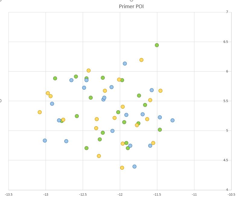

Here's 20x each of the same load (6mm ARC 110 A-tip w/Varget) with 3 different primer types, all else the same. SD for each test was within 1fps. Avg MV for all 3 was within 6 fps.

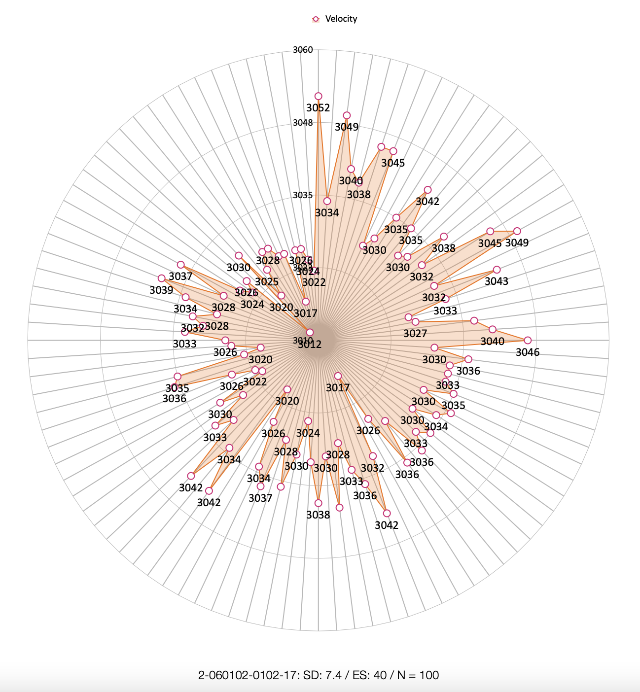

Recently I did this for a 6 CM load. Using 110 ATips and H4450, I made loads from 40.8 to 42.3 in 0.3gr increments (N=6 loads), then identified what I thought was the OCW. I tallied the SD and used that to solidify my decision. That's it, I didn't even need to fiddle with seating depth. In the end, I had what promised to be a good load so I loaded up 100 rounds in two reloading sessions and went for some long range "testing." After a hundred rounds, I had a load that would was in the 1/2 minute range (pretty good for me), an average velocity of 3032, and SD of 7.4. Time will tell if over numerous loading sessions the numbers stick, but a 100 shot sample size over two sessions is certainly more than most guys do.
Based off my own empirical evidence (which is subject to change as further data is collected on the topic), you'll find that powder burn doesn't necessarily produce linear velocity increases, hence a "node." But good groups don't always reside in the flat spots (there goes the rest of the guys). I think there has to be a happy medium. Keep in mind that seating depth, brass prep, component performance in a given barrel and chamber, and other factors also produce their own affects, so the conversation probably needs to be a bit broader than just powder burn. But, FWIW, here ya go.

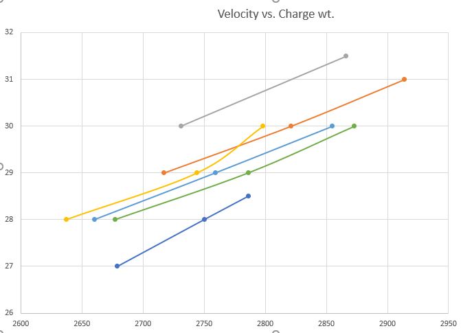

6mm ARC powder charge vs. velocity (each color a different powder). Yellow track had pressure issues at the top.

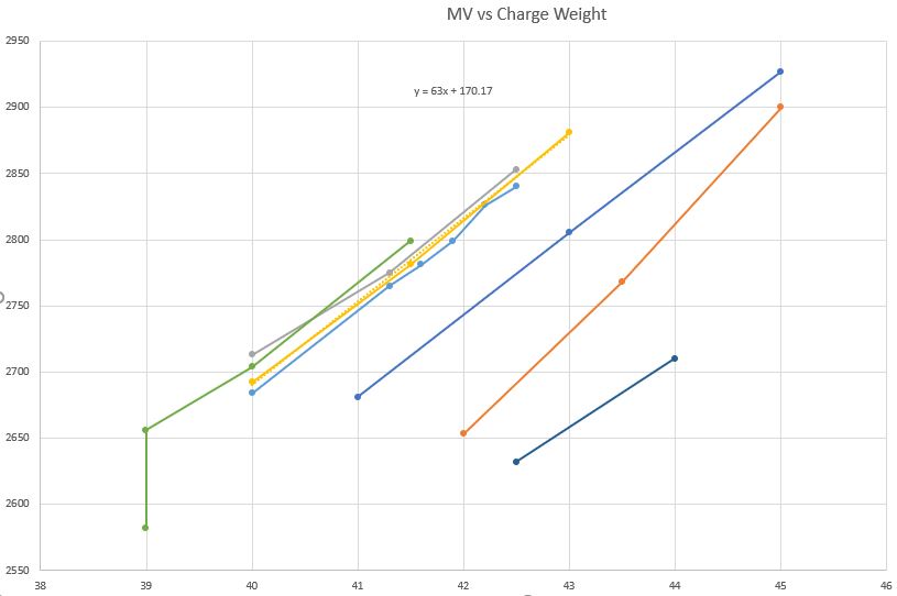

6.5 Creedmoor. The drop tail on the green line was testing a 2nd lot of the "same" powder.
This one is especially telling with the light blue track, 35x shots ea. every .3gr. The deviation you see from a linear trend line is so miniscule you will never see a difference on paper or steel within the effective range of the cartridge. It's effectively the "noise" level present with a 35 shot sample.

ETA: You will see "swoops", like that yellow ARC line, but I have not seen any reliable "sinusoidal" "node" data sets in .223, 6 arc, 6.5 creed, .308, nor .300 PRC.
@Ledzep Homogeneity of slopes is interesting in your two graphs (note the axes are flipped). As different powders were used and produced similar slopes in these two tests, this provides emperical evidence for those following this and the “Flat spot myth” discussion.
