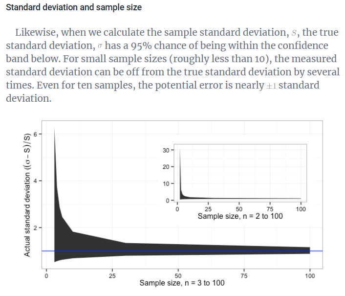

SD's
10 is good 15 is better for a minimum number.
I’m wondering if even 20 is good enough. My recent range trip had groups of 10 and 20 shots, just small variable changes. Results had several SD in the 7s and a few 14s and a 10. Same charge weight. Combined all 90 shots had a SD of just over 10.
Had a group of 10 with SD of 6.6 one day and the exact same load from the same loading session next week had SD of 19 with a 10 shot group. Combined SD of 30 rounds this reload session was 14. Similar results with a different powder, great or bad 10 shot SD with combined 30 shot SD of 12.
I see folks posting low SD's with 3 & 5 shot groups. How many rounds should be fired to get a accurate SD on your load?
Anything less than 20 is totally meaningless. The generalizability of your data improves as the sample size increases so it’s up to you where you draw the line. For me, anything beyond 25 and I get bored so I usually quit running the chronograph.

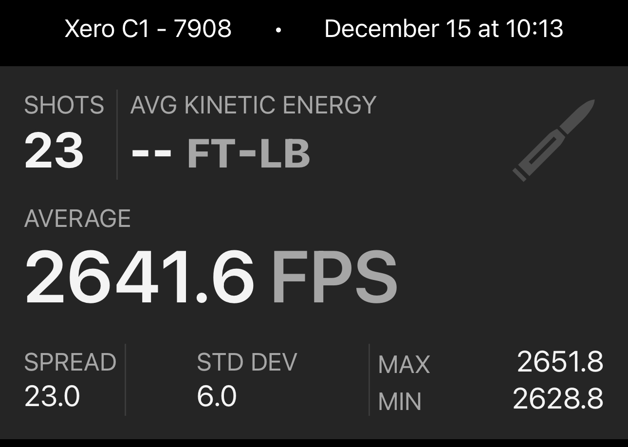

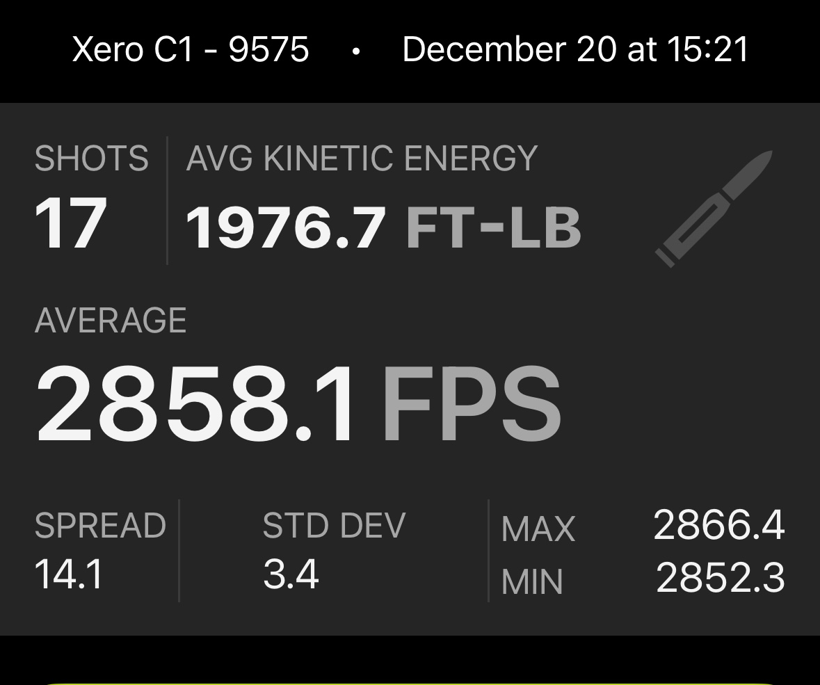

I shot 34 rounds today and got an SD of 4.0
6 dasher in Alpha brass
I am more concerned with ES
Then you need a class in statistics. Standard deviation will tell you the expected spread, 98+ % of rounds fired will be within +/- 3 SD's of the mean. ES is more or less useless. Fire 5 rounds and take the ES, how many data points is that? 2. Fire 100 rounds and take the ES, how many data points? Still 2. Now, with that said, if you fire a string and the extreme spread is higher than 6 times the SD you are looking for – STOP. That load isn’t going to get you there. ES can be used to reject a load, but it will not reliably help you choose the right one.
20 rounds will provide a mean MV and an SD that has a 90% confidence interval. If your recorded SD is 6 fps, your true SD is probably between 3 and 12 fps.
Unless you are shooting ELR type ranges, say 1200 yards and further, SD, unless it's huge, like 25fps or more, is probably meaningless as well.
SD's for 3 & 5 shot groups is really meaningless, except. . . . if I see a high SD in that number of shots, like a 15 or worse, along with high an ES greater than 30, I feel pretty sure it's not a good load. So, while a low SD with that number of shots won't tell you whether it's a good load, it can tell you if it's not a good load. If I think I've found a good load with that few shots, I need to confirm with what I'm getting on target with 15 or 20 shots. The best SD don't mean you're going to get the best result on target. I look at SD's as an indicator as to how well/consistent I'm putting together my cartridges, not how well they'll perform on targets.
What starts to happen with a "good" system versus a "bad" system can end up costing you more samples to get your answer.
For example, with a tight gun and good ammo, we would be able to get a real good idea of what to expect sooner, say maybe 7 shots.
With a bad gun and bad ammo, you will probably not get a fair estimate of the Avg, ES, SD till you burn roughly 30 shots.
The tighter the ammo/gun, the fewer the shots it takes to get stable stats, the worse your ammo/gun are, the more shots it takes to see the Avg, ES, and SD stop changing.
Here is a screen shot for a 95% confidence in the data. On the vertical axis you see how big the possible error in your SD can be for the number of samples along the X axis. You can see why we tell you that the sample size charts run about 30 samples to have an SD value that stabilizes.
Can you get lucky and have a number in 5 shots that holds up? Sometimes, but it generally only happens when the SD is very small to begin with. The risk is that if you only take 5 shots and your ammo is crap, then when you use your average it won't hold and when you estimate your ES you are wrong. Odds are you get a nasty surprise when you shoot out at distance.

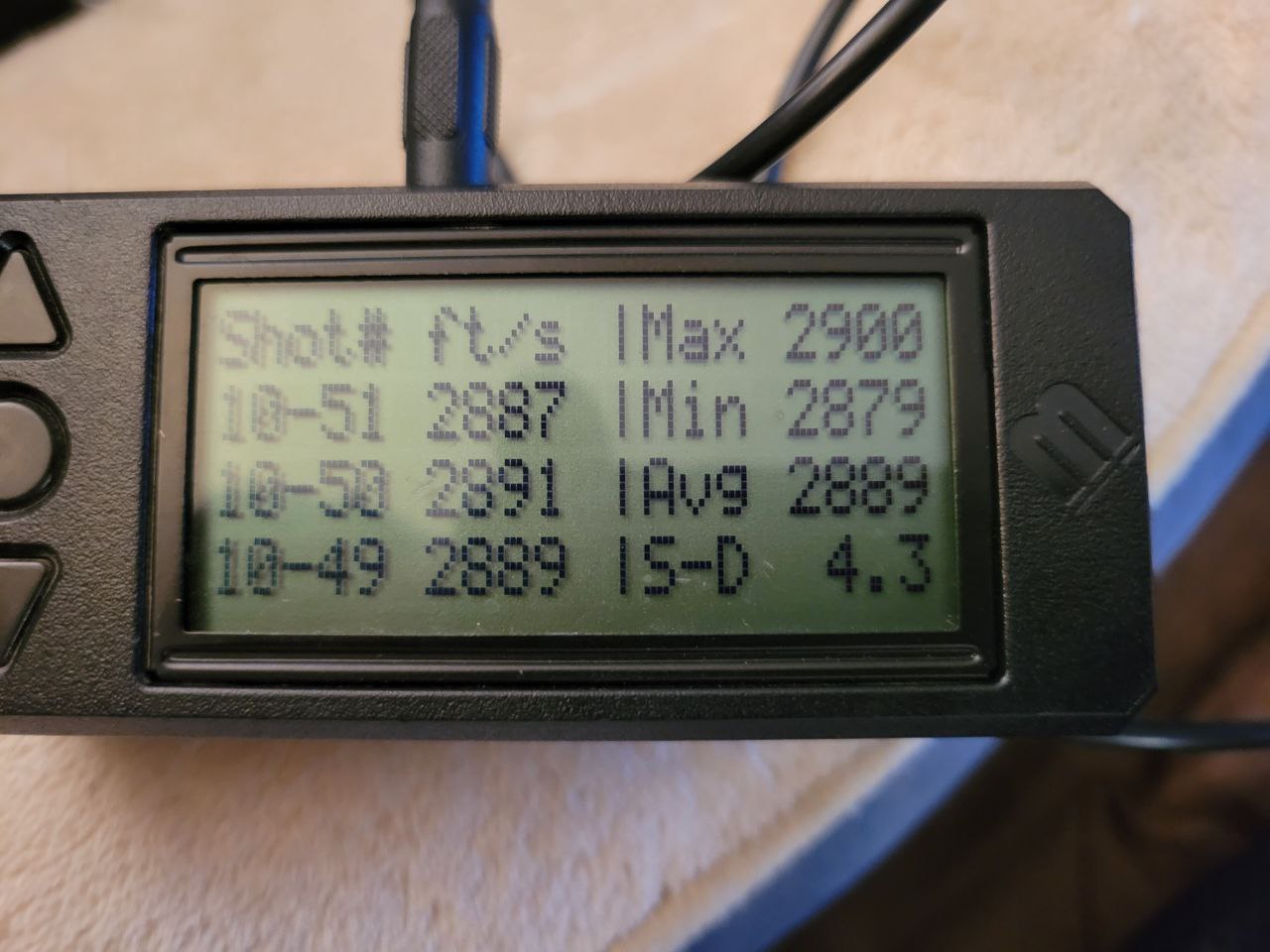

4.3 with ES of 21. If I remember correctly it was only 2 or 3 shots that made that ES. I agree SD is a much better number.
An SD of 5 fps at 2800 fps is +/- .18%. BC variation (ES) with unsorted berger hybrids is probably going to be 0.7%-1.2% based on the data I’ve seen. Group size and the bullet bc itself is likely contributing to the vertical spread at 1000 as much or more than the velocity once you are at that low SD.
Because of having multiple factors, I generally will just run it to 1000 right away and see if it will hold tight vertical. I’ve also settled on a load with higher SD, because it shot tighter groups up close (400-500 yards) but had the same vertical at 1000 as the tighter SD load. We shoot most targets at 400-700 yards where SD is less of a factor than group size, so it made sense to pick the load with the best on-target result across the board.

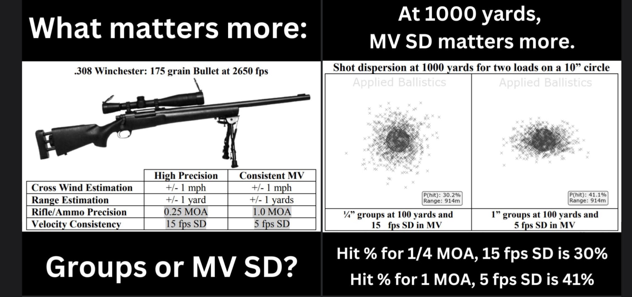

That’s not how sd works at range. The lower sd will have less vertical stringing in the same environment. I agree under 6-7 sd there is very little difference at range.
But an sd of 6 vs an sd of 15 at 1000 yards will have different vertical stringing and the lower sd will shoot better vertically regardless of “group size” at some short range.
Since you said you were shooting at 400-700 yards I assume you’re shooting steel and not shotmarkers so I’d really question what 1k testing you did if not over shotmarker.
What data do you have on sorting hybrids for bc deviation???!
Oof. 15 fps SD is horrible. I guess I should qualify my statement. I’m comparing something like 4 fps vs 6 fps not 5 vs 15. And group size I’m talking about out .3 vs .5 moa, both still relatively tight, and the difference on target (a clean piece of steel), is an inch or two at 1000 yards. The reality is both loads are probably good enough. 15 SD indicates something is wrong with your process or components.
I have zero data for sorting hybrids, but I’ve run a few lots across the AB doppler and the BC extreme spread was enough to change the vertical impact on target by a couple of inches. I can imagine sorting by weight, length, and diameter could tighten that up.

Agree, the stat on the 29 shots stands and the one shot is defined as an outlier. We got what we got.
Now, suppose you got an average of 2858 on the above, and you find that one shot at 2873?
Bad measurement?
Bad Ammo?
Bad Gun?
Time for Scotch?

SD is a statistical measure, as has been said, based on a "normal" or "gaussian" distribution (Gauss was a cousin of Darwin - long history there).
One of the tenets of statistical testing is that you don't selectively report data. you need ALL the data. You are trying to take a sample and compare it to an expected mean result from the TOTAL population.
So, when you do a SD on 3-5 shots, your sample size is at risk of not representing the total population.
Then you go shoot a whole population (a 100 round box of ammo, or 10 of them), your SD from your small sample of 3-5 shots doesn't represent it.
Now that we all have the GARMIN, this problem is going to come into clearer focus, because the results of 20 shots today is not going to be representative of the next 500 shots, which we're probably measuing.
So we're probably going to need to start accumulating more data. Problem is, ambient and barrel temperature changes, barrel fouling changes, powder lot changes, etc.
I think what we're going to find, as we increasingly measure every shot with the GARMIN, is that our notions of what a reasonable expectation for SD over long data series, is going to change.
As far as outliers. And this is killing me with my 50 BMG shooting with the GARMIN at range (over 1 mile) this winter. I'm really having trouble with the vertical outliers. But if I shoot a string of 10-20 50 BMG (at almost $7 a pop with reloads!) and I get SD 14, but I can remove one and the SD is 7, I remove the outlier and take the 7 fps SD. I figure, "that's the shot that's gonna miss, out of every 10-15 shots."
Because I honestly don't know what else to do with that one that was inexplicably and unexpectedly 50 fps faster and went 1 MRAD high at 2250 yards. Should I go rework my trusted $7 a pop 50 BMG load because one "outlier" out of every 10 just goes rogue on me?
One shot out of ten to twenty going out of family sounds like you have some tough choices to make going forward.
Hopefully the batch isn't huge and you can identify the cause before your next batch.
