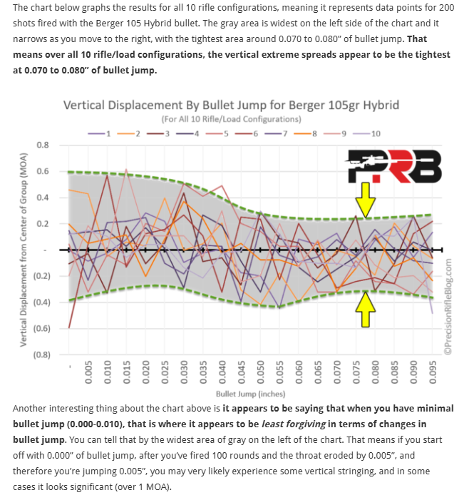

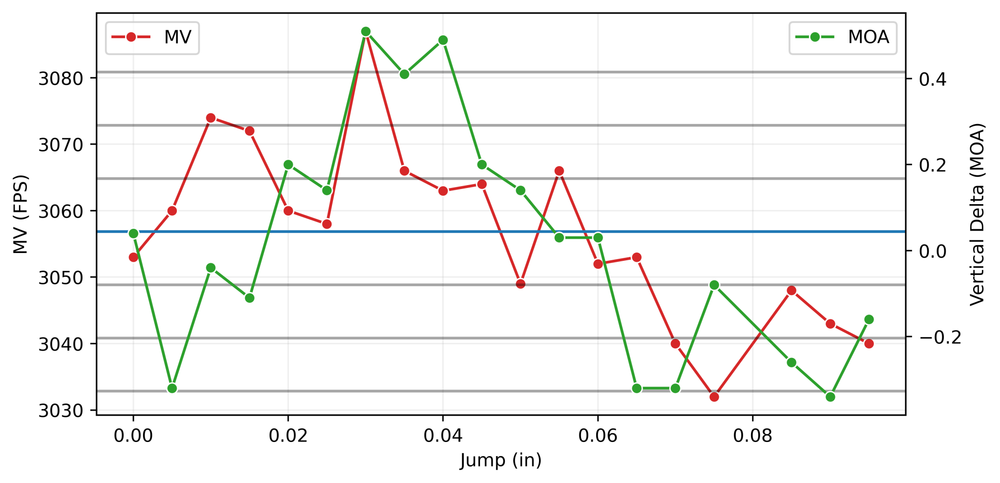

Here is the TLDR version from the link that @KYAggie posted above.
Here is an observation of my own in Mark's charted data. Notice how if you pick any one rifle and follow the line while watching the vertical scale, some guns are much tighter than others and stay that way for several steps of depths. Other guns jump up and down worse than the stock markets and it would be hard to pick a durable zone.
Based on the sum total of the chart, you might say that all of these guns shot pretty well and that you could just jump 0.020" and not worry about it at all. If anything, the context of a hunting or PRS rig where the ammo is all pre-loaded is one thing, a BR match where a relay is 5 targets of 5 shots plus sighters, but they can tune in real time between relays is very different than pre-loading.
There is nothing wrong with giving seating depth a try, other than the bbl life and resources spent on it. If the OP's rifle is for hunting or low volume shooting, then I would suggest he starts at jump 0.005" and takes it in steps of 0.005" to go seven or eight steps and see if it makes any real difference for him at all.

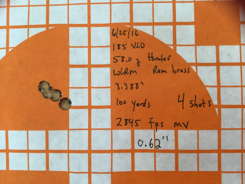

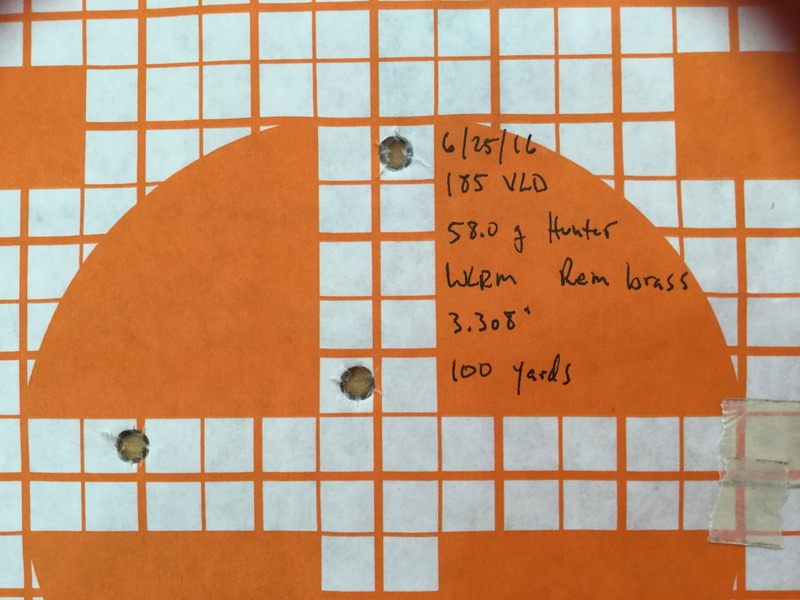

Here is an example of a match bbl in 6 Dasher with a Berger 105 Hybrid where the graph represents the vertical at 600 yards. Not counting the first two steps that were rediculously lucky where all three shots were touching at 600 yards, there are two places where the seating depth seems to be quiet. One zone is roughly 0.035" - 0.045" and the other at 0.060" to 0.080".
Keep in mind this is low sample testing of only three runs. Hard to say if these results would keep or if the verticals would spread out with more samples. The gun shoots just about anything into under 0.5 MOA at 600 for 20 shot strings. Bartlein bbl. chambered by Gary Eliseo.
Reactions: KYAggie

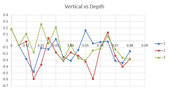

I’m surprised the data experts didn’t noticed a massive issue with the test design. I’ll leave that for them to find out.
From the data table they provided for test #5, we can see the vertical POI is associated with MV. There’s a likely reason the first few shots diverge and have nothing to do with bullet jump.
Because they failed to design the test properly, nothing of statistical value can be concluded. In fact, because of assumption violations, you can’t even use statistical tests.

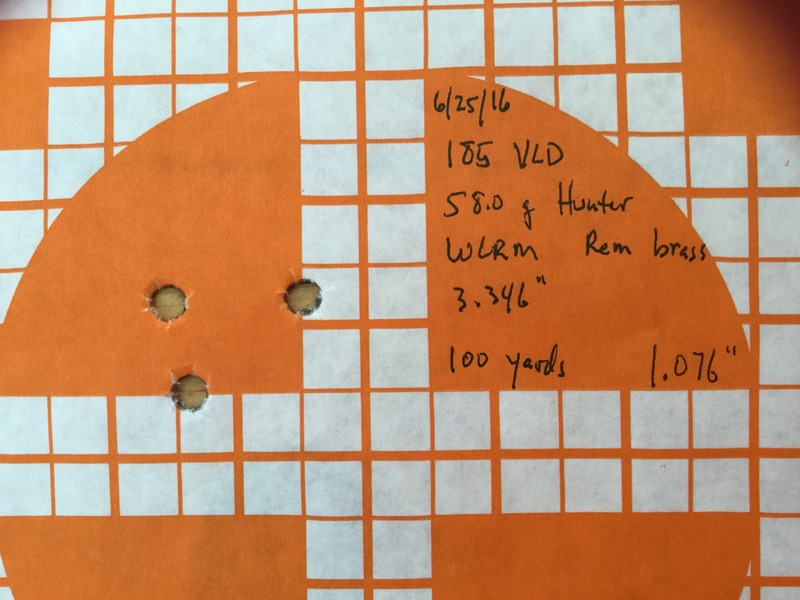

For example, using the earlier post showing 3 groups with the last one clearly being the best, who’s to say the shooter just didn’t need a couple groups to warm up? That’s way more likely, yet because he was “testing” seating depth, he chose to ignore all the other more obvious possibilities that could be responsible and decided a few thou of seating depth difference was the culprit.

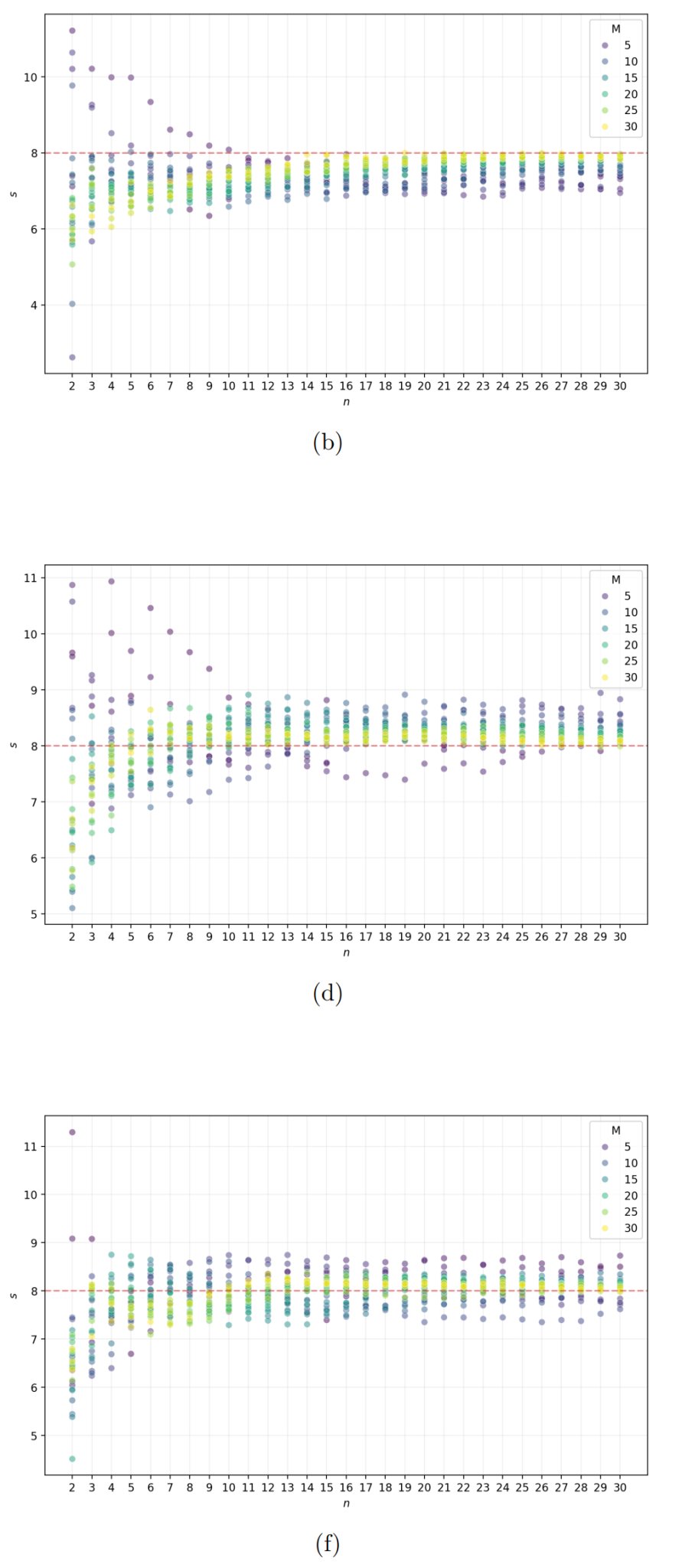

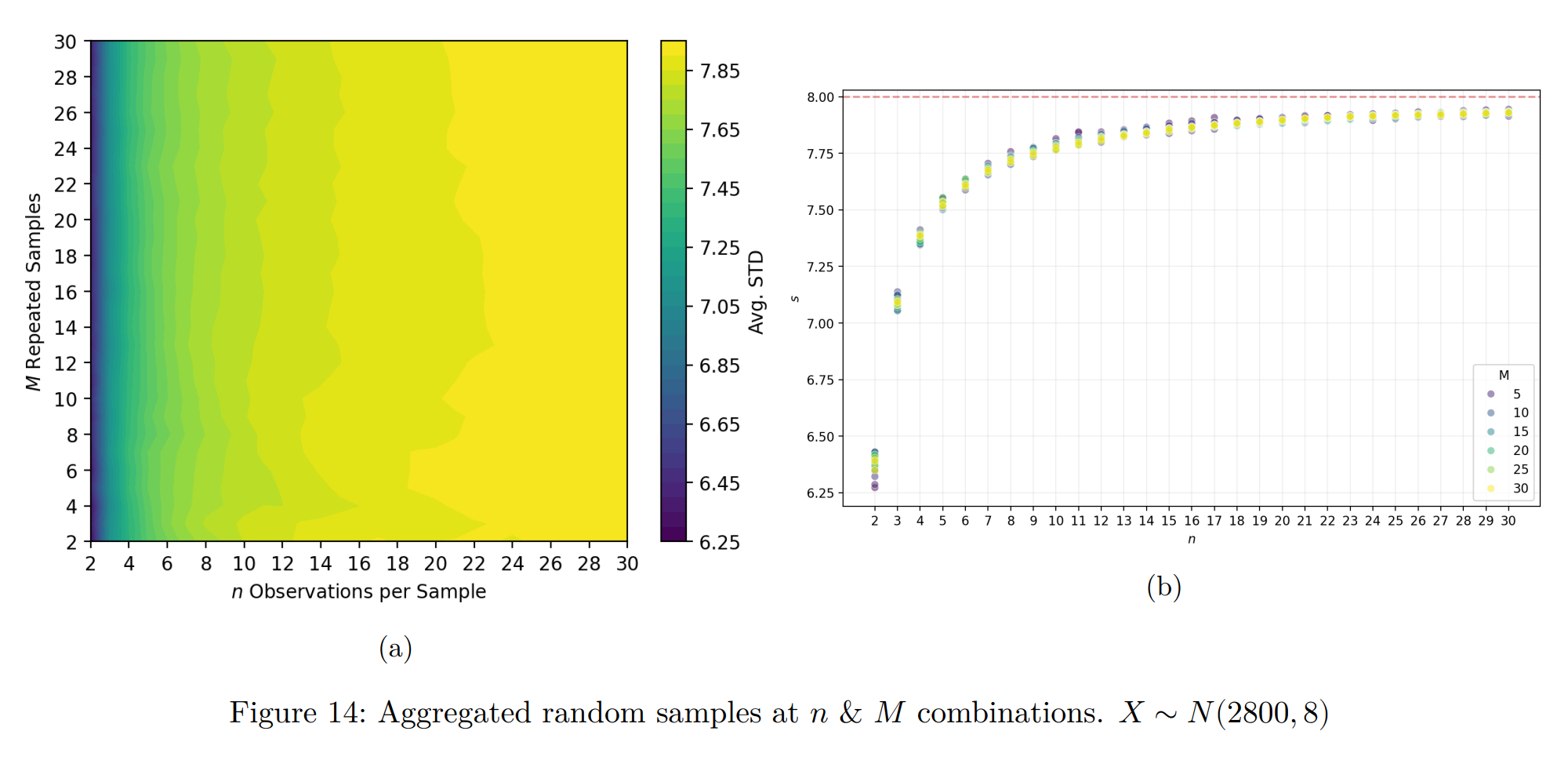

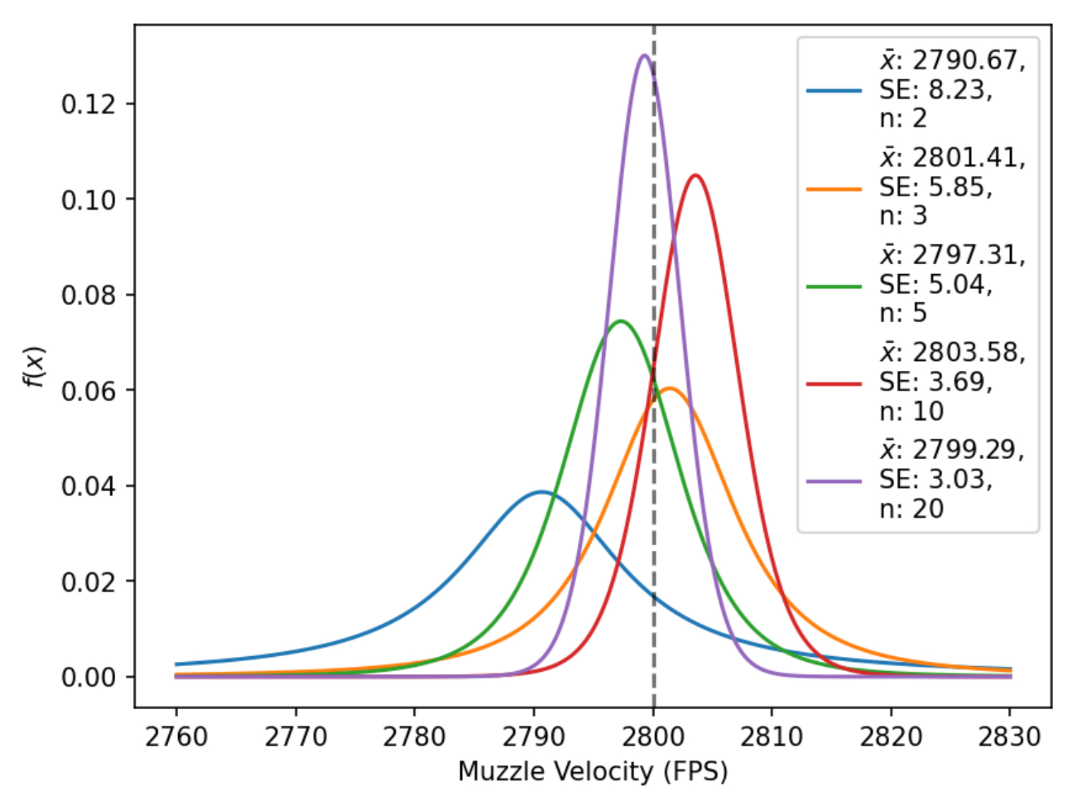

With consistent rounds that produce a low SD, I can shoot a 0.1mil group with 32gn at .020" off, 34gn at .100" off, 33.3gn at .060" off, the load recipe doesn't matter, what matters is that they're all the same.
Assuming MV and group dispersion follows the normal distribution, which it does in a local sense:
To capture the expectation of the distribution 20 shots, on average, does a nice job
To properly capture the variance, 20 shots, on average, does a decent job, but a little more would be ideal. Variance is a lot harder to quantify than the expectation. So, group dispersion and MV dispersion, on average, are underestimated with small sample sizes.
A glimpse of the variation of the variation when it is not aggregated
Nice little charts.
Why does the green/yellow chart only go to 30 observations?
Isn't there a more definitive method to determine minimum sample size that an actual statistician would use?
Nice little charts.
It only goes to 30 because it never converges to the true population standard deviation. You can put the sample size to 100000000 and it won’t converge. Standard deviation is a biased estimator. I like how you’re claiming I’m not a statistician lol. I guess my degrees and time at research labs was for nothing.

The plots I provided are based on statistical theory and their distribution. Nothing to do with my opinion or claims.
Unless I read your question incorrectly, there is no closed form solution for the sample size needed to ensure the 99% confidence interval width of the SD is no larger than 1% of the calculated SD. That’s a numerical method for solving.
Did you mean to ask how large of a sample is needed so that the margin of error of the MEAN is 1% given a population of 5000? If that’s your question, than it’s around 3000. There is a closed form solution for that but it’s a different question than you asked.
I don’t understand why you’re coming at me when I have yet to be a dick to you. Hell I agree with some of the sentiment you’re saying. All I did was post statistical theory.
Show me where I called into question your degrees specifically.
You’re using words that I don’t think you know what they mean. Or whatever.
I understand where the plots and charts came from. I am sure I can find similar plots and charts in several books in the storage unit.
You are correct, I should have referenced the mean of the SD of the MV as measured. Your estimate of 3000 is not so low. It's closer to 3800 shots taken to determine the validity of an SD. Not 20, not 30.....Three thousand eight hundred rounds fired to statistically determine the validity (or not) of that measurement.
