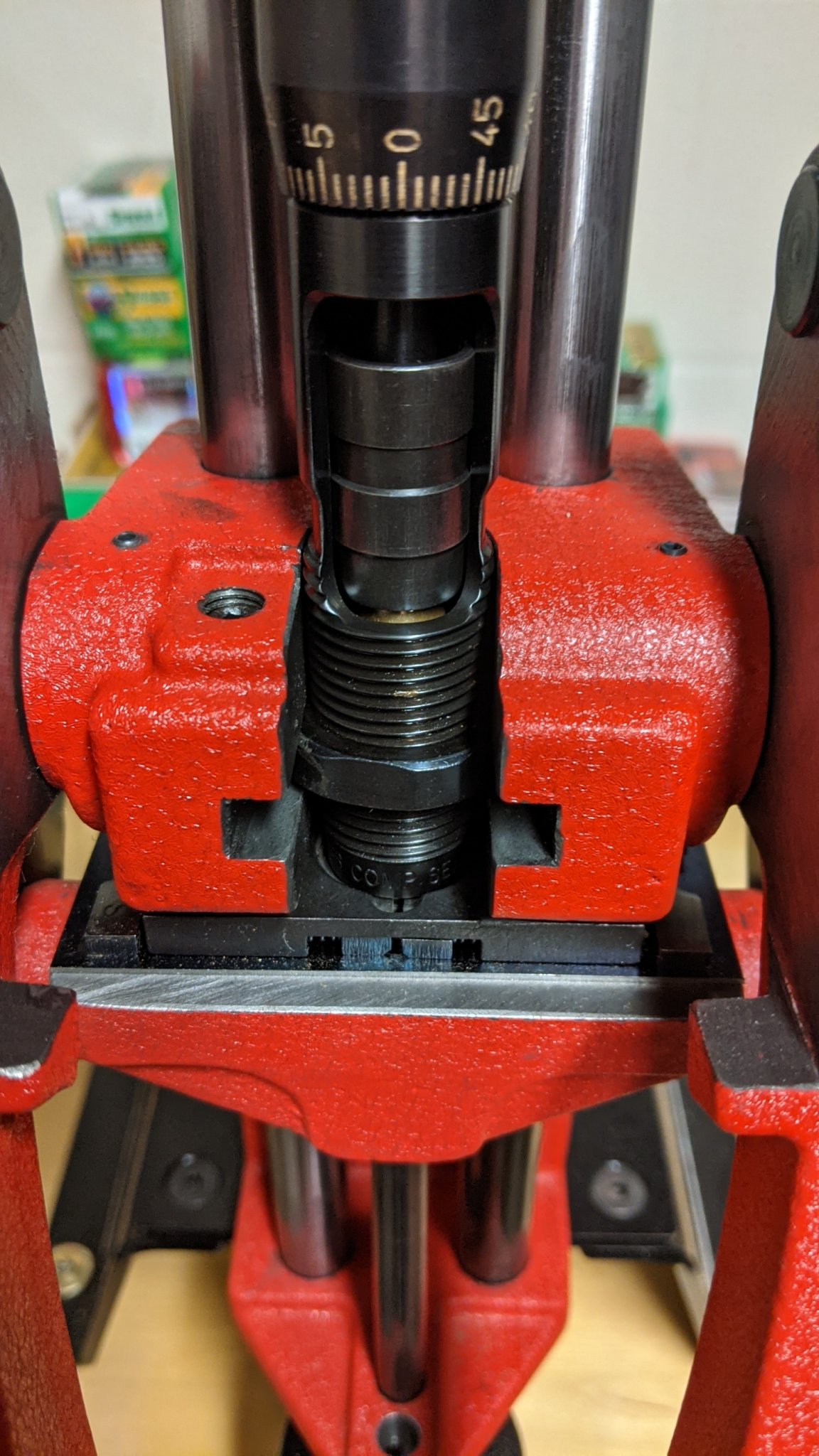

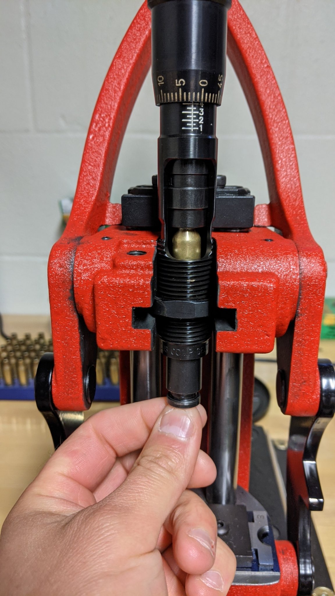

    I'm running the RCBS Comp FL die set and trying to seat some bullets.
    I put the die in the Coax, and no matter what I do, I can't get my OAL less than 2.885"
    The inside dimension of my mag is 2.901"
    I'd like to get down to about 2.870 so I'd have a little more clearance in the mag.
    Is the only option to cut off the end of the seating die, to allow more travel in the press, which would allow a shorter OAL?

    You need to adjust the depth of the seating stem by using an allen key in the top of the die (you'll see a hole on top). Turn it clockwise to lower it; the key should have been provided with the die.
    I see what you're saying, but there's nothing to "lock" the stem in place after adjusting the cap screw, so OAL would start to vary after a few rounds.
    I don't have another press as I sold them after buying the Coax. 🤦‍♂️
    I may have to cut the die down.

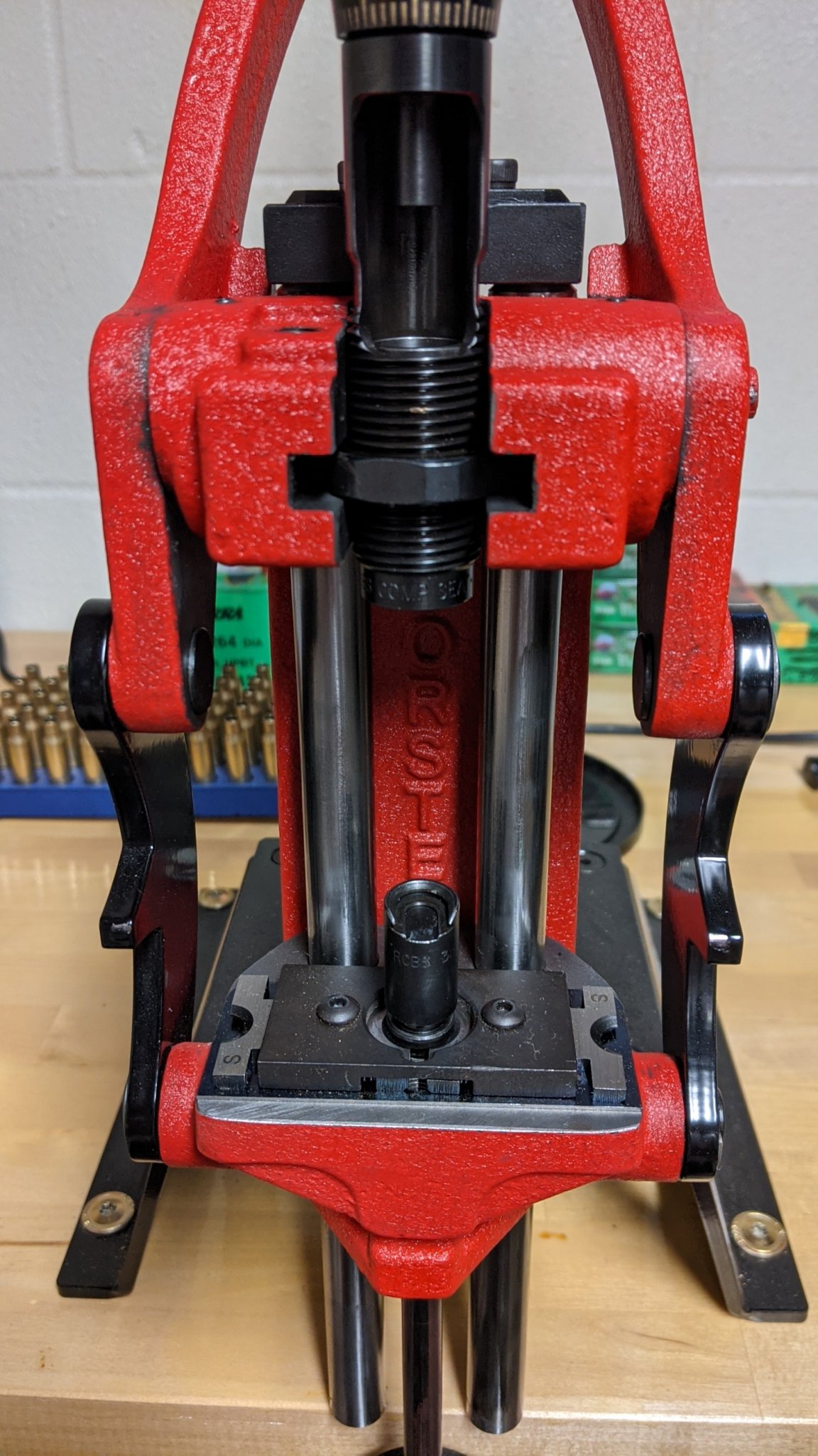

    I found a Forster Coax Conversion plate that will allow the use of a standard shell holder.
    It's less than a set of dies with shipping so I'm going to give it a try. I already have a #2 shell holder so I'm set there.
    According to this thread, it seems to work well and leaving the shell plate screws just a little loose allows the plate to float and it helps eliminate any concentricity issues.
