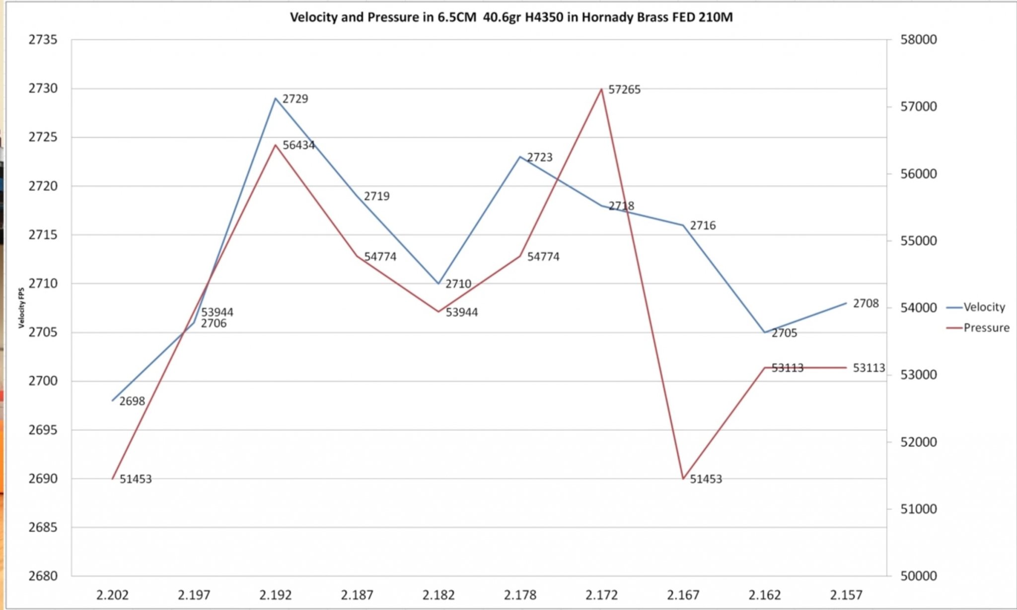

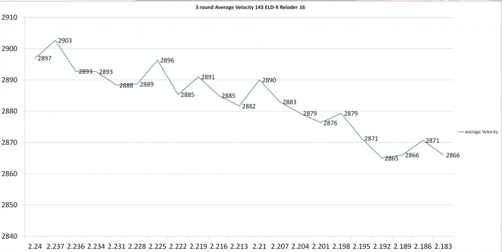

Snatched these graphs from Bolt Action Reloading youtube video. Shows well how MV goes down as jump increases.
So at least in this case, bullet jump is greater variable than burn volume.
And pressure follows MV quite closely.
