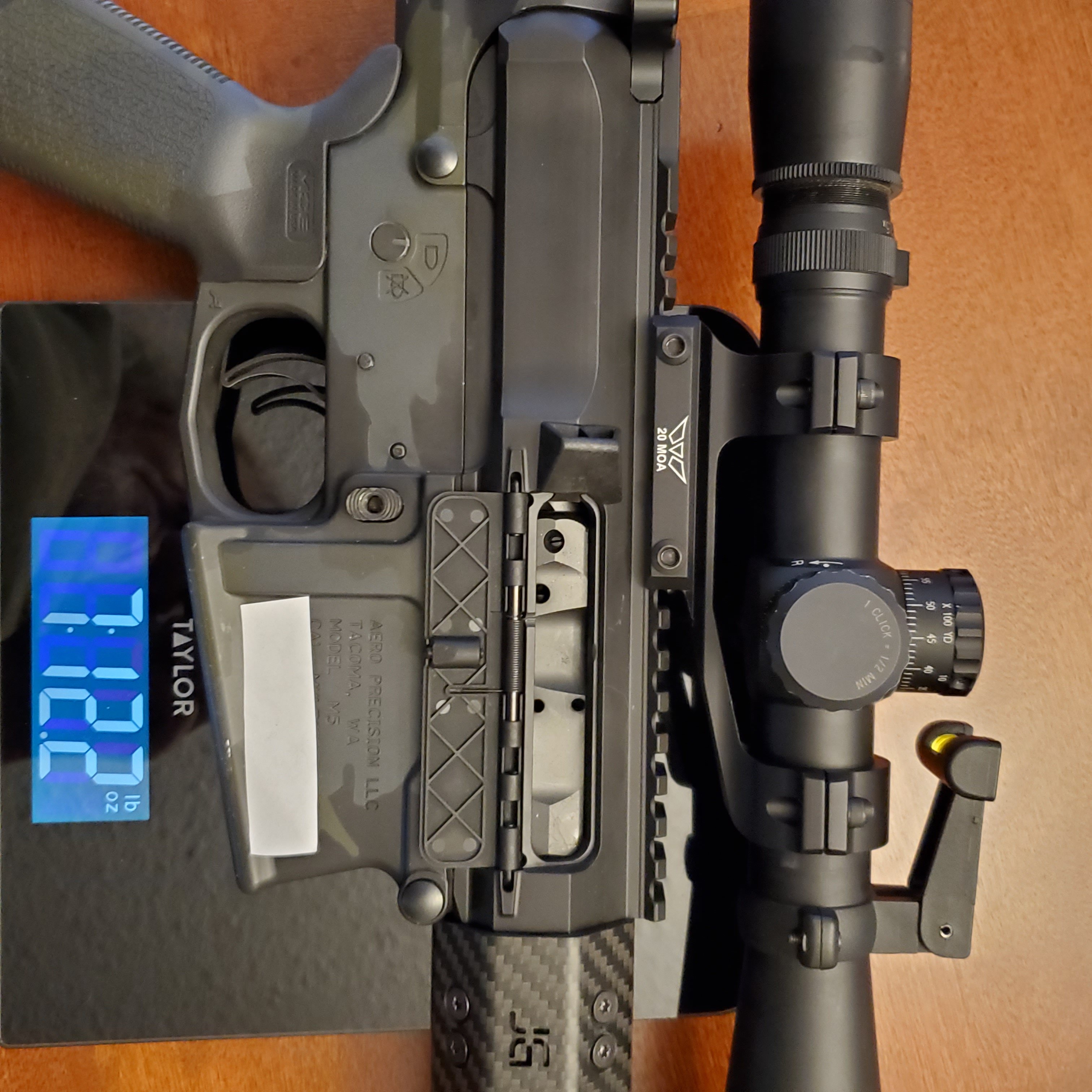

Not yet, I'm still under 200rds on this stainless barrel so haven't done any velocity testing yet. Hope to do more of that this summer
ETA: yes it's an AR10 platform
How far down did you cut it? I'm considering going as far as 14.5"
16.75". I was squeamish on cutting the 20" down. No cans because IL sucks and this was a personal toy.

6 lb ultra light AR 10 in 308 ...already to go form 0 to 1200 yds. Total weight with scope 7 lbs 12 oz.
168 eldm 2756 fps is the 1200 yd dialed load, shooting 1/2" 5 shot groups.
175 SMK 2601 fps
208 eldm 2442 fps
155 plama 2875 fps 155 Lapua to 2922 fps.
Mostly Lake City brass.
So the 308 hangs with the 6.5 CM bringing alot more energy to the target.
The pic is starting loads of 155 gr 2815 fps in 16" AR10. This particular 155 Palma was accurate at 2875 fps. The 2922 fps and tipped MK did not have acceptable accuracy but fast.
