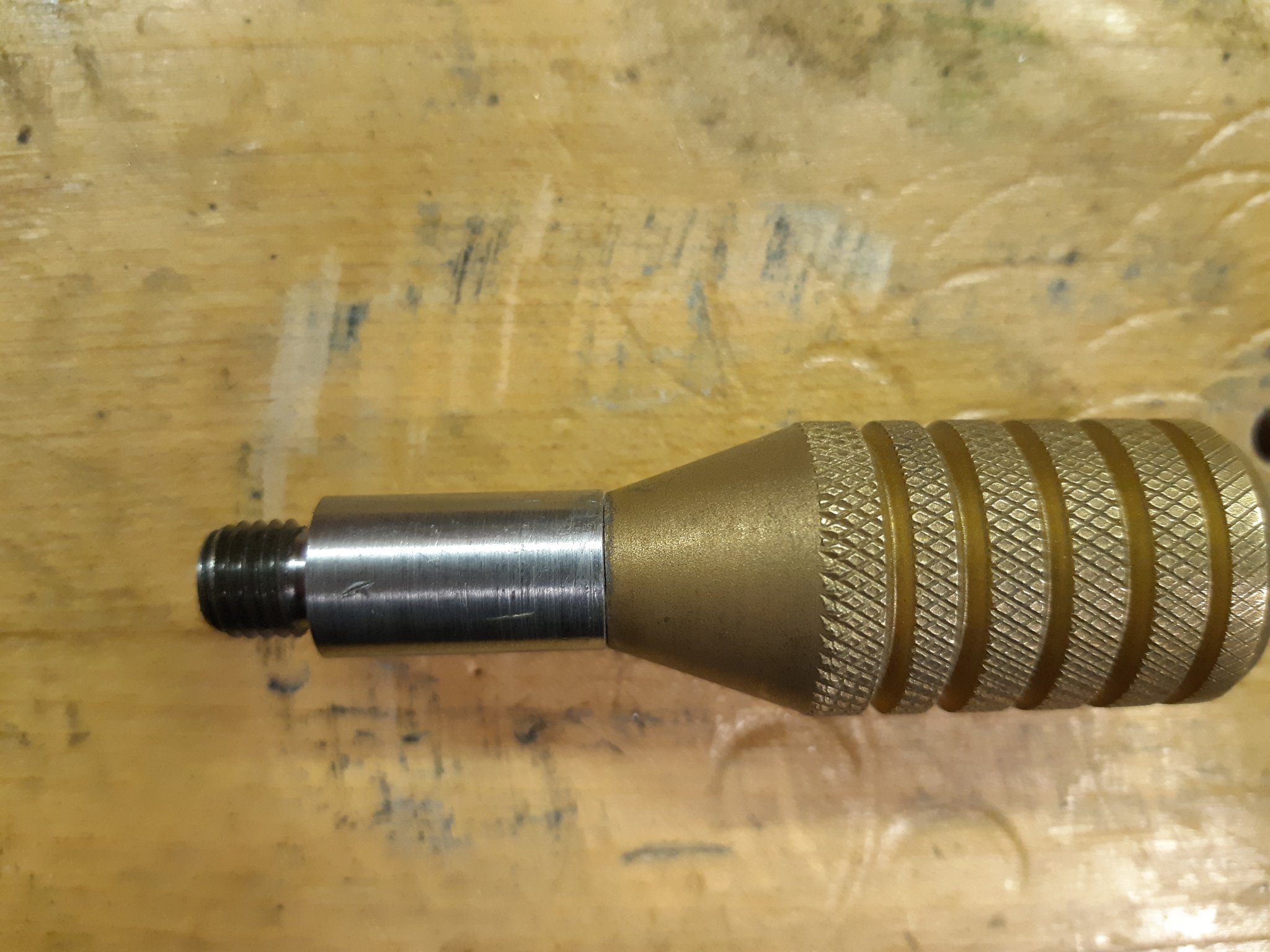

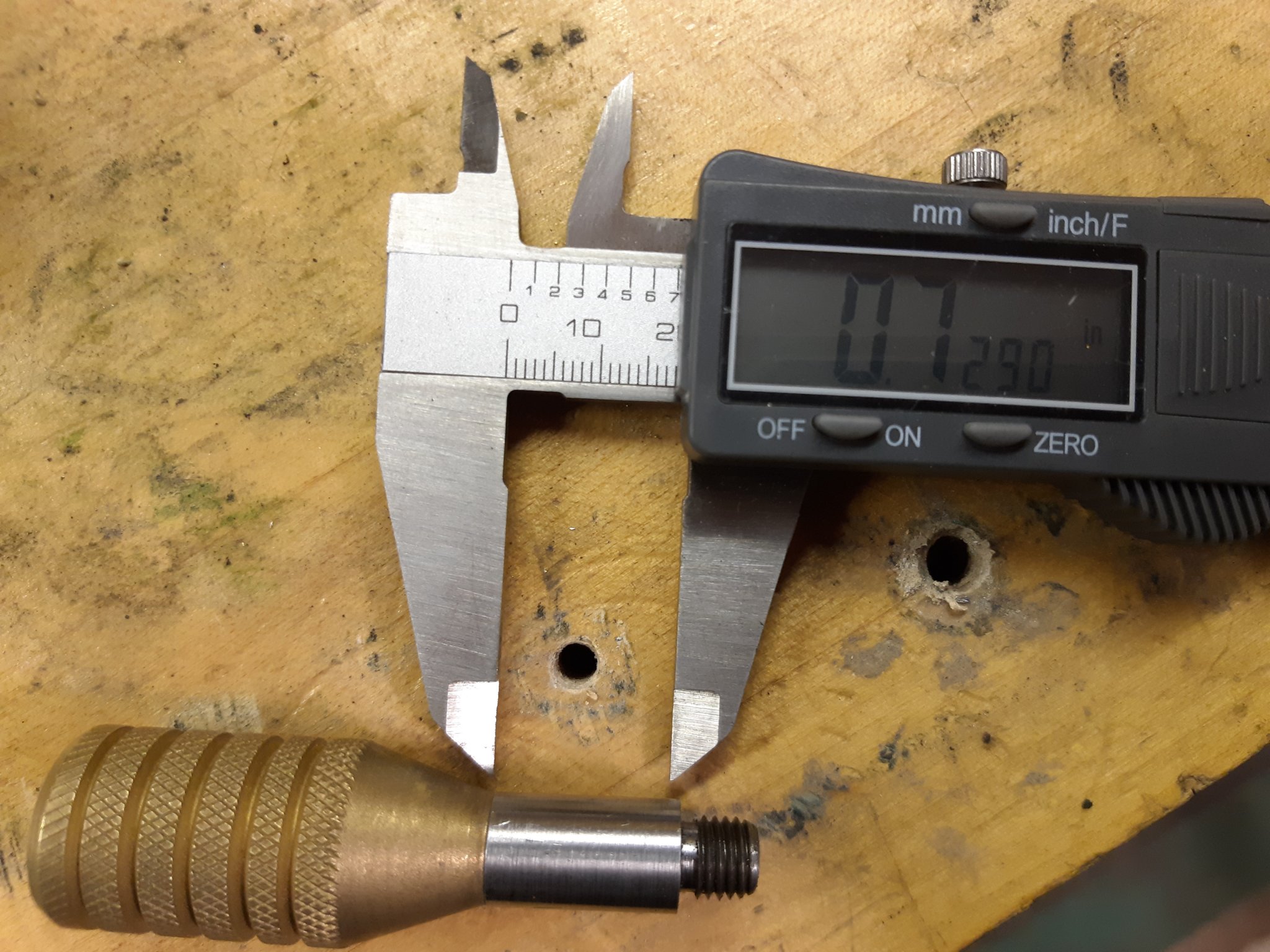

I had a male to male extension made to fit a Remington style knob, the extended (steel) part is just a hair shy of 3/4".

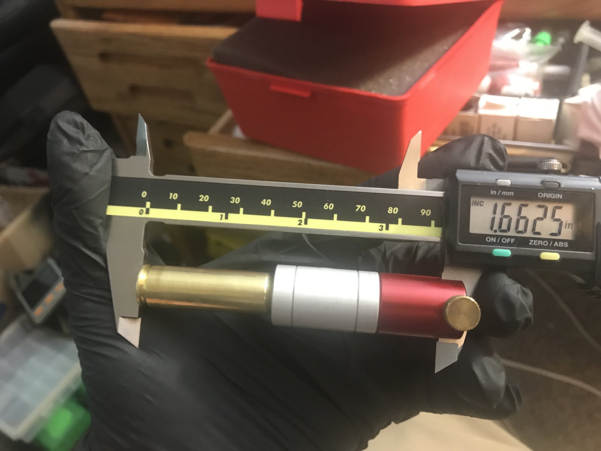

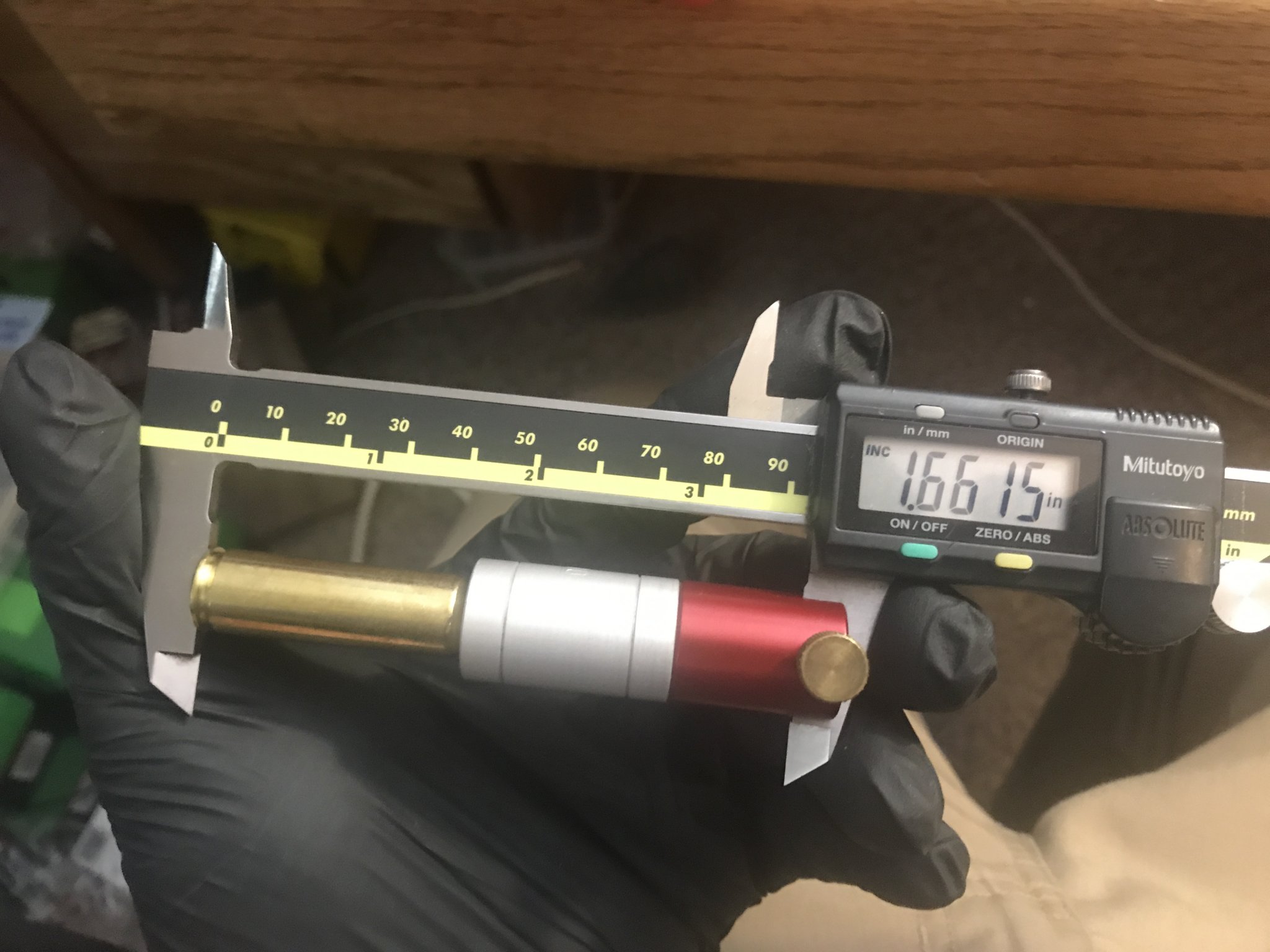

Second, and more importantly, on one of my Havak 6.5 PRC’s the factory head-space was only about 0.001" over virgin brass so there was bolt binding/brass contact on bolt close. I don’t shoot factory ammo, so once the issue was discovered, it became a non-issue for me. I ran the virgin brass through my FL sizer die and bumped the shoulder another 0.001”. From there, bolt close was just slightly more than other comparable actions, due to the cock-on-close, but not ‘tight on lock-up’. No more effort to close on an empty chamber, than on a round.
First picture below if of a piece of brass fired 3X, neck-sized only:
The next picture is of a piece of virgin brass:
Reactions: Dooby

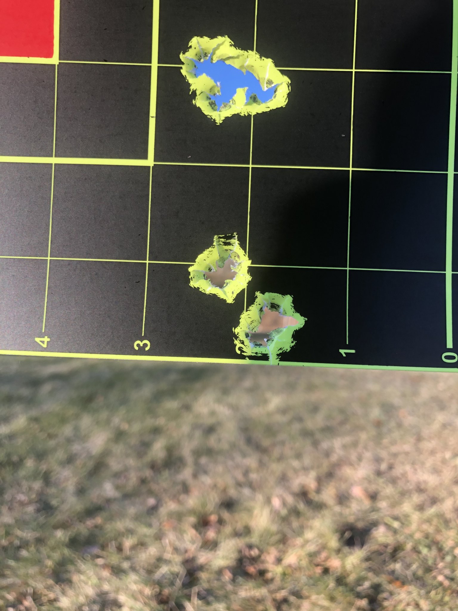

So I received my Havak in 6 Creedmoor last week. Took it to the lease last weekend, but didn’t get a chance to put anything down with it. It was wearing a PST II 3-15 while my glass came in.
I took a box of ammo to the range yesterday with it still wearing the PST, and was able to keep a sub 5” 3 shot group with my last 3 rounds at 1020. The rest of the box had been confirming dope from 300-770. This is the first rifle I’ve shot factory ammo from in a long time (and bought it specifically for that reason). I’m very pleased with the way it shoots. Just got it topped with an ATACR 4-16 MILC this afternoon, so now I need to get back to the range.8D390B02-26A5-4E68-9530-8D0EE919DEF9.jpeg

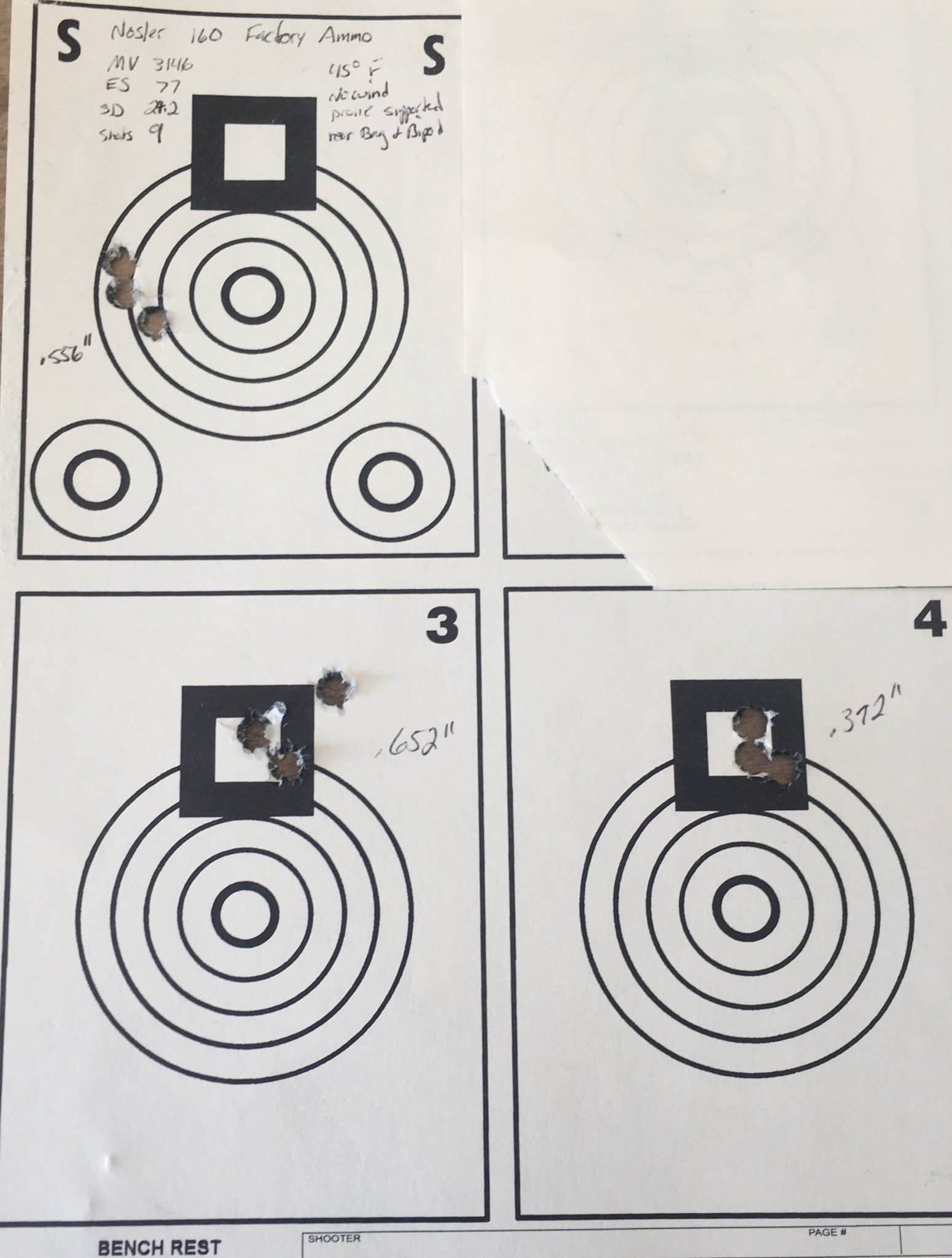

Well, I took the 28 Nosler out and shot some factory ammo through it in order to harvest the brass. It shot 160 Nosler Ammo descent, .53” average over 9 rounds in 3 x 3 rd groups. It shot 175’s like smashed ass hole at 100 (1.5” average) but pretty descent at 823 yards. I had 4 rds left and remembered I had a piece of steel that was still fresh since the last time I was home. I shot twice, (the left two) my father in law and my wife shot the other two with a different windhold, off the back of my truck cover. Sub MOA group with three different people shooting isn’t too bad considering.
I’ll be charging up some 180 Berger hybrids this week when I get home and see how it does. So far though, not bad for a factory rig with factory Ammo.
