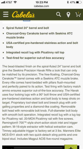

So what about the second version of this rifle that showed up on Cabela’s website? It looks to possibly be a more tactical version with an extended DBM, ATC Brake, and wearing a manners mcs-eh1 stock. It also says it has been test fired from the factory and is already ceracoated. But is it worth the extra $800?
I was curious about this second, more expensive version as well.
I think I like the manners over the McMillan a little bit but I’m sure both are solid choices. I might send Seekins an email and see if I can get a few more details about the other version. $800 more for just a Brake and a cerakote job is a little high, the stocks are roughly the same price (minus paint).
So I called Seekins about the other version and it’s going to be a Cabela’s exclusive model. Barrel contour will be the same as the standard Havak which is not named but they said it is pretty close to a heavy sporter. No release date at this time.
