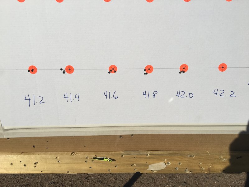

Did some load development yesterday with 140 Berger Elite Hunters, RL 16, Lapua brass, and CCi 450 primers. I’ve used a similar load in several different rifles, so I had an idea of where to start and ran the OCW in .2 increments. Also had really good luck at .040” jump with this bullet, so started there. Started seeing pressure signs at 42.0 so did not shoot 42.2.
Average velocities were as follows:
41.2 - 2755
41.4 - 2774
41.6 - 2797
41.8 - 2810
42.0 - 2828
The aiming dots are 1”, so virtually all groups were around 1/2” @ 100 yards.
