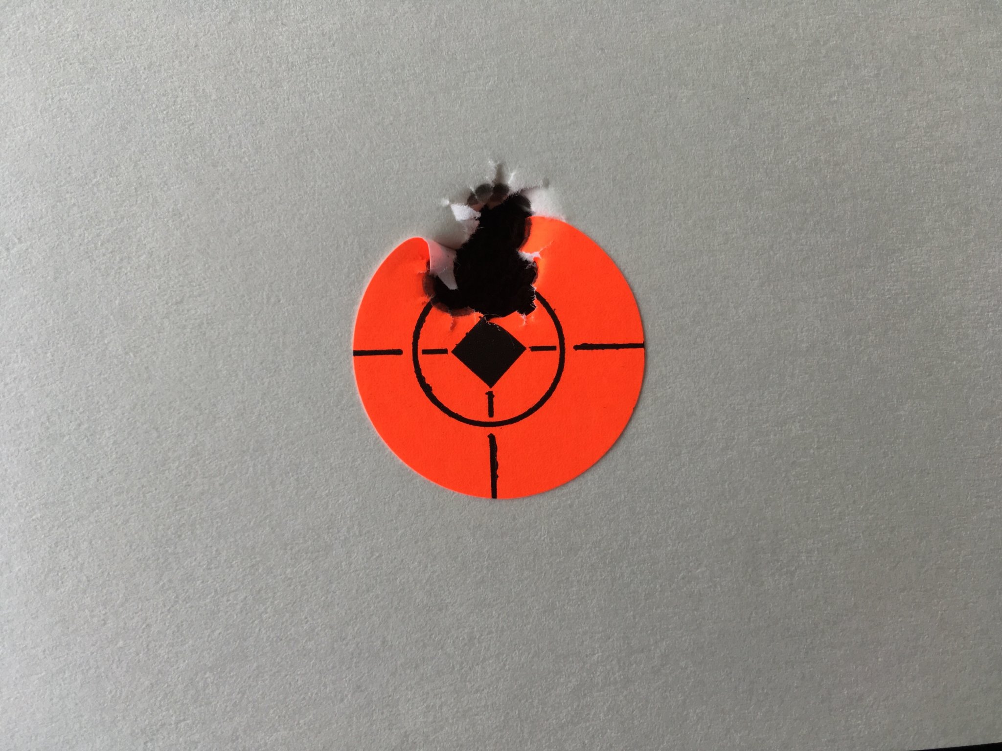

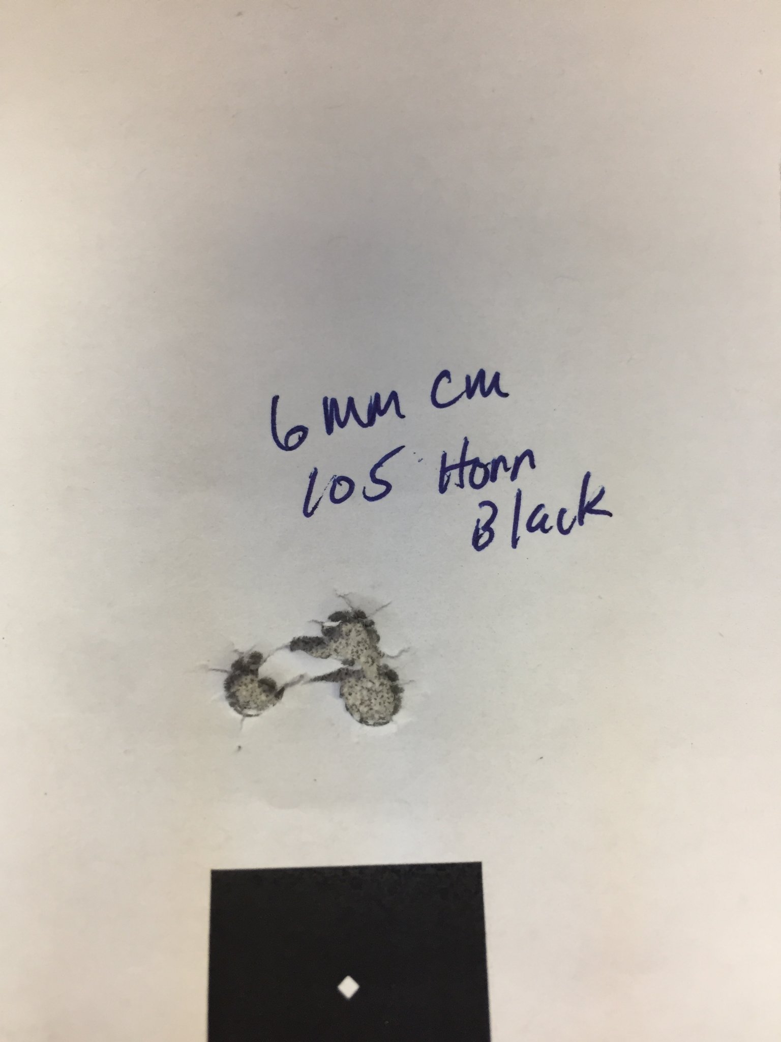

Can’t find last weeks targets at the moment but they were 1/2 MOA with 105 AM. Factory ammo is good also...

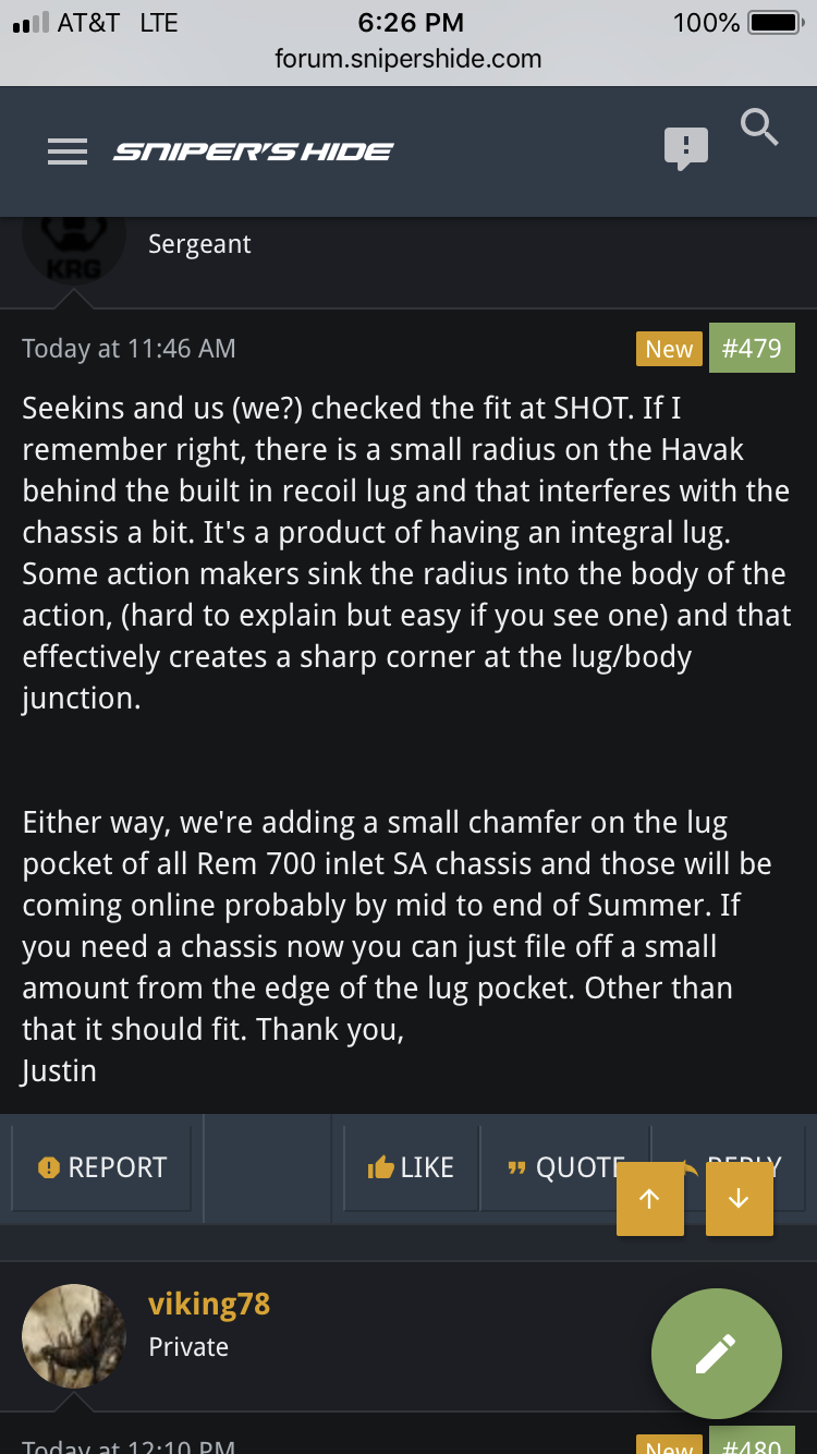

I rounded off the lug fitment on the bravo, and my trigger safety was hitting down on the bravo so I filed those areas down. Other than that, looked good to me.

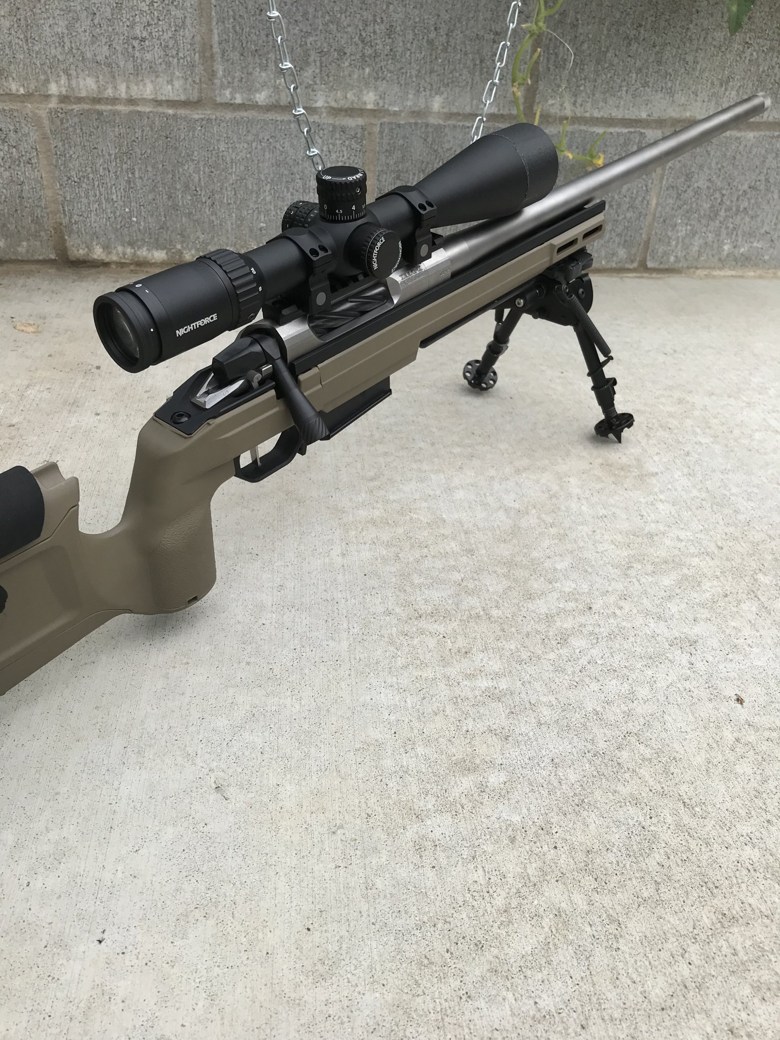

Havak installed in the KRG bravo. I noticed when I'm dry fire practicing on my barricade, with the 12/6 o'clock lugs, the 6 lug likes to bind up with the feed lips of a AI single stack mag when any kind of pressure of made contact with the bottom of the mag. with my AI AW mag, the mag follower makes contact with the 6 o'clock lug after last round is stripped. I know not an issues but when dry firing, I have no ammo keeping the follower down. what I'm asking, anybody using another brand of Magazine with no feeding issues?
I dropped my Havak in a Bravo and fed 6.5 PRC without issue out of 2 unmodified ARC mags. I did not specifically try putting upward pressure on the mag in a barricade but can test that later and report back. I am able to dry fire from a prone position though with those mags with no issue. I ran this for 125 rounds so far with 100 of those being in a prone ELR club match (not thinking about the mags at all).
